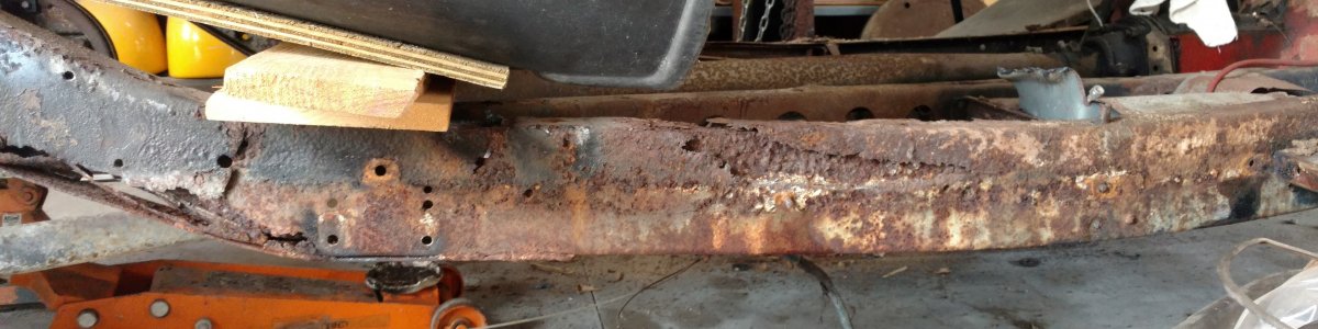

    Back when I was helping with the engine & brakes all those years ago, I noticed some rust undernearth the right rear frame rail at the kickup - a common rust area on these years. I welded in some strap as a temporary reinforcement, but told my dad he needed to replace that section. One of the things he bought was replacement frame sections for the area, along with replacement pieces for the crossmembers (which weren't bad).
    Fast forward to a couple of months ago, and for spring break, I helped my son disassemble the bed, rear fenders, and running boards so we could get to those frame sections first. The kickup was worse than I knew, but what was even worse, was the entire right frame rail, which we couldn't see with the running boards on, was almost completely eaten away. This wasn't noticeable from the inside because someone had welded in some C-channel on both sides at some point in the distant past. The C-channel was keeping this frame together...at least on the right side [​IMG]
    So now we're on the hunt for a decent frame. I've found a couple good ones, but they're way out west and it's simply not feasible to get them back to FL. I've posted a wanted ad here on the board:
