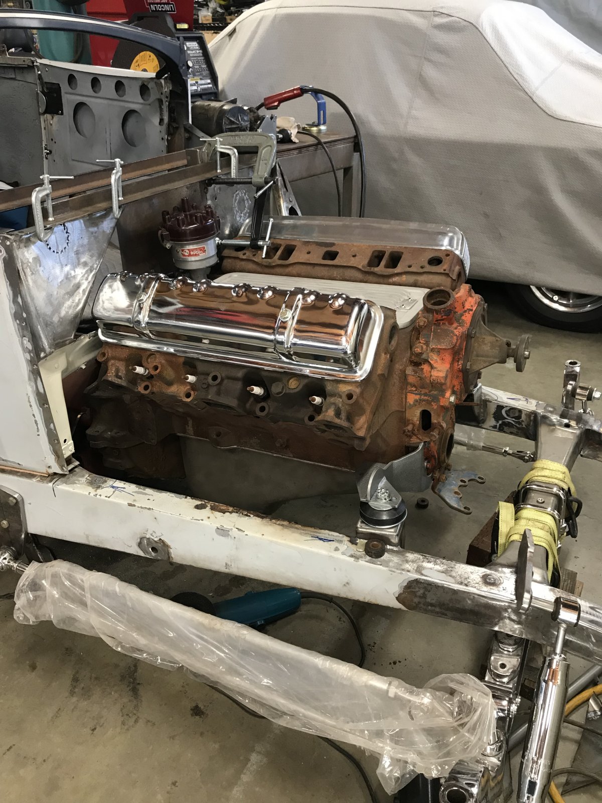

    I bought some Hurst clone motor mounts off of eBay years ago during the parts collecting phase. Real ones were scarce and too expensive. These are pretty accurate. For frame brackets, I did what I would have done back then; made patterns and made them from pieces of 3/16" plate welded together. I mocked it all up using my spare '49 block and a Hydro.
    I like my engines a little higher than folks do today, I use a stock fan and raise the engine until the bottom tip of the fan blade is just above the lower tank to core seam. Raise or lower the rear of the trans to get reasonable U-joint angles and call it good.
    I like the look of a chrome stock fan spinning behind an old Ford radiator.

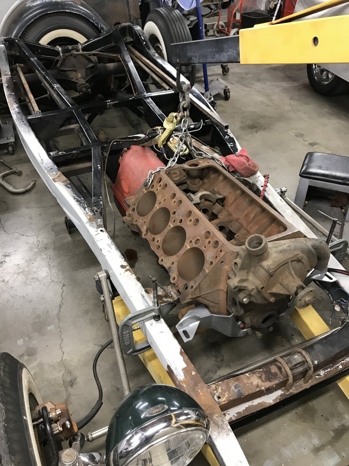

    Again, made use of the old Ford biscuits to mount the back, kinda like the Olds factory did, a four-point system. More cardboard and more plate. Nice, compact, sturdy little mounts.
    A lot of the material that I used came from the horrible boxing plates someone did on the frame of my '33 Ford pickup, a lovely combination of 1/8", 3/16" and 1/4"! I live way out in the boonies and it's a substantial drive to the nearest metal supply company so I use what I have for the most part.
    I left the old Chevy tailshaft mounting pad on the crossmember, I may make a rear mount for the transmission using a Chevy pad. Just doesn't look like enough to support that big ol' cast iron trans, does it? Olds thought it was, the jury is still out for me. The old Ford pads ain't what they used to be.

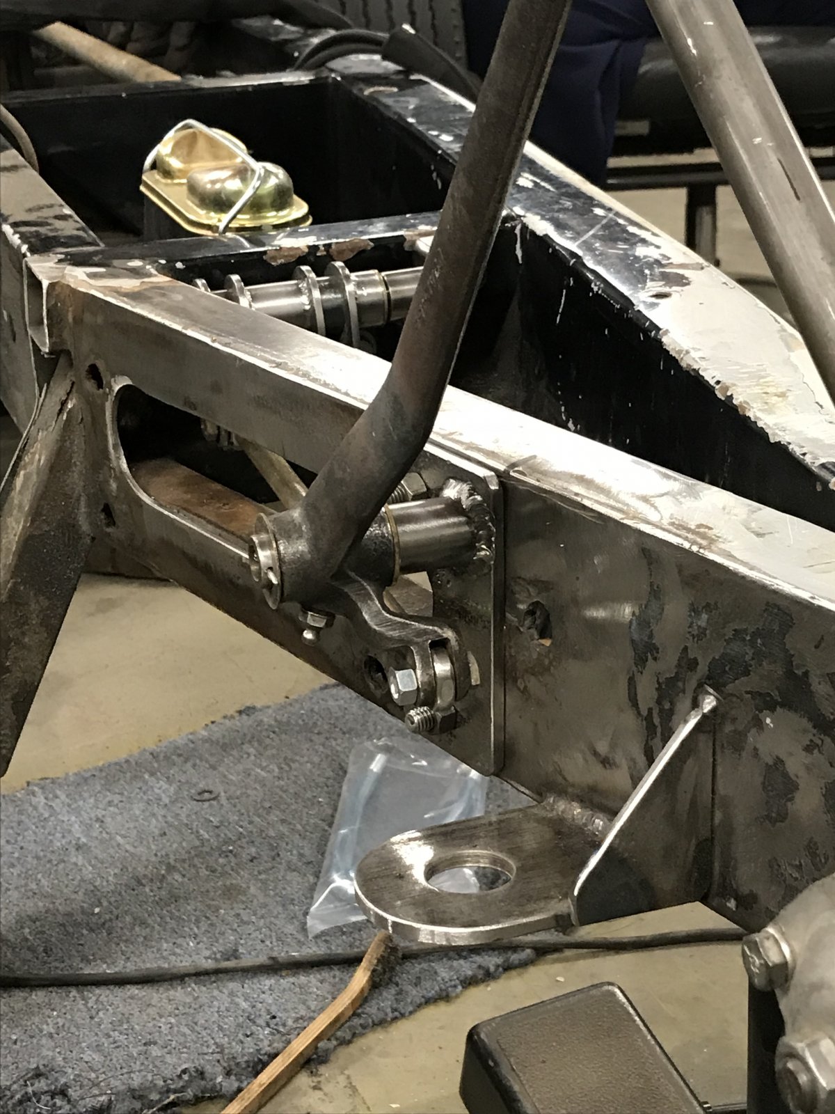

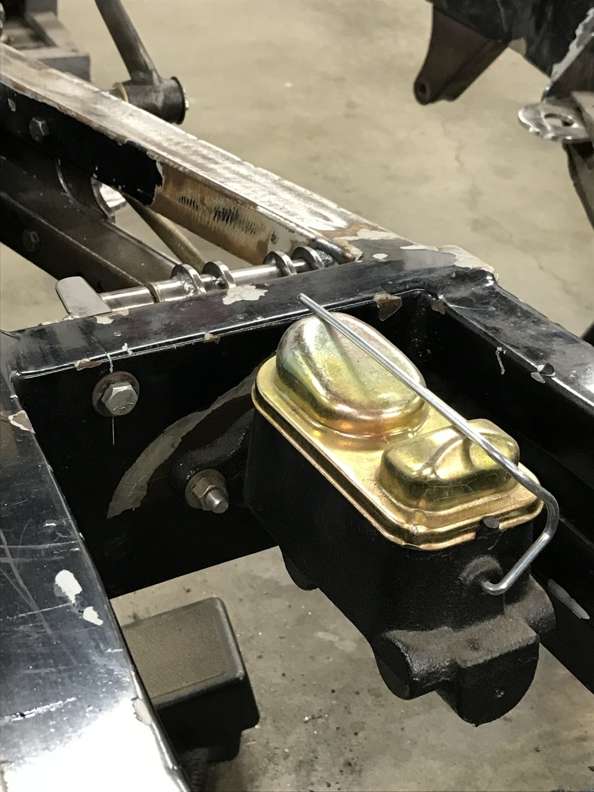

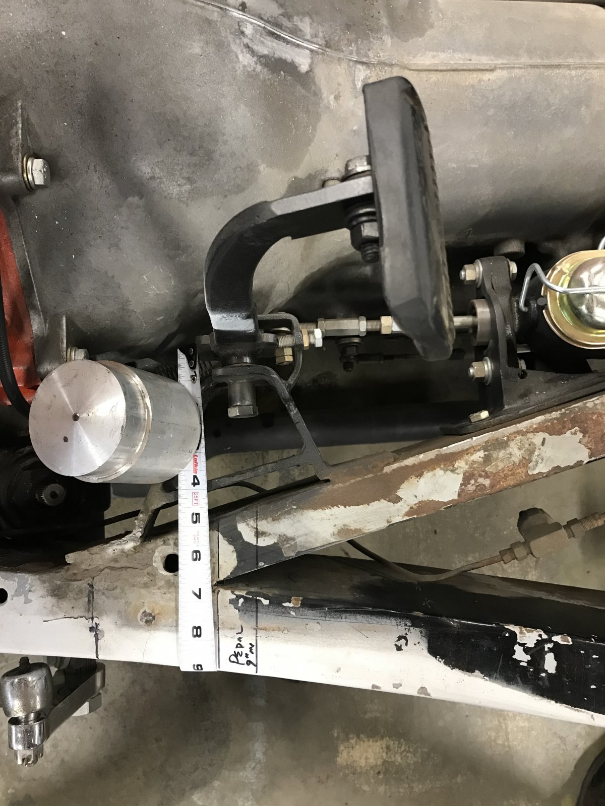

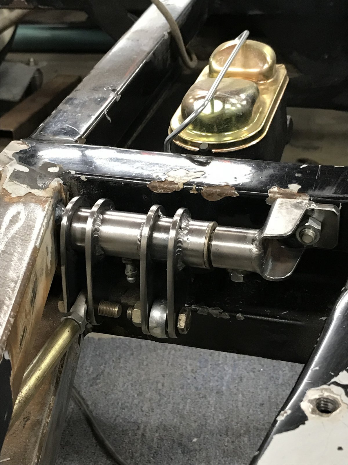

    The pedal and master cylinder assembly that came in the old car was not their best work. When I got it the pedal ratio was pretty bad and the pedal effort was pretty high. On top of that the pushrod was way off center with the M/C and it had started to leak. So I cut the ear off of the transmission. I added a tube and a bushing to the pedal pivot to give it some stability and some bearing area. Added a mechanical stop, instead of the carpet. Then I remade the M/C bracket to improve the position and angle of the actuating rod. It worked better and gave me some piece of mind, but it was still real bad.
    Here you can see where everything was.... Right where a motor mount needed to be.
    So I mapped out the pedal location and cut it all out. I mocked everything up and figured out a way to use a real old Ford pedal.
    That piece of square tubing with the fractions written on it was my tool for measuring the curvature of the top of the '32 rails. More on that later.
  15. bchctybob
    Joined: Sep 18, 2011
    Posts: 5,774
    bchctybob
    I moved the master cylinder to a different place on the X, but the X presented a problem, finding a path for an actuating rod. A big oval hole in the X plate and a cross shaft/bellcrank solved that problem.
    Mocking things up to see what goes where....
    If the pedal goes there, and the M/C goes there, I'm gonna need....
    IMG_1636.JPG In the oval hole you can see the plate welded to the 2x2 X....
    In the end (after installing the body and steering column) it came out OK.
    I'll still need a pedal return stop and a spring....

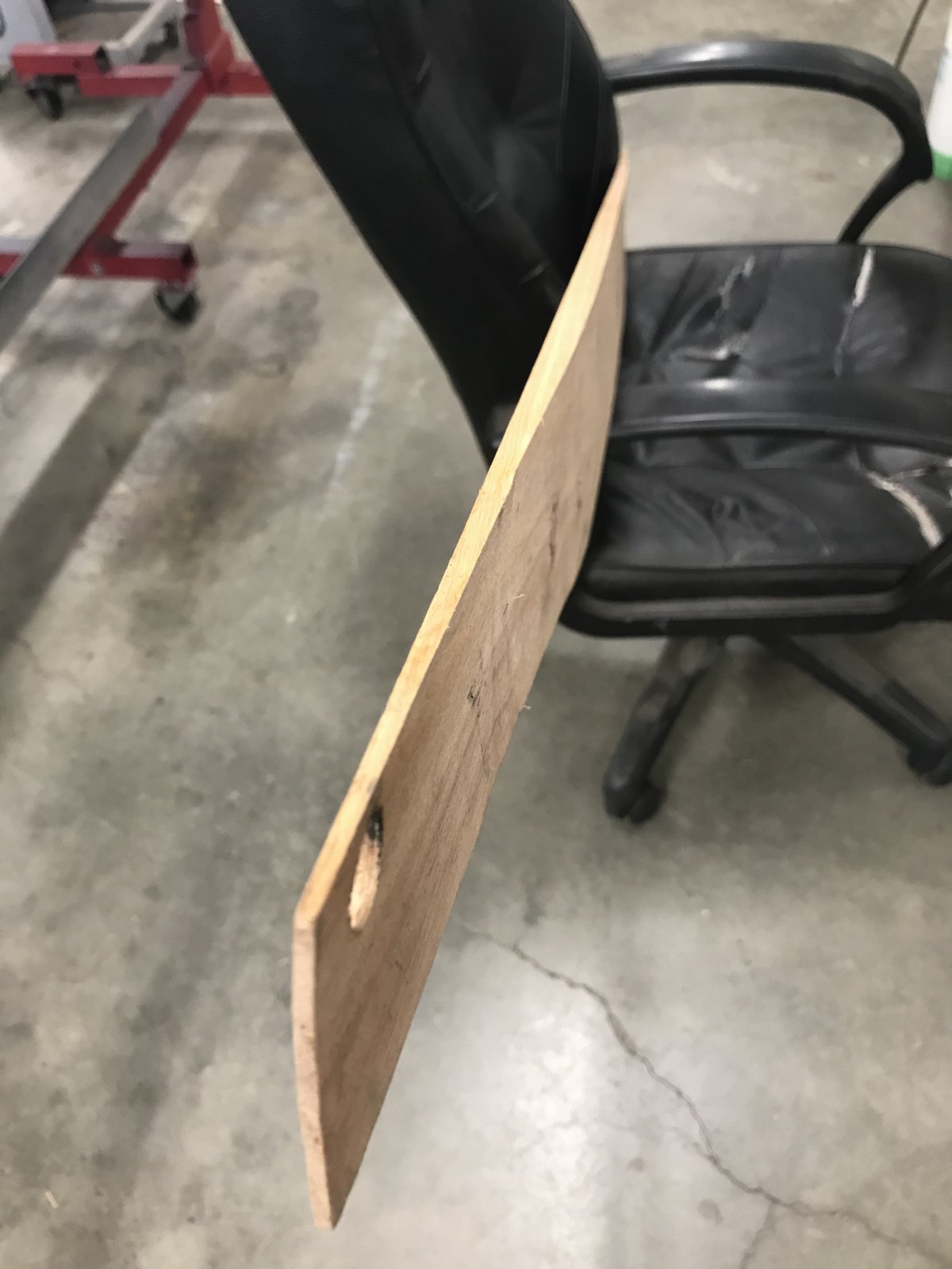

    The bar that I pointed out before with the numbers on it is a quick straight edge that I made to plot the curvature of the top of the '32 frame. The bottom of the '28 body is flat, so there is a gap between the two when the body is installed on the frame. I considered flattening the top of the frame but with the X and boxing that was just too invasive. Some of the old timers cut a piece of hardwood to fit and fill the gap, some used individual pieces, but looking from a low level, you can see the shim and individual pieces look terrible. The previous builder used a piece of a pallet and some plywood.
    So I cut a piece of square tubing to the proper length, clamped it where the body sits, measured the gap every 6", and wrote it as graduations on the bar. There were slight differences side to side but nothing significant. I bought two lengths of 1"x 4" oak, transferred the dimensions to the edge of the boards with a Sharpie, and wondered how in the hell to cut a five foot long oak 1x4 through it's edge accurately. I have an 18" wood band saw that I used to use for cutting out aluminum motor plates and marine mounts so I dusted it off and tried a cut. Needless to say it wandered and I couldn't control the board well enough to get a good cut. Did I mention that I'm no woodworker? I hate working with wood. My Dad was the woodworker in the family, I didn't inherit that gene. Back to the lumber yard for more oak planks.
    I ended up using a 90 degree plate from my mill, clamped a few inches back from the blade to act as a steady rest so I could keep the board vertical as I cut it. Following my Sharpie line, it worked great. The next step was to remount the body and see if I could get the doors adjusted.
    The body was previously mounted with several long bolts that went all the way through the frame rails with nuts on the bottom (ugh), and a couple decent rear mounts added by my buddy. I made inserts from some long 3/8-16 self-locking nuts, turning them down and leaving a little shoulder so they wouldn't fall into the frame. I marked and drilled oversize holes and chamfered the top so that the shoulder would sit down in it. I TIG welded them in. I put them in locations that would make shimming and adjusting the body and doors easier.
    It took a few iterations, putting the body on, taking it off, putting it on, but eventually I got the body bolted down securely and the doors to open and close nicely. Unfortunately, I didn't take many pictures during this fiasco other than the end result. The long, wide body shims will be trimmed during final installation, then shellacked and painted body color.

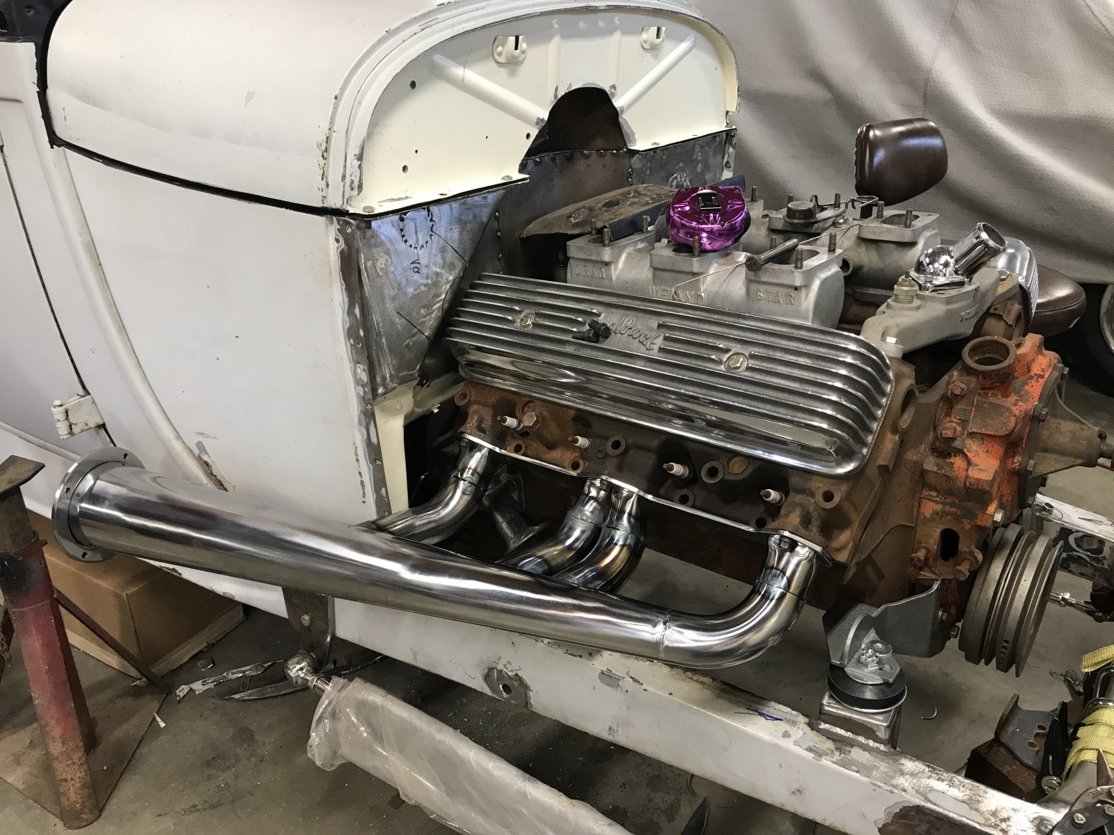

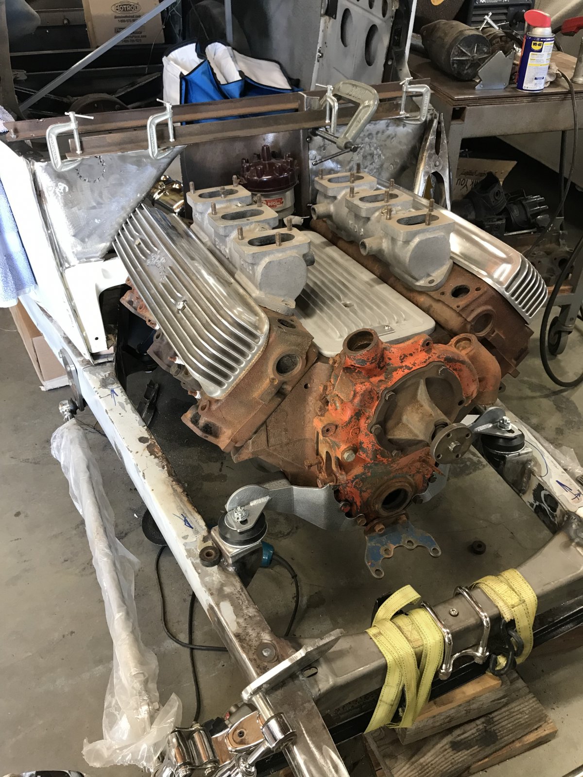

    With the new shims and inserts I reinstalled the body and got the doors aligned quickly. Time for the firewall. Sam's car had a flat, mahogany firewall made by Tex Smith's father. It and the rear wheel arch inserts were a trademark of this car. The workmanship was beautiful. But I just couldn't do a wooden firewall.
    I installed the front crossmember 1.5" forward from the stock position. I installed the Olds with a stock fan, nice and close to the new Walker radiator and I fully expected to install the body and use a stock or a flat firewall. Well, apparently, I need to sharpen up my math skills. All fit well with just the short block but when I went to install the heads and distributor, oops.... With the heads installed it was apparent that the firewall could not be stock. Even the valve covers encroached on the stock firewall. What the hell??? So, I just got creative. I do not like those generic firewalls from several sources that look like boxes, so I decided to make the recess fit the need and use larger radii instead of square corners.
    I like choices, so I mocked it up using the various valve covers and distributors that I might want to use to determine the needed clearance.
    The Edelbrock covers are a bit taller....
    There was a bunch of poorly done repairs under the "skim-coat" of Bondo on the firewall, but it will be ok once it's all finished.... (never mind the headers)
