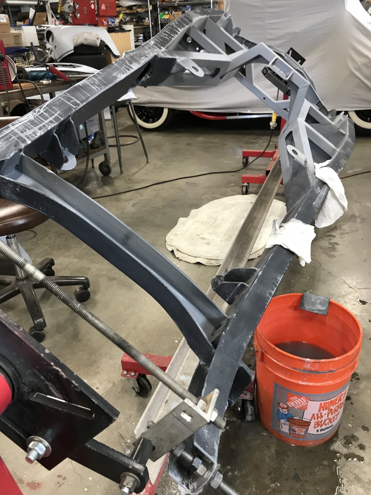

    Sorry for the interruption. As I mentioned before, I’m sharing caregiver duties in 24 & 48 hour stints. I certainly see now why my sister had a meltdown and wanted more help. Giving 24 hour care to to a mostly helpless person is more taxing than I remembered. Maybe it’s because I’m no spring chicken myself.

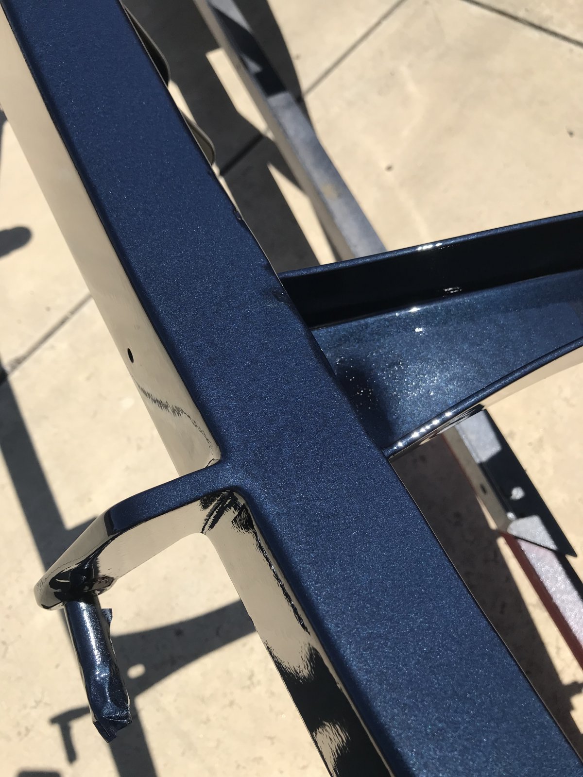

    If you’ve seen my other thread, I’ve been rebuilding the Treadle-vac power brake unit out of my Stude pickup among other little bench projects. But the roadster has progressed as well.
    After the frame returned from ‘blasting and epoxy coating I cleaned it and scuffed it in preparation for some high build primer. I molded all of the welds and filled and blocked the areas that were to get body color paint. I masked and painted the inside, from the firewall back with Krylon Rust Tough semi-flat black. It’s been my go-to chassis paint for years. It has the right tone, gloss and most of all it doesn’t fade much so it touches up well. I know that I will have to make a few mods as I go forward so those changes won’t be readily apparent.

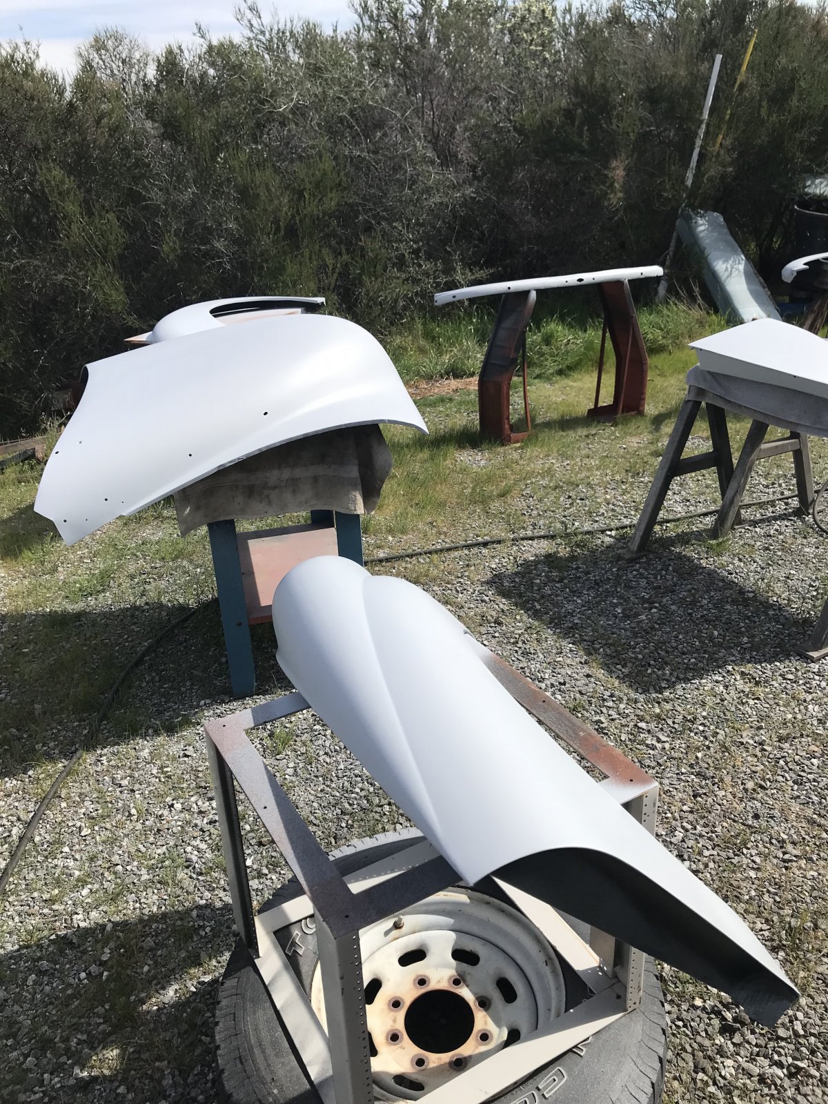

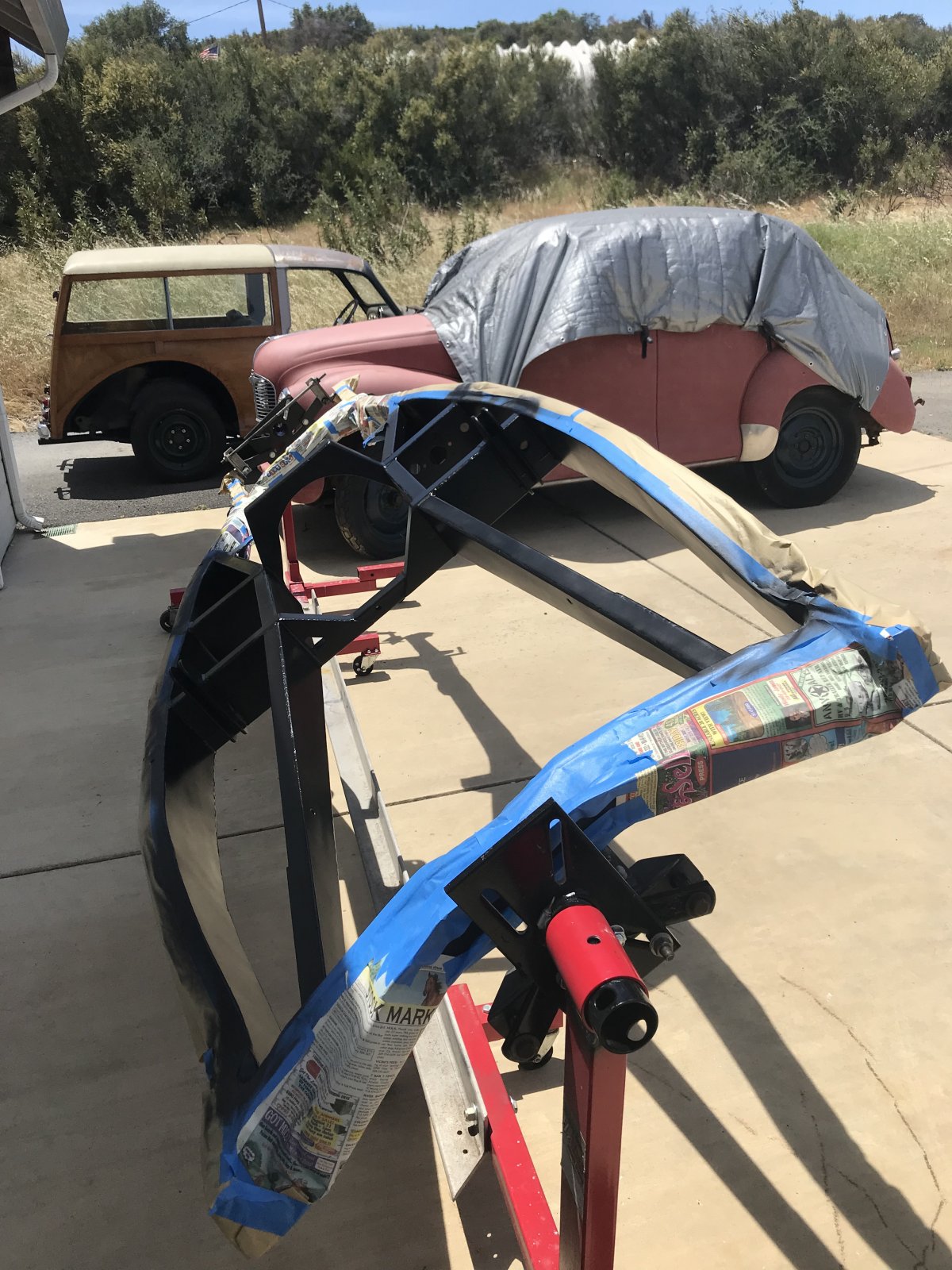

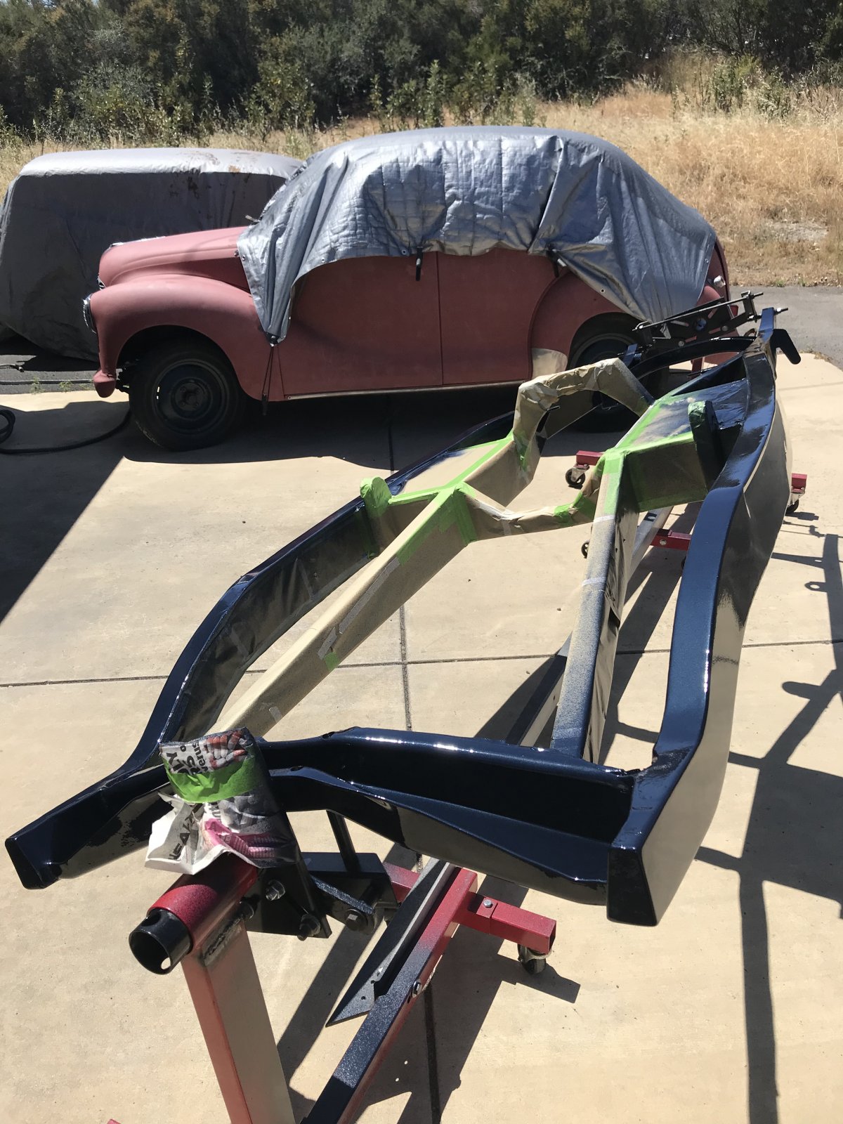

    I gave the black paint some significant drying time since I knew it was going to require back masking when I sprayed the body color. I contacted TCP Global and ordered ‘63 Buick Diplomat Blue Metallic single stage acrylic enamel. I sprayed an old hood and I wasn’t impressed with my application or the color. So I ordered several other metallic blues (at about $100 a pop) and did test sprays. The truth is that while I like the intensity and color of the later model colors, they just look too late model. I took a break from color selection.
    During this break is when I bought my Stude pickup. As fate would have it, it was painted with the same Diplomat Blue way back in the ‘60s and although it was lacquer and is checked and faded, I really like it. It says ‘60s hot rod to me loud and clear. My roadster would be painted with a ‘63 color just like Sam’s was back then. (It’s the same paint code as Corvette Daytona blue metallic). So I cleaned and re-masked it and shot the color. Again, I rolled it into the shop and left it for weeks. I’ve got plenty of other stuff to do; I built up two dual quad setups for the 389 Pontiac in the Stude, also a factory 3x2 and a couple of distributors.
    I seem to have lost my paint mojo. I’ve painted several cars for myself and for friends and customers over the years using lacquer and acrylic enamel, but I just haven’t found the combination to do great work with the new stuff. I’ll figure it out.

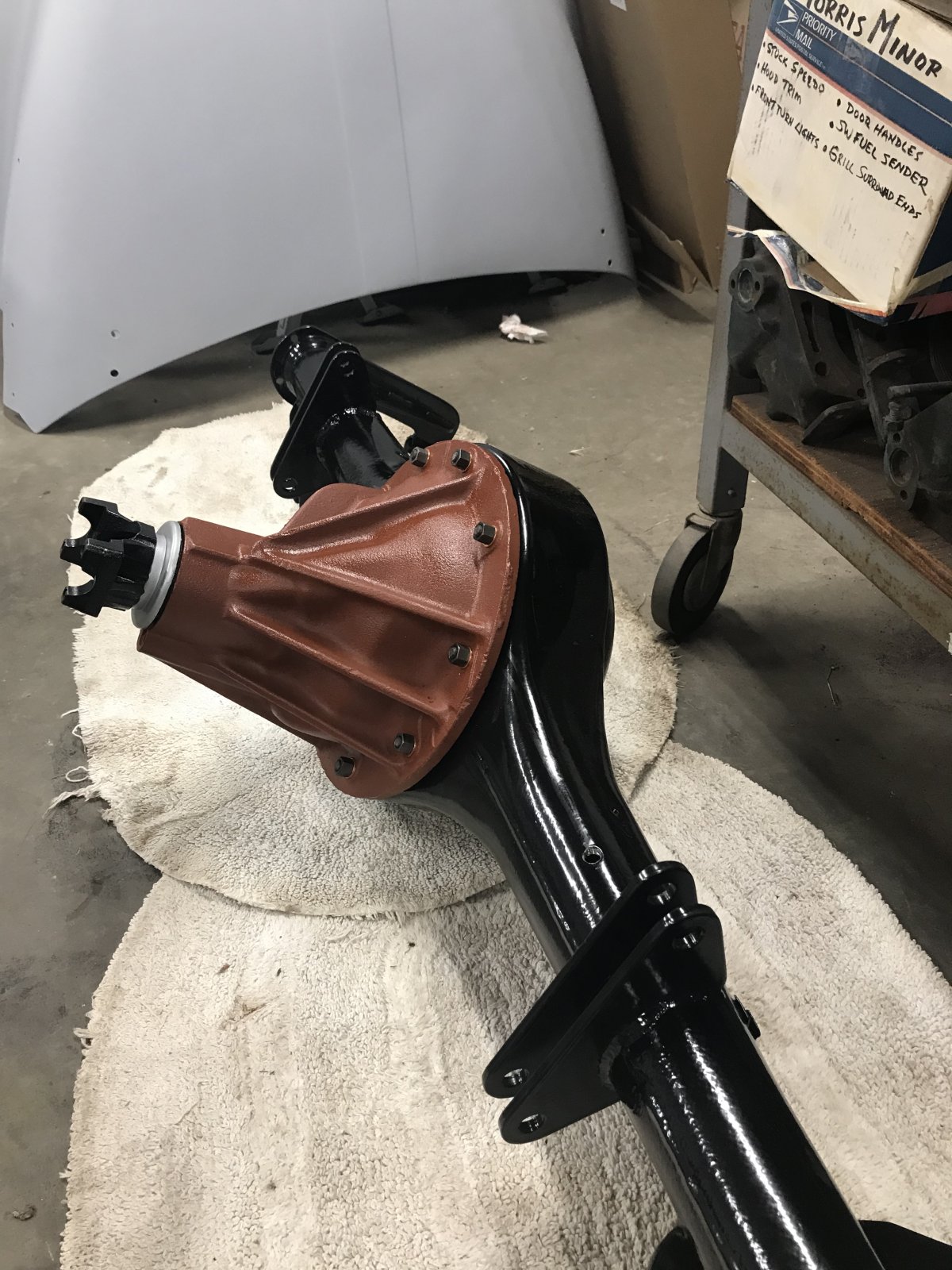

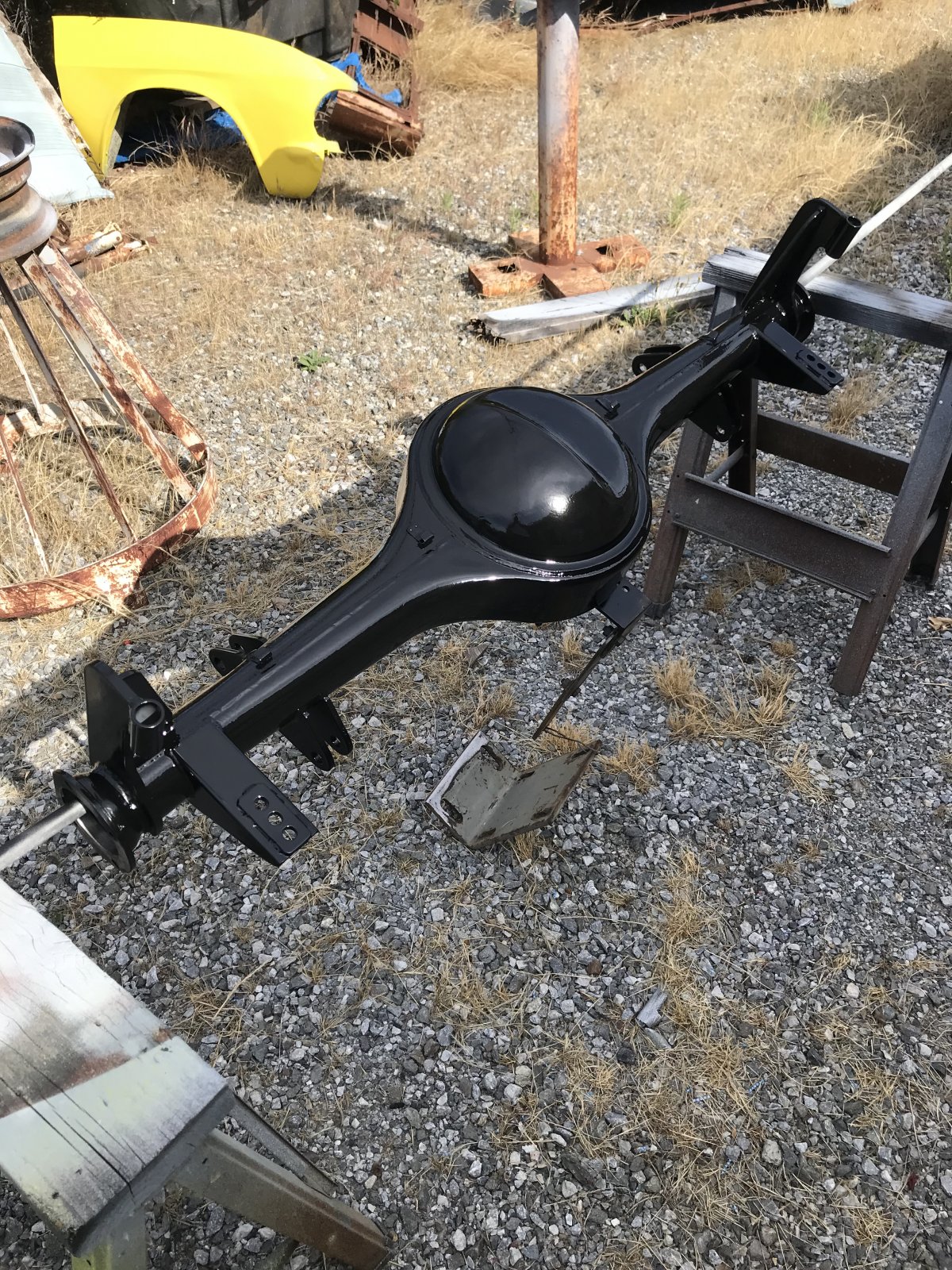

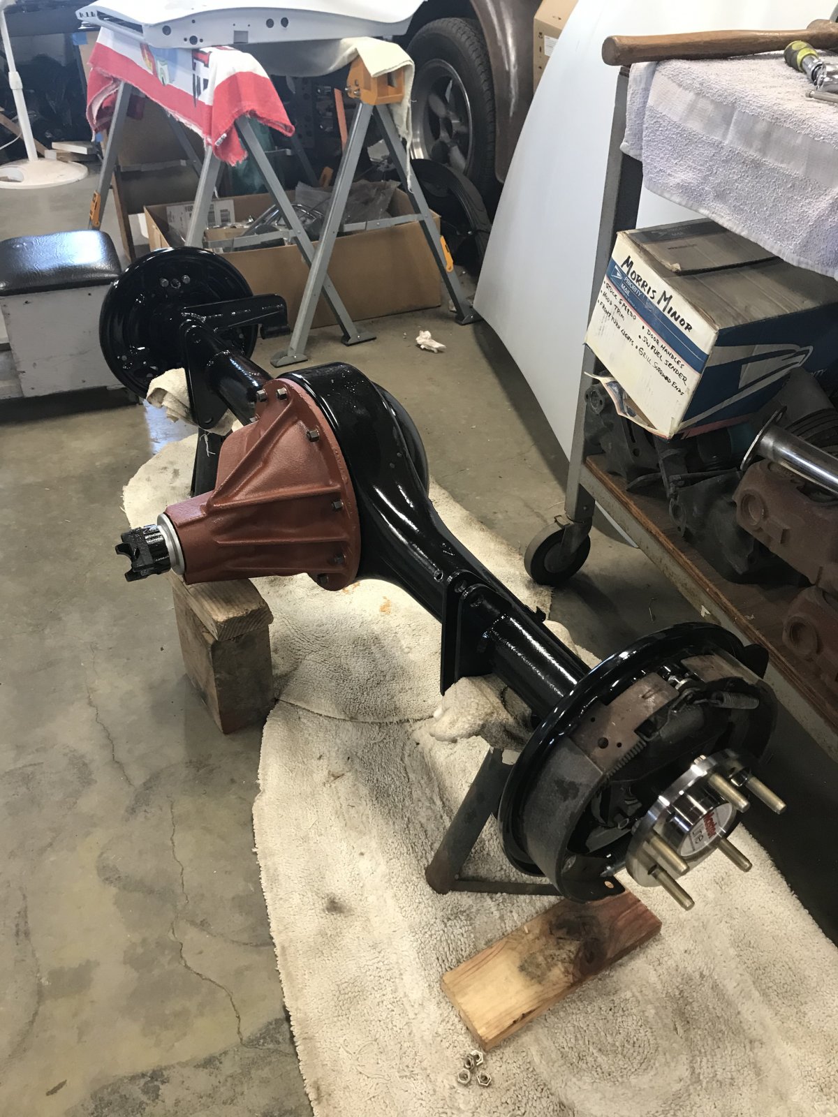

    I also prepped and painted the narrowed ‘60 Olds rear axle housing. Once again, good old Krylon Rust Tough, only gloss black this time. (The yellow fender was a color test for my Morris Minor woody that I need to paint)
    Now to find and paint the 3rd member…. I know they are in here somewhere.

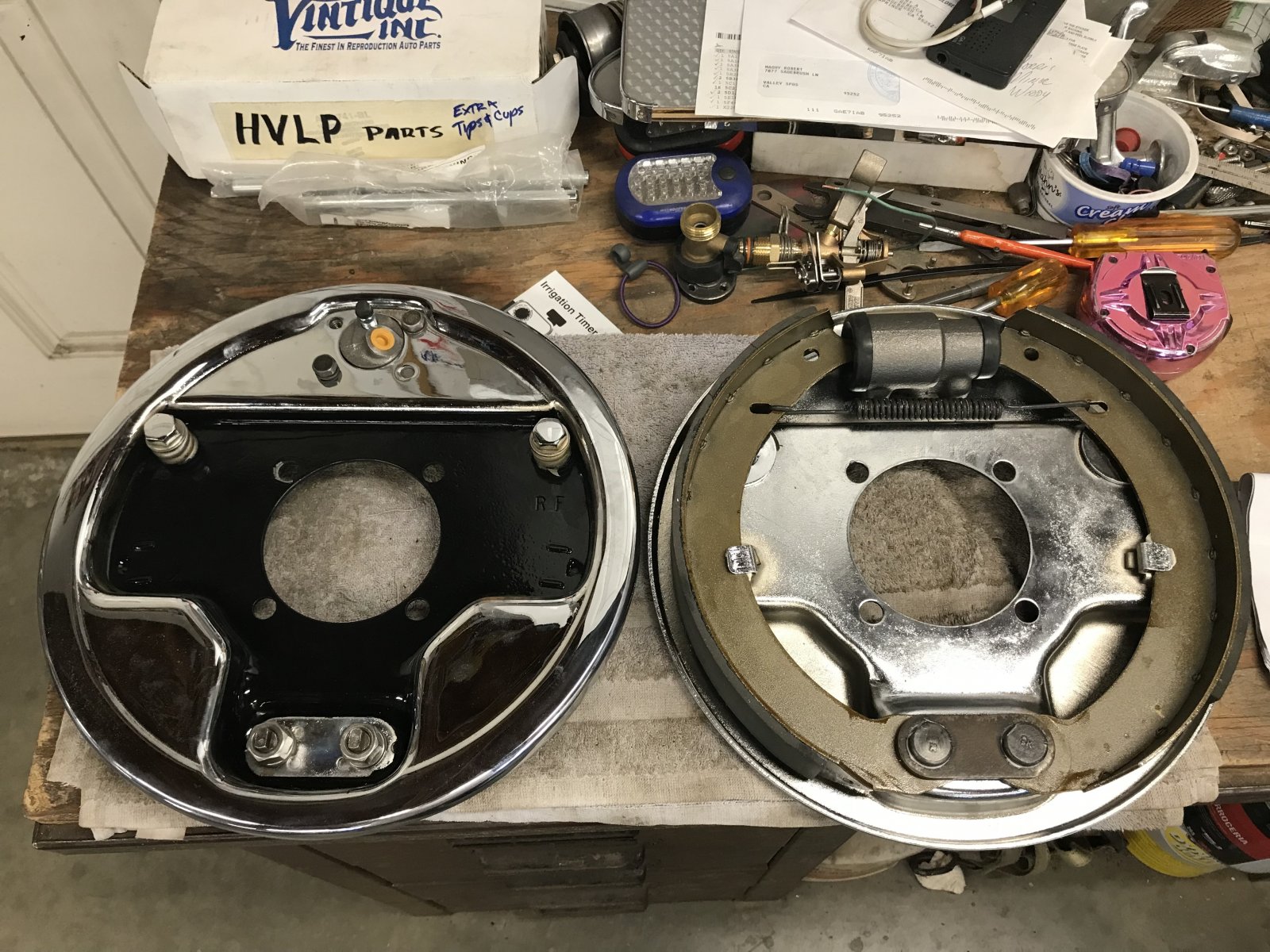

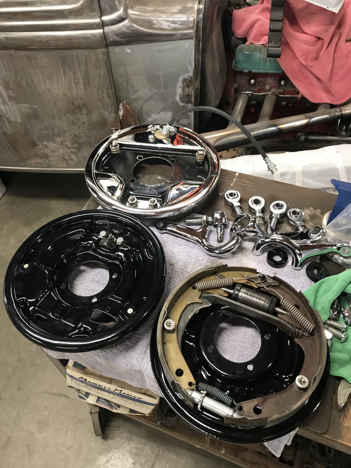

    So where were we? Oh yeah, rear end. I had the rear backing plates powder coated when I dropped the front drums off to be sandblasted. I’m not a big fan of powder coating but he saw them sitting in the van and offered, so I did it. I rebuilt the wheel cylinders and reassembled everything. The brakes and drums were almost new when I bought the rear end so I just cleaned everything. I had to clean the PC out of the center hole and the mounting holes but overall it looks pretty good.

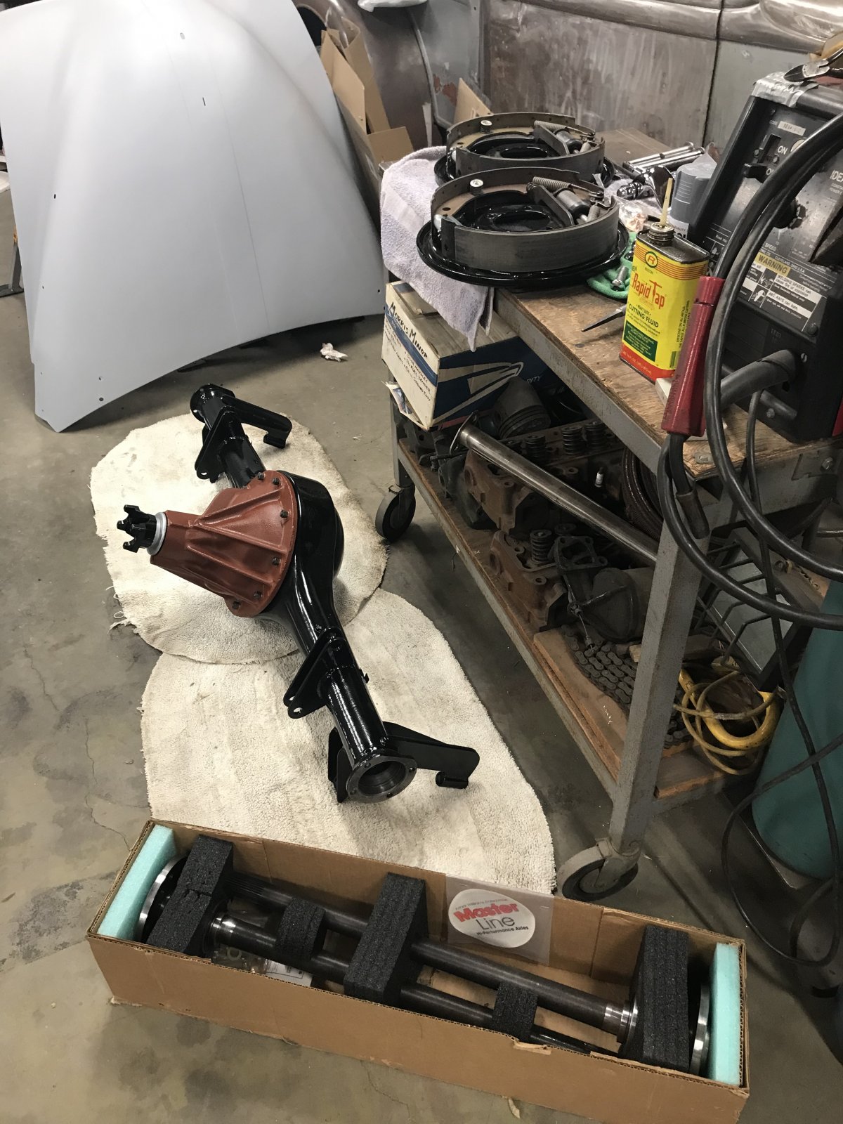

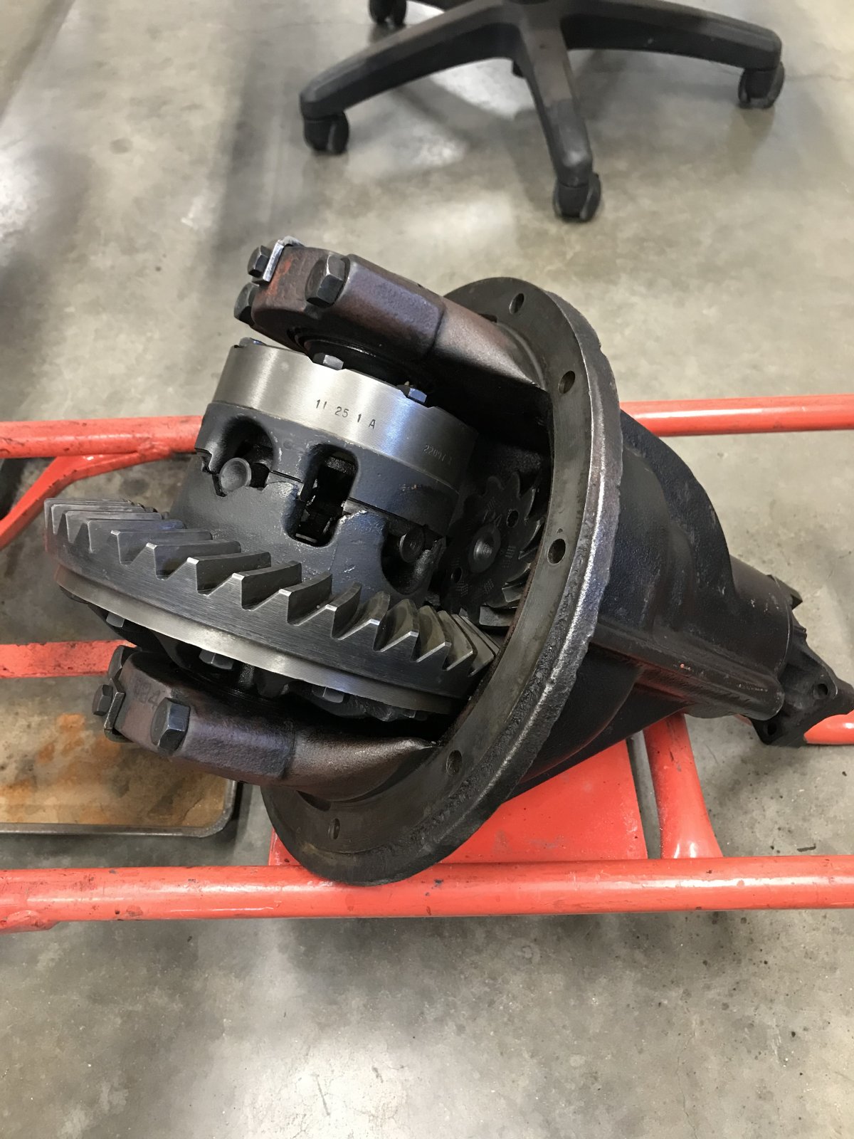

    I’ve collected several Olds/Pontiac 3rd members over the years. I’ve got 3.08, 3.23, 3.42 posi, 4.56 posi, and a 5.57 spool. All bagged and labeled stashed around the shop. I got out the 3.42 posi and inspected it but then I started thinking about driving my ‘56 Chevy (3.55s) and my red coupe (3.70s) and of course the $5.49/gal cost of gas. The Hydro has a steep first gear and our local roads are all 45-65 mph, no stop-n-go city driving. So I decided to put the 3.42s back and start with the 3.08s. I found the 3rd member and opened the bag. It was an oily, crusty mess. Usually, I clean stuff up before I store it. Oh well.
    My red oxide primer was too orange and too flat to look right so I fogged on some clear to help get the factory looking color for the 3rd member casting. I chased the threads on the studs. A new gasket and the long factory nuts with new copper washers and we’re in business. I must have been holding my mouth just right, that big ol’ thing dropped right in first try.
    The posi that I didn’t use….

    The axles I ordered from Mark Williams worked perfectly. Being lazy, instead of pulling the bearings and the retainer plates from my axles and sending them to MW, I just had them include new everything. Well their competition bearing retainers are thicker than the stock Olds ones. I had cleaned and painted the stock retainer bolts and I was sure they would be too short. Nope, it all fit back together perfectly. I must be living right.
    I just need to clean and paint the rear drums.
    Done and waiting for drums….

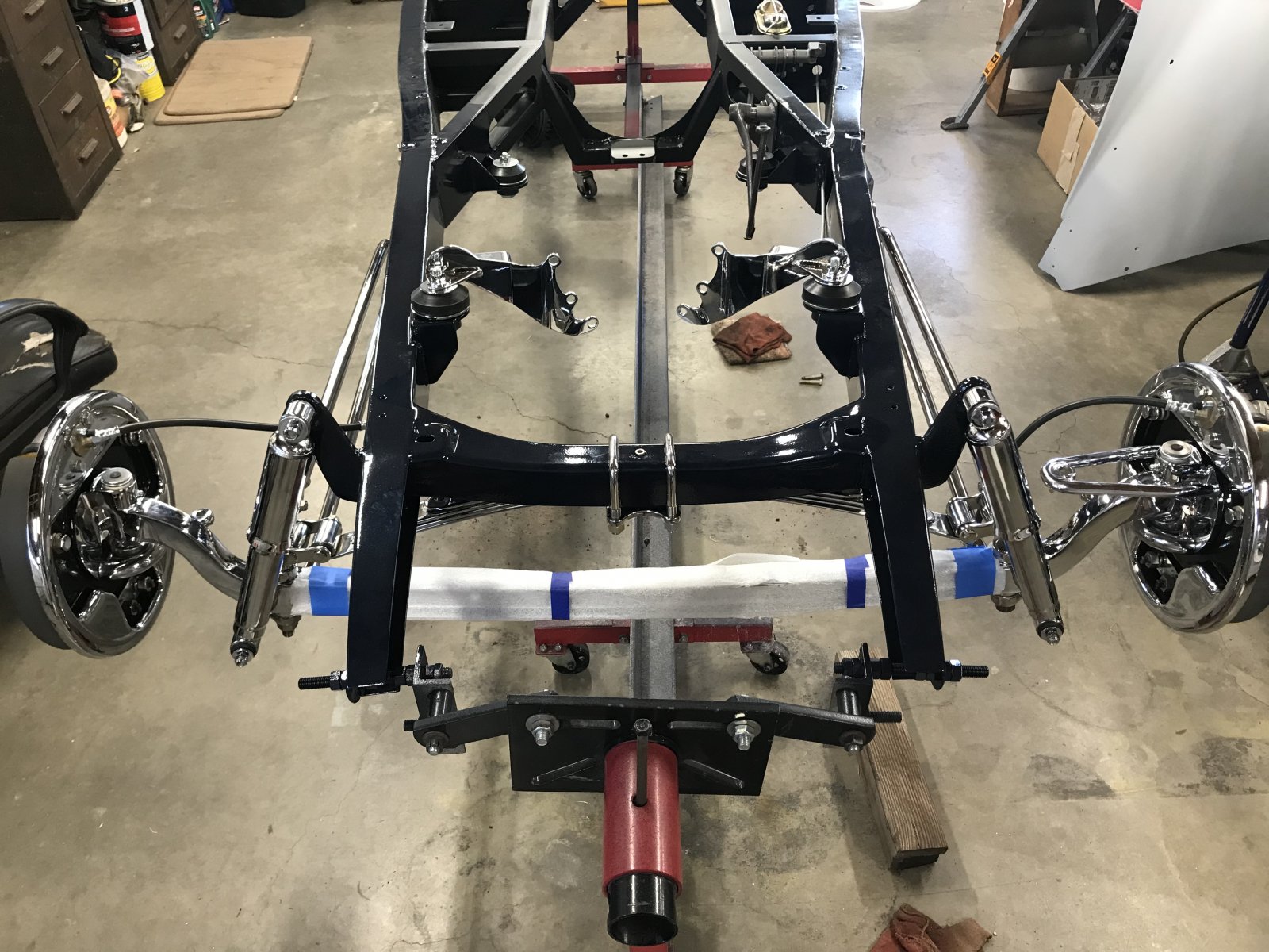

    Up front, everything is either chrome or polished stainless. I bought some chrome CPP spindles and had some steering arms chromed, including an old hairpin style steering arm and an old Pitman arm I had from a previous project. The spindles that came with the car had been turned down to accommodate a homemade disc brake conversion.

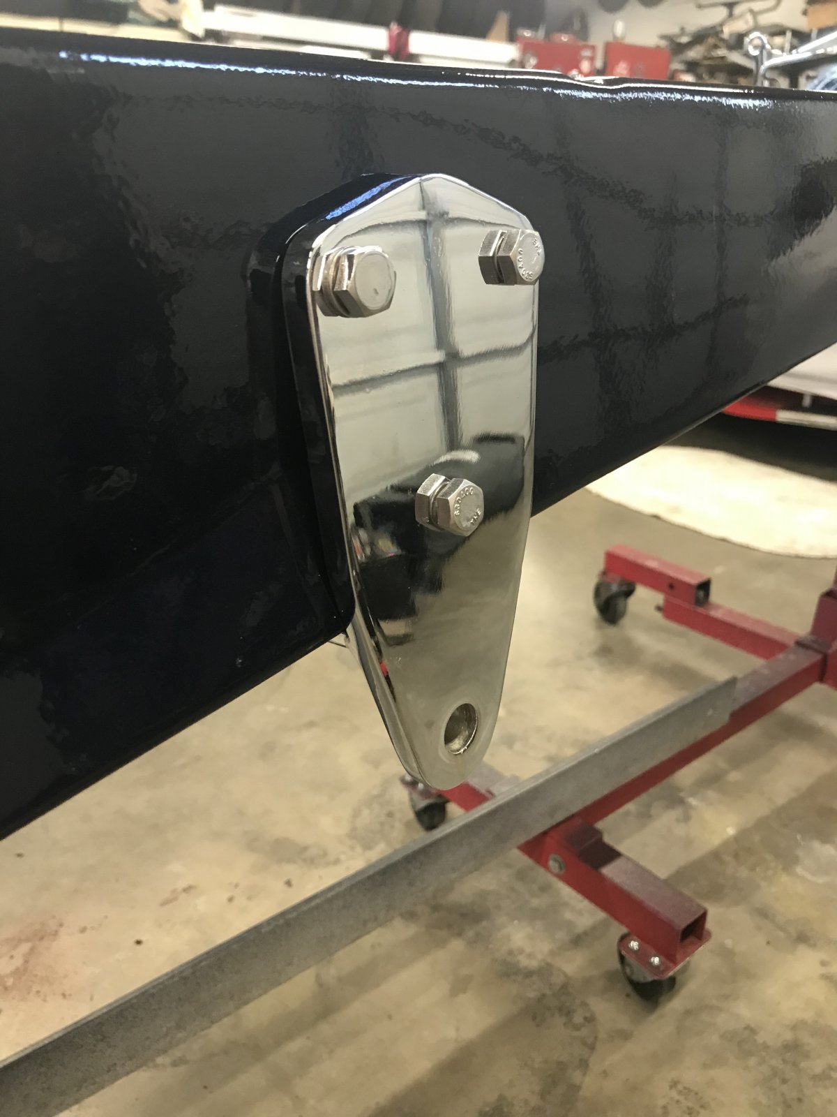

    I made frame brackets for the hair pins and they also got plated.
    When I started getting ready to assemble the mess, I found a pair of chromed stock Ford spindles in a box up in the loft that I forgot that I had. Well I’ll be. I guess I’m not as organized as I like to think I am. Lol. They didn’t have king pins so I tried one of the CPP pins. It seems like they put new bushings in the Ford spindles but never reamed them. So I ordered king pins and waited.
    While waiting, I put it together with the CPP spindles. The new spindles with “fitted” king pins had a ton of slop! I checked the axle - all good. There was an extra set of bushings in the box that the CPP spindles came in. Now I know why. I’ve used CPP spindles many times and have never had a problem.
    I have the proper piloted reamer and have done many king pins but I decided that I need to visit my friend Willy at the machine shop and send a little money his way. He knocked them out on his Sunnen machine.
    Here’s the hairpin brackets and the first mock-up with everything.

    I was ready to drive it this summer, unfortunately the car wasn’t ready! I’ve just gotta find a faster shop! This guy is slow as winter molasses.

    The front brakes…..
    As mentioned, it had disc brakes and I’m not a big drum brake fan, but they are a big focal point on the front end, so I scrounged around and I had enough stuff to put together a good set of Early Ford brakes so why not give them another chance. Besides, chrome E. Ford backing plates with the painted recess are what Sam ran and they take me back to my first couple of cars.
    CD784FE6-288E-416A-A10A-C2F5EDFC126F.jpeg 77E6B9ED-DBA1-4A79-A00F-53E531BD4DE2.jpeg
    Funny thing, my ‘33 5w had these same brakes and the same rear end. I drove it everyday back in ‘68-‘70 including making passes at Lions every Wednesday and Saturday that I could. It usually ran low 12s with a best of 11.86 at 117. When I took the front end apart to install a Corvair IFS w/Camaro spindles and brakes, I found out that the front wheel cylinders were frozen solid with corrosion. All that time I was stopping with rear brakes only! It seemed fine to a young guy more interested in going fast than stopping!

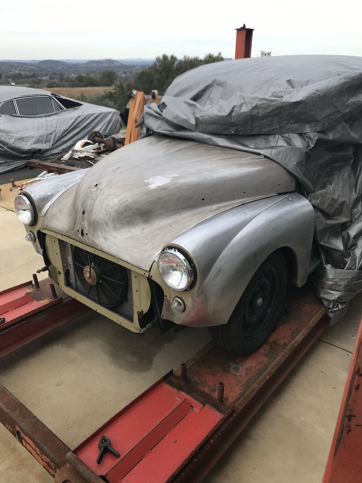

    And strip and paint on our Morris woody….15 y.o. primer had to go.
    I’m in desperate need of drip rails for this one.
