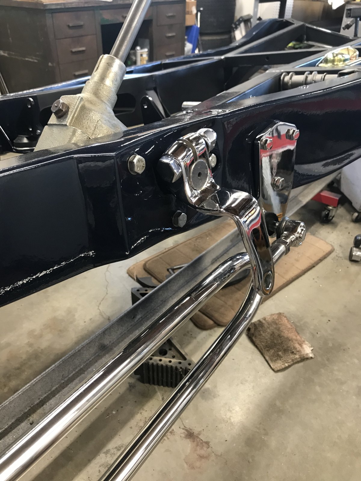

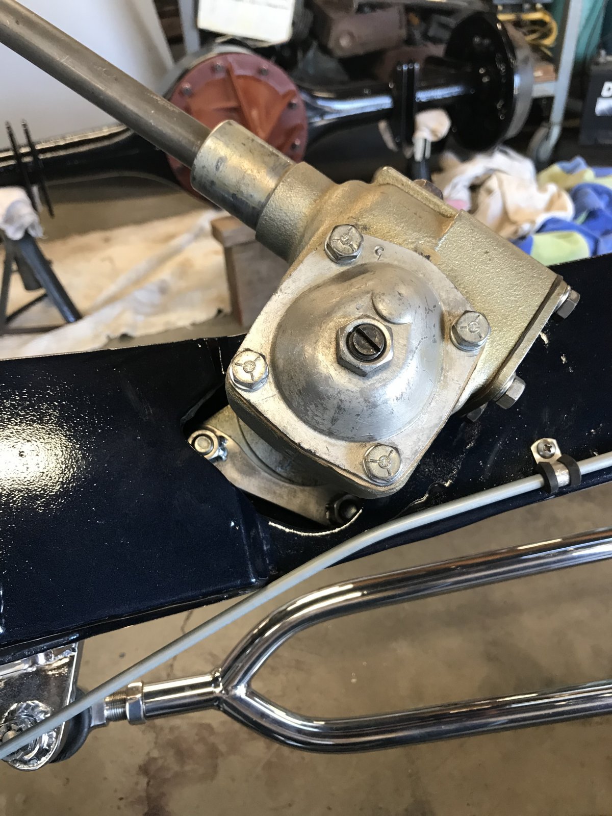

    I only had a little time in the shop today but I got a couple things done that were bugging me. A couple days ago, I installed the steering box temporarily so I would know where the brake lines could and couldn’t go. I’m glad that I did, my initial brake line idea would have made installing and removing the steering box impossible. Especially with the starter in the way. The steering box came out of my ‘55 F100. I made the hole in the frame just big enough to get the box in and out with the car completely ***embled. I found it nearly impossible to get the nuts installed so I made a “nut plate” that I will attach to the steering box flange to make life easier.
    You can just barely see the nut plate down in the hole….
    I had a nifty old fabricated Pitman arm that came with a steering box that I bought years ago. I found that it fits the roadster perfectly so I put it in with one of the chrome shop batches. I love using old “heritage” parts….
    I don’t remember where but I ordered a new drag link because I didn’t have anything nice to make one out of. Somehow, I managed to order one that was 2 1/2” too long. So I tapped it deeper and cut it off. I squared up the end in the lathe and now it’s right.
    Details, again. The primer and paint closed up the recess I provided for the rear steering box mounting bolt. A socket on a standard hex doesn’t fit without messing up the paint. So I looked through my stash of old aircraft 12 pt. bolts but I didn’t have the right size. I ordered some from ARP, ($$…ouch). I’m not sure that I like the look. I’m thinking of using good old hex heads and just using the 12 pt where I absolutely have to. Am I being too picky?

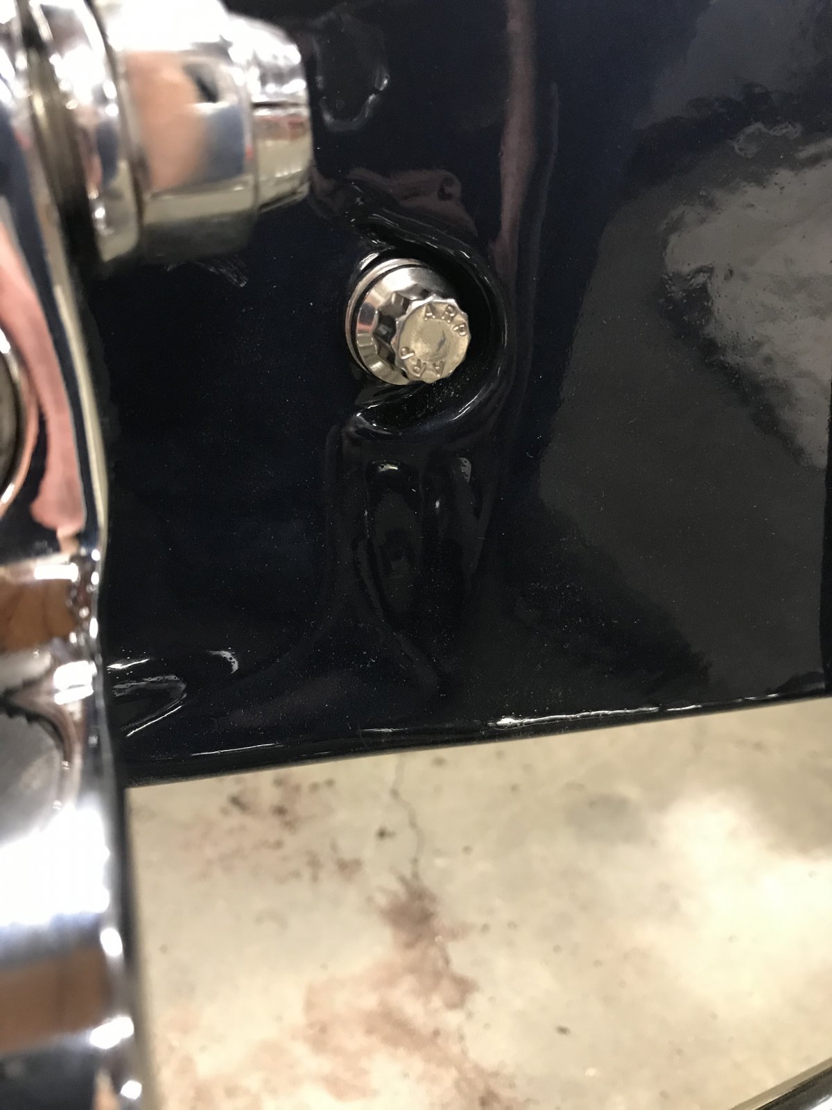

    I painted the inside of the frame with semi-gloss black Krylon because I was sure that I would need to drill, cut or weld on it somewhere in there and I could easily touch it up. Well, sure enough, I didn’t leave a path for the rear most brake line to get to the rear end. Oops.
    No sweat, a little touch up won’t show….

    My 7/16 stainless hex bolts for the steering box came today, so while the touch up paint on the backing plates was drying I decided to polish the new bolts and see how they look. Much better. I even managed to use a hex head in the recess where I didn’t think a socket would fit. I ground down a cheap socket and it worked.
    With a 12 pt in the recess….
    With all hex heads….
    Tomorrow I’ll attach the nut plate to the steering box and paint it. I’ll polish the washers and install the whole mess. Probably not for the last time though.

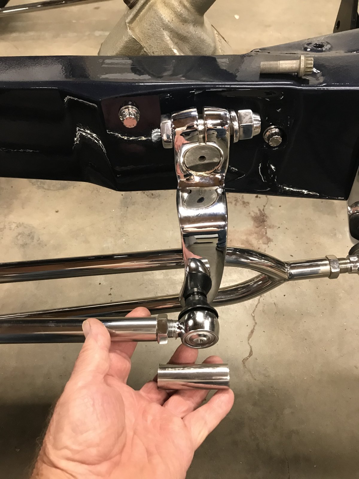

    I also installed the shocks, and found that I didn’t make real spacers for the lower mounts. So I made some from 1 1/4” stainless rod. I’ll hit them on my homemade polisher before I install them.
