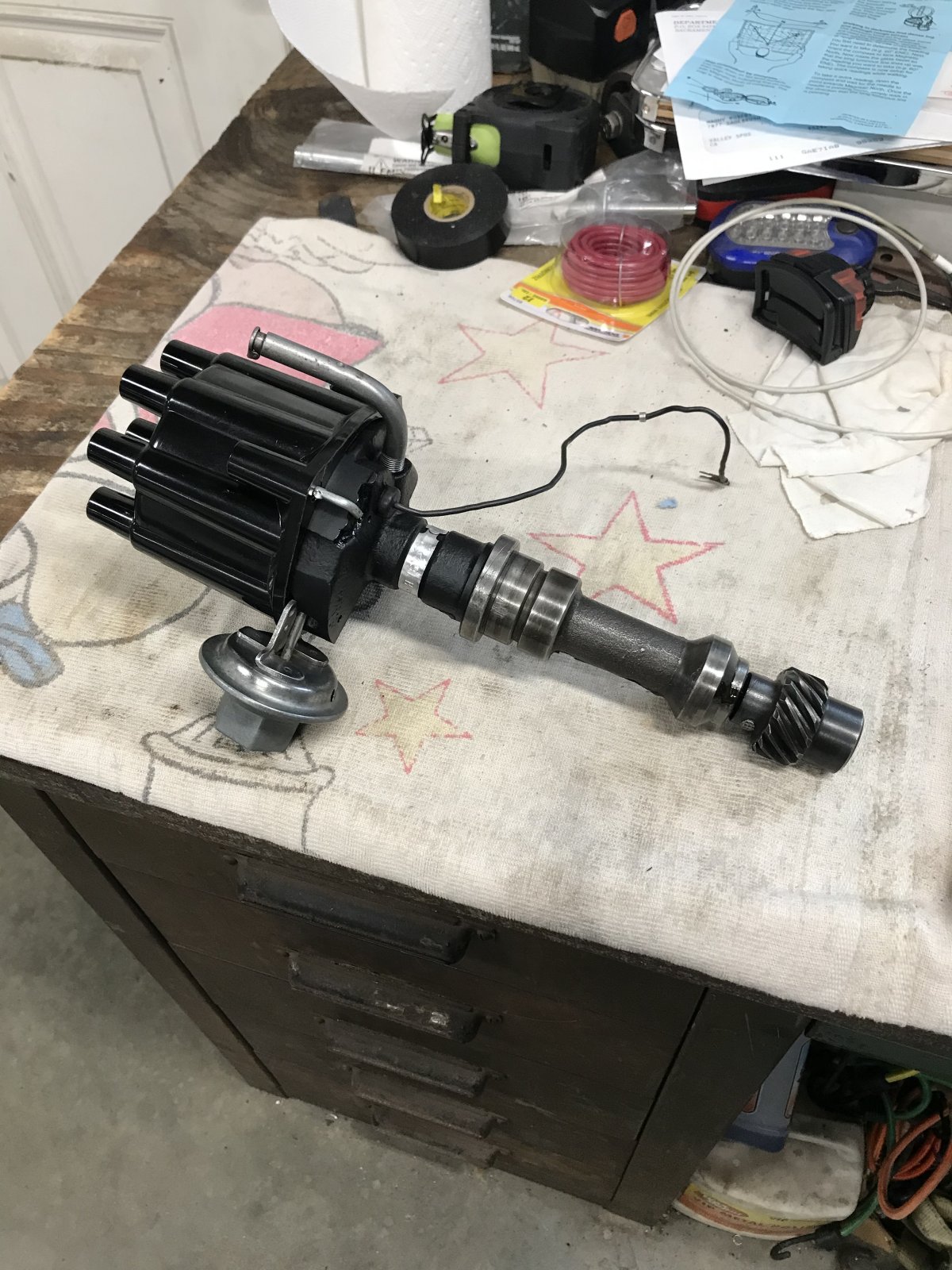

    I’ll install the DuCoil distributor and the 6x2 intake after I run in the engine some.

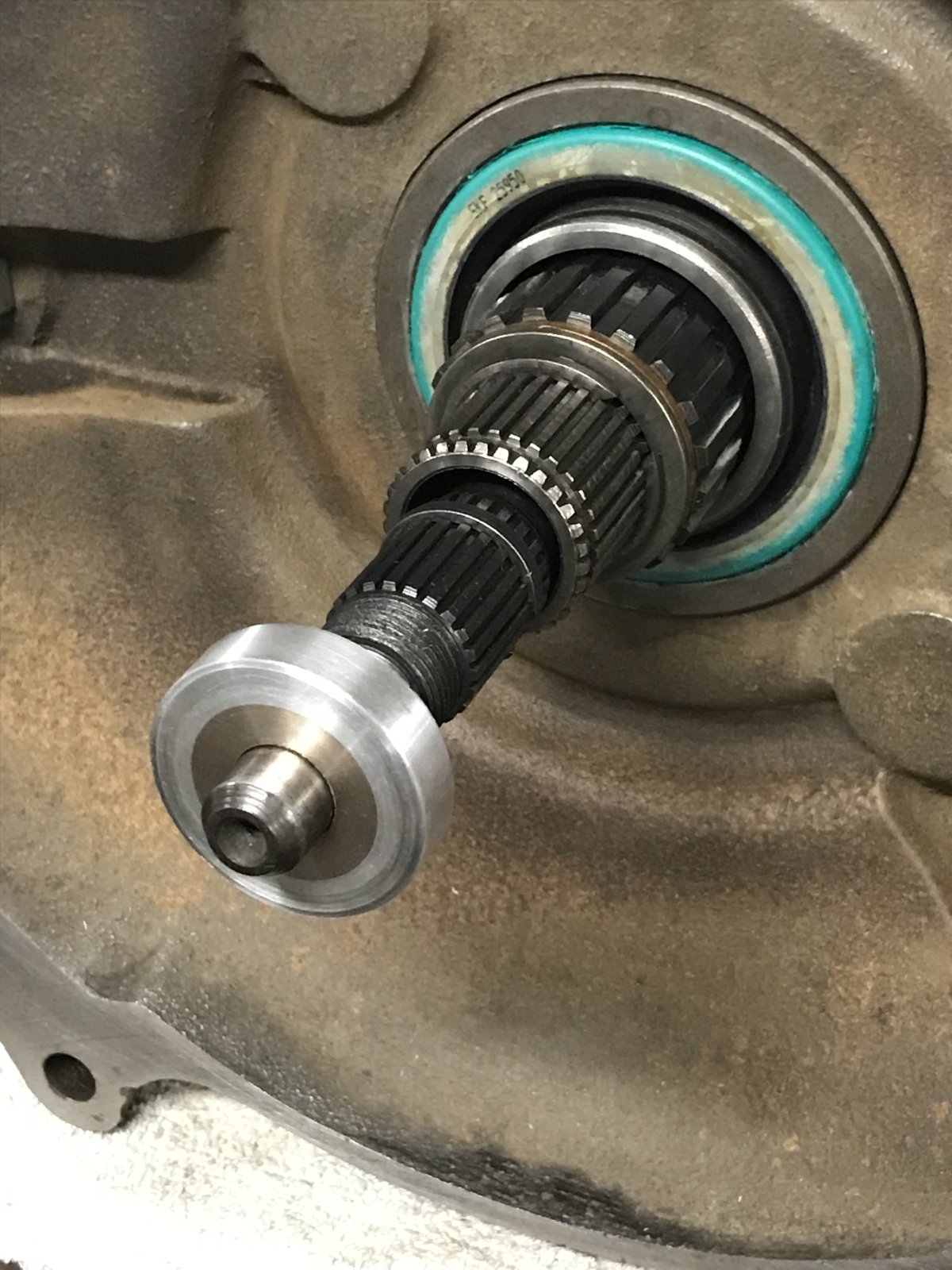

    I got my hybrid pilot bearing back from my friend Willy’s machine shop. I sacrificed my lathe power outlet for my new mini- splits so I could work during our 100+ summer days. I need to rearrange the north wall of my shop so I can move the lathe down to the other power plug but I’m lazy and besides, my buddy likes to do little oddball projects, so I gave him a drawing and let him have at it. We settled on a standard Chevy bushing with an aluminum adapter ring.
    Just a quick fit check, I’ll install it tomorrow.
    I'm not sure about the depth. I’ve seen some strange Olds pilot bearings. I’ll do some more dimensional checks tomorrow and hopefully it will go together well.
    Olds guys; note the plate that I made to mount the extended Olds block onto my old engine stand. It moved the load closer to the head/pivot so it’s not so quite so tippy. Even though it’s a big old heavy duty ‘50s or ‘60s stand, it was still somewhat unstable when I had the complete engine on it during dis***embly. It’s better now but you still have to be careful moving it around.
    It’s supposed to rain all weekend, so if all goes well I’ll have the short block and transmission in the ch***is this weekend.

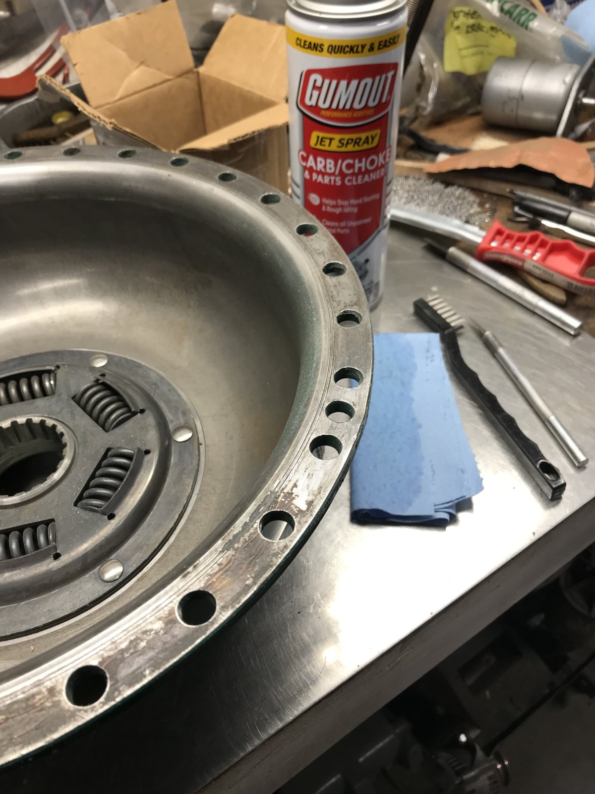

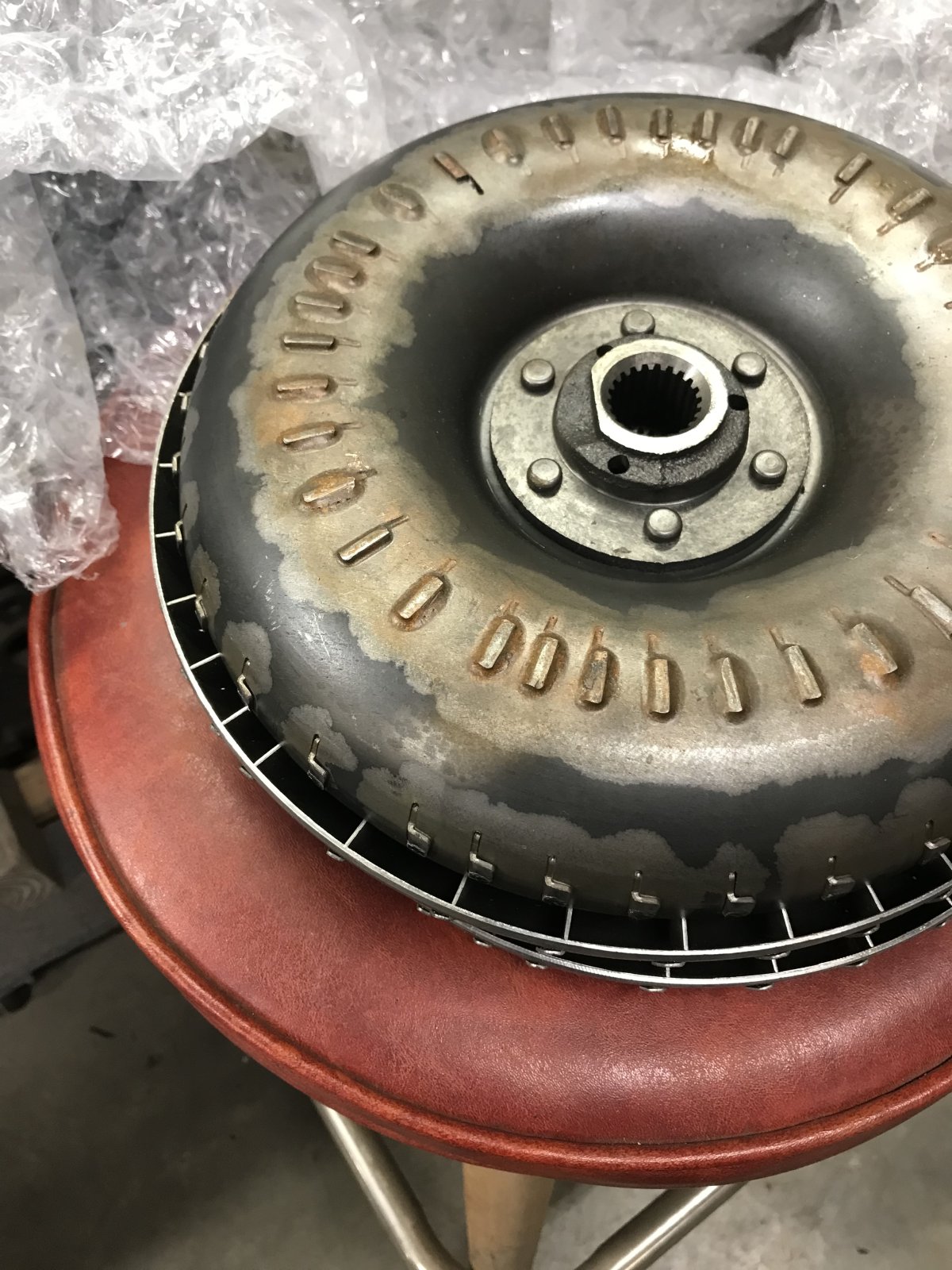

    Well, as usual I didn’t get as much accomplished today as I hoped. We had torrential rain and wind starting around 8 this morning. The power went out about the same time as I was making coffee. It let up just after noon so I went out and set siphon hoses running on my boat, the bed of the Stude, and then swept the water out of the shop. No power until around 3:30.
    I got out the ‘55 Olds torus ***embly and sure enough, the guy I bought it from didn’t include the spring, spring seat, snap ring or the big nut and washer. Luckily I found my spares. I found the flywheel bolts and the torus cover bolts so I have everything.

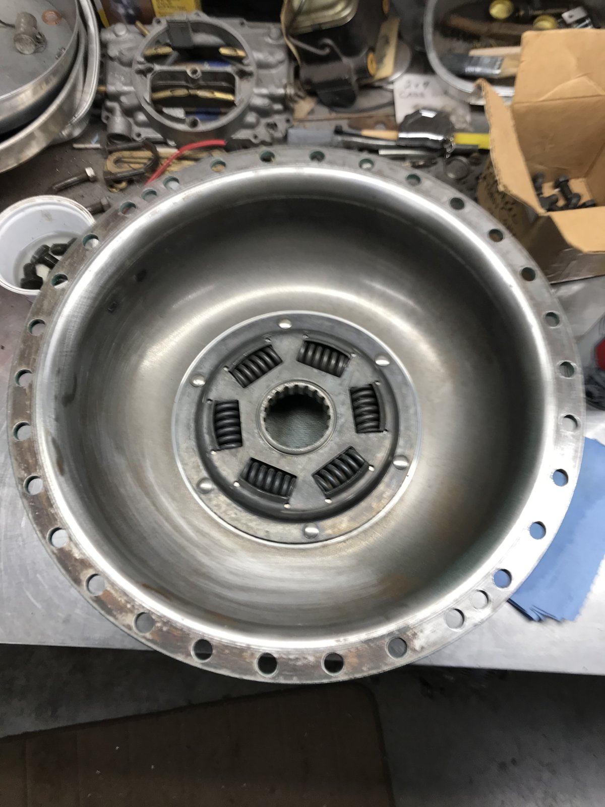

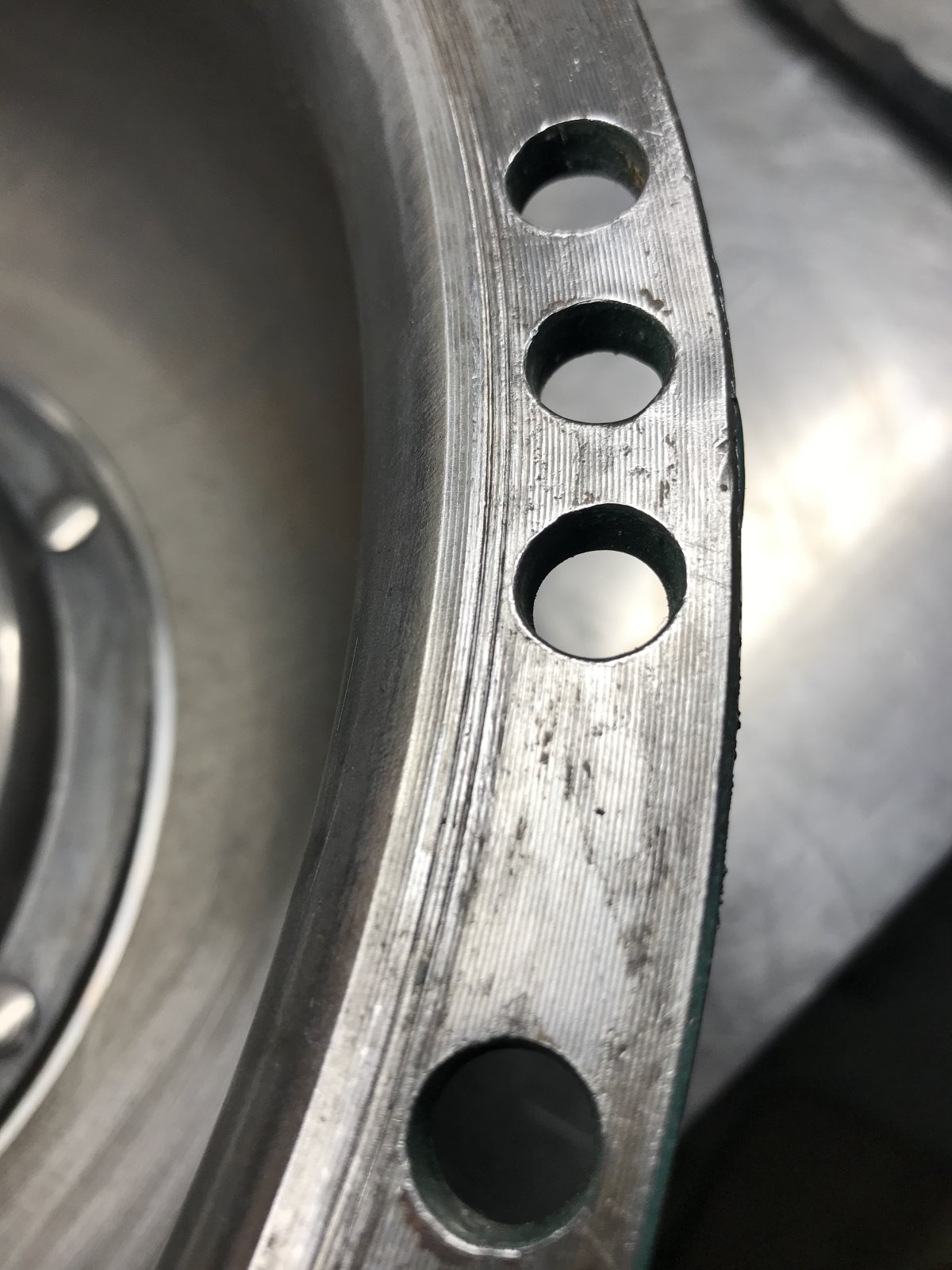

    I cleaned the flywheel carefully. It forms the other half of the torus cover and the transmission side is flooded with ATF, so the crank surfaces and the outer sealing surface have to be clean and smooth. Likewise, the torus cover sealing surfaces. The last guy used Permatex hardening sealer on the torus cover seal so I had to s****e all that off.
    It’s about half done here. I found that if I soaked a rag with carburetor cleaner and let it sit on the sealer, it got brittle and s****ed off more easily.
    Here you can see the serrations that help it to seal. Any little piece of old sealer or nicks can make it leak.
    It’s half done here. You can see the springs, like a clutch disc that help make it smoother acting. Before installing it I’ll need to thoroughly rinse that area and blow it out. Any debris can get into the trans and into the valve body.

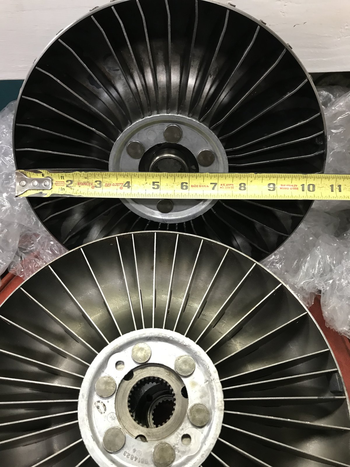

    I’m posting some extra photos and details for anyone who might be curious about these old transmissions. This is the difference between the Chevy torus wheels and the Olds version.
    The Chevy is the smaller one.
    Part of me wants to use the Chevy wheels in the Olds cover hoping for a little more stall rpm, but everything I’ve read says that the Olds wheels provide 1800 rpm stall speed. That should be ok with my mild Ross Racing cam. And I don’t exactly relish the idea of draining the trans and swapping out the wheels if it doesn’t work like I want it to.
    Now that all of the parts are accounted for and clean, I’m hoping to ***emble this mess tomorrow.

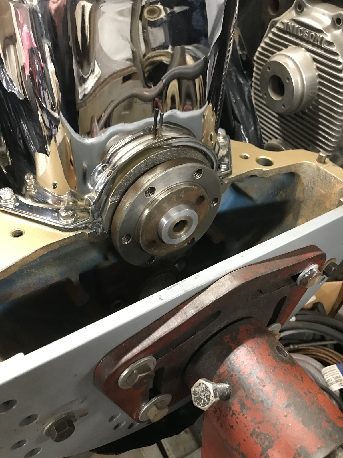

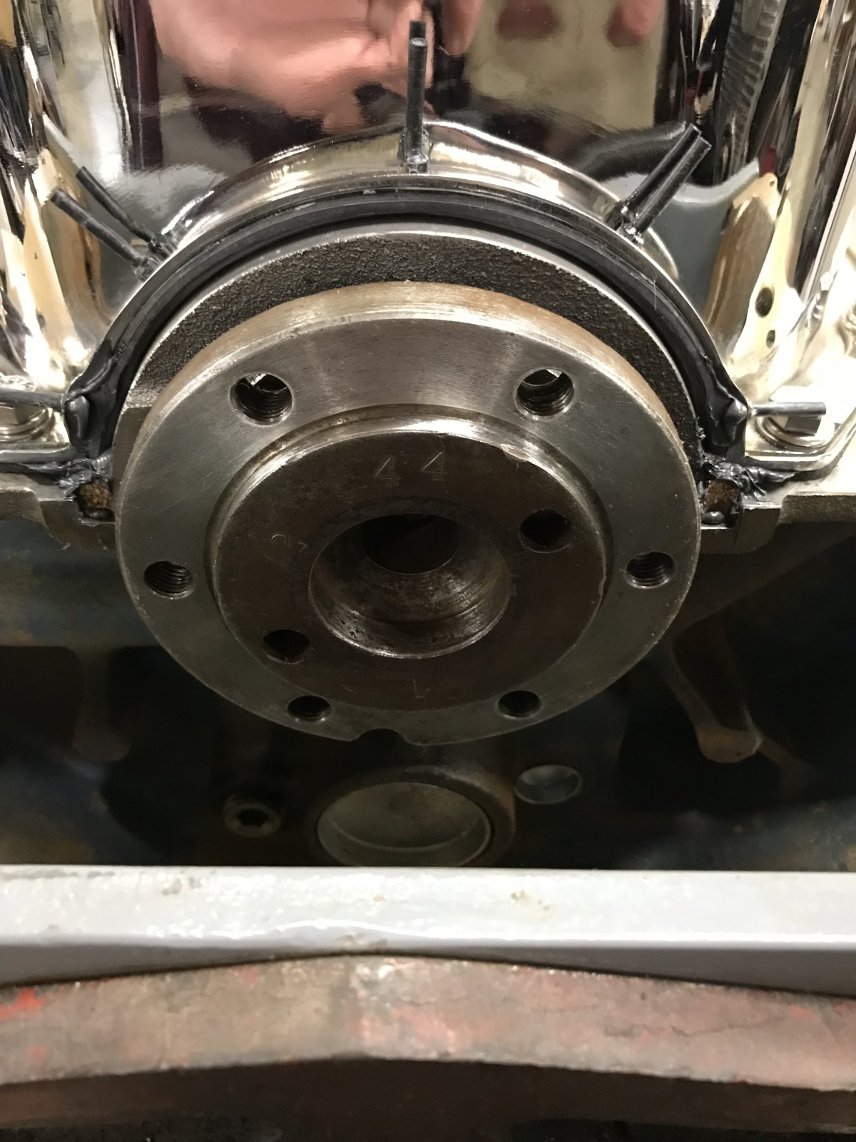

    Two steps forward and…. Well, you know that old saying. Check out the last photo on post 159. Notice anything ugly, Walt (@vtwhead) did. He sent me a PM and saved me a bunch of embarr***ment and work. The rear pan seal had squeezed out. Actually, in and out. I don’t know what happened to the little nubs that are supposed to help keep it in place. No, they aren’t in the engine.
    It was really a mixed blessing, I had also forgotten to install the new oil pressure relief valve spring I got from Ross Racing. It’s in there now and the pan’s back on with the seals installed properly.
    Much better…. Thanks Walt!

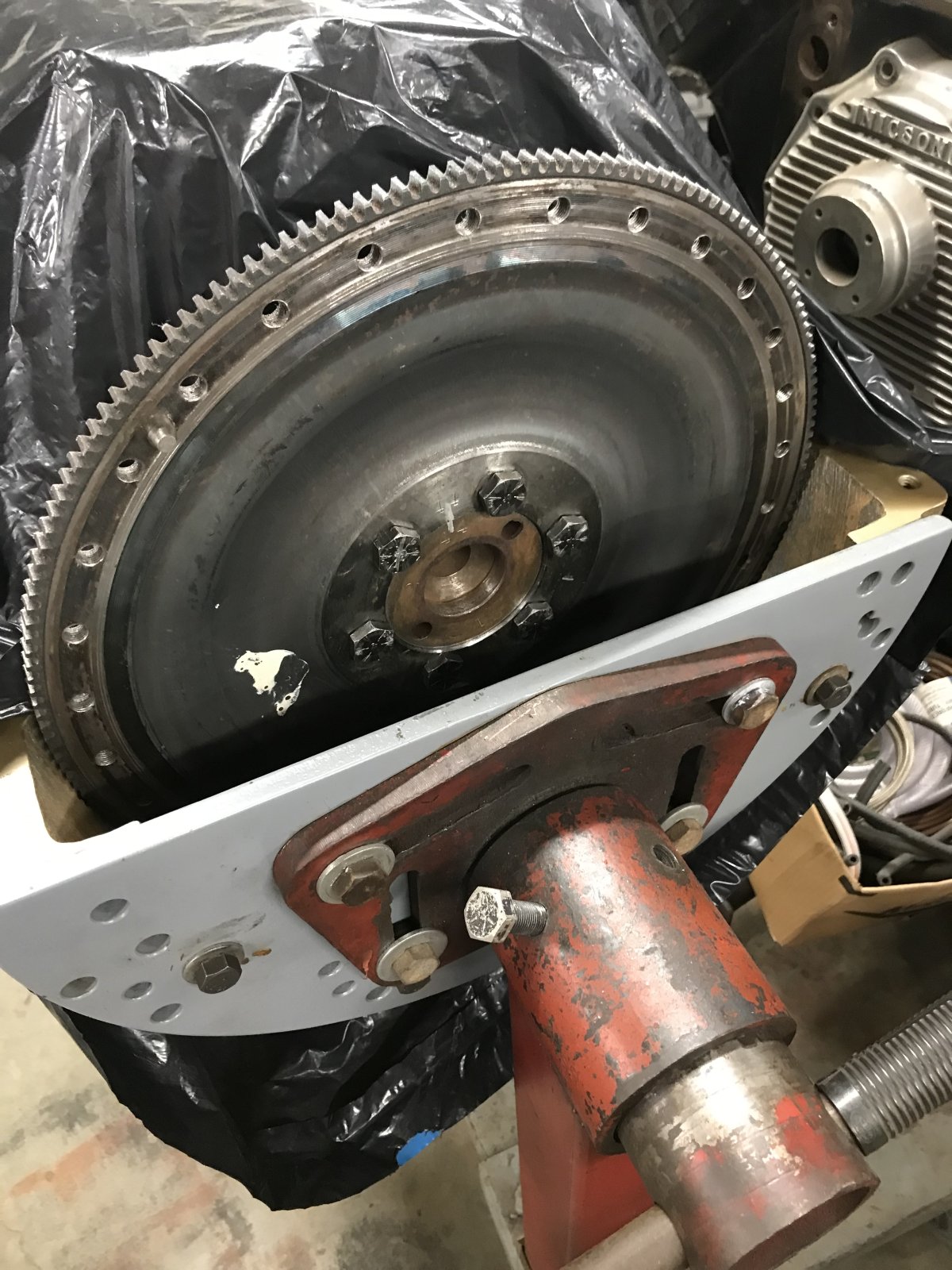

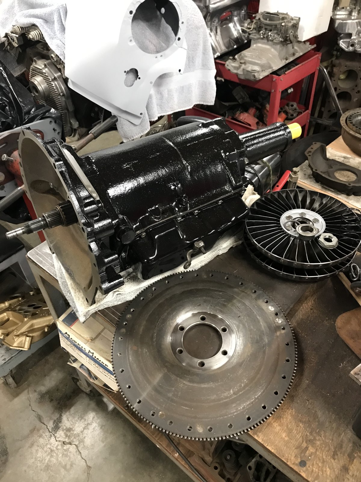

    I got back on track getting the engine and trans ready to mate up. I cleaned the flywheel and installed it with sealer on the flange and bolts.
    I put off installing the pilot bearing until the engine is off the stand, I’ll have better (straight) access.
    Then I did a final cleaning of all of the torus parts and ***embled it.
    So hopefully I’ll get them mated up tomorrow and into the ch***is.

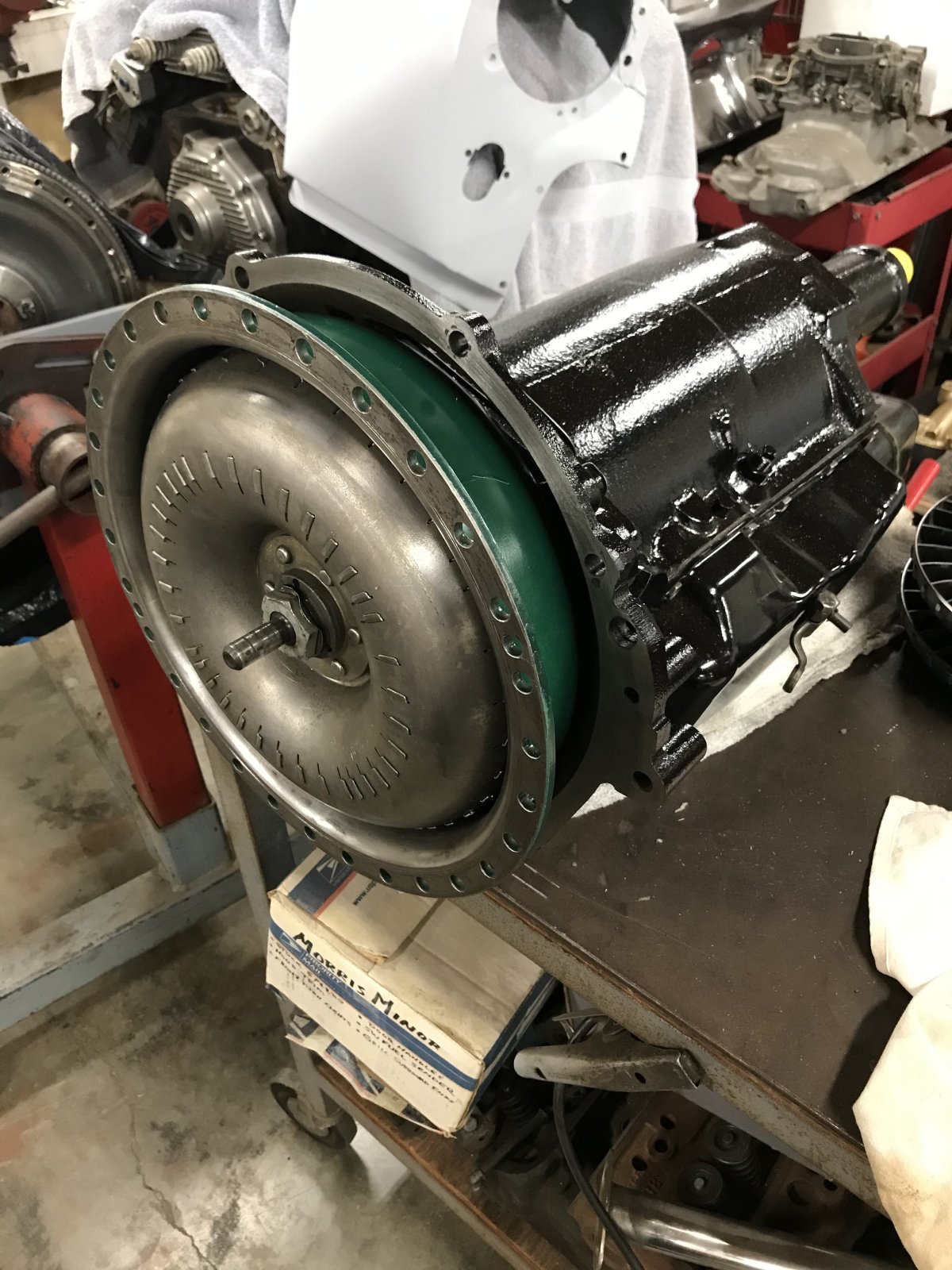

    I used good old Gasgacinch and a small brush, trying not to get it anywhere but where it's needed. No problem.
    The burning question: Now that they don't sell Toluene to the general public anymore, what thins Gasgacinch?
    One final wipe down and the fun begins....
    I put the transmission on a small car dolly so I could roll it around easily, the engine is hanging on the cherry picker with a ratchet strap set up so I can easily change the tilt. The torus cover doesn't fit through bellhousing surface at the back of the block, the engine has to go up and over the torus cover flange. Then, line up the pilot, two dowel pins on the flywheel and the bellhousing pins, and push. Did I mention that this all happens while lying on the floor next to it. It went together with no drama, just as Oldsmobile intended.
    Next, you install a million 3/8 bolts. I got to use my handy-dandy flywheel turner. Here you can see the dowel pin (there's two - 180 degrees apart) and the torus drain plug. Remarkably, all of the bolts went in, no problem. Keep turning and slowly cinch them up.
    Torque them up in increments - more turning, still lying on the ground. All torqued and retorqued.
    Now there's a milestone (for me). As I got up and put the torque wrench away, my mind decided to screw with me. Did I torque the four big bolts that hold the little bellhousing to the trans case?? Aw, come on....
    A few minutes later, I remembered cleaning the surfaces and the bolts, applying some Loc***e and torquing them with my big old Harbor Freight torque wrench. Whew. I hate those moments.
