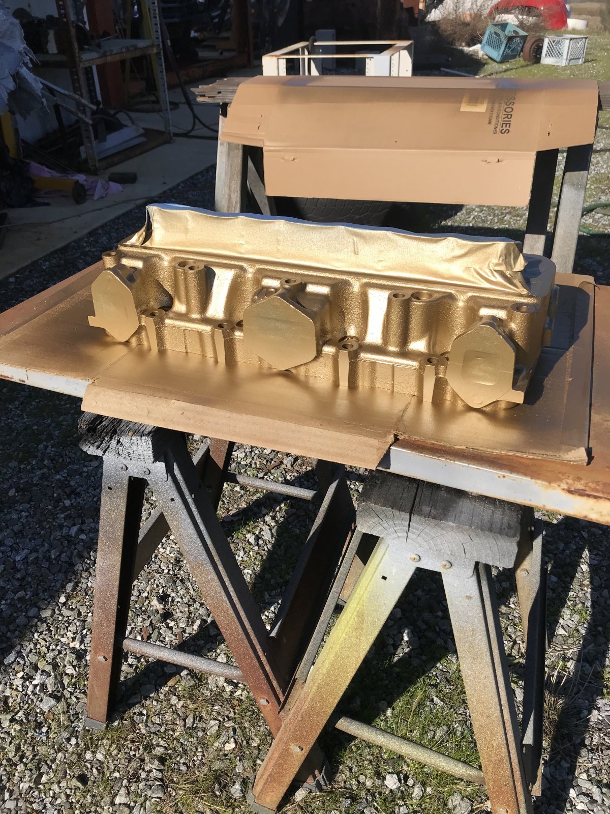

    With the short block off the engine stand and mounted in the ch***is I could finally put the heads on. But first some paint. Quite a bit of masking. I was a little concerned that the new cans of paint I bought might not match the stuff I painted a while back. I did recoat the block with the newer stuff but the timing cover came out a little lighter. Everything got four coats, a tack coat and three color coats.
    I had washed the greasy head bolts but they needed some time on the wire wheel. Damn, there’s a lot of head bolts. Finally, got them installed.
    Check out the chrome head bolts. I know, pretty show car-y, but I’ve always wanted to do that.
    Unfortunately, my beautiful chrome valve covers have a problem, the plating on the inside is flaking off. The outside is fine. I scrubbed the inside with steel wool and stainless brushes but I can’t run them as they are. I’ll take them back to the plater and see what he says. But for now, after a good scrubbing, I put a coat of grease on the inside surfaces to make sure no contaminates get in my new engine. I have a nice set of Edelbrock finned aluminum ones but they need a good cleaning and touch up buffing. Besides, Sam ran this type on his car, so I’m partial to them.

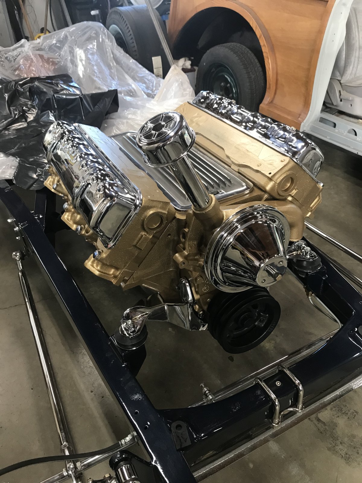

    I also brought back the Rochester 4 Jet that I got from Walt (Vtwhead). I had rebuilt it and used it to start up the other Olds. I mounted it on my spare 4 bbl manifold. I'll use this carb/manifold and the refurbished stock distributor to do the initial start-up and break-in on this engine.
    I have the DuCoil and 6x2 intake for the final version, but I don't want to fight that fight at break-in.

    Looking nice Bob! What is the hole in the front of the valley cover for?

    I'm a little behind on this thread. I guess the hole is for an aftermarket breather. Maybe a Moon?
    That valley cover won't work with a stock intake so I needed to get out the stock one I had chromed.
    Well, now I am confused. The manifold hits the stock valley cover too!
    This engine had a two-barrel manifold on it when I got it, and it was all together except for a few accessories. I do have a bunch of stray Olds parts but no other valley covers. I bought this manifold off of eBay years ago, now I'm wondering if it's really a '56 as advertised. I've haven't tried to bolt it onto anything until now. Arrgh....

    Intake is a 56 Bob but you need the 56 valley cover with the indent in it. 56 was the first year for the new valley cover and the lower heat riser runner. My memory is not what it used to be so I looked over on the Olds site and Charlie Jones ( in my opinion he is an expert on the Olds stuff) said this responding to a similar post which cleared my memory banks:rolleyes:
    The manifold you bought is a 1956.
    They changed the exhaust crossover in 1956 and it protrudes deeper down.
    As a consequence, the block top cover was re-designed with a depression in it.
    Your engine is either a 1954 or 55.
    You will need to get either a 54 or 55 manifold or a 1956 top cover.
    The 1959 cover is wider because the block deck height increased in 1957 with the 371.
    _Intake Manifold Issue Olds 324 - Cl***icOldsmobile.com_________________
    bchctybob, brEad, Anderson and 2 others like this.

    Thanks Walt. I need to scrounge around in my stuff and see if I can find the ‘56 cover. It won’t matter if it’s not pretty, I’ll only need it during the break-in since I plan to run the Drag Star 6x2 intake or an Offy 2x4 as a back up. It’s gotta be around here somewhere?
    So it’s a ‘56-‘58 only valley cover, earlier ones don’t have the recess and later ones are wider. Learn something new everyday. I couldn’t find my intake manifold casting number on the sites I looked at, I began to wonder if it might be ‘57-‘58.
