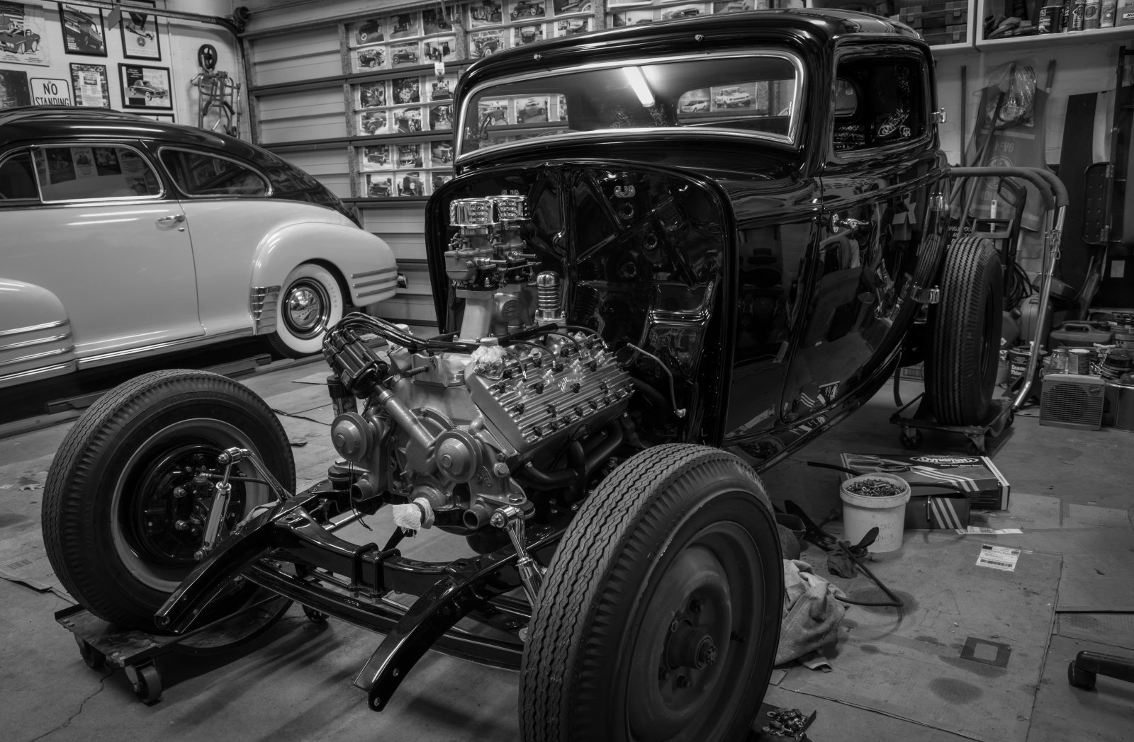

    Time for everyone's favourite part of a build...... Wiring.... !!
    Binga likes this.
  11. Jimmy Tee
    Joined: May 29, 2009
    Posts: 582
    Jimmy Tee
    Dynamat done, seat in, steering wheel in, battery tray in.
    Now time for some wiring and accelerator pedal setup.

  13. Jimmy Tee
    Posts: 582
    Jimmy Tee
    I picked up a door from the painter and fitted it today. Tomorrow I go get the other one.
    rcnut223, LOST ANGEL and 509garyd like this.

  16. Looking good Jimmy but damn you need to clean up around that car before taking a pic....;)
  17. Jimmy Tee
    Posts: 582
    Jimmy Tee
    Hahaha.... Yeah, I'm renowned as a messy worker. I spend lots of time shuffling stuff around so That I can start work.
    But I love how my hinges pop against the black, you can really see them now that the door is on. Lots of work went into these to get them to this lustre.

  20. Jimmy Tee
    Posts: 582
    Jimmy Tee
    All done and ready to go off to the Trimmer.
    Doors Dynamated & fitted, Door handles, locks and window regulators fitted, Fuse Box mounted and cables roughed in to front & rear. Accelerator pedal fitted.... Now to decide on an interior colour...
    And here is a look at my Tail Lights.... 41 Pontiac, Nice Deco look.
    I have a nicer set that I will use. This one is just for mocking up.
    ct1932ford, waxhead, Rich B. and 2 others like this.
