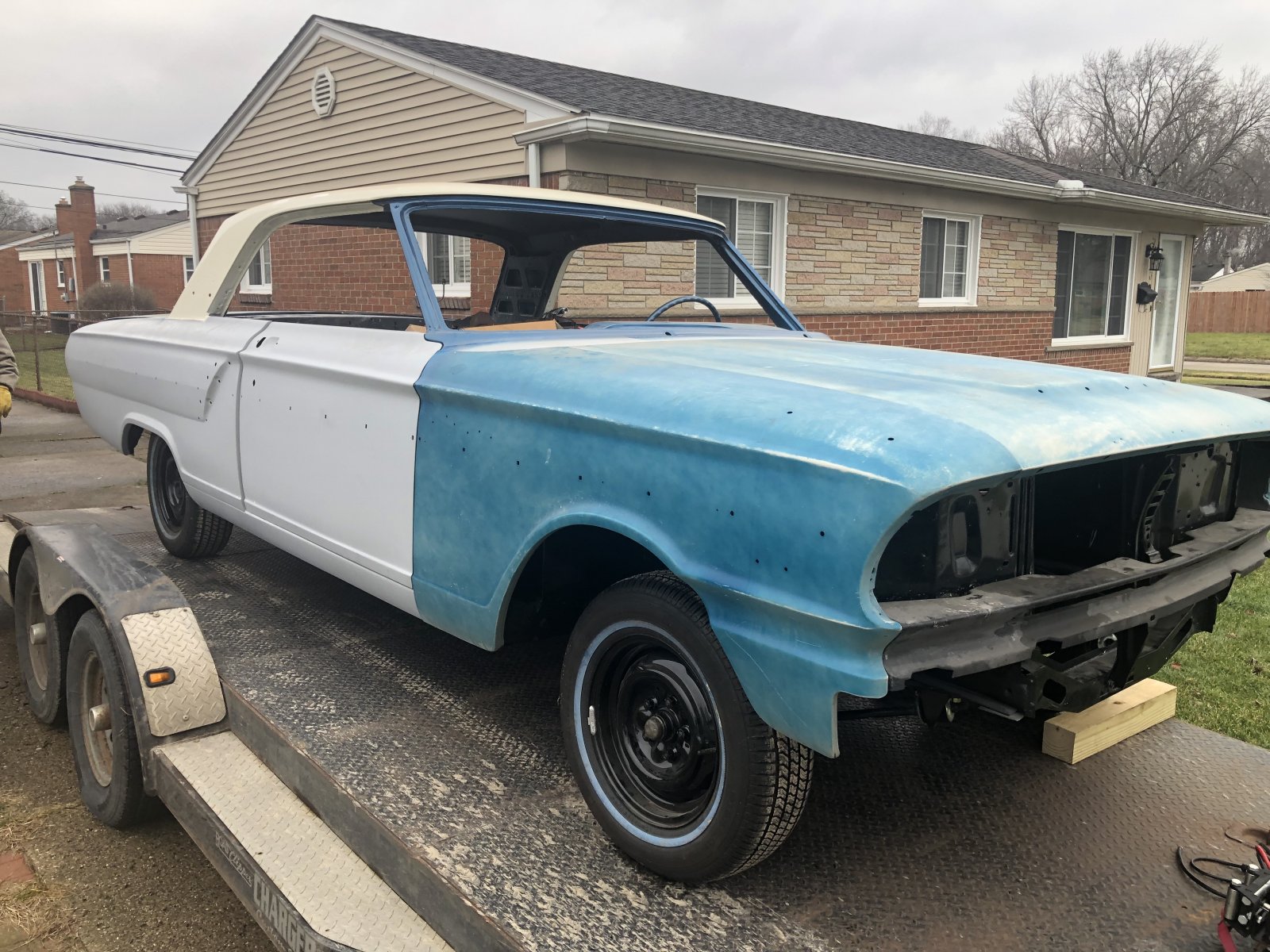

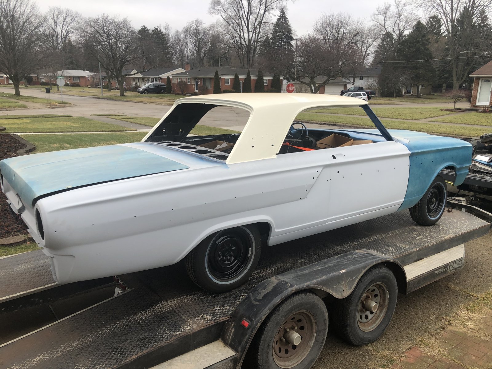

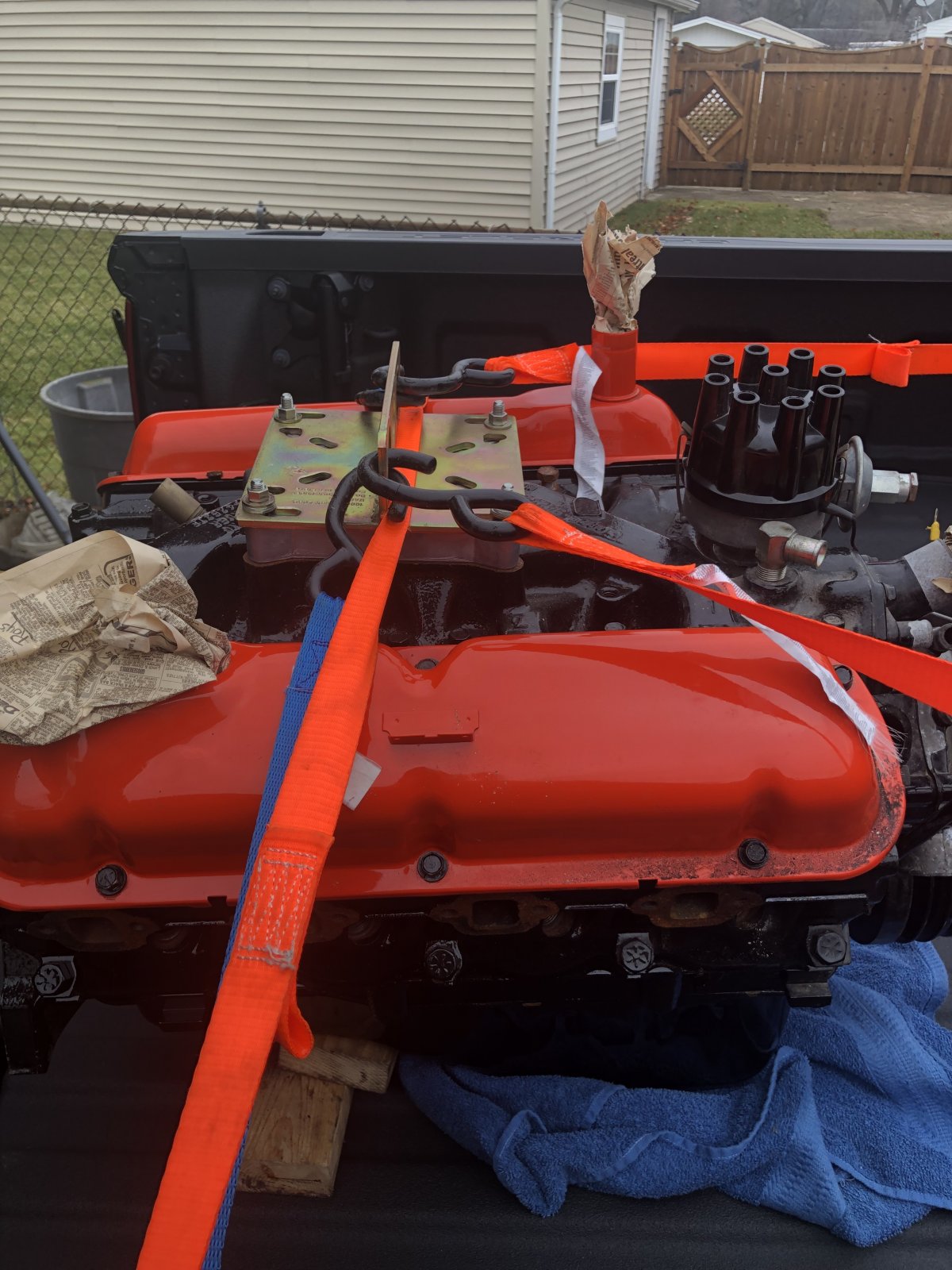

  14. Love those….friend of friend picked this up last week…really nice start to a 64…
    0F706F09-649D-4B2E-82BF-92309C93D807.jpeg 93EDDBAA-0F02-40E1-A262-424DD4C7996B.jpeg C8F9EFDA-0A4C-4428-BCFF-CF9A9330A316.jpeg 26FB9CDB-CAA8-491D-9C5D-7DDB5A0849DD.jpeg

  16. He has it all..the trims perfect…fresh 289, rebuilt to stock..gonna get a “Day 2” makeover..some bolt on motor parts, rims and tires, has a T bolt hood and glass bumpers…replacing the 3 on the tree with a toploader
