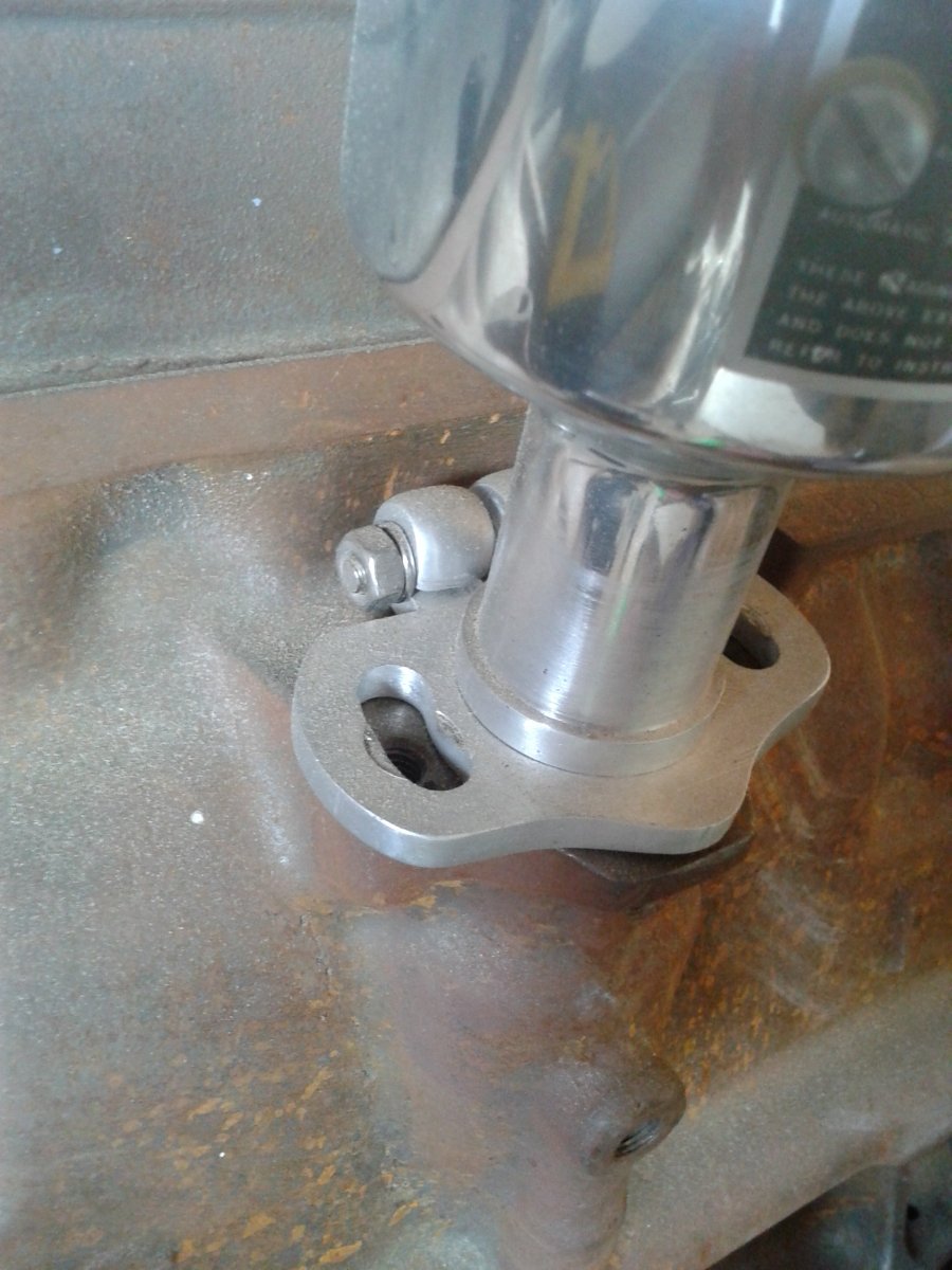

  2. Do you have any pics for reference so I can follow what your saying on the base? I would defiantly be interested in running a different distributor thanks!

  9. What year Pontiac dist would that be? So factory it would just take the big u shaped washer and a bolt? Then u just made the part to slip over the bottom?
