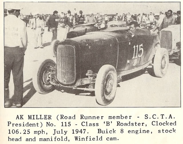

    That is an wonderful car, and a lovely fiancé.
    Congrats to both of you
    I like the fact that you plan to run the straight eight, that is so cool.
    Ak Miller ran a straight eight in a 32 roadster at the lakes.
    If it's good enough for him, it's good enough for most people :)

    I don't want to be off topic, but rodders, don't miss the A-arm suspension on Ak Miller's roadster!
    Ak was quite the man, and also competed in the Carrera PanAmericana with a '27 T on a '50 Ford ch***is,
    (as well as his Pikes Peak mastery!).

  28. Ak is the man! I wonder where that car is today if it's still around!
