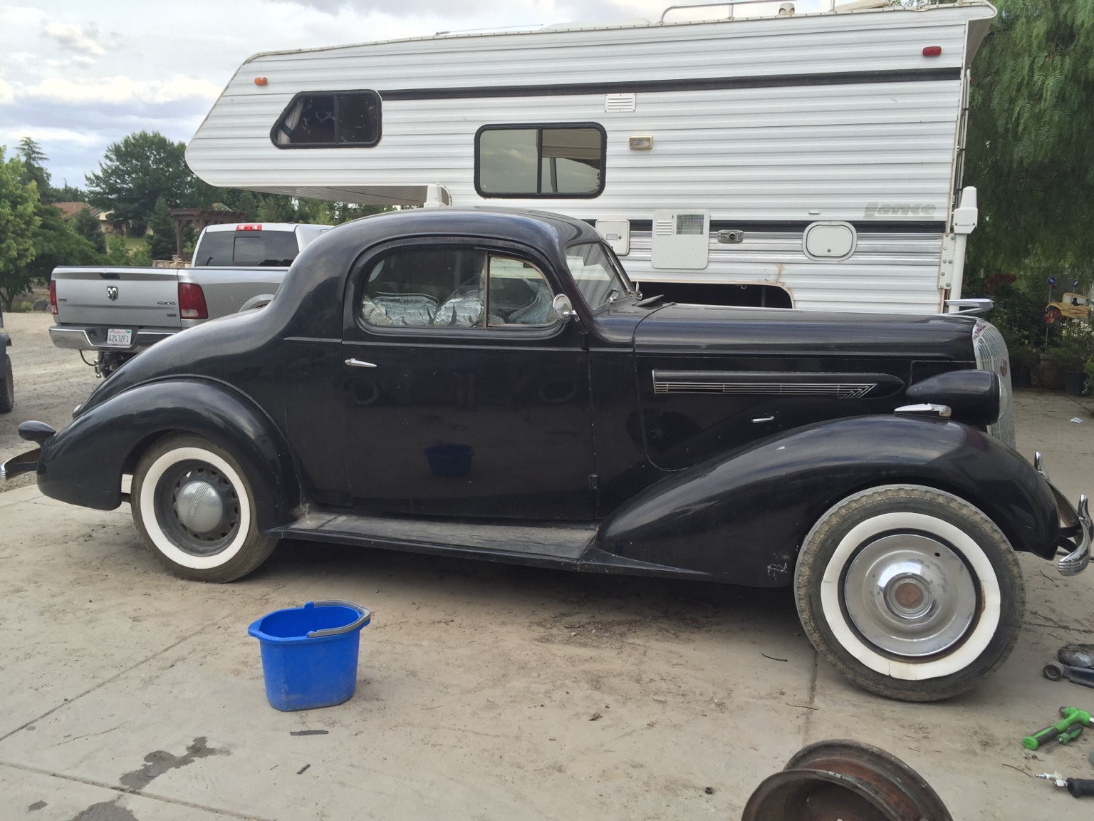

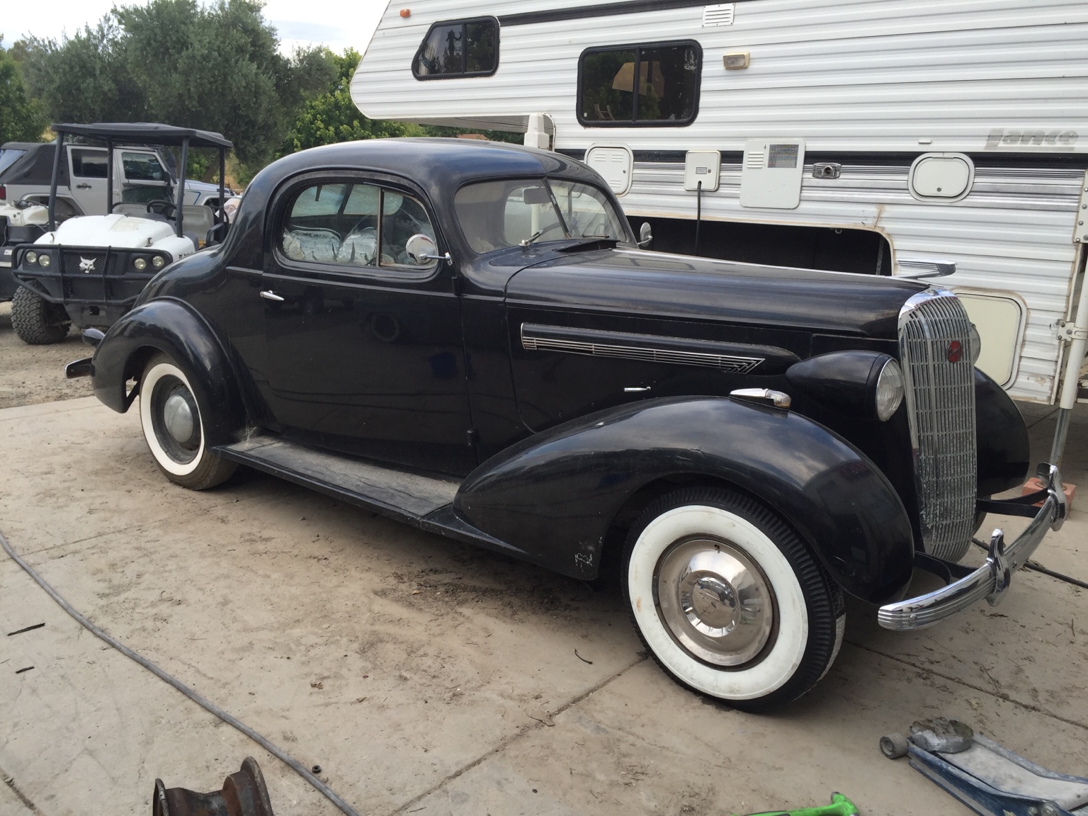

My fiancés new 1936 Buick 3 window coupe

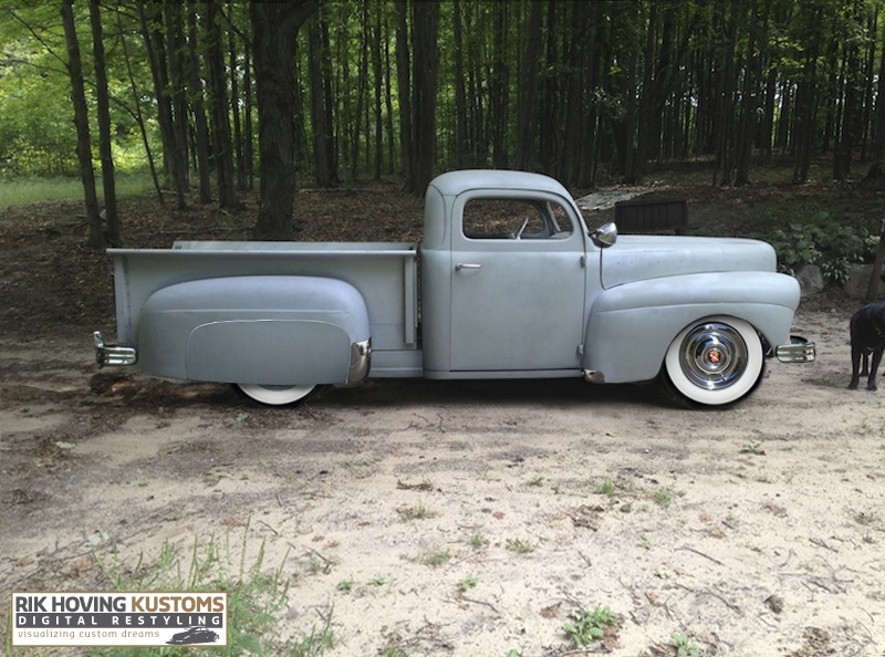

    As to tire size. I am running 600-16 on my custom 1941 Ford as it was the stock size. 650-16 were available as an option I believe.
    I am also running a 3-7/8 width white wall which is wider than most use but I feel that it fits my build better.
    If you are looking to keep it pre-war style then the wider white walls are the way to go. Or you could go with black walls as well.
    Here are some pics of mine with the 47 cadillac sombrero 16" wheel covers that I will be using.
    Also a pic of my build.
    I saw that you posted over on the Jesse Lopez coupe build. Jer is running 15" wheels I believe which is what a lot of guys did back in the day. Mercury started to offer them as an option after the war.

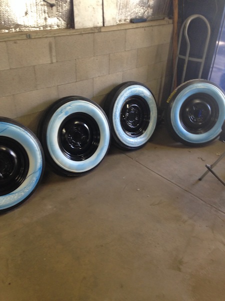

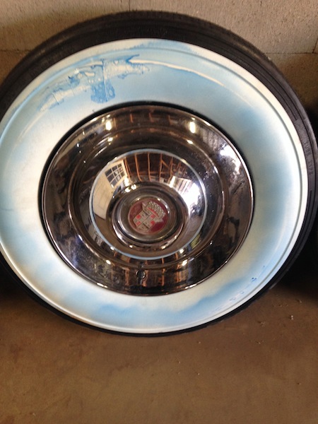

  26. Well I scored 2 - 6.70/15's today for 360$ I thought well I can the 15's from my 52 and then I can run some hubcaps. Well when I dismounted the tires somehow the tire machine came loose and bent the **** out of the hub of one of the wheels. [emoji35] after getting 1 tire on and the wheel as straight as I could get it (for now) I popped them on and ran through a few of my choices that I currently have. I don't remember the exact years so if you know the years feel free to say! I forgot I had a set of 16" Cadillacs so I just set that one next to the car to see what it looks like.
    [​IMG][​IMG][​IMG][​IMG][​IMG][​IMG][​IMG][​IMG][​IMG]
    I think I like the Buick caps from my 52 on it.
    Typically I ran the Olds's cap on my 52 but those also look good I think. What's your guys thoughts?
  27. 'Mo
    Joined: Sep 26, 2007
    Posts: 7,419
    'Mo
    ALL great choices! :)
    Where to start?
    As a rule, I tend toward the earliest workable solution as a target. It's rare to have a '40's style custom, so the Caddy covers have a lot of merit.
    Visually, I really like the Olds covers. These are a**** my favorites, and would still date the car back to at least 1950.
    That said, I would choose the Buicks, primarily because they fit so few wheels. They are the cleanest sombrero type cover of all, but very few people get to use them. You just won't see them on the Chevys and Fords parked next to you! They would still hold the build era to just 1952 (although I'm sure some people will mistake them for Lincoln Premiers.;)). AND they are Buick.:cool:
