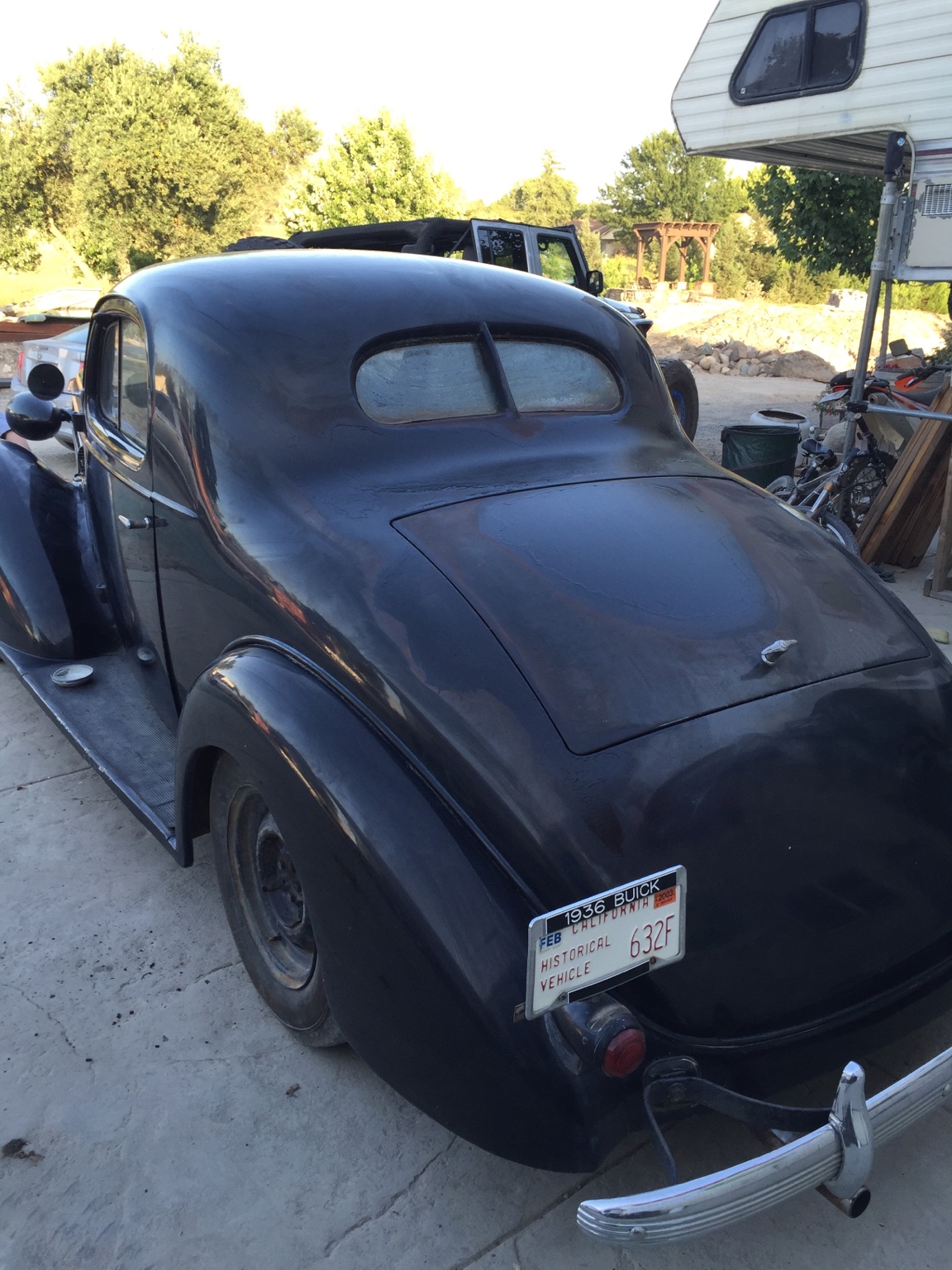

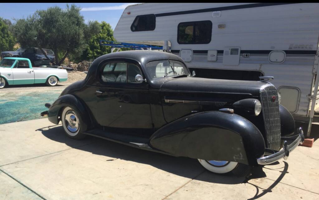

  3. I got it lowered 4" today. Ordered some blocks and u bolts from summit. I think I'm going to drop the front now just an inch. [​IMG][​IMG]

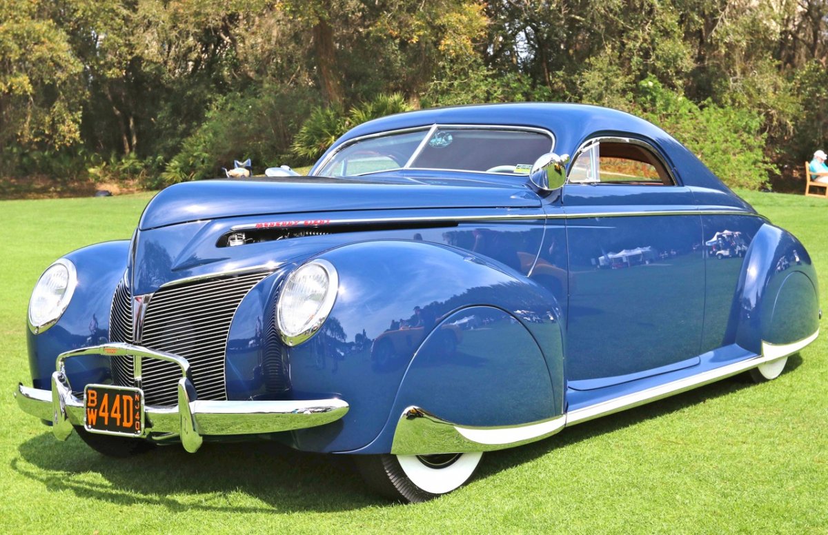

    You might as well run rear skirts as well (good intentions but it needs the back ones too). I posted this Cadillac offshoot in another thread that this reminds me a little of this elegant style being proposed by Falcon. Steering may be more difficult (offset wheels perhaps). Also with this combo of skirts the chop the Rikster proposed in his rendering would be essential to give it that Loooong slinky cruiser look...Live this as you know is just my opinion so you will be the ultimate judge in where this goes and again this beast you and your sweetheart have is a lovely canvas ;).

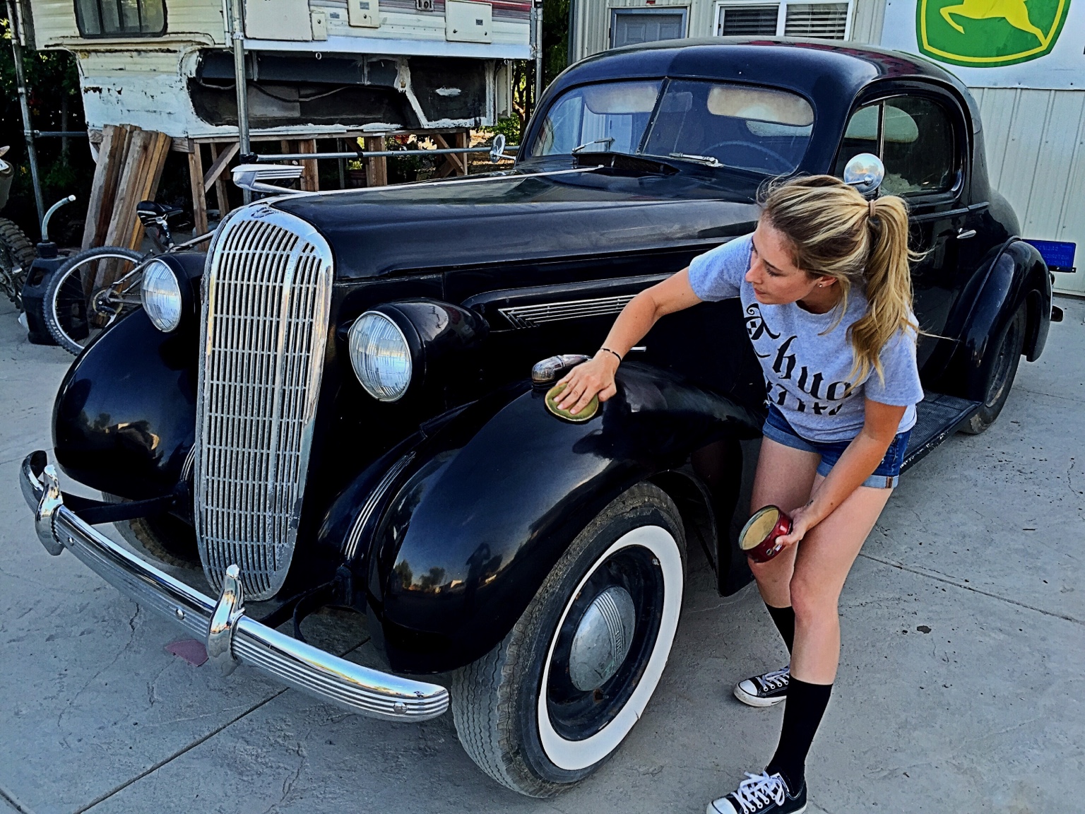

  16. Heading to the pismo beach classic this weekend so have been getting the 36 dialed in, got it running pretty smooth has a small miss at idle and a tiny sputter mid rpm with no load. I think it might be my automatic choke giving me issues. I'm going to try to find another carb. Also it's still has the starting issue once it's good and warm it only has to sit for 4-5 minutes then it fires right up. I played with the timing yesterday and it didn't make a difference in the starting. I also started to (attempt) to fix the paint with the process mention before, and started polishing her up. The lady helped me with the paint to! Hard worker she is. [​IMG]

    telekenfun
    Now that is really looking great! Amazing what a little wax and elbow grease can do. We can still see your reflection in 80 year old paint. And, even a single brush coat over the bare patches does wonders visually and will stop further deterioration of the surface. Have her continue to load the lacquer into those patches until it is thick enough to feather the new into the old. Then the patches will disappear with a bit of buffing. Cruise it proudly and enjoy Pismo.
    Best Regards and good luck with all your endeavors, KB.
    302GMC and LiveActionMotorsports like this.

  19. 1946caddy
    Joined: Dec 18, 2013
    Posts: 2,321
    1946caddy
    from washington
    I had a corvette and it had a similar problem with not starting after being driven and then not wanting to start up until it cooled down. The problem turned out to be the starter, it apparently got hot being close to the headers and needed to cool down. I replaced the starter and that fixed the problem.
    Another reason could be the heat from your engine is heating the fuel in the carburetor bowl after shutdown. You could try some short of insulation or heat shield at the base of carb to see if that helps.
    LiveActionMotorsports likes this.

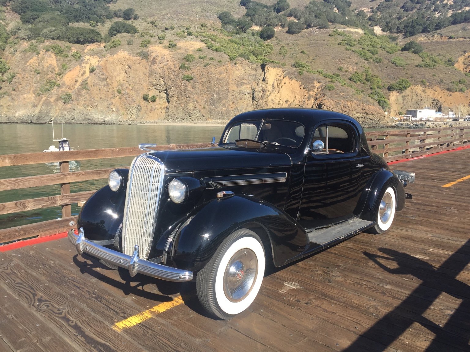

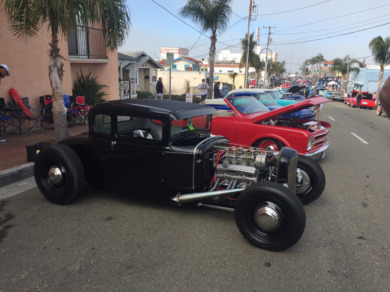

  23. 302 the motor is a very low mile motor and very clean internally the heat riser works perfect. .. I'm building a new manifold for it also.
    Telekenfun I think I have it narrowed down to it being the starter or an issue with the factory vaccum operated choke. As for the motor it is very clean inside as it was rebuilt before I got it, only has a few k miles on it.. I'm going to go to 12 volts soon to that should help..
    As for pismo, what a blast! Car drove amazing we had a blast! It was a hit at the show people were all over it and it's originality. We cruised all around town I even took it down on the beach, through Avila beach, onto the port San Luis pier, also on top of pervert point that overlooks a nude beach. (No pics of the beach) [emoji12].
    [​IMG][​IMG][​IMG][​IMG][​IMG][​IMG][​IMG][​IMG]
    I still have some work to do on the paint but it's a hell of a lot better than it was and it buffed out really nice! I'm really diggin hoe the car sits now on the new 6.70-15 with my 52 Buick hubcaps. I think I need to lower the front end about an 1/2" to sit right with the 4" blocks in the rear. I need to go through my wheel stack and see if I have another matching wheel to because one of my rears isn't straight anymore. Fun successful trip. Next I plan to keep working on the paint, fix the rotten wood in the doors, convert to 12 volt, and start building a manifold. Also somewhere in there get the glass replaced and seat redone.
