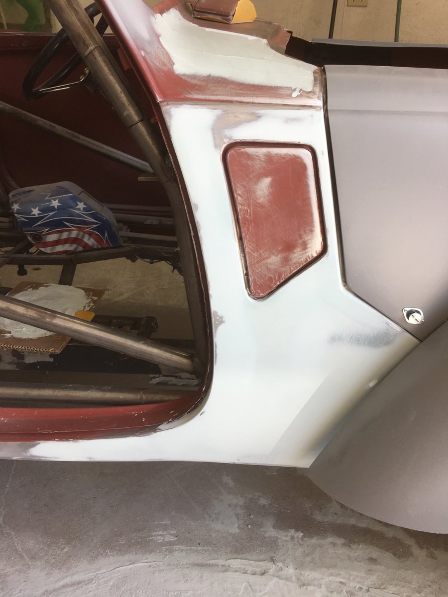

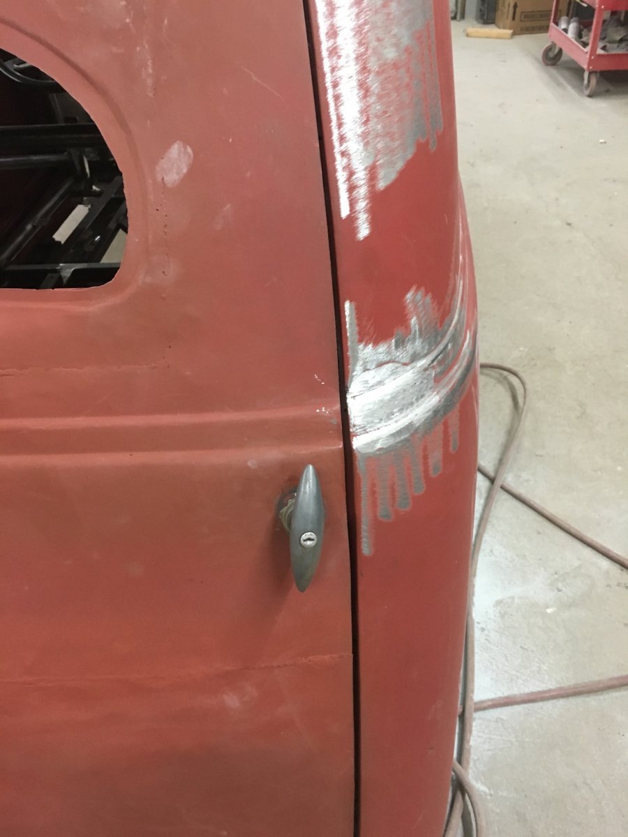

    The Fiat is in the body shop and the fun has begun. Getting rear door unsprung and starting on the roof. Fixing the rear door has the body lines matching again. 558.jpeg 562.jpeg 564.jpeg

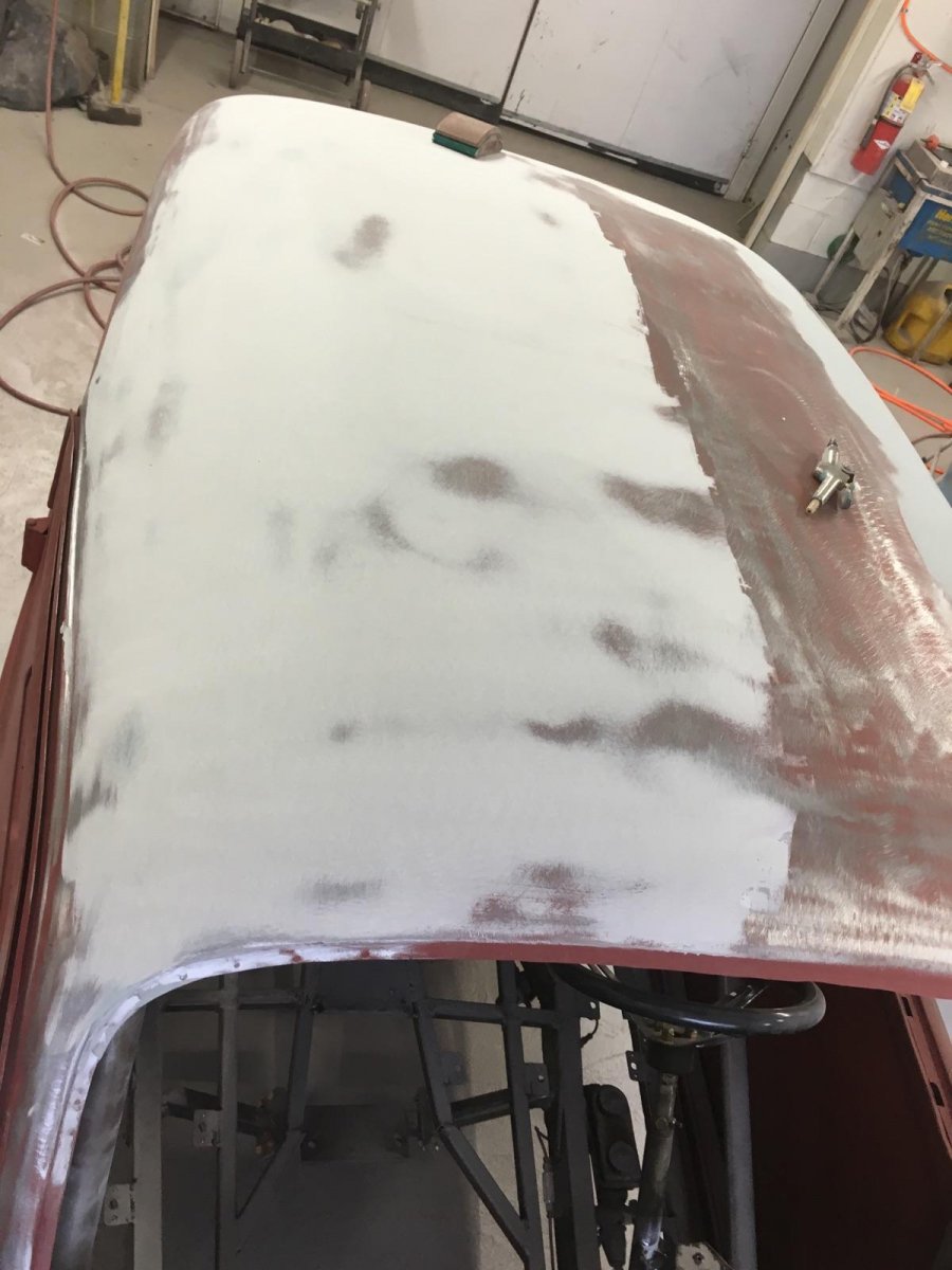

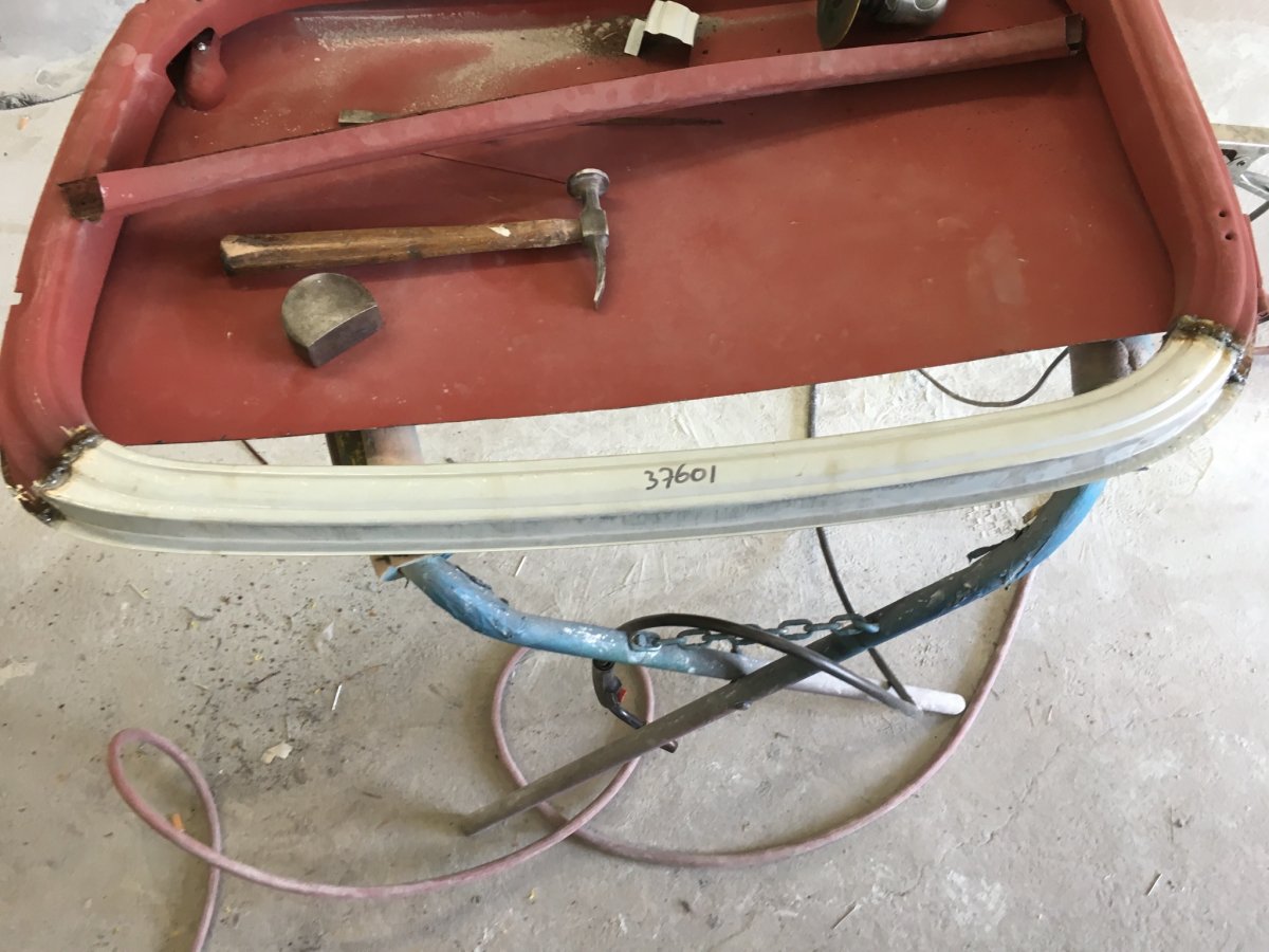

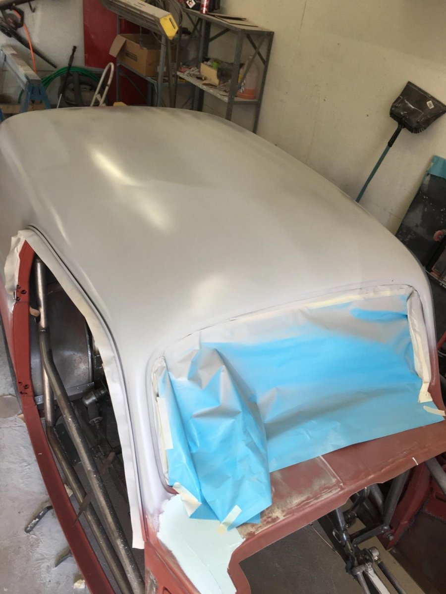

    A little more work on the roof. you cannot see it in the picture but the roof had a lot of small surface dents. Large ones were hammer & dollied and the rest get a light coat of filler.

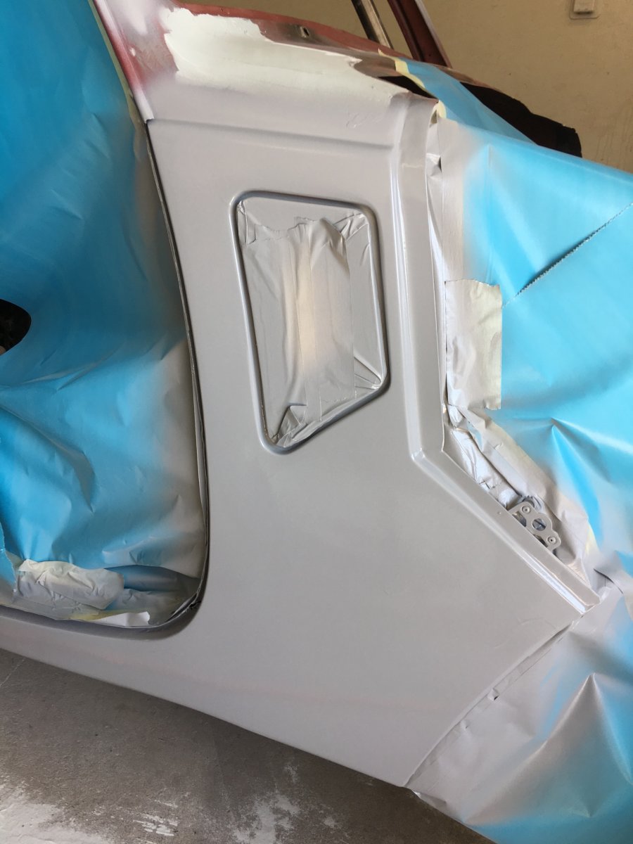

    Fiat is coming along nicely at the body shop. roof smoothed out and in primer. A lot of other small issues are being tended to also. Hope you like the progress. 855.jpeg 20160419_100642.jpg 20160419_100420.jpg

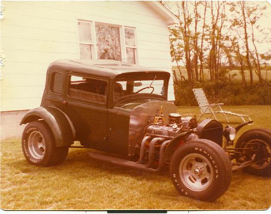

    When I set the line lock it pushes the front tires before the back wheels spin. Also had to stop quick once and the front wheels locked up and did very little to help stop the car. The yellow looks nice on there. When I was a kid my dad had a 31 willy's that initially he painted dark metallic green. The following year he painted it yellow. Very small car that we fit my brother, myself and my parents in. About the size of the inside of your Fiat. Well, once it was painted yellow it was a magnet for bee's. You want to see something funny. When a big old bumble would come in the window, Dad trying to get the car stopped and the four of us bailing out afraid we were going to get stung.

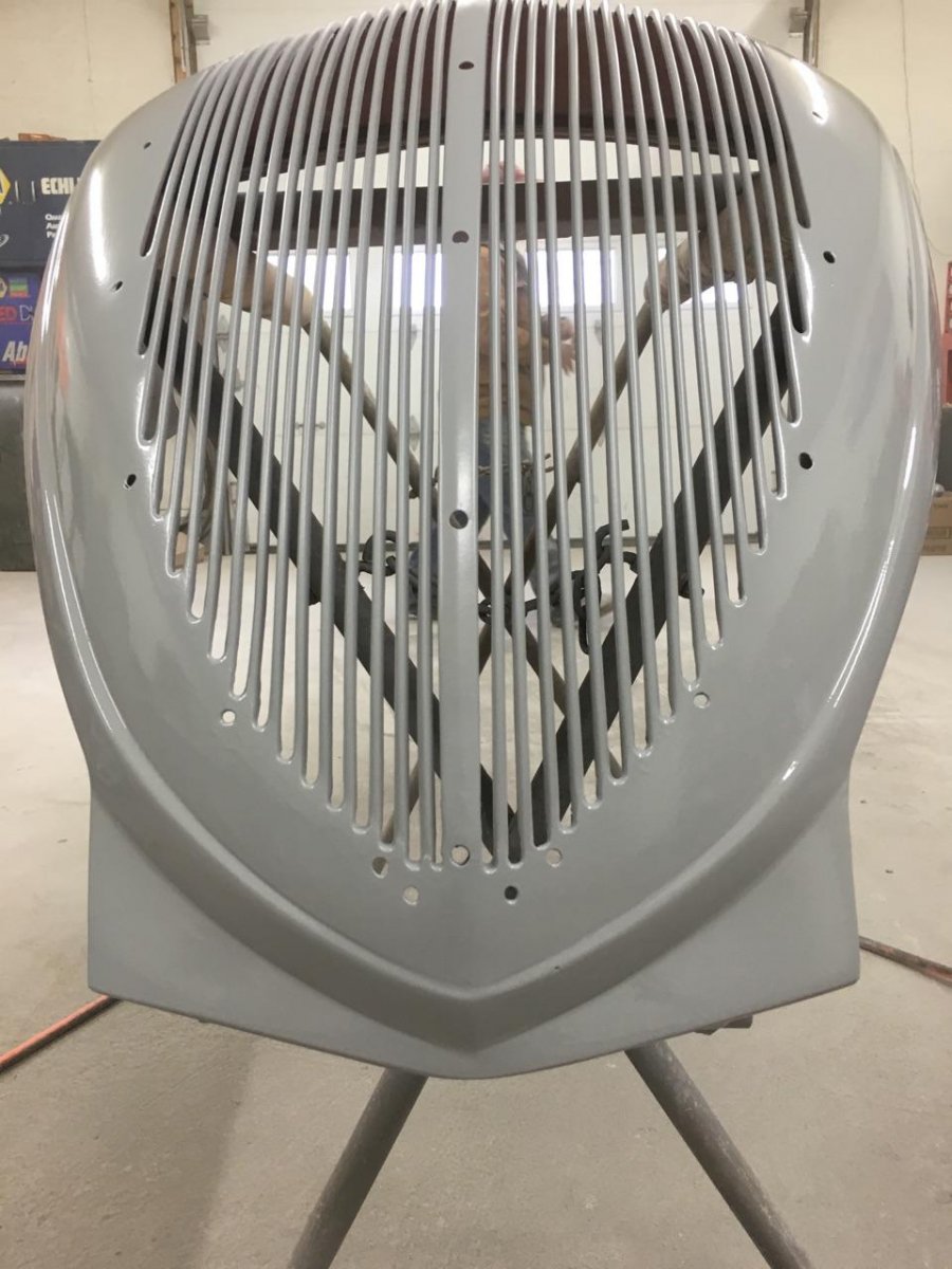

    The body work is progressing nicely. The hood and nose where I made it longer took a lot of massaging to fix the body lines and straighten things out. The inside of the grill was welded on each rib because through vibration were each rib meets the body it makes cracks, so welding should stop any further damage.

    Looking good! Bet it was fun tacking all those ribs.

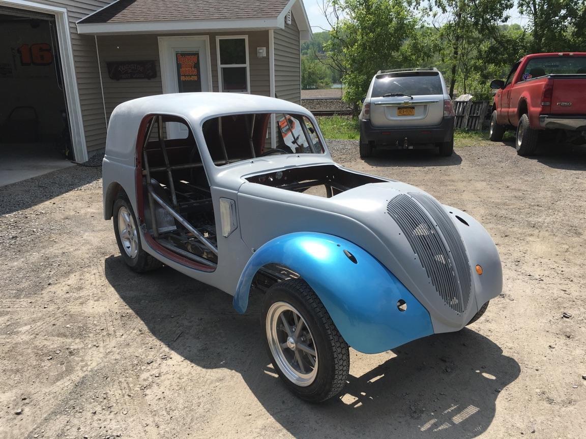

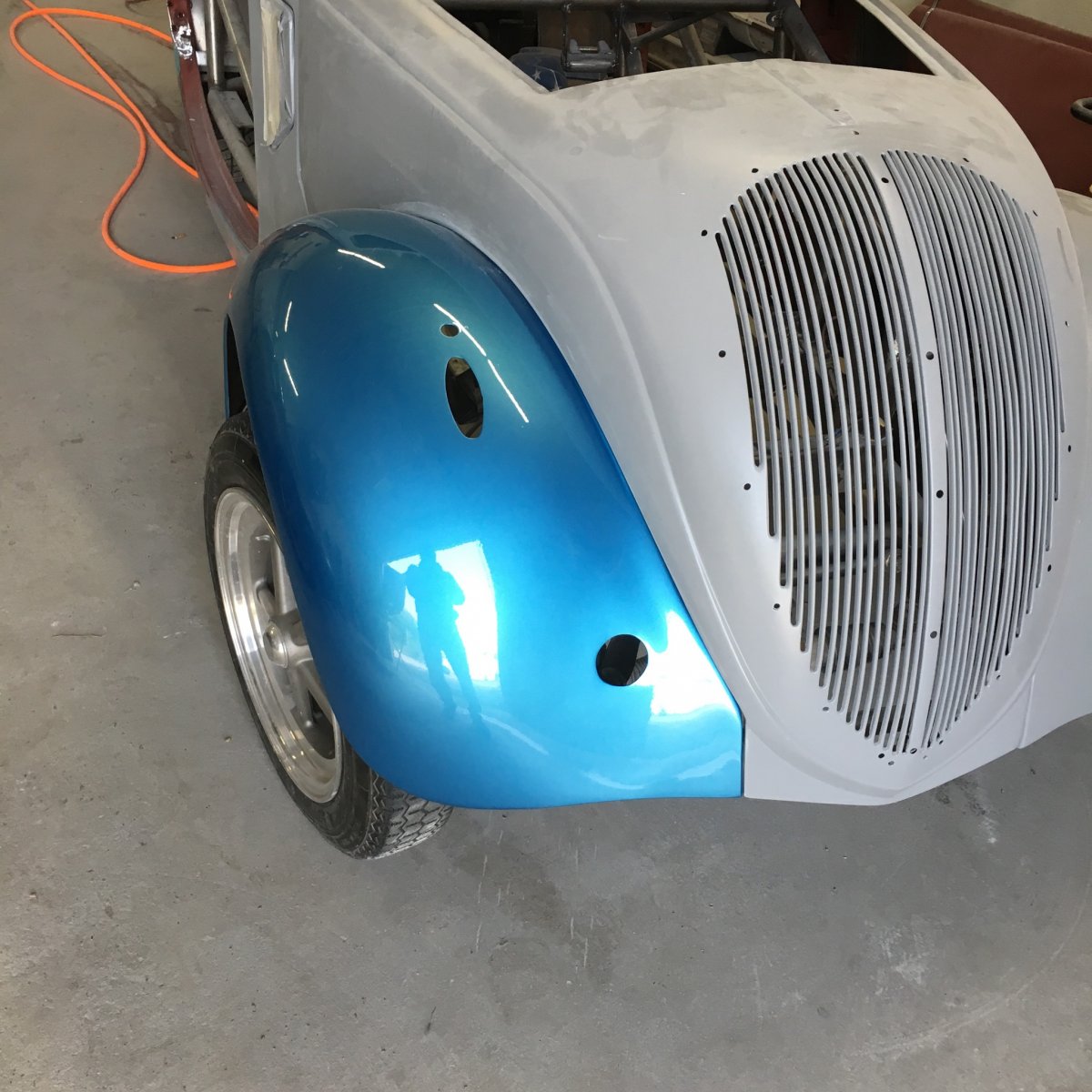

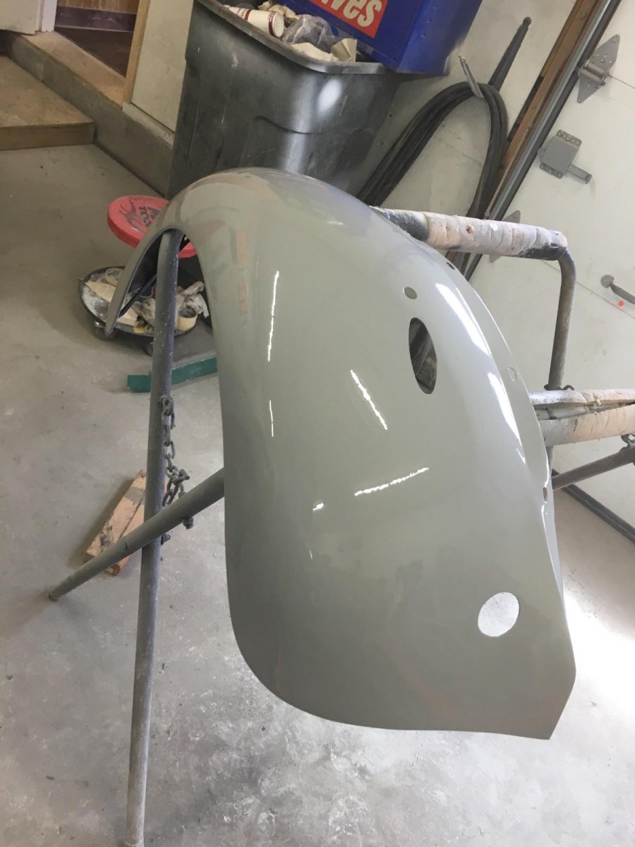

    Fenders done and in primer all fitted with a nice fit for fender welting. Directional light fits flush in fender opening. work on cowl area progressing nicely and zues fastener to secure flip nose when closed. 1263.jpeg 1262.jpeg 1324.jpeg 1328.jpeg 1331.jpeg 1203.jpeg

    front end is coming together nicely. FB_IMG_1463188376318.jpg FB_IMG_1463188351022.jpg FB_IMG_1463188344896.jpg

    A sneak peek
