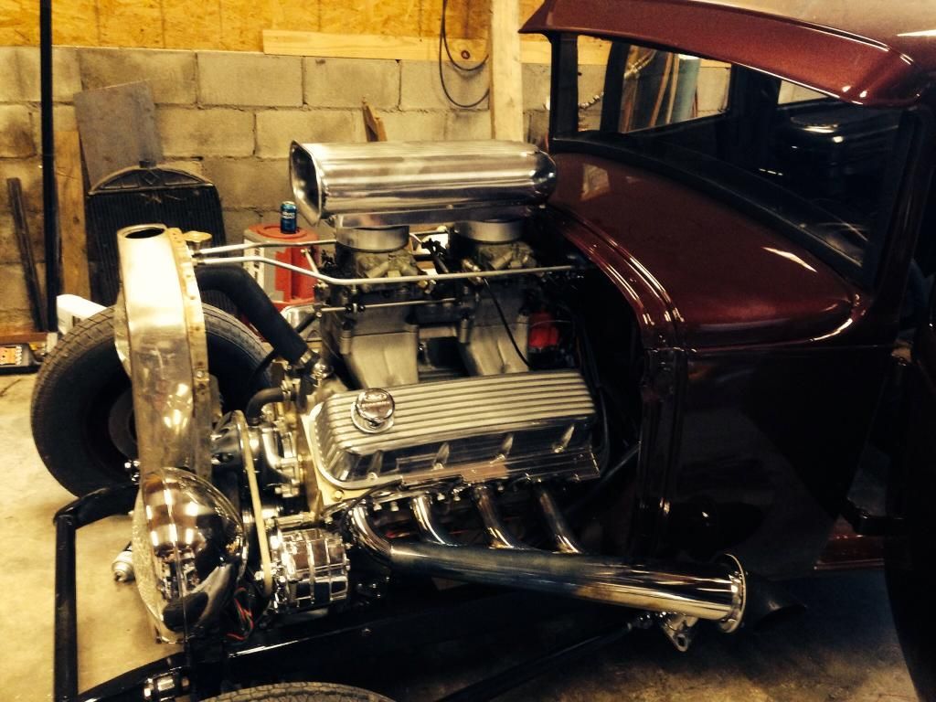

  4. Brads MONSTER
    Joined: Oct 6, 2011
    Posts: 2,170
    Brads MONSTER
    from Buford GA
    image.jpg Steel in motion 2014

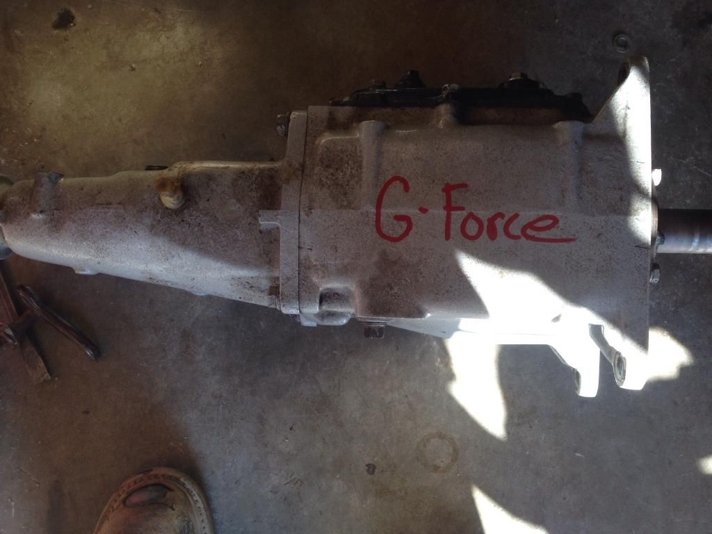

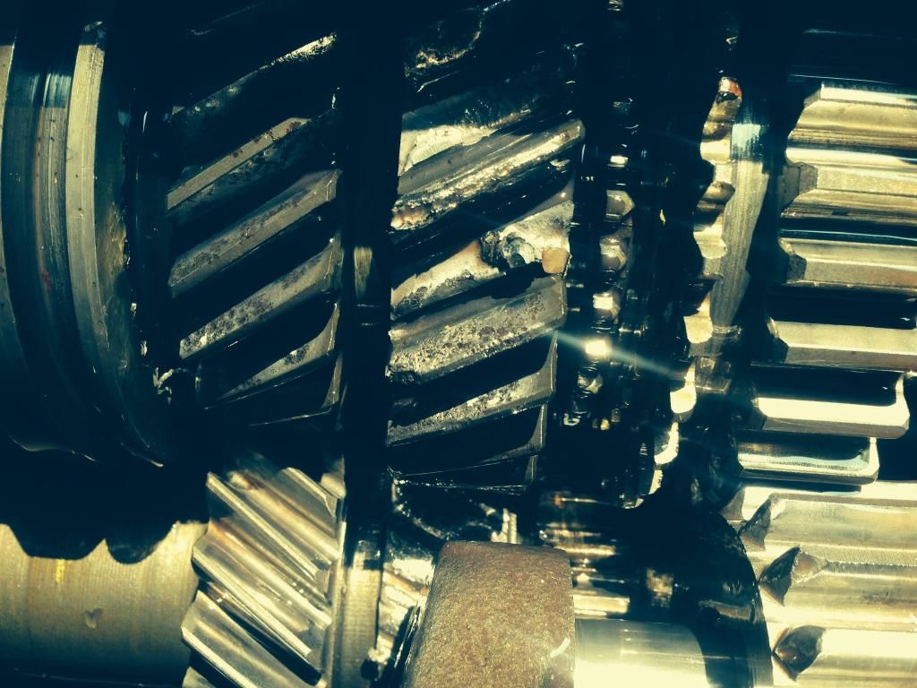

    Looks like it 2 for the BBC and 0 for the drive train Saturday before last ripped out 2nd gear
    So I picked up this real nice G-Force
  29. dirty old man
    Joined: Feb 2, 2008
    Posts: 8,910
    dirty old man
    Wasn't the trans that gave up a Saginaw? Never used one, but have heard they weren.t as stout as T10, Muncie, or top loader Ford. I'm giving some thought to a change from the top loader with Jeep shifter to my other top loader with addition of a Hurst shifter, but would sorta like to add a Gear Vendors over/under drive at the same time.
    All that at once is a bit rough right after $3200.00 for the injectoir job on my truck, LOL!!!!!!!
