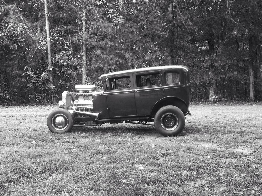

    Looks like a gangster car, Great shot man!!
  2. Sure appreciate you showing this build, you're going in the right direction, welcome to HAMB.

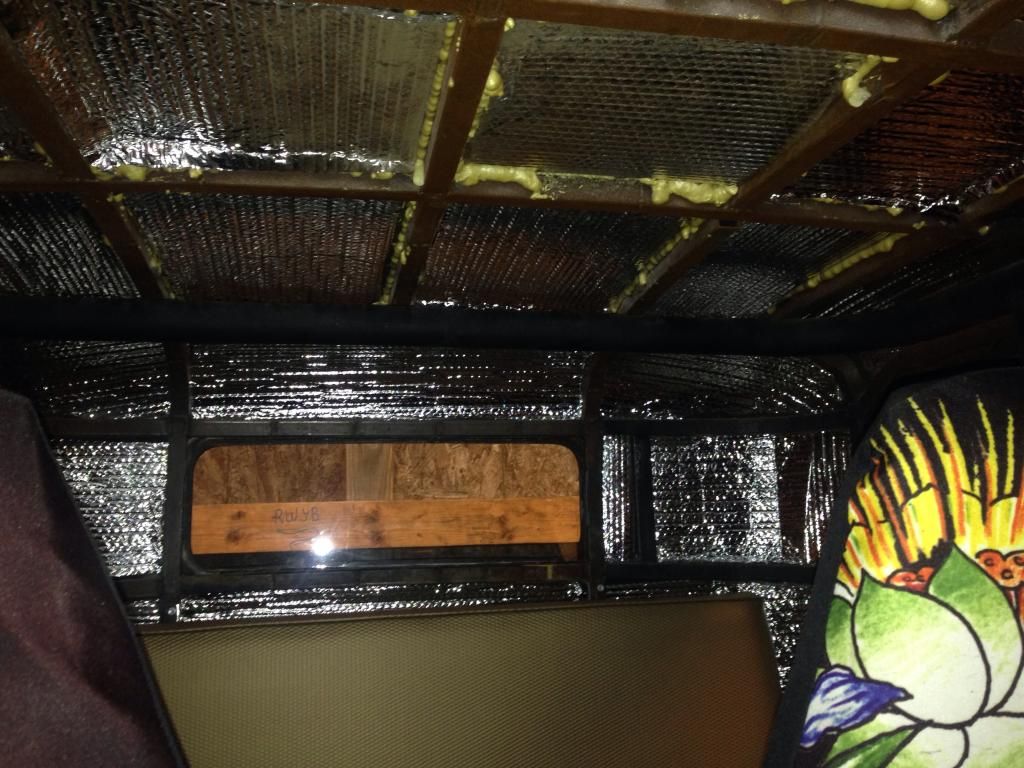

    Looks good Brad! How are you sticking the foil stuff to the roof? I used 3M 77 or something in the sedan delivery and the foil came down in the heat.
  9. Brads MONSTER
    Joined: Oct 6, 2011
    Posts: 2,170
    Brads MONSTER
    from Buford GA
    I used 3M super 77 I hope it holds
  10. 3dnsouth
    Joined: Mar 19, 2006
    Posts: 1,217
    3dnsouth
    from North Ga
    The stuff you need is DAP Weldwood Landau Top and Trim Contact Adhesive. A gallon can will go a good ways, get a cheap HVLP gun and spray it. Hit google and give it a look.
  11. dirty old man
    Joined: Feb 2, 2008
    Posts: 8,910
    dirty old man
    The stuff I used is a 3M product that comes in a spray, suggested by the insulation vendor here on HAMB (not the fancy name brand stuff, I think he's listed as an Alliance vendor. When I get home from here at my sister's place here in VA, I'll take a looksee at the label.
    I only have it on firewall inside so far, but it hasn't loosened at all.
  12. dirty old man
    Joined: Feb 2, 2008
    Posts: 8,910
    dirty old man
    It's listed as automotive insulation on Alliance list and when you clk on the link it comes up E-Z Kool insulation. He recommends 3M gen. trim adhesive and I'm fairly certain that's what I used, but I'll look when I get home. His literature says part # o8o88. You spray on and put in place before it sets up so you can slide into place and smooth out before it grabs solid.
