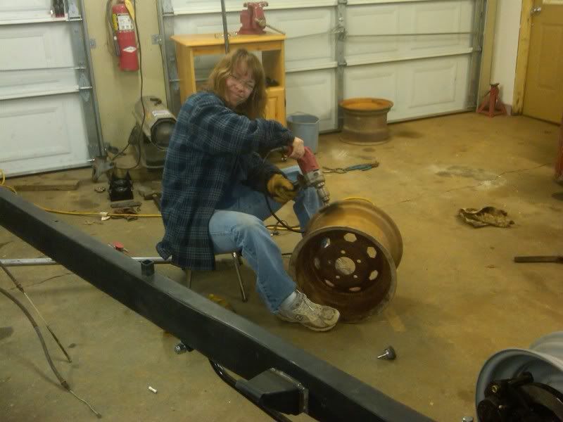

    Its Sunday night and the wife Deb has helped me all weekend hunt down a new rear in the junk yards. So its time to clean up some old dirt track wheels I bought the other day and do a dry fit but first they need to be cleaned up. Now this is a good women. Get down and dirty baby. Hears another cold one.

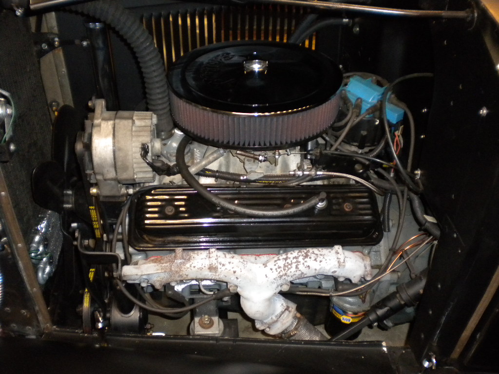

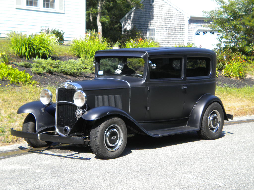

  20. I'm not to fond of IFS on fenderless cars. That said , I don't think my Chevy came out too bad. My 1st build.
    Keep up the good work. I have subscribed. FYI I am now working on s***ching up my interior.

  24. My column is out of a Buick. 70's vimtage. Can't get much fiuller size then that. All depends on the angle you want and clearences.I could have dropped mine another 1". I did use 2 knuckles in the linkage.
