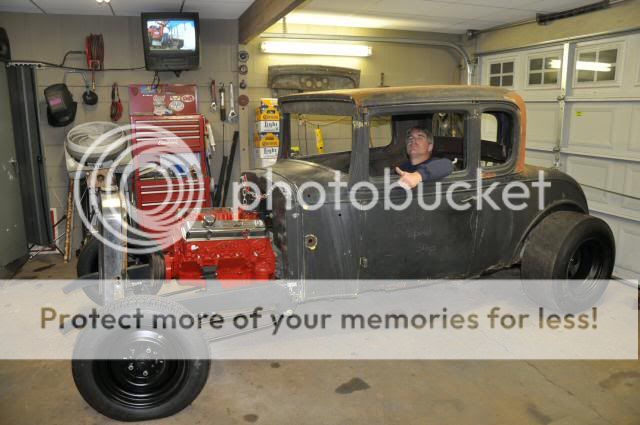

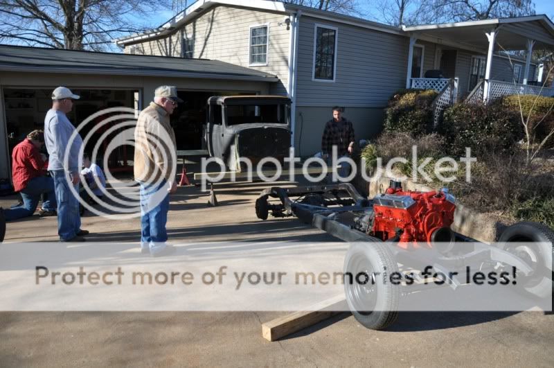

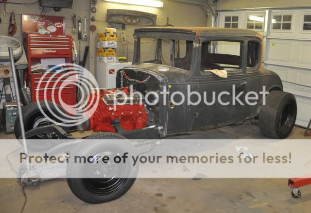

    After the X bracing was complete it was time to test fit the body and check out what will work and what needs to be fitted a bit more. I need to put the body on and see how the car will sit so here we go. I even got the guy in the pasture that was picking up the horse manure to help with this one. (His name is Dan the horse $hit man). We fit the body but it still needs some work.

    Well after a long 3 day weekend it was time to sit back and look at how things are going. The body sits well but I think that the front-end needs to go lower and the body needs to be channeled. That will dress it up well. I think I will change out the front tires and lower the body over the frame and put some 31" tires on the back. That should do it!!! I hope!! :rolleyes:

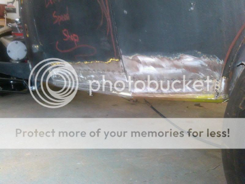

    I couldn't find the post. Can you send it to me? I fitting the metal now to the lower panels, I worked all day Sunday making all the new panels that were rotted out from some sheet metal off a donor VW bug I had out by the barn. I will post some pictures tonight of the panels.

    Here are the panels that I made and I will say that they don't look to bad for what I had to shape them with. They all match up.
    The bottom of the doors are next. Then the other rear panel and door the I will start the 1x1 steel tubing to frame up the inside skeleton inside the car.

    Your panels look good and this will take care of the problem. The picture I was referring to is on page 4 of this thread, the #79 is at the far right side. The post you made on your panels is post #83. I don't know how to transfer his picture or I would.

    Well its time to update. My computer crashed in the garage and that is where I did my posts. So here are a few pictures of what has been going on. I did some more work on the rockers and they turned out pretty good. It's not a show car so why not make them. They turned out pretty dam good.
