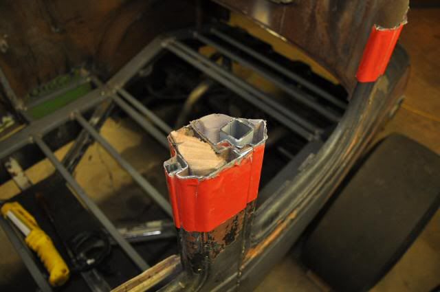

    So now its time to get the chop going. This is my 1st hot rod and did what research I could. Its a scarey thing since one you cut it there's no good way to go back. I wanted at least 4" and was thinking about 6 but it would make the tie back to hard with the difference in the a pillars. I setteled for 4" I had some red tape that was 4" so I just put it on as clean as I could and got to cutting. is really a simple thing one you get started. about an hr later the roof was in the driveway. Cool Man ;)

    Well, now that I can breath again. Time for a beer. I called on the gang and we set the top back on after the lower sides of the pillars cut off. there is still wood in some of it. Dam Chevys, Its time to put some steel back in that car. We set the top on and it fiit great. I had just a bit of trimming to do and I was welding away. Two days of work and its to a point I can move on. I did learn that I need some backer steel when welding the top together since it burns holes to easy. I will get it figured out.

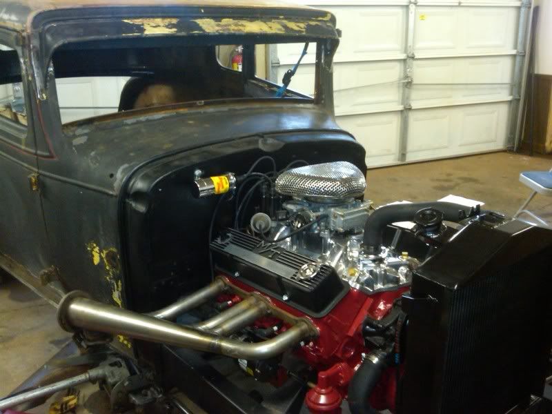

    So here I am. The car has come a long way since the 1st day. My buddy let me drive his 32 coupe and man that was soo cool. Its a true hot rod. Nothing but bad ass HP. I was going to install a turbo 350 but after driving his there was no way that was going to happen. I had to have a stick. I ended up with a Burg Warner T-5. My car will most likely never be what his is but at least I have a stick. I have spent the past month working on the motor and tranny and they are in the car now. The motor is running and ready to just about make the trip down the road. I'm working on the tranny cross member, under the floor peddle assembly and break lines for the next few weeks. I also have the new steering column on its way. I will do better on the posts since my computer is back up and running in the garage.
  6. Carl5Coupe
    Joined: Oct 31, 2010
    Posts: 601
    Carl5Coupe
    from Buford Ga
    The steering column is a solid shaft 30" long from Speedway. along with all the other joints that cost an arm and a leg. Dam man, $9.99 for a drive shaft joint the size of your fist and $70.00 for a little tinny one. Go Figure??? The motor is in along with a radiator from a fellow Hamber ( SY1356 ). all I need now is a fan and all my other stuff that will be here tomorrow. All it takes is a fist full of $100.00 bills.
