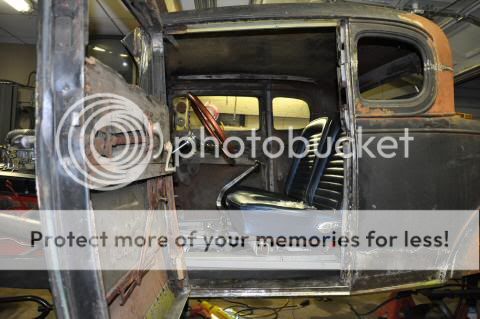

    The seats fit good. They will be in soon. I'm waiting to cover them since I have so much to do yet.
    Carl

    Looking good dude. Do you have a seat for it yet? I'm kinda courious how the shifter will sit between the seat and your leg. Normal side mount shifters usually end up under your leg. That top loader looks much better position wise.

    It all sits good. I have a set of 65 mustang bucket seats. I dry fit everything before it was welded in.

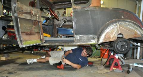

    I spent way to much time on the brake lines. I guess I should have done some reading first. The double flare tool is what I was missing. My wife helped out and found that steel lines need to be double flared. Well after doing everything 2-3 times, I finely got all the lines installed and no leaks. It was like a sprinkler system when we first filled the system. I still have to install clamps to hold the lines in place, paint the frame and do some welding but at least some of the plumbing is done. I plan on painting the brake lines when I paint the frame.
    My buddy Brad come over and helped out all day, Thanks bud, sorry I filled your coke bottle with old brake fluid. It didn't taste to bad did it? ;)

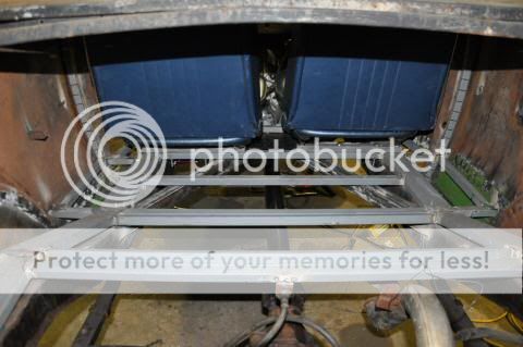

    Its been a wile, I re did all the break lines and hooked up the gas pedal and carb. This past Friday I finished the framing of most of the floor and installed the 65 mustang seats. This weekend I hope to finish the gas line and install the battery. Im still looking for a gas tank that I can hide in the trunk area so im going to put in what I have. The car should be rolling in and out of the drive way this weekend. Im so close. :)

    I tied in the fuel system this week, installed the ignition switch and cranked it up last night. It ran great and it shifted great. Its still on jack stands so it didn't go anywhere. Tonight I'm going to seal the rear since it leaked, change the rear gear lube and check the rear and ****** degrees then weld up the rear.
    It will roll Saturday under its own power. :) Then its time to do the little stuff and move on to a more finish stage like floor pans and get the old paint off and put it in primer.
