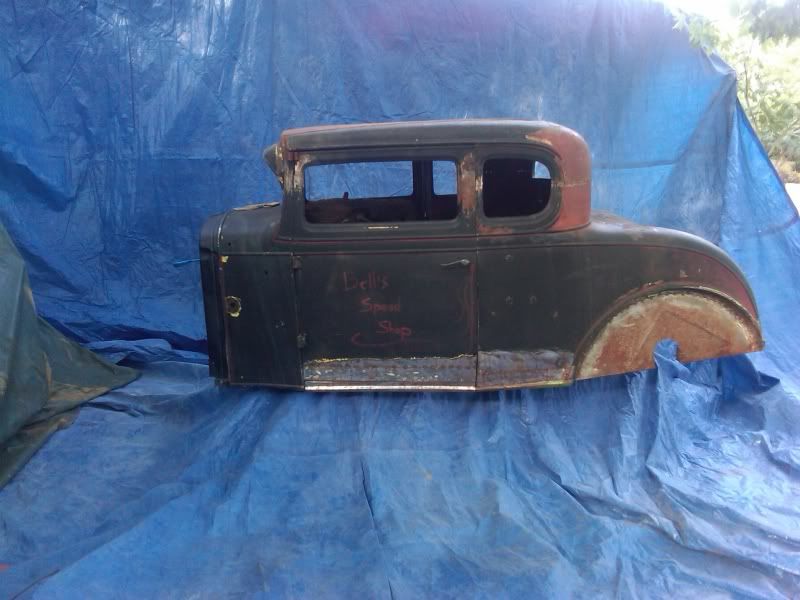

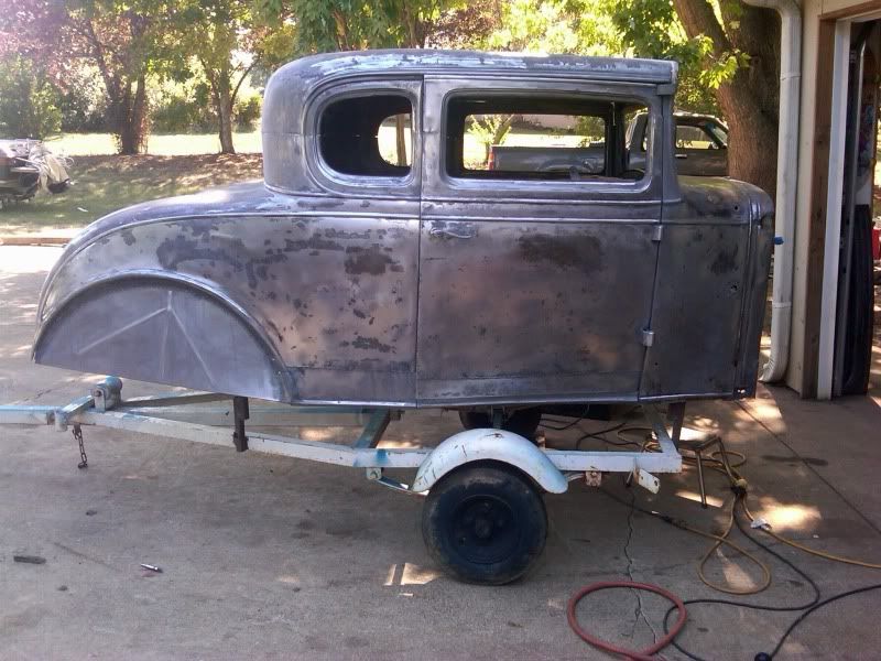

    Well I did the sand blasting and I did use sand blasting sand and Debby did the research on the HAMB and a few other sites and there are so many people with there own opinions. Josh came over and warned me also about warping the panels so I got some cold feet and that is probable good so I only did the hard to sand areas and I hit the large areas slightly as shown in the pictures. Thanks Brad for the blaster. I will say that I'm happy with the turn out. The metal is rough but I broke out the sander and did a few areas and it smoothed right out. To morrow I will sand the car down with some 100 grit paper and see where that gets me. By Sunday the car should be sanded out and in primer. Then I will put it back on the frame after some welding is done on the under side and start getting it ready to run again. The windshield will be in Friday so that will go in next week and I will also try to install some of the new floor.

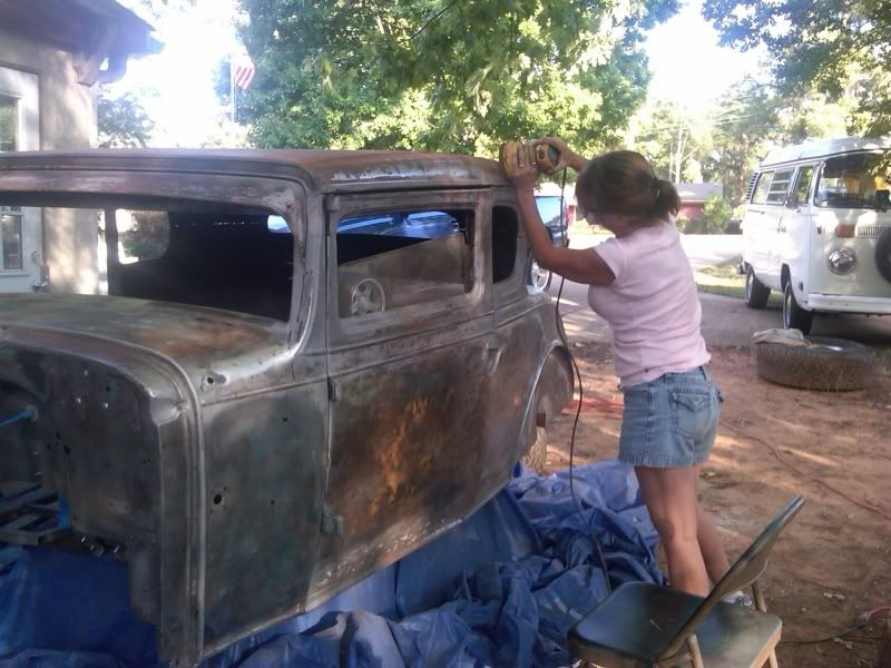

    Don't ya love it when you come home and the wife is sanding the car. :) :) :) Dam man I have it good. Body is sanded and prepped with Prep & Etch. Ready for primer then I can start the body work.

    So today we got back on the car and sanded it for about 5 hrs today and its ready for primer now. There was lots of surface rust under the paint so I couldn't get that as clean as I wanted but in all I hope it turns out. I still have a bunch of welding and body work to do but I think this would be the next step since it will take some time to get the steel work done and bondo work that I hate so much completed. By spring all that should be done. Time for a Red Bull and get the primer going.

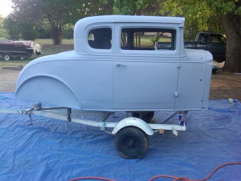

    The primer turned out great. I used a 2 Part High Build Urethane Primer that I had left over from when I painted my bug. This seals it from all the elements and I can just put the Red Oxide Primer as a finish coat when its all finished. Should look cool. I was checking out one on the HAMB last night and I like it much better then black on black. I still have the trunk and dash to do this week.
    Now its time to get some of the floor in and back on the frame. My wind sheld is also ready to pick up, that will be nice when driving. Safety glasses suck for driving.

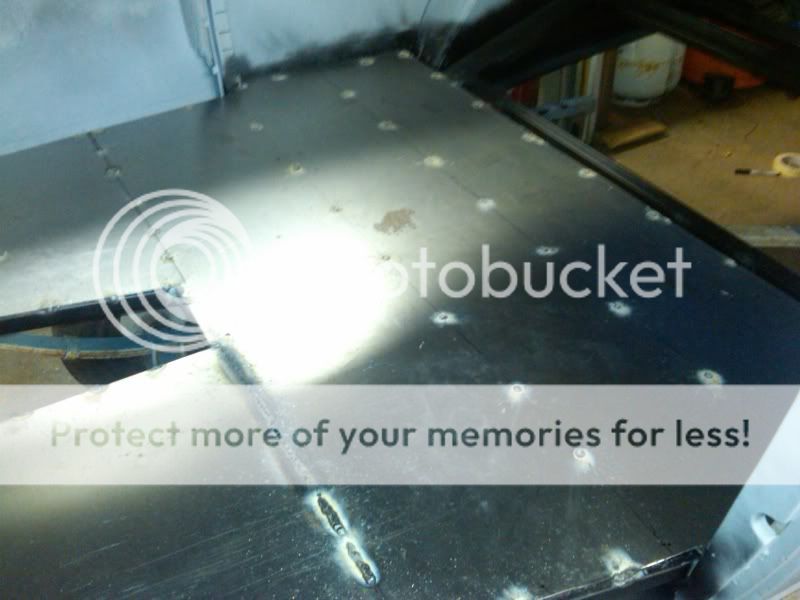

    Got the fire wall done and the floor in. I will have to cut an access hole for the master cylinders for the clutch and breaks. I painted the floor and fire wall tonight and we are waiting on some help to put the body on, should be here in about 45 min.
