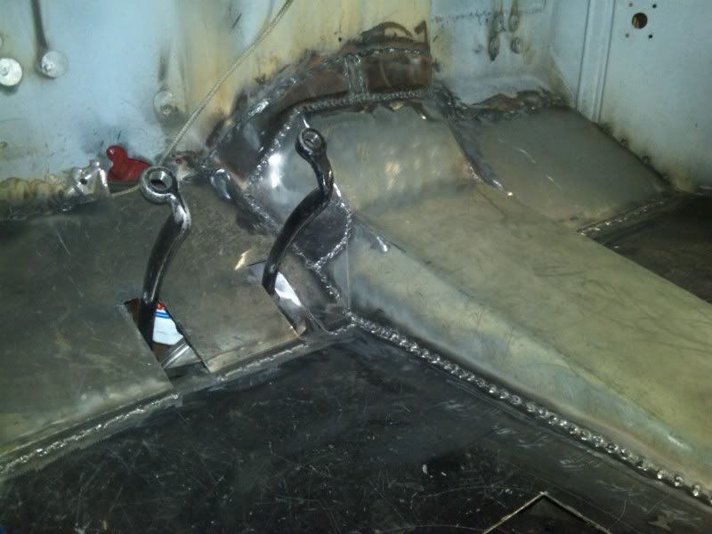

    Here are the floor pictures and what I did last weekend and this week. I dont have any pictures of the exhaust yet. The headlights and front grill are now installed.
    I spent last weekend installing support framing for the trunk and rear trunk wall behind the seats. It's all painted now not shown in the pictures.
    I also installed the rest of the front floor pan. This went pretty good. While I was there I also fixed the clutch and break pedel angles, they were tilted to much for how low I sit in the car. Everything is now painted also.
    The exhaust went great, I had a local shop install it and it turned out killer. I will post them later today or this weekend. I plan on making the wiring harnes this weekend. I picked up the 10 gauge wire today for the headlights and I have new VW bug wiring harness that I will be useing to get things started. We will see how it goes.

    Man nice work on the floor! That's motivating - I think you lost your sungl***es out my floor.
  27. Looking real good Carl! Do you have any Pics of the inside of the deck lid and your hinges. What guage steel did you use on your floor?

    The floor is 16 gauge.

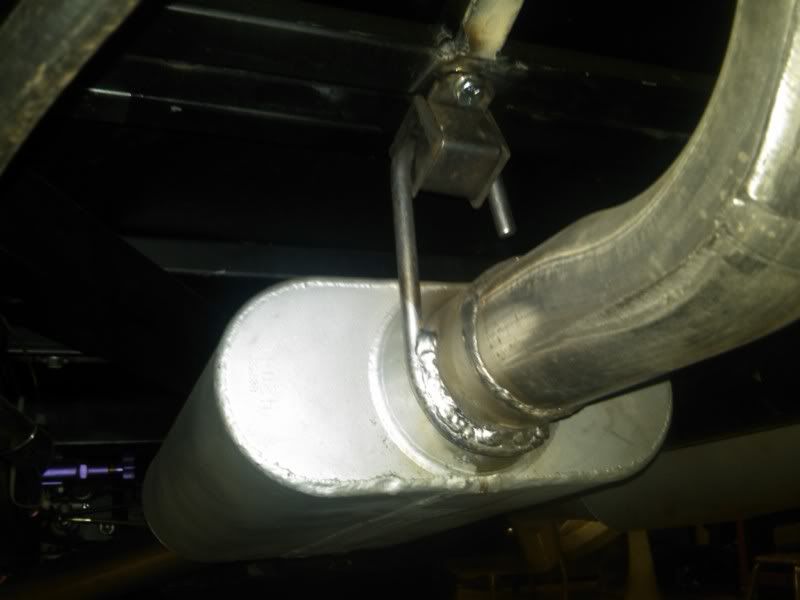

    Here are a few pictures of the exhaust. It is made of 2-1/2" pipe and some Flow Master mufflers. Sounds killer. The shop that installed it is known for doing show cars and complete custom exhausts on hot rods. No miss bends and everything is welded. They gave me a great deal also.
    This is the 1st time up to now that I had to send the car out for work. I like to keep the labor in my garage but some things have to be done by the pros.
