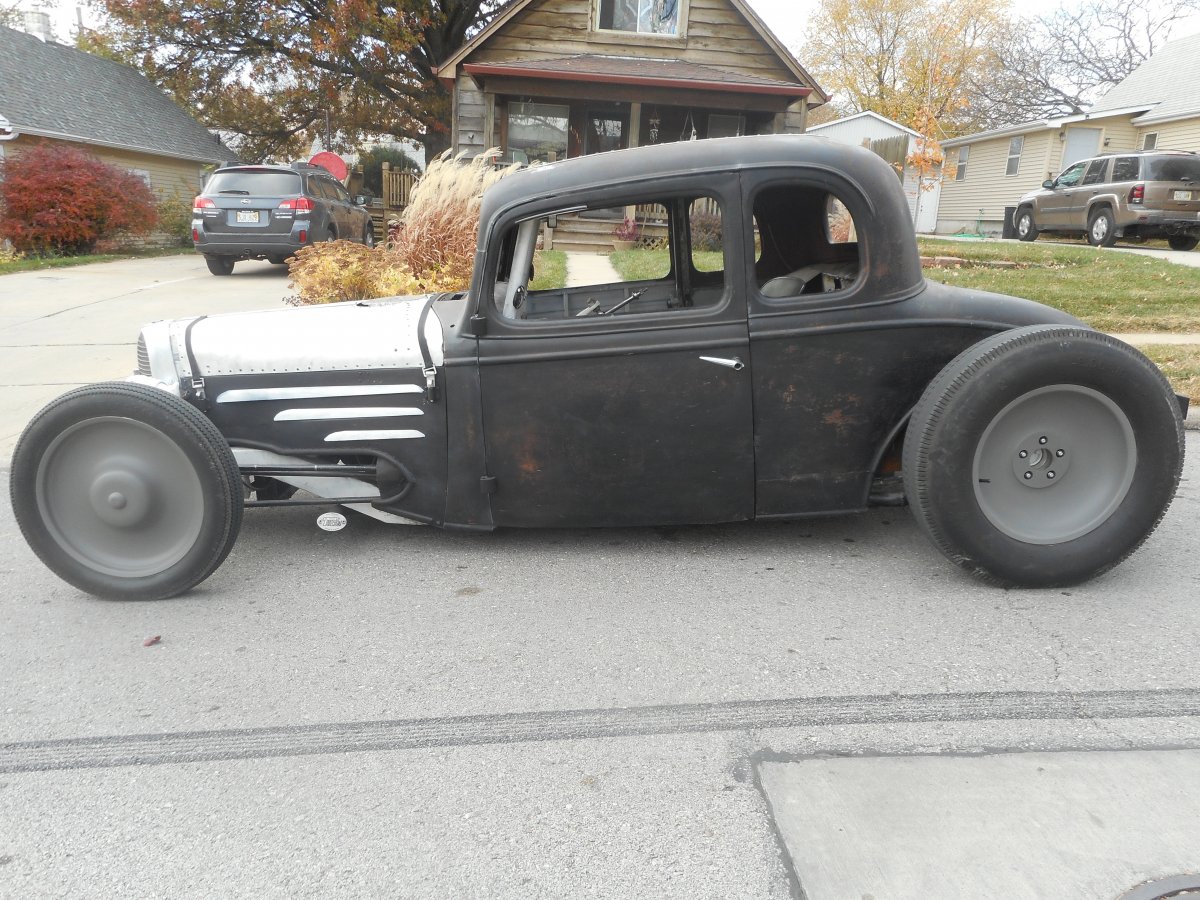

    This will be my first hotrod build, all of my previous builds have been 60's muscle. I'm going to be learning a lot on this one. I bought this jewel back in July 2021 and have enough done to start a build post. Still on the trailer when deciding to either go in the garage or the shop. The garage won till I get the shop ready. The 33 body is complete with fenders and running boards, but no interior, it's a blank canvas on the inside...I mean nothing, no steering column, peddles, or wiring.

  2. Nice start to a 33 ,is it on a ford frame??
    Good to have the fenders ,they are a hard item to find .

    It does have a 32 Ford front axle, but the frame is a custom 2 x 4 square tubing.
    Nice 3 window
    Stogy likes this.
  4. Is all the wood removed from the body ??

    The 33's have plenty of room inside compared to a Ford but their trunk is a little smaller. If the body is still sitting on the wood rails, the vin tag is mounted by the p***. seat.

    All of the wood has been removed and replaced with steel.
    1) New fire wall
    2) Steel floor from fire wall to trunk
    3) Top of cab has been capped off with steel
    4) Next is the doors reenforced with steel.
    Stogy, Okie Pete and TFoch like this.

    68 327 with camel hump heads and a TH350. The diff is an 8" ford
