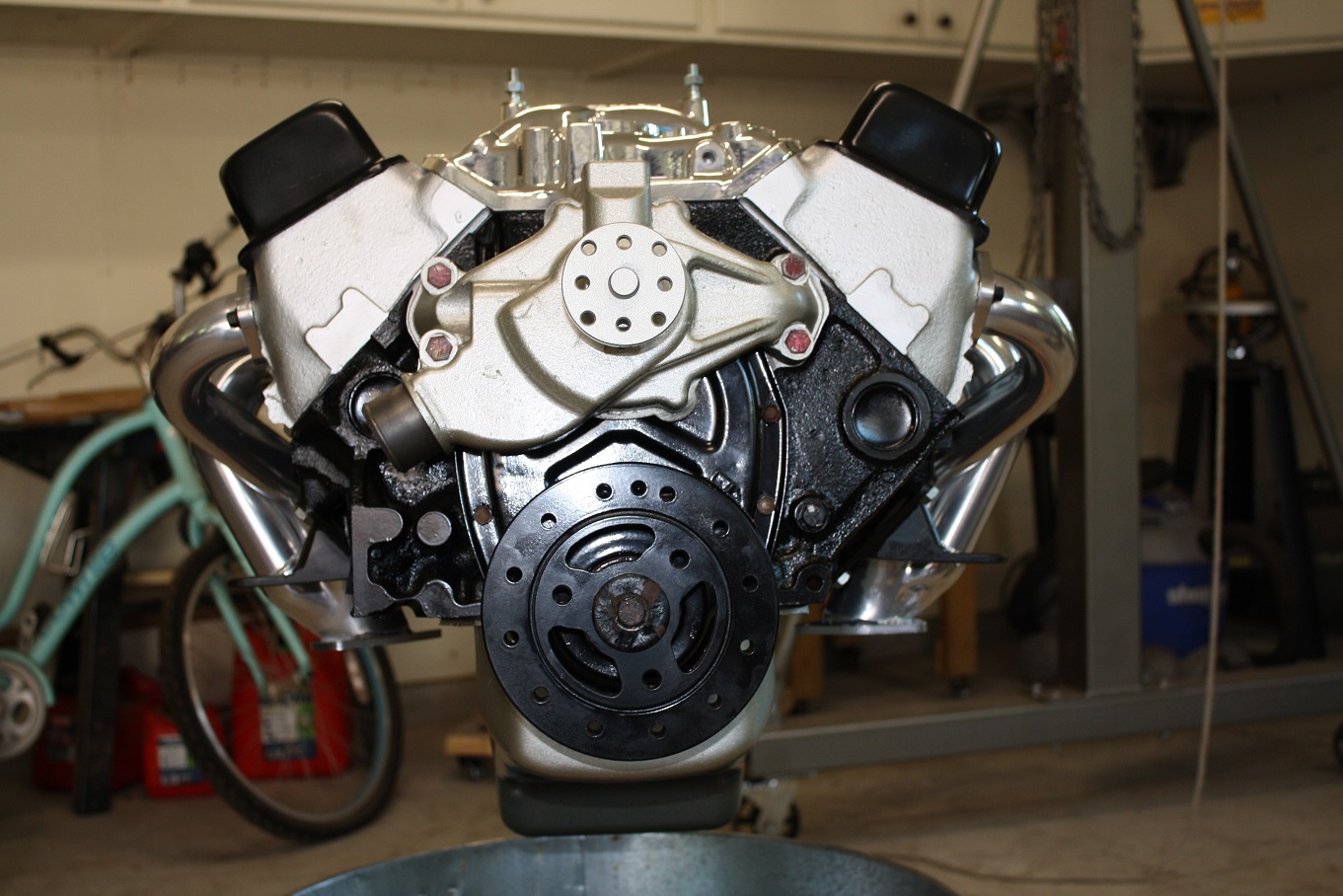

    Well I got side tracked on the frame and decided to finish the ***embly of the SBC engine, still waiting on a few S/S bolts to complete the build. IMG_3398.JPG IMG_3399.JPG IMG_3402.JPG

    Are those the trick flow heads ?
    Stogy and rbrewer like this.
  3. mixerman
    Joined: Jun 23, 2021
    Posts: 255
    mixerman
    No, they're just cast iron 291 heads painted with high temp aluminum

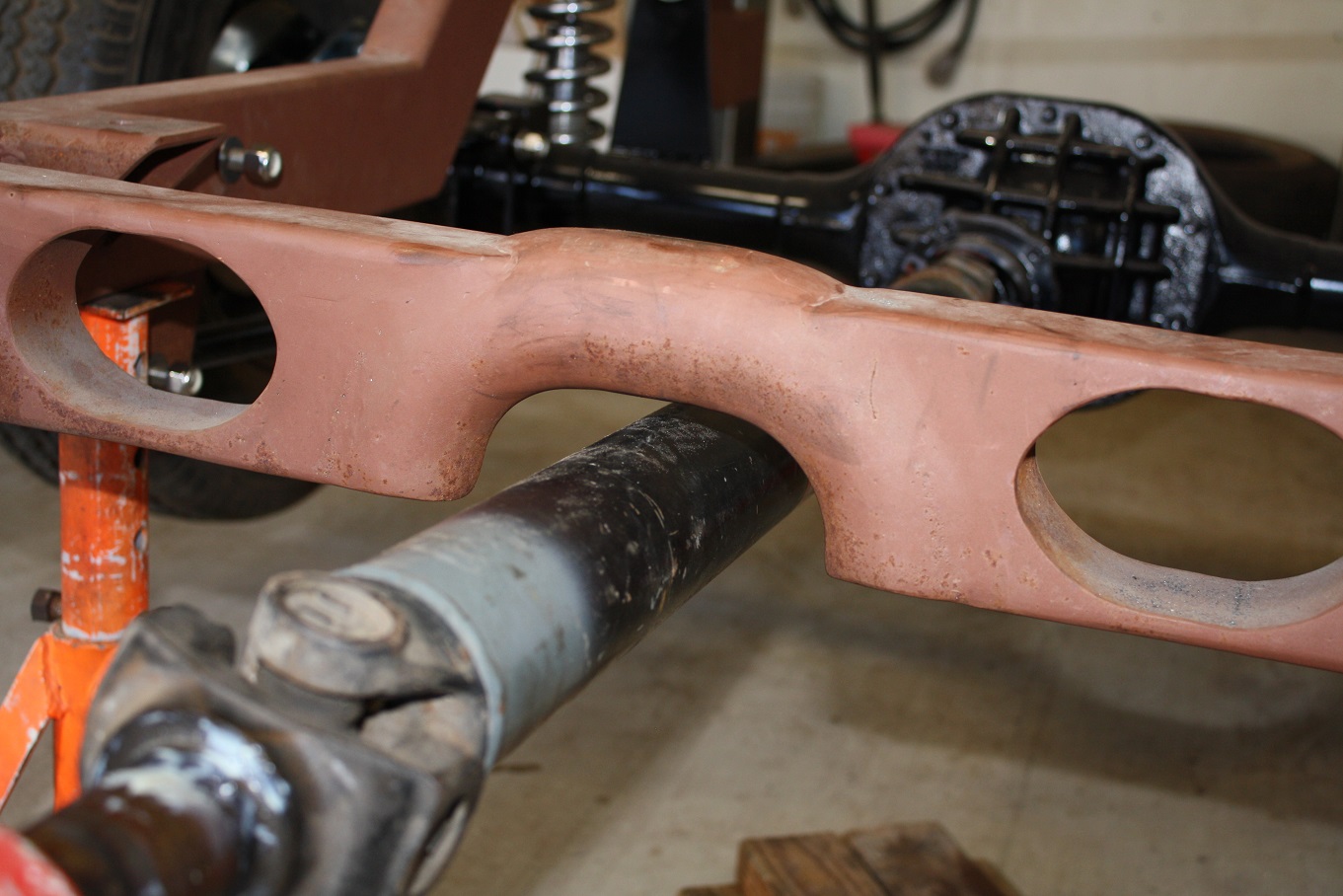

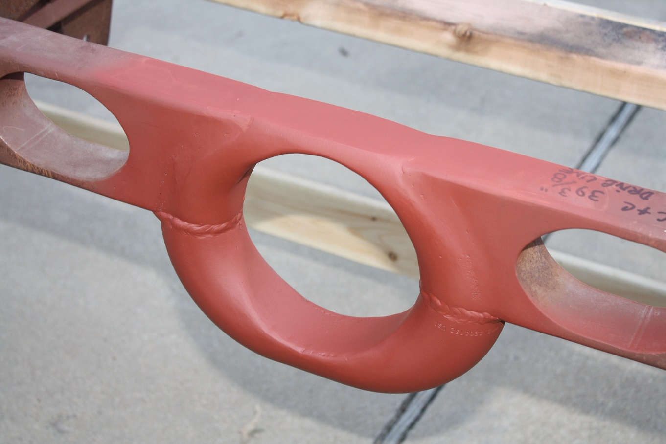

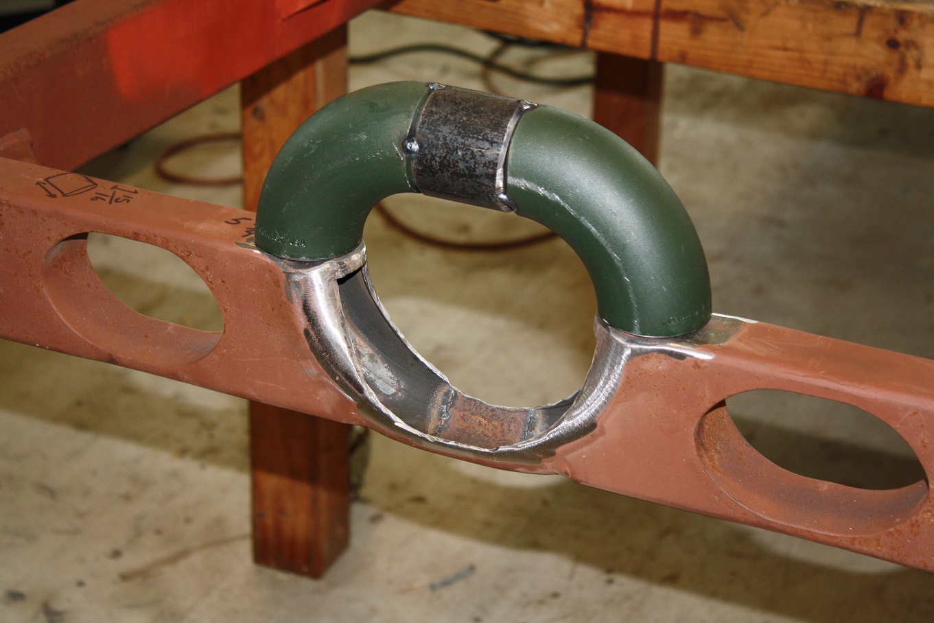

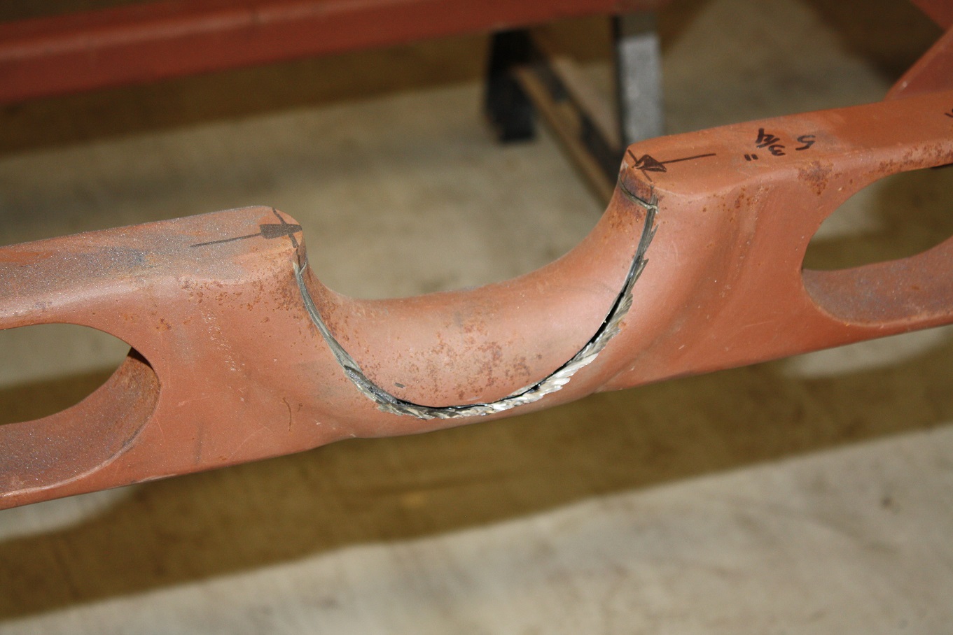

    Back on the frame, when setting up the engine angle at weighted ride height I noticed the the drive line would hit the top up the "U" cut out in the crossmember. Well a little cutting is needed.
    In this pic the rear suspension isn't even clost to being at weight ride height.
    Here is what needs to removed for the right clearance of the drive line. The frame is upside down. This section of the crossmember is made of 2" long radius 90 and a 2" straight between the two. It was a strong section untill I cut half of it out.

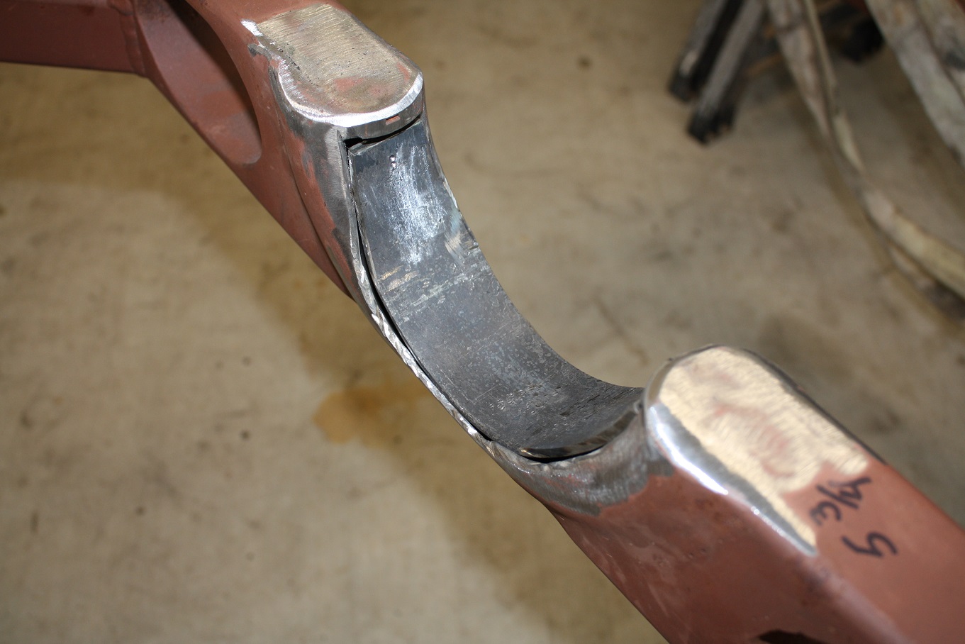

    So to get the structural strength back in the crossmember I mirrored section of pipe to the "U" cut out. Also it can serve as a drive shaft loop. With the suspension unloaded now the mirrored section needs to be cut out for drive line clearance.
    Here's the new section installed to be welded back in.
    The finished result, crossmember is strong again.

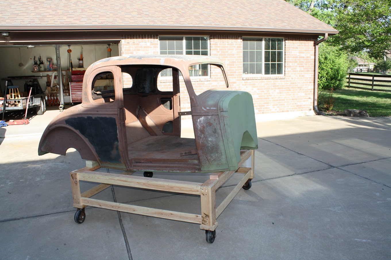

    I got a new toy for the 33 build
    Rolling the body out of the garage into the shop
    It took me a half a day to get the adapters made to mate the body onto the rotisserie

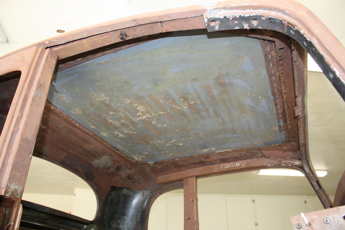

    When I got this project all of the wood had been replaced with steel, some parts were done good and other parts I'm going to have to redo. Overall it's a pretty damn good start. The roof was installed real good, no redo here.
    Firewall and trans tunnel is all new, but the firewall being flat it has a little warpage, but not going to worry about it at this time.
    The part I'm most happy about is the under floor, really structrued good.
    catdad49, 35cab, tb33anda3rd and 7 others like this.

    I love the car! The transmission mount looks well made. But the drive shaft looks to be too short. Is that the length with the drive shaft located in the pinion yoke and the u joint bolted in? If it is the transmission yoke of the drive shaft does not appear to be far enough into the transmission tailshaft. It might crack and break the tailshaft housing while spinning under load.
    That looks to be schedule 60 green domestic pipe elbows. Made in the USA!
    It looks like Welbuilt brand name pipe. Good stuff. I can almost read the heat numbers on the side of the pipe. I spent some of my misspent life working in a pipe yard.

    That drive shaft was used to get a ball park clearance for the "U" cut out. I had an extra drive line from my 300ZX that I had cut down to the proper length. Almost ready to have a pic of the complete rolling ch***is.
    Thanks, I spent my early years as a pipe fitter...slash...metal fabricator, before I became a Design Engineer.

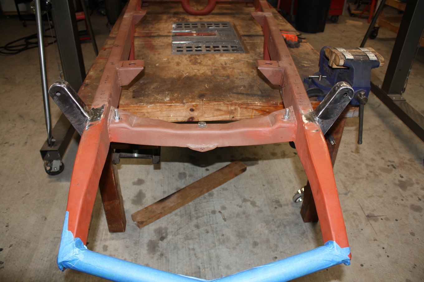

    Two more things done to the frame, fish plated the rear angle frame splices and shock brackets.
    The shock brackets aren't anything special, but they get the job done. Maybe they will look better with primer on them.
    It helps when you are able to 3D model the build and send the files to your brother-n-law to lazor cut.
    The rear of the frame I wasn't sure if the previos owner put any fish plates on the inside of the frame splices. So I decided to add some for peace of mind. They will be hidden by the body.
    Next will be the streering rack, brake lines, and exhaust.
