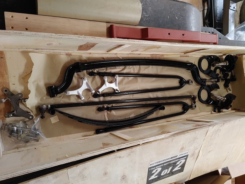

  11. Kainalu
    Joined: Oct 11, 2022
    Posts: 5
    Kainalu
    Do you know what front disk brake conversion kit this one is?

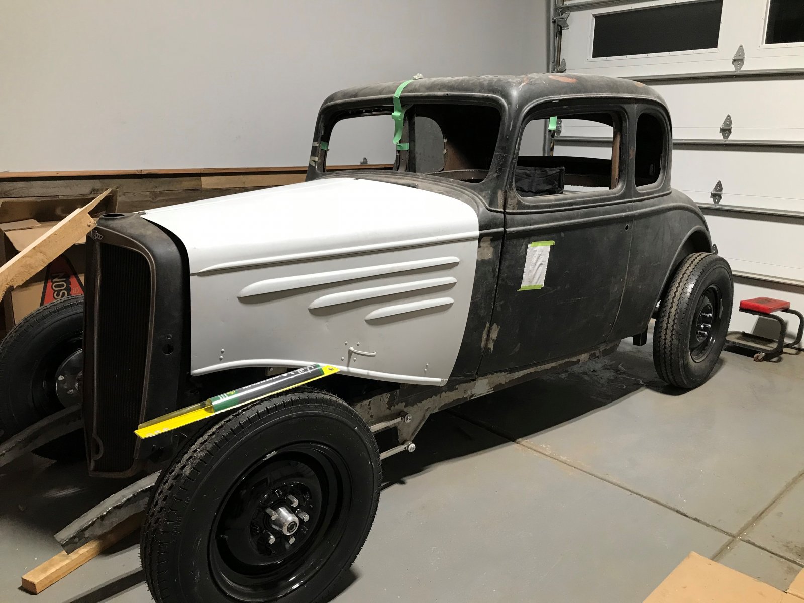

  15. mixerman
    Joined: Jun 23, 2021
    Posts: 255
    mixerman

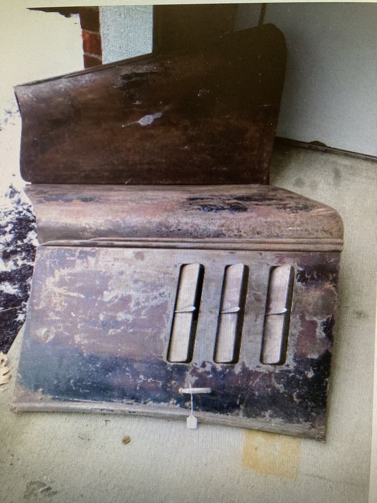

  18. Hey bug your hood looks like a 34 car hood , 34 36 truck hoods have up and down louvers . 20170929_212942.jpg
    This is my 33 chev 3 window with a Canadian hood on it ,all Canadian cars came with this hood in 33 20200217_101547.jpg 20200217_101633.jpg

  20. That is an American 33 chev hood, our cars were not available with that hood ,although the top looks the same ,I might have some extra 33 canadian hood sides .Be the first on your block to run them LOL
  21. Bug ,your 34 hood on your car appears to be a standard hood . Master hoods had a piece of chrome along the edge of the louvers and standard did not . Maybe see if somebody filled the holes along the louvers on your hood ??? A 34 standard hood is a tough hood to find .

    Wood Remover Thanks for your incite! If you could post a pic of those Canadian hood sides I would like to see them.
