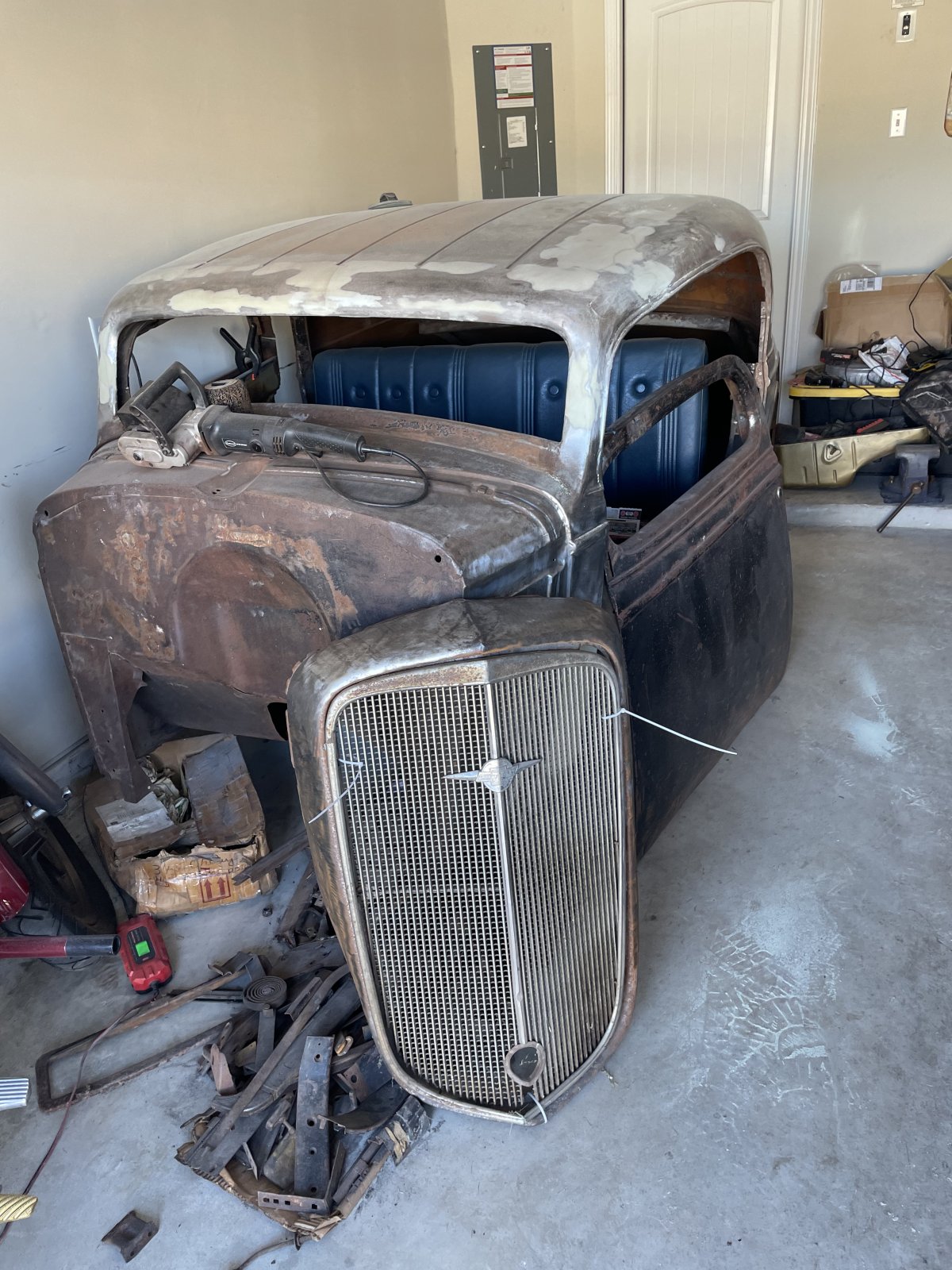

    Got the grill shell mounted, and the head lights in a mocked up position.
    Now my question:
    The headlights are pretty much even with the grill shell. Do they need to go ahead are further back?
    This view is with the front wheel turn full to the right. It appears to have enough clearance.
    This at a different angle.
    The back side of the grill shell. I still nedd to add a couple of pices to these cut outs. I have no idea why they were cut out by the previous owner.
    Closer look at the grill shell mounting to the crossmember.

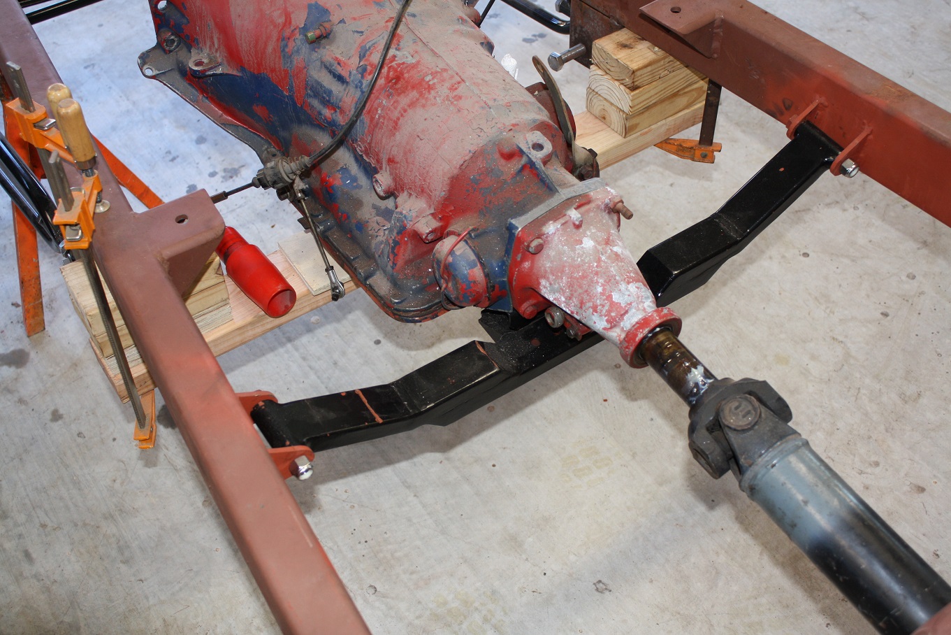

    This is for "NHbandit"
    1) The crossmember main body is 1 x 2 x 3/16" rectangle tubing.
    2) The outer mounting is 1" dia. x 2-1/2" long with a 1/2" hole.
    3) The trans mounting plate is 3/8" TK x 5-1/2" wide and is long enough to cover the bottom of the rectangle tubing, with 3/8" TK gussets.
    Bottom side of crossmember
    The brackets that attach the crossmember to the frame. I chose to bolt it in the frame to make removing the trans if the need arises. Brackets are 1/4" TK.
    This shows the bracket angle of the engine and trans to the frame.
    I know it's over engineered, but I always do that to my designs.

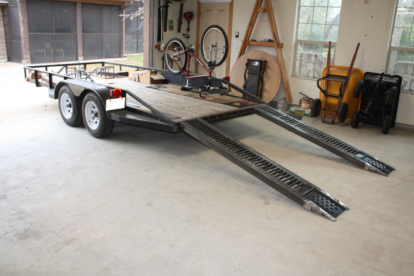

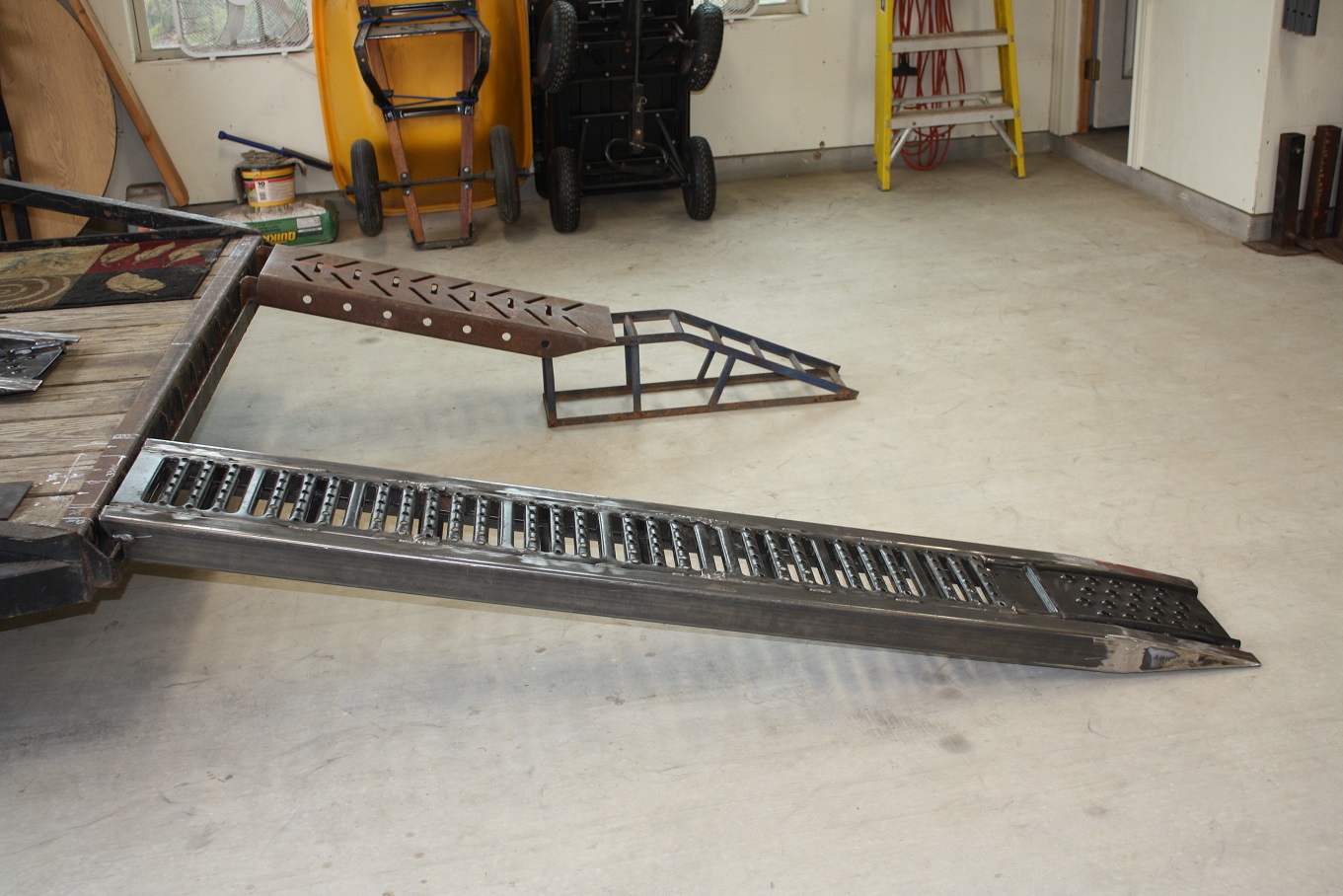

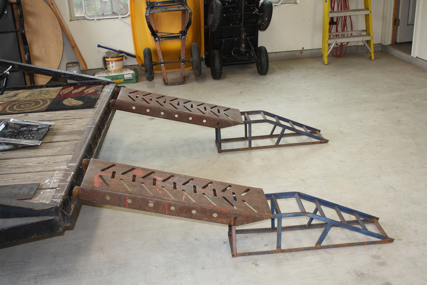

    Another one of my non-money spending project, indirectly related to the 33. The material was already purchased before the wife had me slow down on the spending for the year.
    Trailer ramp upgrade....
    This is the ****py ramp setup that I had to work with...a accident waiting to happen for sure.

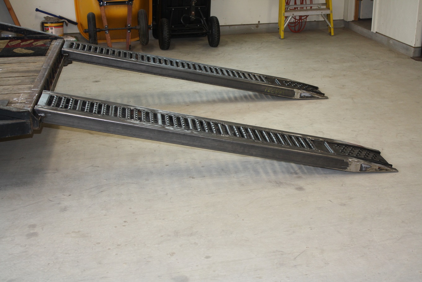

    Here is one new ramp compaired to the old setup.
    Both ramps, so much better.
    My custom trailer I built myself, just a tad bit heavier on the bottom side than a normal trailer.
