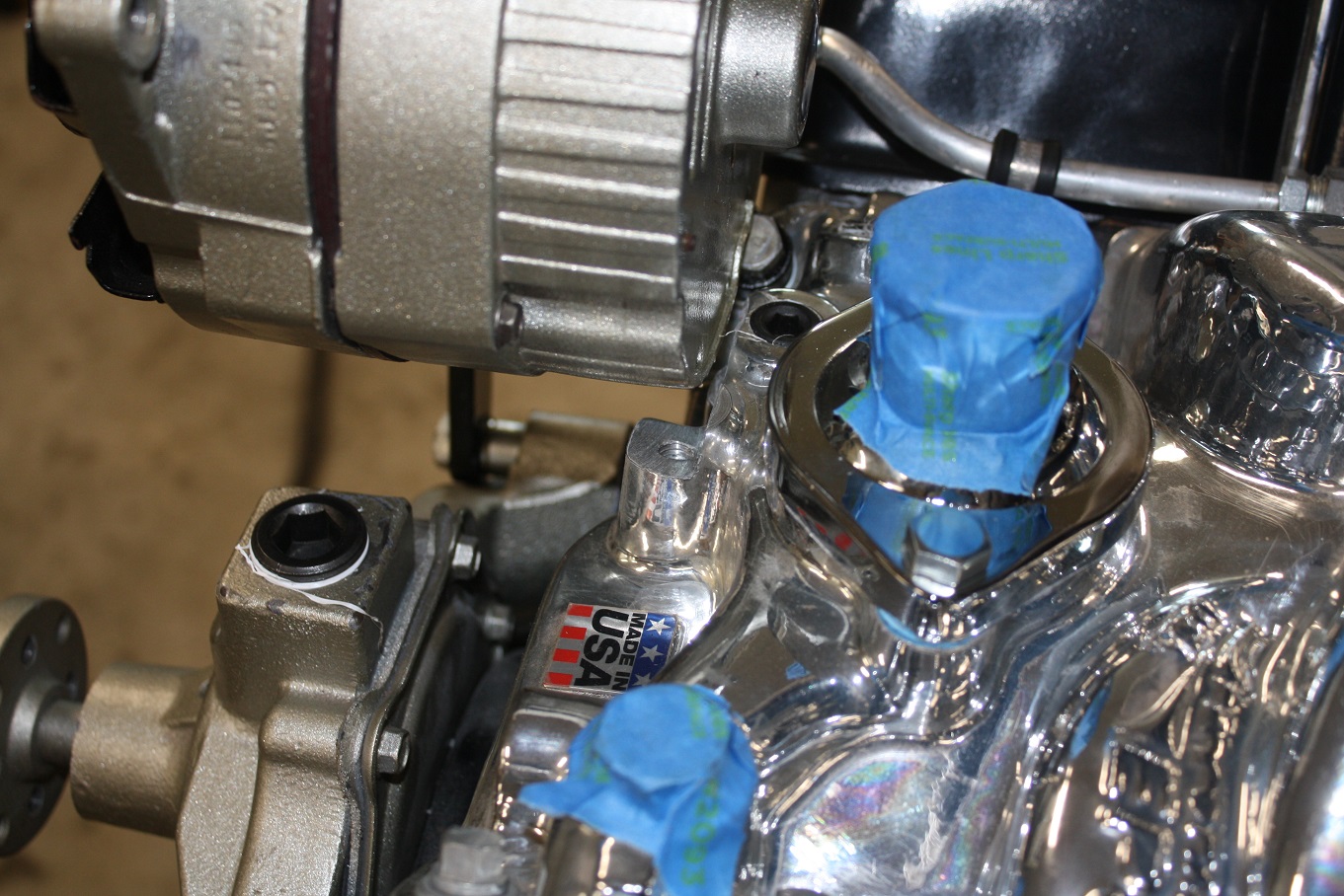

    With some modification the alternator bracket is mounted to the top of the motor.
    The outer mounting ear/tab had to be moved out to get the pully grooves to line up.
    Then I had to notch the intake manifold so the alternator would be able to get full range of motion.
    And lastly waiting for the new drive belt.

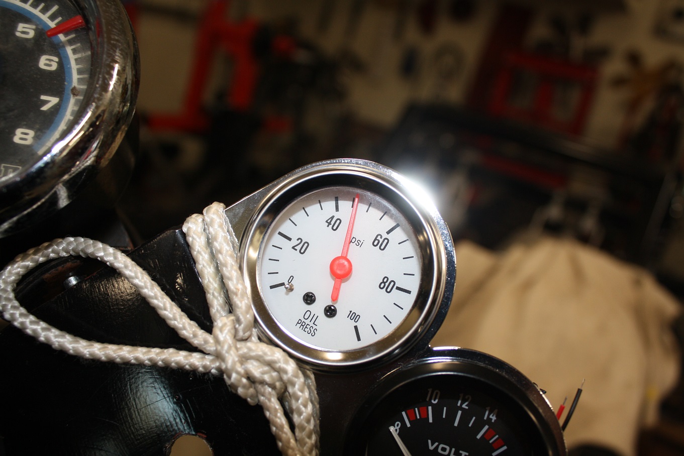

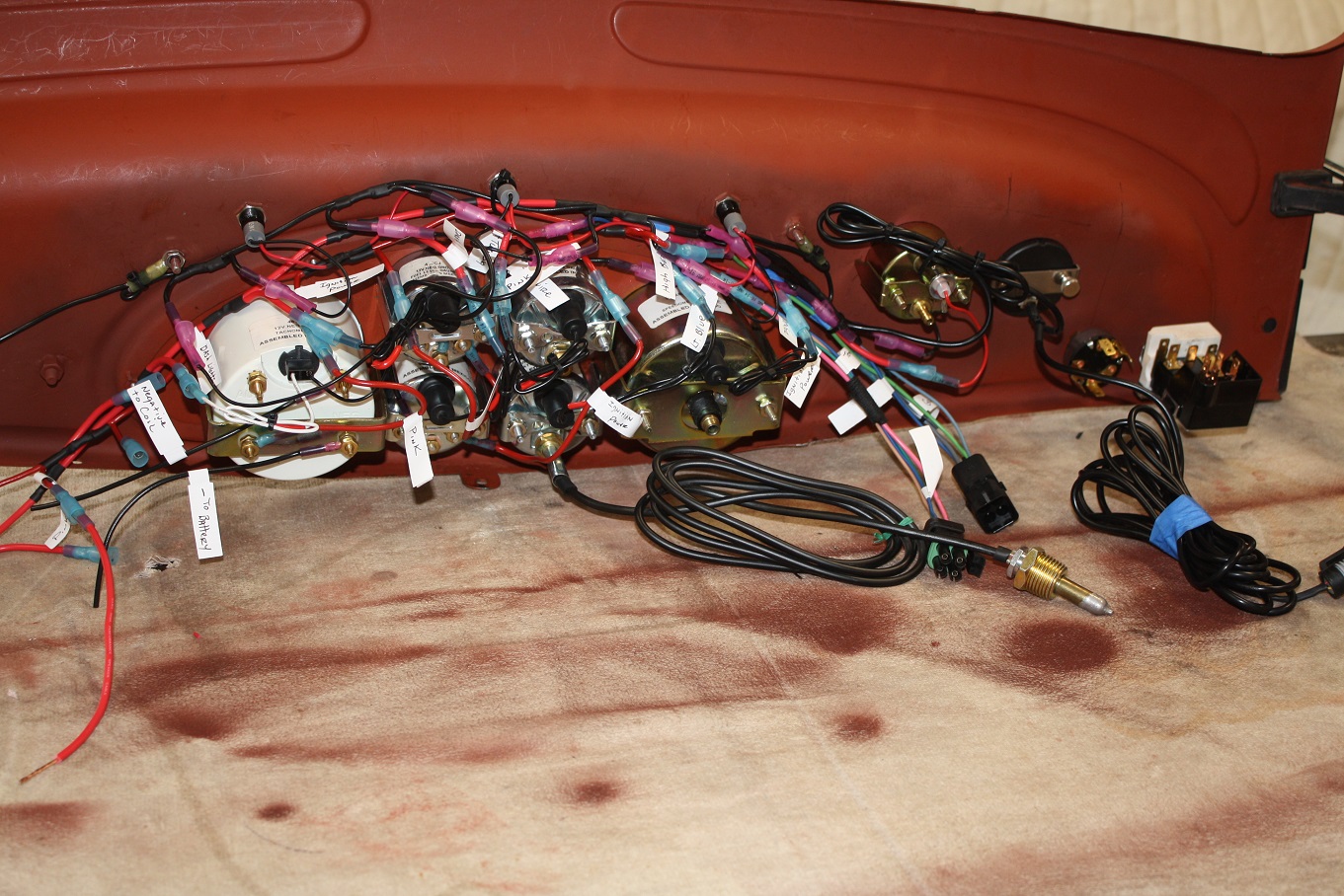

    Engine is in the ch***is and waiting on a fan belt and a 3/8" tube spacer to finish up
    the idler pully for the crank and water pump pullies.
    Washers mocked up to get spacer length.
    I chose to start up in the frame with the exhaust hooked up, so to better hear engine noise.
    My rat nest of wires for all of the gauges.
    Everything I'm watching on start up.

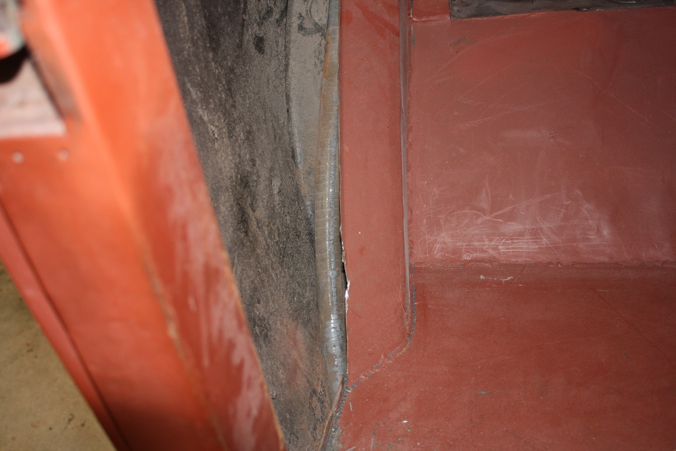

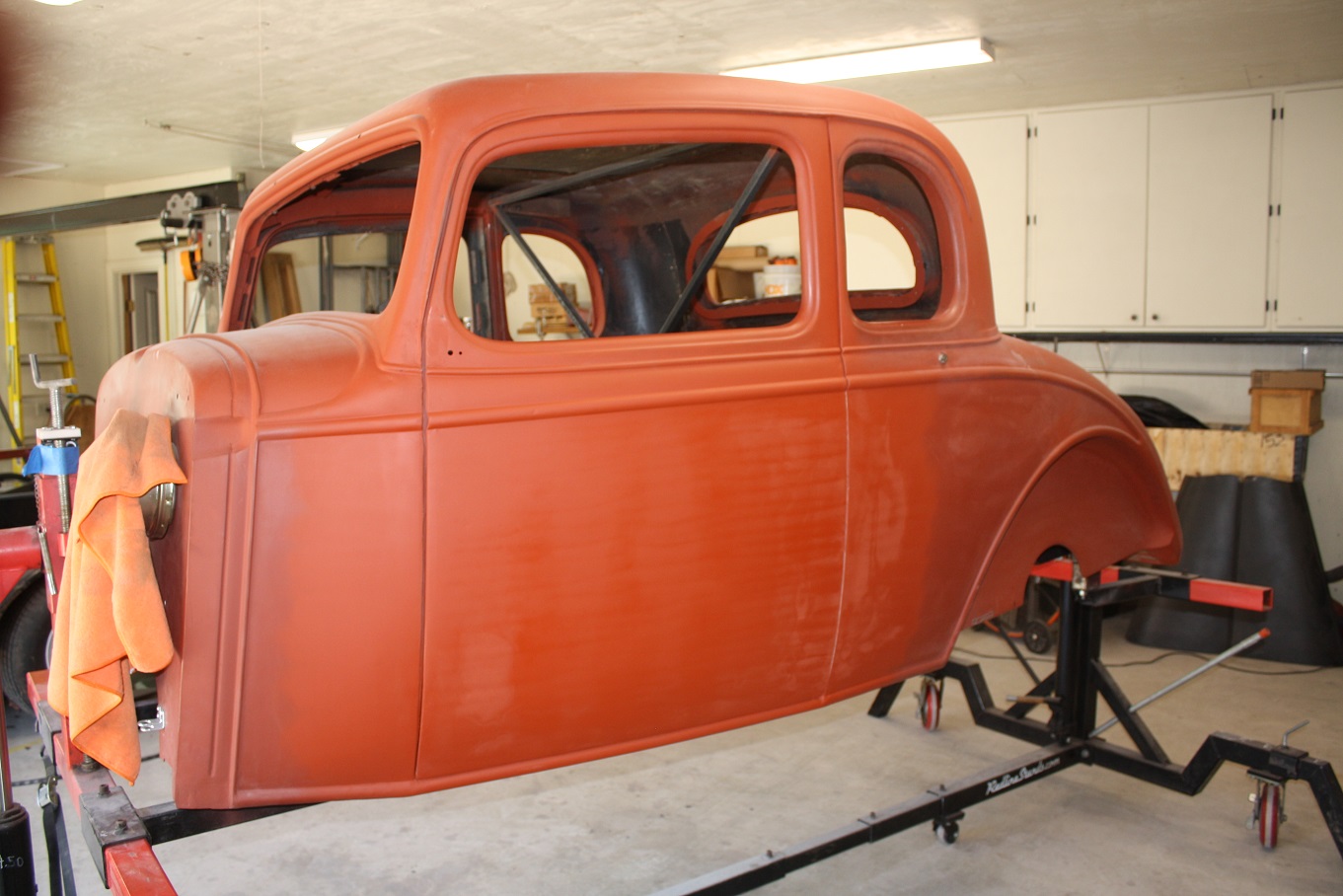

    Its been awhile since my last update, so here goes.
    After getting the doors mounted and the door latches worked out, I finally got around to working
    on the door gaps. I don't have a before, but they were really bad, and they aren't perfect.
    Driver's side
    P***enger side was really bad. The gap between the bottom front body panel and the door was at least a 1/2" and a lot of metal had to be added, as by all of the shinny metal.

    It's finally all one color even if just primer.

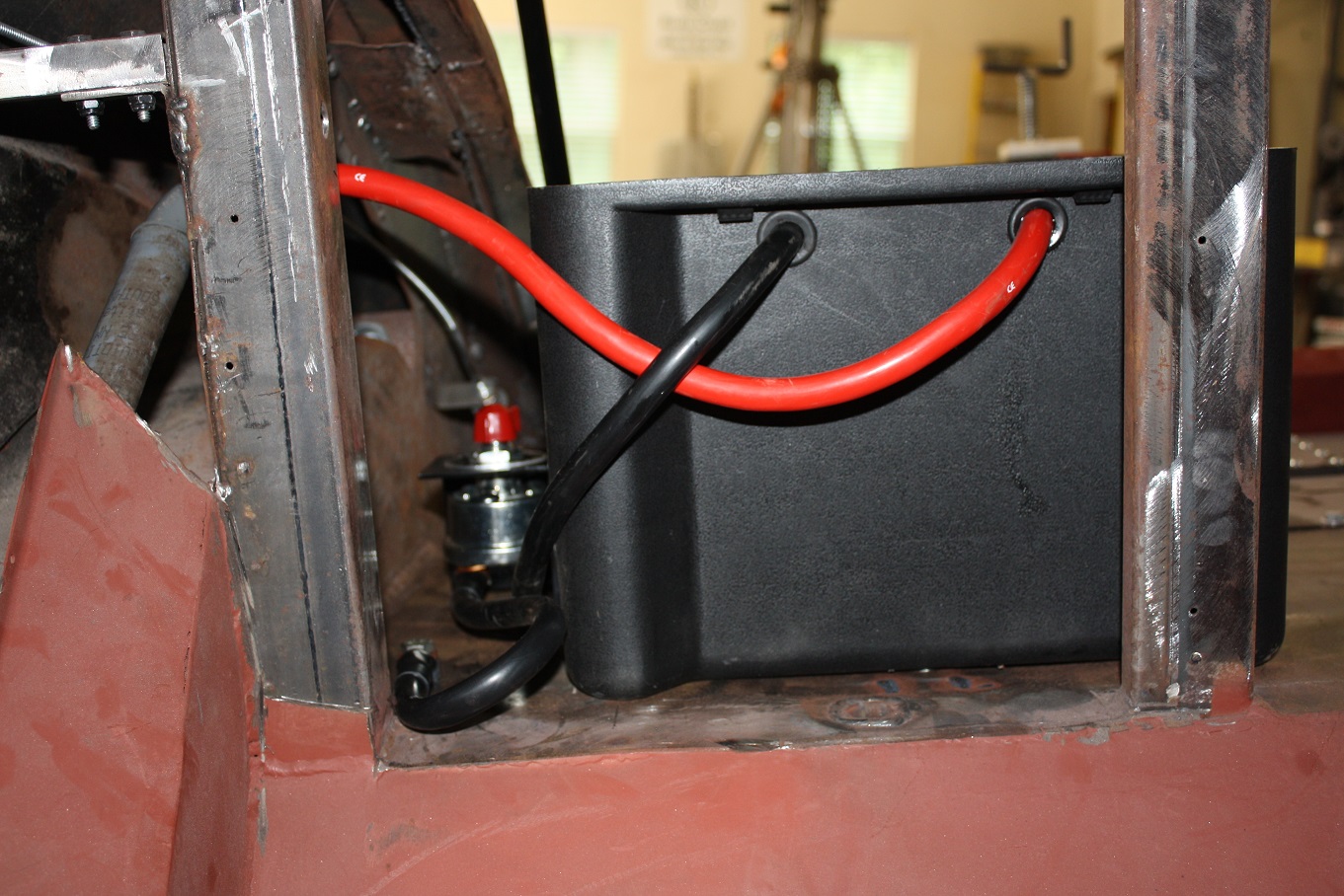

    Finished one more task on the 33.
    The sealed battery box in the trunk area all mounted.
    The previous owner do do this right and installed all plastic romex tube all the way from the trunk to the front firewall, low chance of a arc out on the inside of the body.
    Here is the tube running just p***ed the trunk area going thru the p*** side floor rocker panel.
    Here it exits out of the rocker panel thru to the firewall.

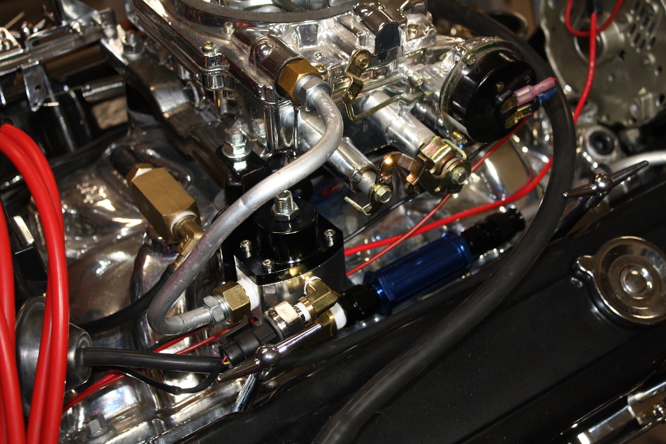

    Not much done to the 33, for I've been on lite duty for the last month. The battery box in the trunk has been put on hold, so this gave me time to study up on the edelbrock carburetor. From what I've read this carb doesn't like anything over 5 to 6 psi fuel pressure, and my machinal pump was putting out between 9 to 11 psi. Well now to install a FPR and a inline fuel filter between the pump and the FPR.
    I went with a electric fuel pressure gauge so I could read it inside the cab. The directions said to put the FPR as close to the carb as possible, I hope it's close enough.
    I also put another fuel filter before the fuel pump
    TFoch, swade41, brEad and 4 others like this.

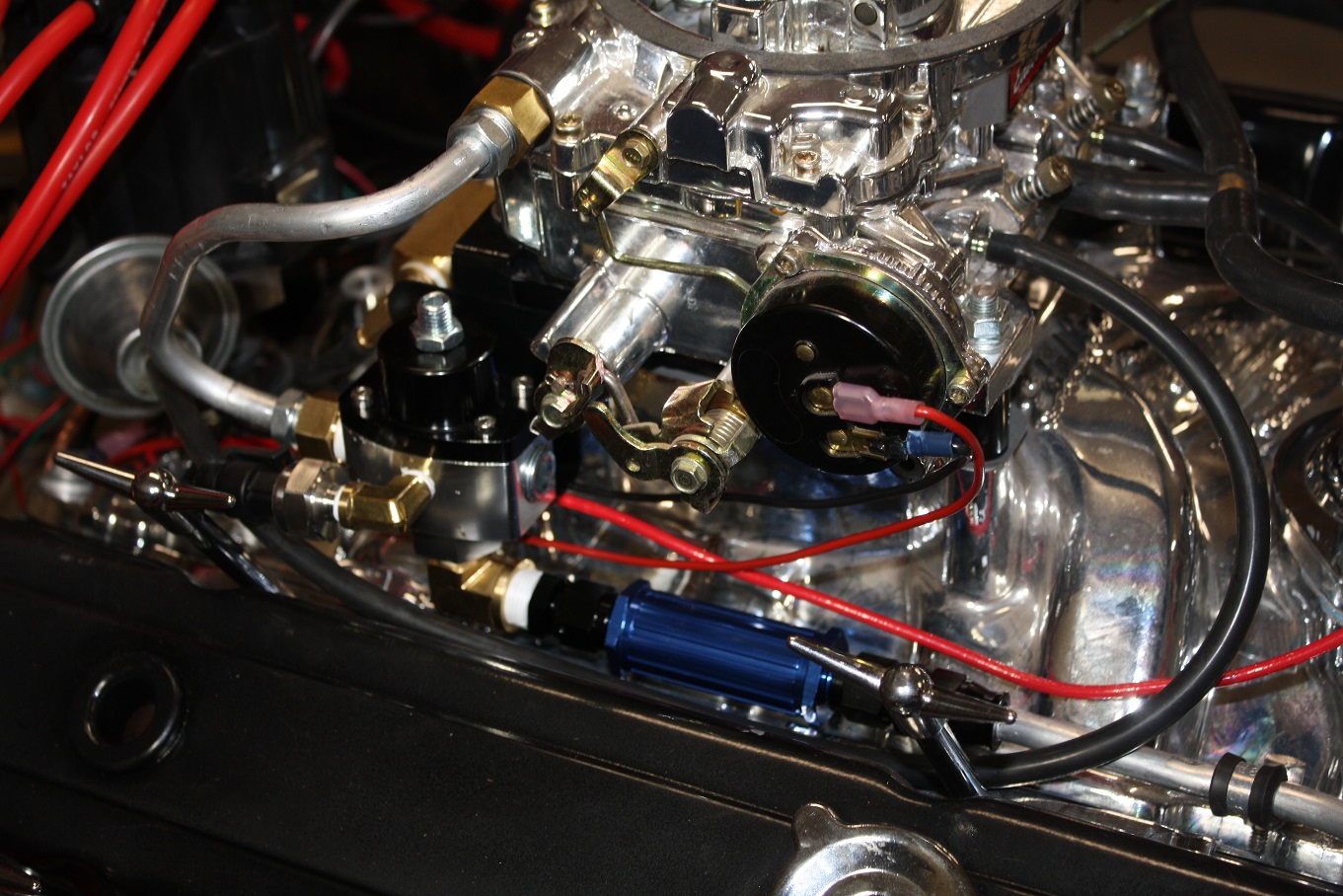

    After getting the fuel line ***embled I desided to pressure test the section from the pump to the carb for leaks.
    (8 psi)
    I'm glad I did, two seperate fitting were leaking. (before)
    No leaks (After)
    TFoch, swade41, brEad and 2 others like this.

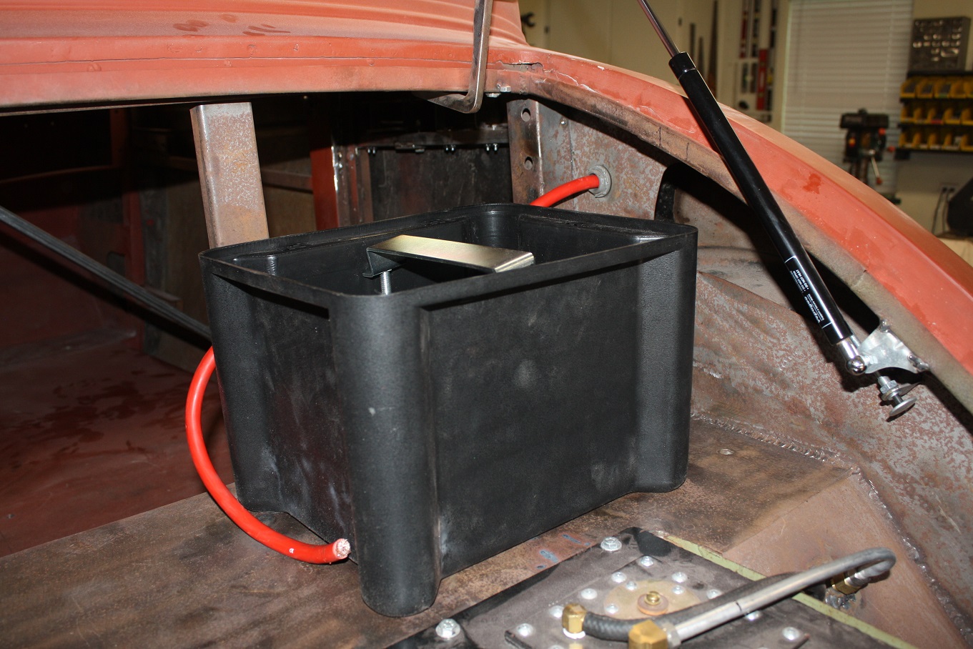

    Finished up the trunk mounted battery box today.
    Got the battery cable disconnect installed, along with the vent tube.
    View from inside the cab.

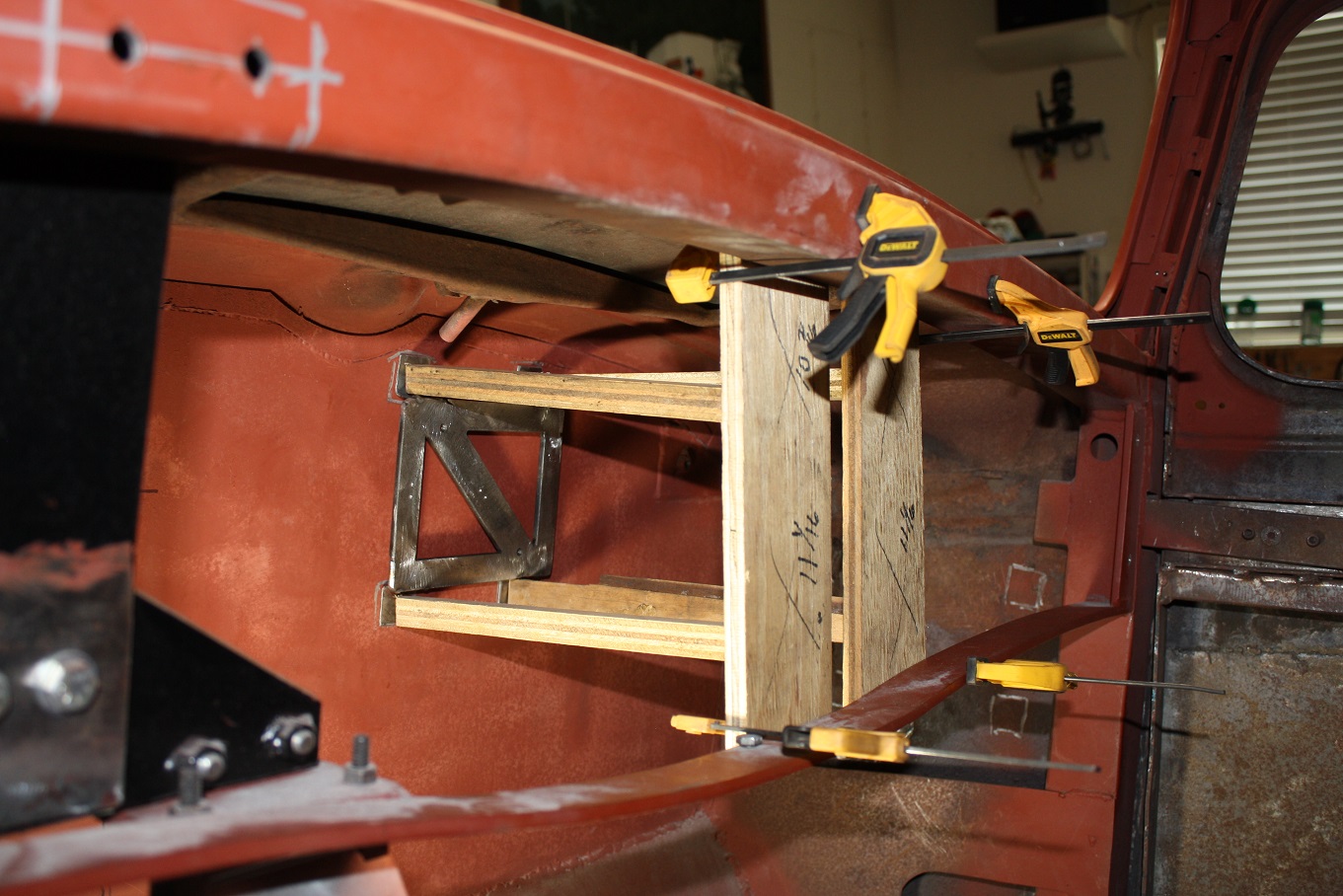

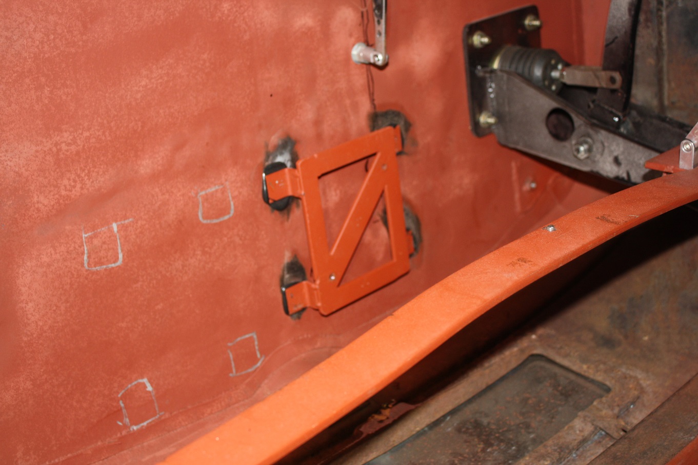

    After mapping out every position under then dash for the fuse panel, I finally come to this location that allows for each harness to reach its final junction.
    I plan on using 3M's panel bonding 08115 to attach the mounting bracket for the fuse panel to the firewall. Right now it's just mocked up in that position and my brackets to put pressure on the glued joints. Still waiting for the glue to be delivered.
    TFoch and tb33anda3rd like this.

    Fuse panel is now bonded into the top of the firewall, along with my make shift clamping fixture.
    As hard as I tried pulling on the fuse panel mounting bracket, I couldn't pull it off.
    Now I need to make harness clips to bond to the upper cowl to keep each individual harness up and out of the way.

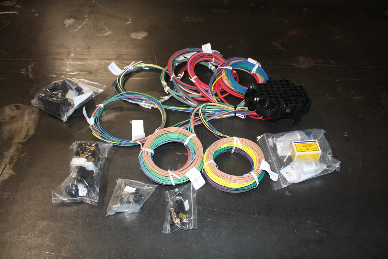

    Finally got the dash electrical finished. It took me way longer than I had expected.
    I still need to get a Head light sticker for the switch handle, and I plan on adding a A/F regulator later on.
    Now for the rat nest of wires, everything is plug and play, with the two main harnesse connectors (weatherpacks), and all circuits labled with waterproof lables.

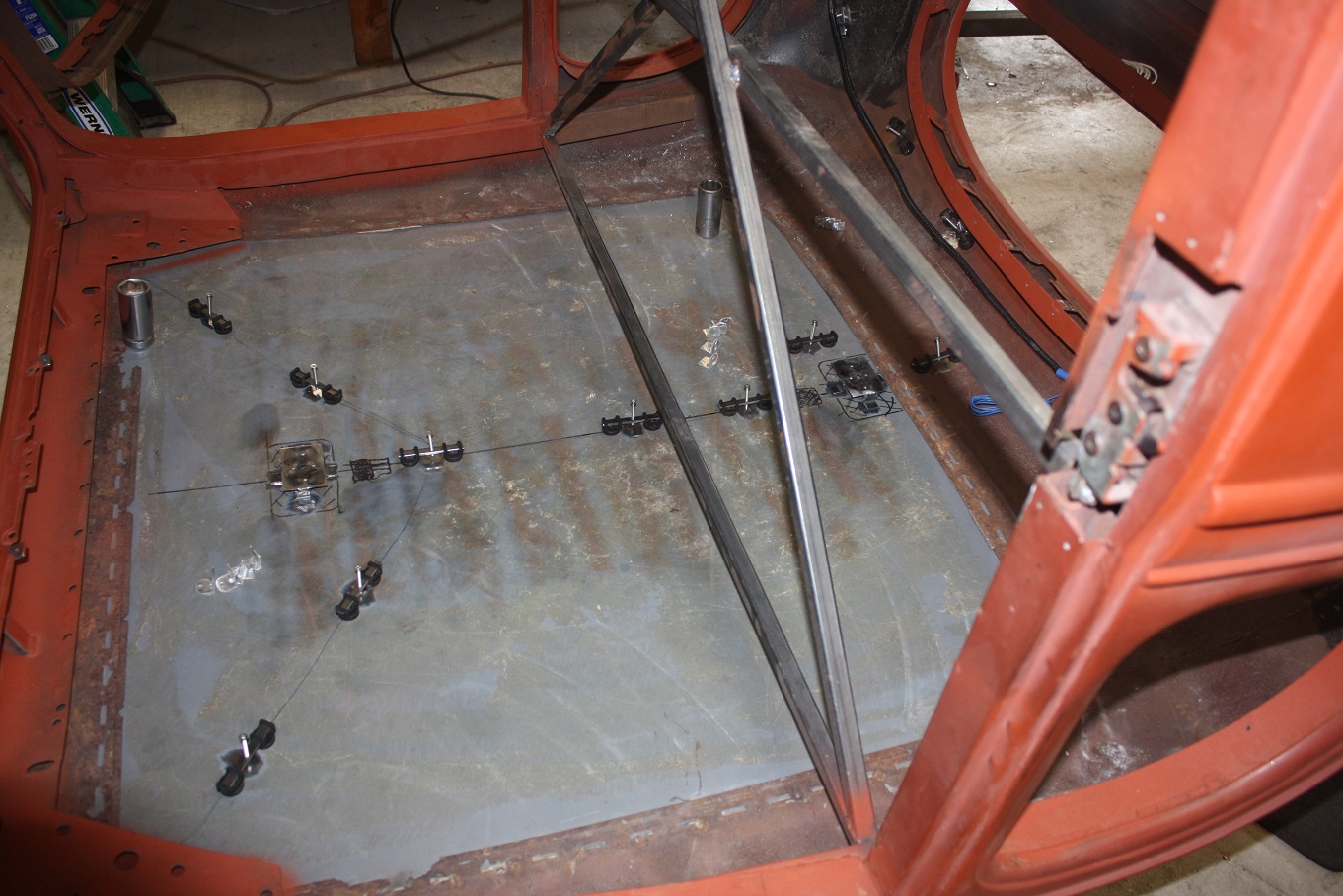

    A couple more electrical functions finished inside of the coupe cab.
    With the body turned upside down in the body rotisserie it made installing the aluminum angle clips a breeze.
    I used wire tie magnets with a modified 1/8" strip with a 8-23 tapped to house a 1-1/2" screw to keep pressure
    on the clips using 3M panel bond. I went with duel inside dome LED lights and bonded them to the roof of
    the cab also.
    Here all the brackets are bonded and pressure to hold them in place.
    24 hours later and the clips are boned. I did use a 120 volt to 12 volt converter to map out the electrical to make sure my wiring was correct.
    I believe I'll have enough light inside the cab.
    Everything is quick disconnted to make for easy repairs later if needed, each light also has a switch to set for door, off, or on. White wires are for the door switches.
    LED lights have a few more wires than incandescent lights, blue wire is for third brake light.

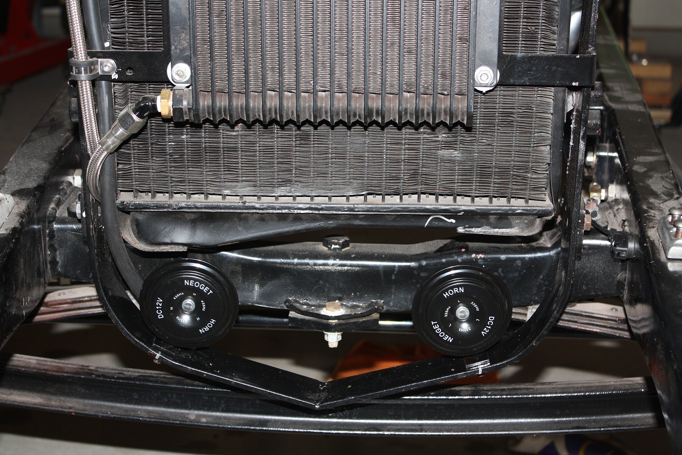

    Finally got the 3rd brake light installed after its multi-state trip by the USPS, it took 5 days to go from Nebraska to north Houston terminal and stayed there for two days then went to the south Houston terminal for another couple of days, (I live abour 90 miles from the N. Houston terminal) then it went to Oklahoma city and was there for three days, then went to the Dallas terminal for anothe few days, then back to N. Houston for another couple of days. I guess they figured it out and it made it to my house...and yes the address was correct on the package. That brake light has more miles on it than my 33 so far.
    And to end the day with installing the horns in the bottom front grill.

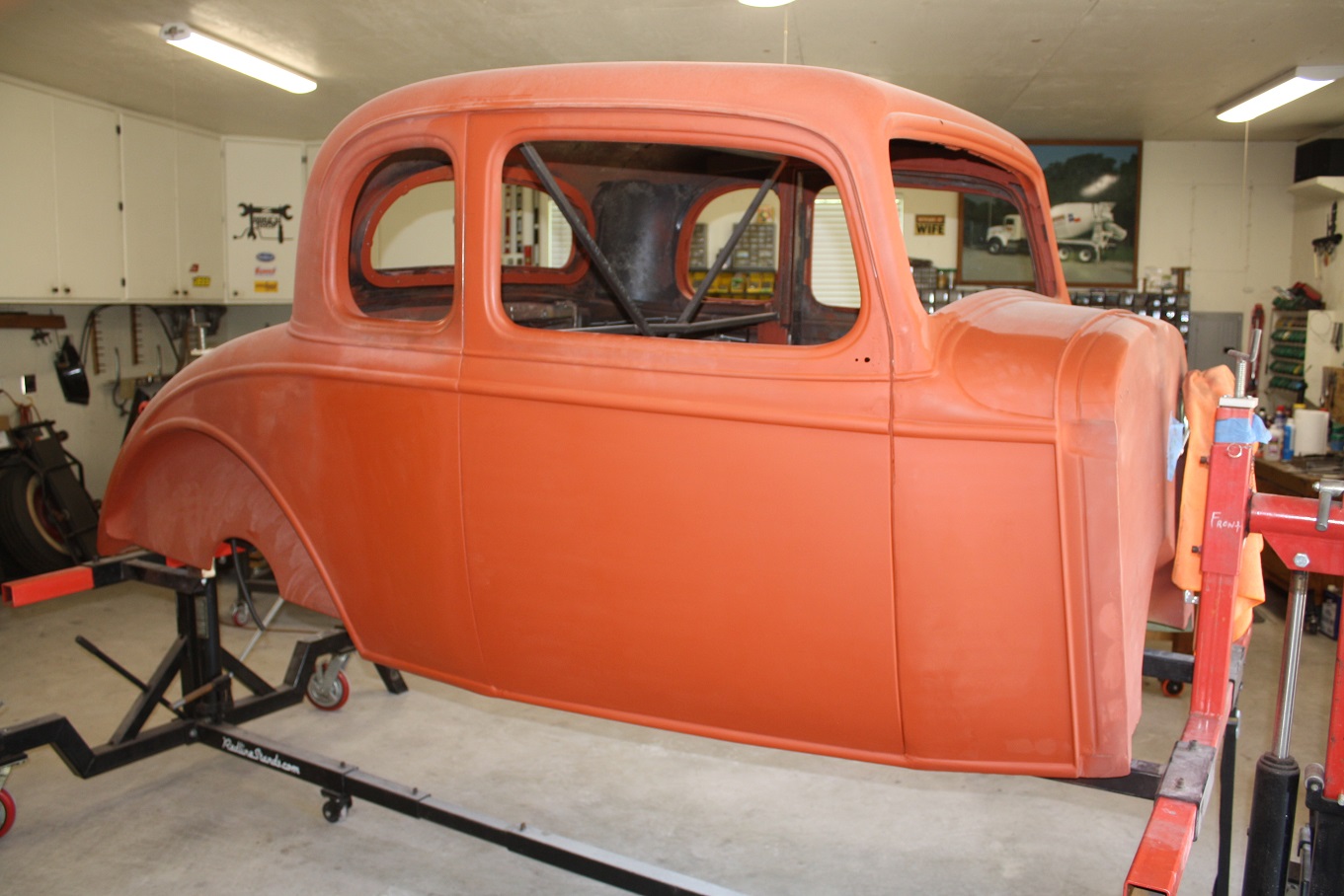

    It's time to put the body back on the ch***is.
    Getting set up for separarion.
    Separation complete.
    Now the ***embly begins. Spent the last part of the day finishing up the lights and blinker wiring hook up. IMG_4950.JPG
