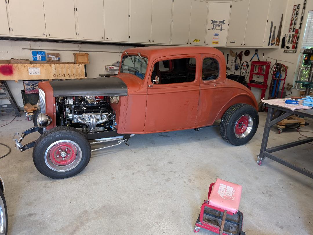

    While I'm waiting on parts to be shipped, this was a good time to finish some needed metal work on the "B" pilor.
    Driver' side
    P***enger side.
    A little bit of primer and the door latch cover plate installed.
    The p***enger side will be the only side that will lock from the inside...lock knob installed
    Driver's side
    Rear quater window granish installed, now I'm trying to deside if I need to install metal around the entire window granish. Simular to the one on the rear window.

    I'm so close to doing the first drive of this build.
    This is the first time in almost 4 years the 33 has sat on new rubber and just a few items to go for her first road test, and for the first time I'm not waiting on parts to be shipped. I have everything to finish except being painted.

    It's been awhile with trips out of state to back and nerve problems, I'm now making more progress on the "33"
    I'm pretty much finished up with items going thru the fire wall. I desided not to hide to much going thru the fire wall for ease of maintance.
    It however looks a little bussy, but a somewhat orginized bussy.
    I chose to make everything going thru the fire wall with a bulk head fitting. The only thing not is the speed cable and the temp gauge.
    Then I needed to address the weather pack electrical bulk head fitting, by itself not to pretty.
    So I made a cover for it.
    Electrical connection covered.
    It still looks bussy, but with the hood installed it should hide a lot without stooping down to look.

    I have a update on my overheating problem. I really wanted to do one issue at a time but, that turned out to be a lot of work, so I did all of the great soluations that you all have suggested.
    1) Added a lip to my existing fan shroud. (Tested the air flow with 3 x 3 plastic bag and it ****ed it to the grill real hard)
    2) Positioned the fan to the somewhat correct distance in the fan shroud.
    3) Moved my transmission cooler from the middle of the radiator to the bottom of the radiator, which is actually hanging in mid-air, not covering up any of the radiator.
    4) I changed from a 16psi radiator cap to a 13psi cap.
    5) Added a radiator overflow fluid can. (which doesn't do much for overheating)
    6) Had to much ignition timing and got it set 10 deg. (It was15 deg. and hard to start.)
    7) Fuel pressure set from 1.5psi to 7psi.
    I then fired it up and put a 36" shop fan in front of the radiator for added air flow.
    I left the radiator cap off so I could see when the thermostat opened up, then top off with anti-frezze.
    Put the 13psi radiator cap on and waited for it to fully warm up, then shut her down when it got p***ed 200 deg.
    So now I'm thinking these issues aren't why the engine is overheating. This is a fresh rebuild, only 2 miles on the engine. I let it cool down to 150deg. Removed the radiator cap to check coolant level and it was just below the fill opening.
    I fired it back up to see if the coolant did any movement while it was heating back up.
    What I noticed was a steady quarter size air bubbles coming up thru the filler neck. At first I though it might be removing air trapped in the coolant system, but they never stopped.
    Now I thinking:
    1) Blown head gasket. (Should I re-torque the heads to see if that helps)
    2) Cracked head (I did inspect for cracks, and could have missed one)
    3) Cracked block (And also looked it over)
    I didn't see any steam coming out the exhaust.
    The oil doesn't look like it has coolant in it.
    What does the group think I might have missed?
    The overflow can
    This is what my filler neck looks like.
    The coolant level was a little higher when the bubbles were coming out.

    I finally have a update on the little mouse motor.
    First the list of things I corrected with everyones great suggestions and ideas.
    1) Verified that the temp gauge was reading correctly. (yes it was)
    2) Verified that the thermostat was opening up at the right temp (yes it was)
    3) I thought I had a 16psi radiator cap, instead was 13psi. I changed it to 16psi.
    4) Moved the transmission cooler to the lowest postion in front of the radiator and grill shell. It only covers the bottom radiator reservior no cooling cores
    5) Added a 3/4" lip to the opening of my fan shroud.
    6) re-positioned the fan depth within the fan shroud.
    7) Verfied that the water pump was the right rotation (And it was)
    8) Test the water pump with a drill in a tub of water to see how much flow it had. (it looked good to me)
    9) Increased the fuel pressure from 1.5 psi to 5.5 psi. To correct a possible lean fuel mixture.
    10) Corrected the ignition timing, it was way to advanced. (not sure if that had anything to do with the overheating, but made it had to start.
    11) Verified that the by-p*** hole at the water pump block was clear, and it was.
    12) Added a radiator over flow catch can (had nothing to do with problem, except
    anti-frezze on the floor)
    13) Bubbles in the radiator fill neck...still a mistery. It could be that the fill neck is not at the top of the radiator and the top radiator hose is putting fluid on the top of cooling cores and creating air pockets and what I'm seeing is the bubbles from that...sitll not sure, but it sounds good to me.
    14) Ran a compression test on all cylinders and all with in specs, so no blown head gasket.
    The results:
    Ran to the gas station at 65 mph, round trip 16 miles...coolant temp 185 to 190.
    Setting in the shop without an external fan ***ist and was around 200
    I guess it's now runable, Thanks again everyone, now onto the driving bugs that were discovered in those 16 miles.
    You all and this web-site is pretty darn cool
    Thanks.....
