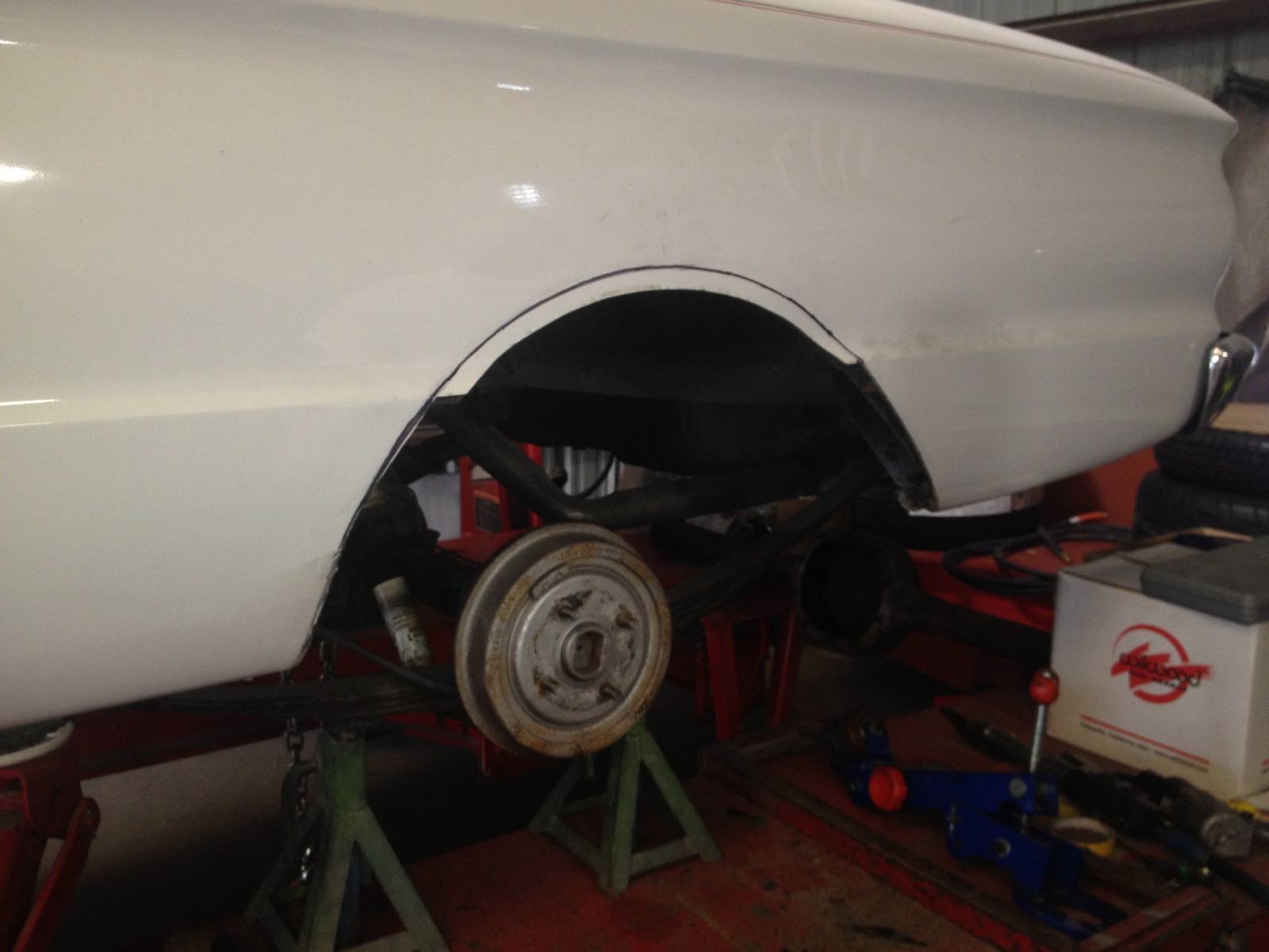

    I am happy to say that we got the 4 lug rear out, the 5 lug rear in and the tires and wheels mounted into the fully mocked-up rear wheel wells and I like the look. We start on the front end Thursday evening. Also decided that several of you were right about the 61 valance and decided that we would build our own rollpan up front based on the shape of the front grill splash guard that the 62 has behind the front bumper. We will be running round turn signals in it and will build a recessed area for the 3.5 gallon Moon tank to fit into that will hold my "fuel" for the flame throwers.

  28. Run the rear wheel well "tear dropped" like you have it, it matches the front, looks good, and will be unique to your car!

    I am leaning towards a 3.80 gear, I called it higher , but I knew what I meant. And the "posi" I bought at such a great deal.... wasn't. The low life who sold it to me lied and I was dumb enough to not get serious about checking it before I gave him the money because it was starting to rain, big time rookie mistake that I knew better than to make, wasted $200.00 bucks, that will hurt the build budget a bit.
    And as you can see from the pics, we did use the front wheel opening as our guide for the back, I am really happy with that look, I think it will do well. And I'm "stealing " the front roll pan idea from Bricktopp. It will give me the basic guide and I'll modify from there to make it my own.
