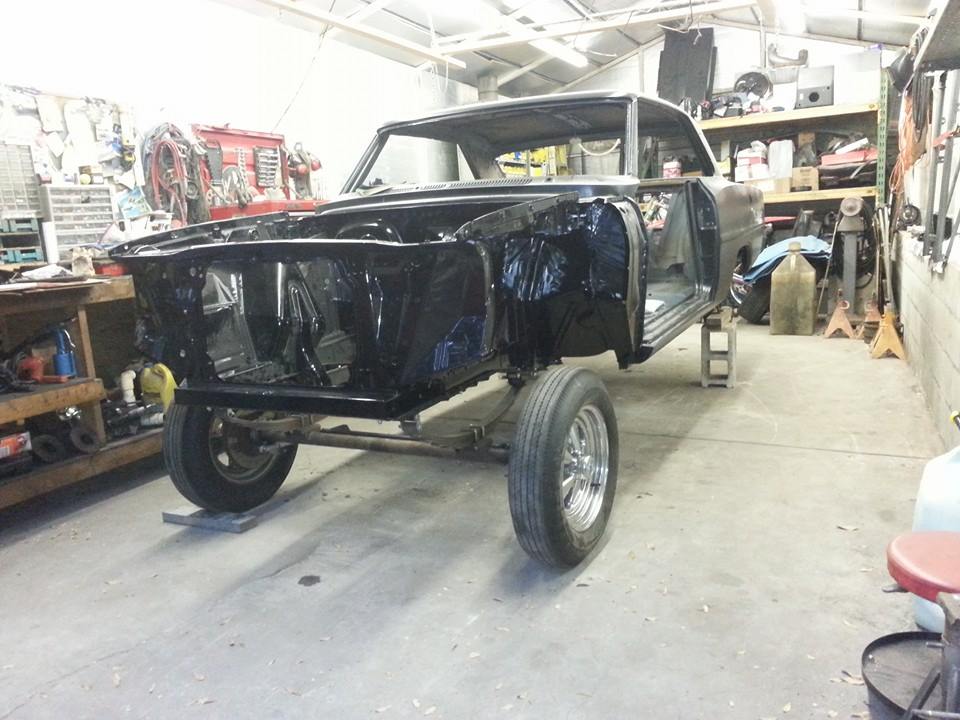

    While I was off helping my Mom get ready for Easter Family time, my guys at Marc's Auto Creations got busy and took out the stock front end and mocked up the new 48" axle with the Wilwood disc brakes and my lil wheels and tires... Sweet!

    Perfect positioning on the front axle! The front wheel combo sits just right in the opening!

    We are hoping that the front won't come down more than an 1" or so once we put the motor and trans back in, its a 289 with tunnelram, so not super heavy, just have to wait and see. The width is wider than I thought it would be, gotta decide if I need to go to a 46" axle instead of the 48" before we weld in the shock mounts and lock in the spring perches. But I agree the wheel is right where I thought it should be in the opening.

    I think the width looks perfect also! I really hate the tucked in look some cars have with an axle that's too narrow. Those tires sit perfect in width as far as I'm concerned. I really would like to get some narrower front wheels for my Falcon, as they sit out even farther than yours. But it's tough to find them in a matching wheel that's 15"x4" like I need. Mine are 14"x5.5" or 6", and just hang out a bit far.

    I ended up going with the Summitt Pulsar rims because they were 4" wide and they were cheap! And the 135 Firestones ended up fitting just right. I ***ume that my steering will be somewhat scary since the tire contact patch is really small compared to the back, but i guess we will have to wait and see. I do think the axle and tire combo worked out just right on the front.

    I didn't even know they made a tire that narrow still in a 15" rim! I thought a 155 was the smallest made, and my car has 185 on it because of the wider wheels. I've got a pair of 155-15 on my Austin, but it's pretty small and light. Steering feels just fine, and handling is good. If I find the right wheel I will probably go 165 on the Falcon, just because of the big Chevy's weight.

    The black car I'm getting together runs 135's up front,and it's only a 2700lb car,but those little tires just don't have enough load bearing capacity for anything but an aluminum headed,fibergl*** front clipped,lightened to the max type car.
    Mine still has iron heads,but no heater,radio,power steering or brakes,or a/c,and the tires are just overwhelmed.
    Even at max inflation,they are just squashed by the weight of the car.
    I'm gonna try some 165's on it,as they have way more load bearing capacity,and their taller height will probably get the car sitting a little more level (which is the look I'm after).
    Basically,I'm just saying that through personal experience,I wouldn't recommend the 135's for anything but an absolutely featherweight car.

    Yeah Scott, my BBC has aluminum heads, but with full steel front metal, plus all the frame mods adding weight to handle the BBC, it's just too heavy for anything smaller than 165.

    I will let you guys know how it goes, we might have to change the tires, we should know by the first part of next week. I ordered the posi unit and a set of 3.55 gears, the ywill be here on Friday, I'll rebuild the 3rd member over the weekend and we should be done with the rear by the end of next week. Going to start the front end final mockup on Wednesday and Thursday, hopefully we'll have pics of the car on the new shoes on the ground by Friday of this week.

    These firestone tires are speed rated "P" and have an individual load rating of 780 lbs. each, I think I might be cutting it close, but I don't thin the front of my Falcon ways close to 1500lbs, but I guess I"ll have to wait and see how the car sits with the motor and trans back in.
