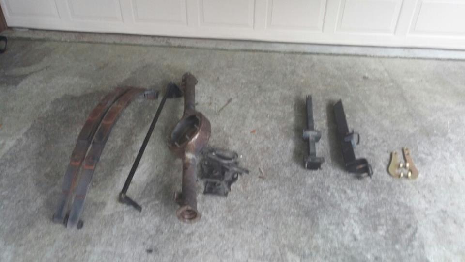

    Any reason you hung the springs with the shackles on the rear?
    Don't worry about your pal building a Chevy ll 'g***er'. They're all doin' it...
  2. stickerdick
    Joined: Jan 26, 2013
    Posts: 149
    stickerdick
    Because I did what I thought was the correct way based on Speedway's instructions? I never built one before, so I figure it was smarter to follow the lead of the folks who have done them before. I have seen it both ways, me and the fab guys figured it was better to do them the way the majority of the other builders seem to be going, if it is not the correct way, I don't really know which way is.

    And you were right. There is no wrong or right place to put the shackles, as long as it's at the end of the springs. I've got one of each, and they drive equally well. I've seen factory setups with shackles in front, and the rear also, so even they didn't agree which end was "correct".

    The way I build them is the static end of the spring is mounted the same end as the steering box or the swinging shackle is mounted opposite to the steering box mount, the spring actually gets longer as it compresses
  6. 1971BB427
    Joined: Mar 6, 2010
    Posts: 9,834
    1971BB427
    from Oregon
    Doesn't the spring get longer on both sides of the axle Steve? Both of my cars have the steering box in front of the axle, and shackles at the front on the Falcon, and rear on the Austin.
    I would guess if it was not cross steer, then it might be different. But can't see how a cross steer axle would matter which side the shackles were on?

    I see what he means- yes the spring gets longer on both sides of the axle, but since one end is stationary, the axle moves half the growth distance, while the shackle end registers the full amount of length change.
    Theoretically, if the steering link is on the same end as the solid mount it would see less change; however, i believe most jeeps/trucks have the steering on the same end as the shackle, so it must be negligible- that's why i left mine front-steer, front shackle. -rick

    Sorry it didn't read that clearly now I look at it, yes it grows both ways but as fury has said because of the static shackle the axle only moves half, on side steer this must have an effect of some kind, on cross steer not so much.

    I think at this point, I'm going to use the rear steer box as is, it will be set-up as a cross steer design and we will see how it goes from there. If everything goes as planned, I will be posting pics of the final mockup of the car on the ground on all four wheels, I hope it works out that way at least.

    I went to front steer boxes on both of mine to clear the oil pans, and keep drag link angles as flat as possible. Sometimes the behind the axle position can really create interference angles that wont allow a flat drag link.
