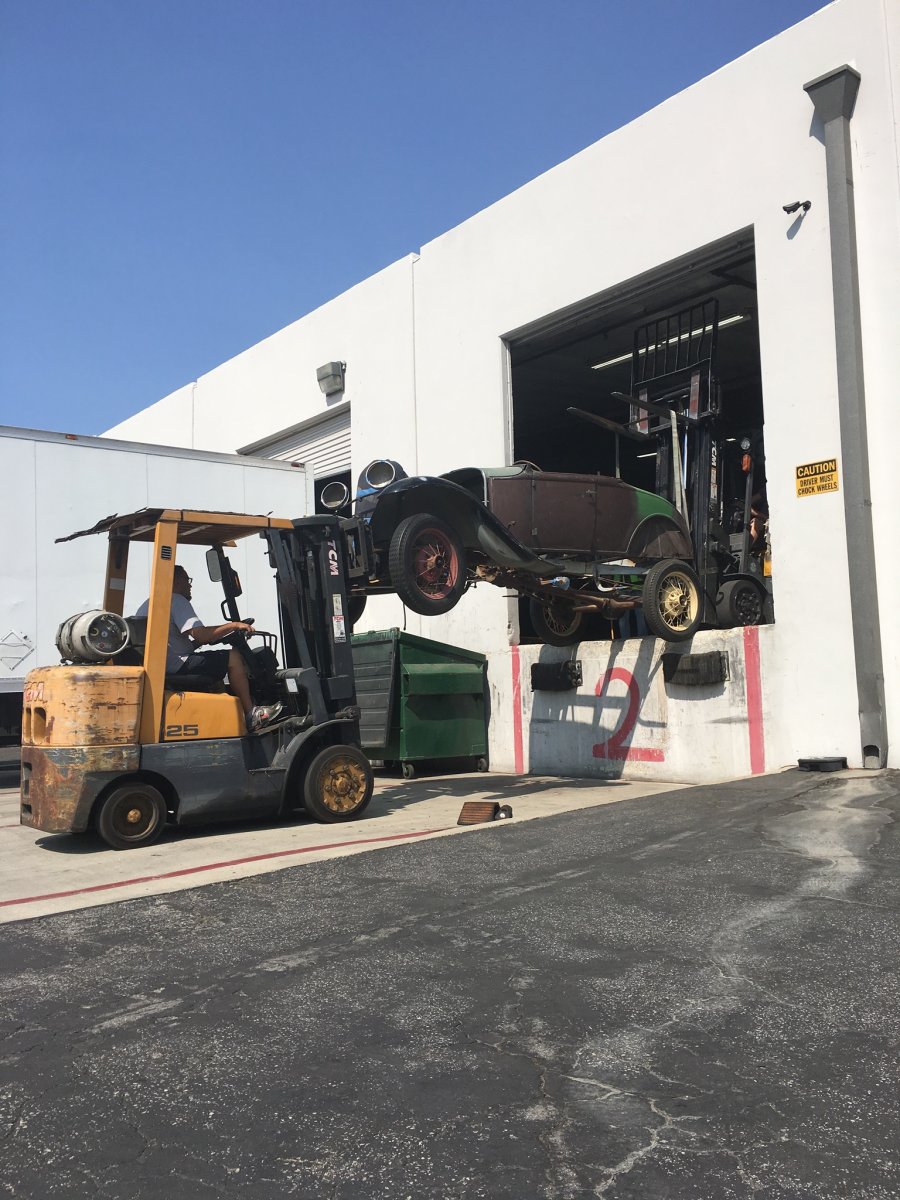

    5042C103-C333-4ACE-A5D7-710EE6EAF6B9.jpeg I found this relatively solid ‘30 roadster body and ch***is through a local listing. It had been stored in a warehouse just outside Burbank awaiting a restoration so the car came with a few boxes of surplus stock model a parts.

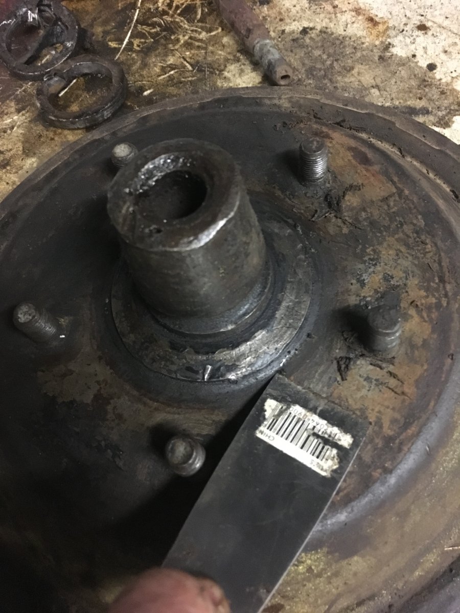

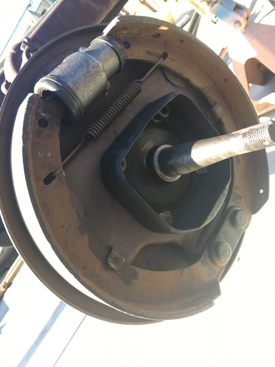

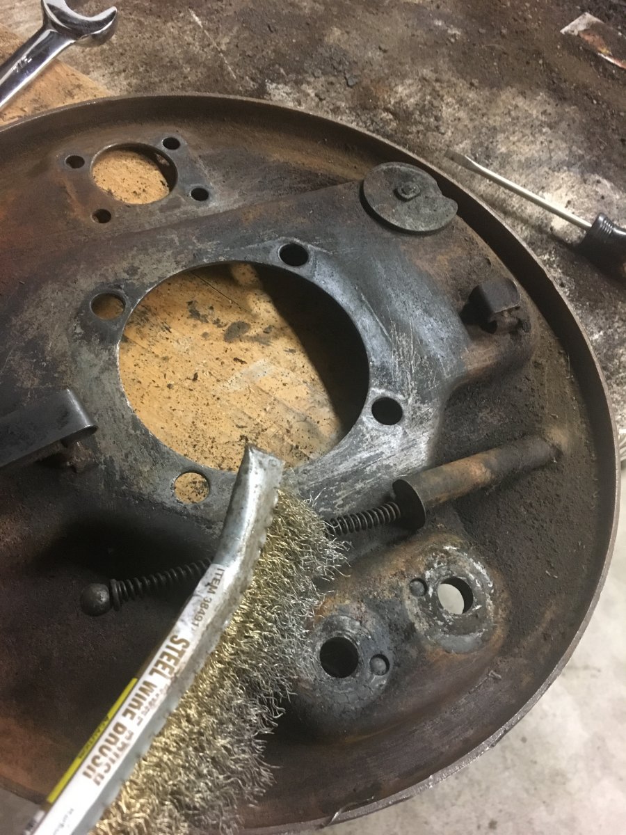

    I started by cleaning up some ‘ 45B291DA-A055-4B34-9406-C9E706D1EE06.jpeg 07112E62-932B-49FB-BD57-10B1C11068CD.jpeg 60B7DC07-BD26-4D67-AC0A-B1D1623FAD70.jpeg 40 backing plates and drums that I bought from a friend.

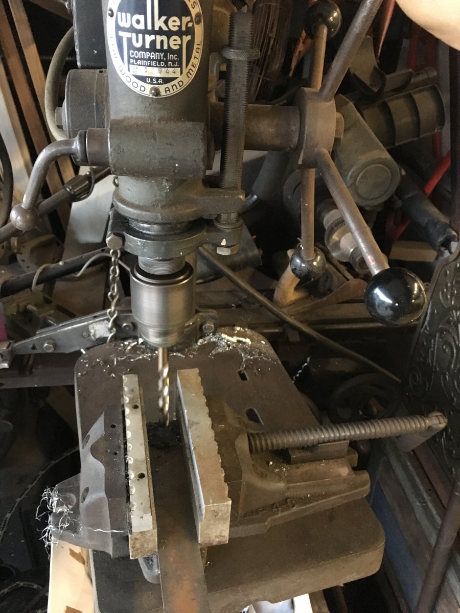

    Modified what I think are F1 rear shock mounts to even out the length..
    22E6D5DD-C3D3-458A-AE4A-97611F9E1D4F.jpeg E4691C85-0A1B-4908-A1E8-4739D1327C37.jpeg

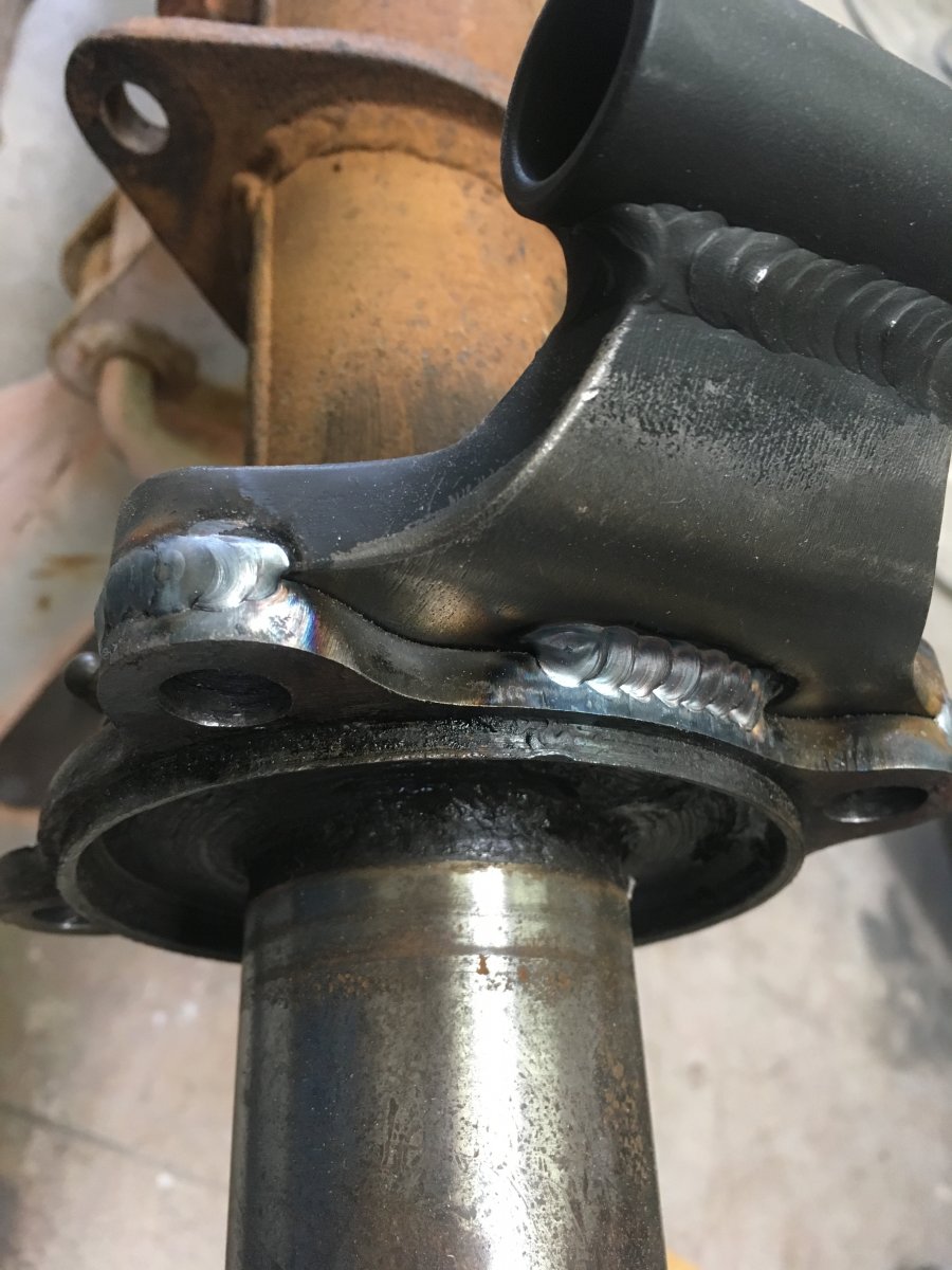

    Built up a rear spring stack w a reversed eye main leaf, and while I might consider utilizing the 36 radius rods in the future with th spring mounted behind the axle, I opted to mount the spring above the axle with weld-on mounts to simplify the build.
    691C231B-7891-442C-B9C6-FCBCB2E10667.jpeg E48D541E-104E-41BA-99C0-82264F851330.jpeg

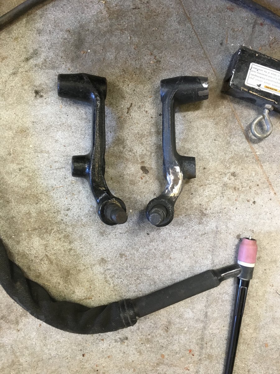

    I found these radius rods in a parts pile. Not sure what they’re off of but they allowed me to mount the spring above the differential. I cleaned them up, and welded up unwanted holes.
    8313C29E-3C8A-4D73-A284-DC4F3E58BB88.jpeg B3E4B1CC-AF95-47AA-89D9-D7EDF7E62781.jpeg FA454DAE-A46C-45DF-8A17-5B340967F931.jpeg 9379BF15-9BF0-469B-8E80-B83EC609B7D6.jpeg

    Nie looking welds so far. I think those are 46/7/8 rear shock mounts. I'm just coming to the end of ***embly of my 31 after 4 years on it. Still a little left to do on it. 20180425_175854.jpg

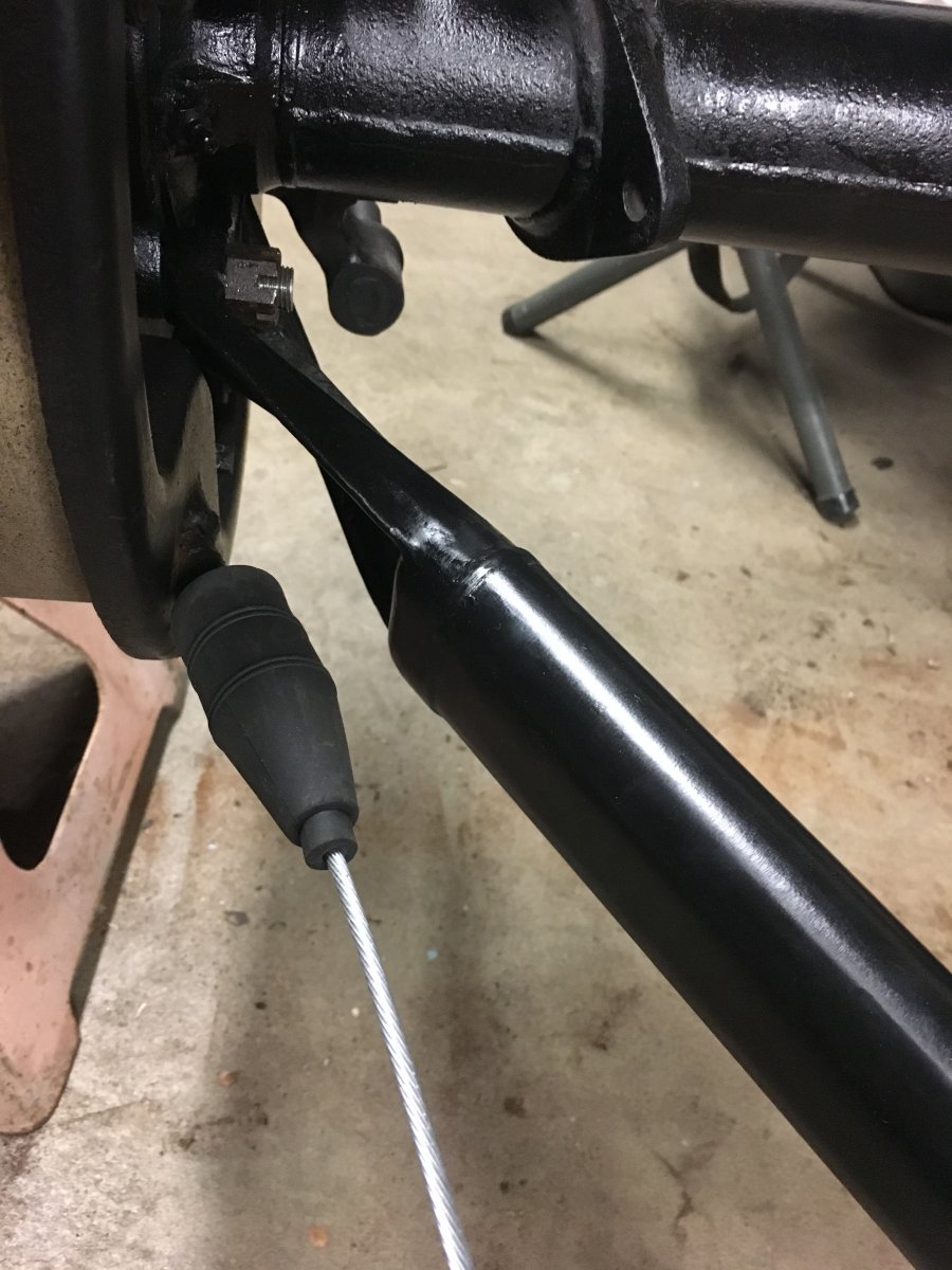

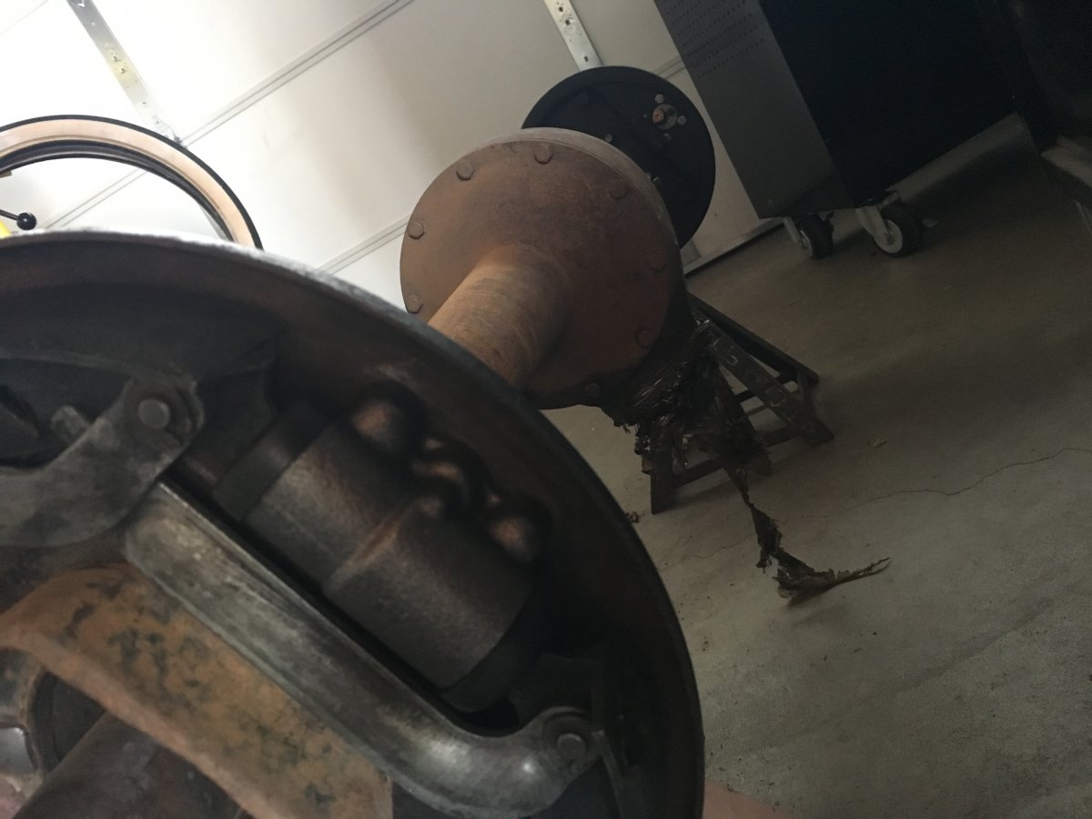

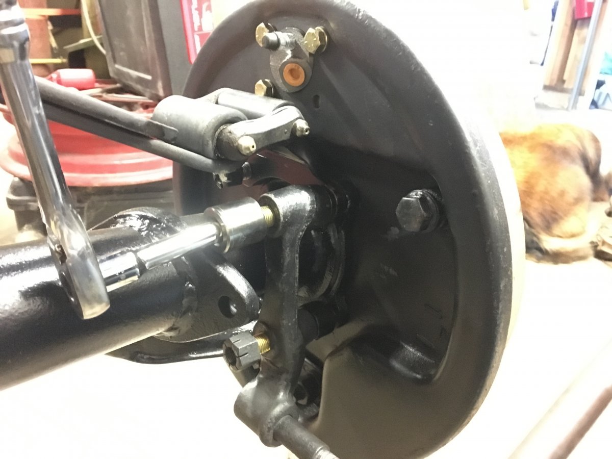

    Wrapped up the rear end w new bearings, fresh grease, brakes and e-brake cable
    027B43F1-FA71-40EE-9D58-F46889F97772.jpeg A4305FF7-D9A2-415E-816B-7265178B0F1F.jpeg E2CCB07B-C026-4617-9821-5B281F9282C0.jpeg 7567AB77-DE31-4632-9F4D-DCF28F7E2D6E.jpeg

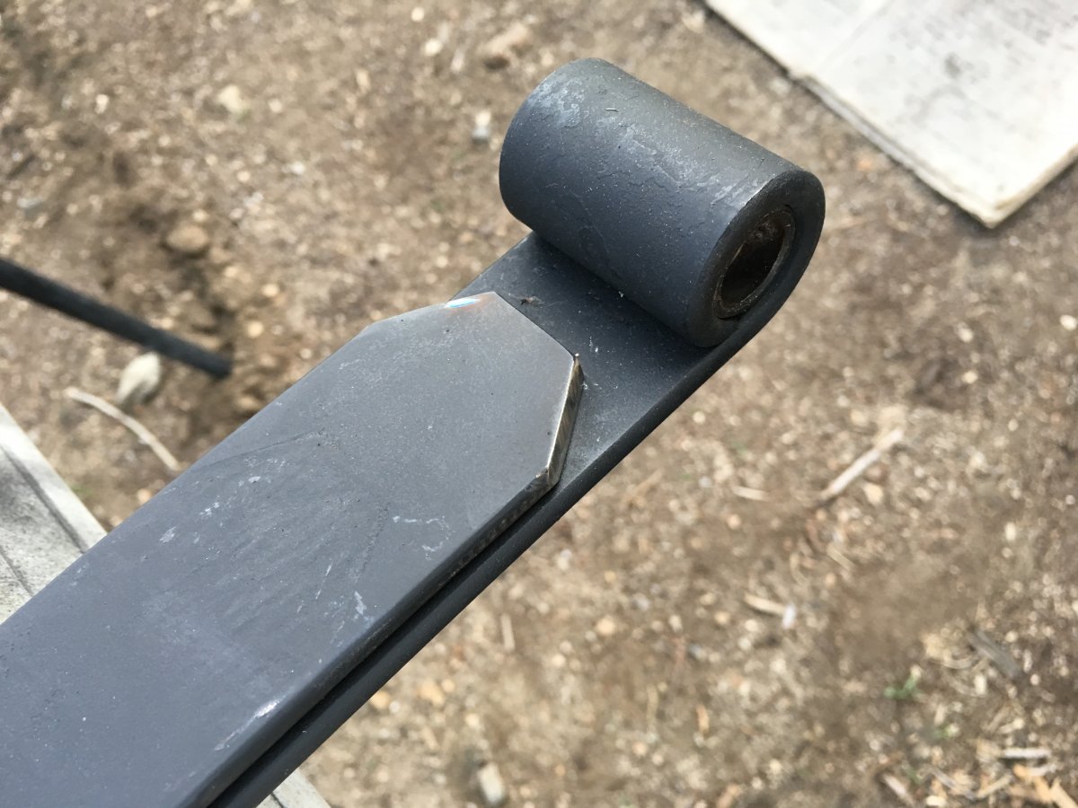

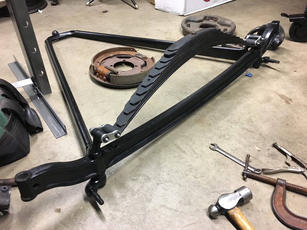

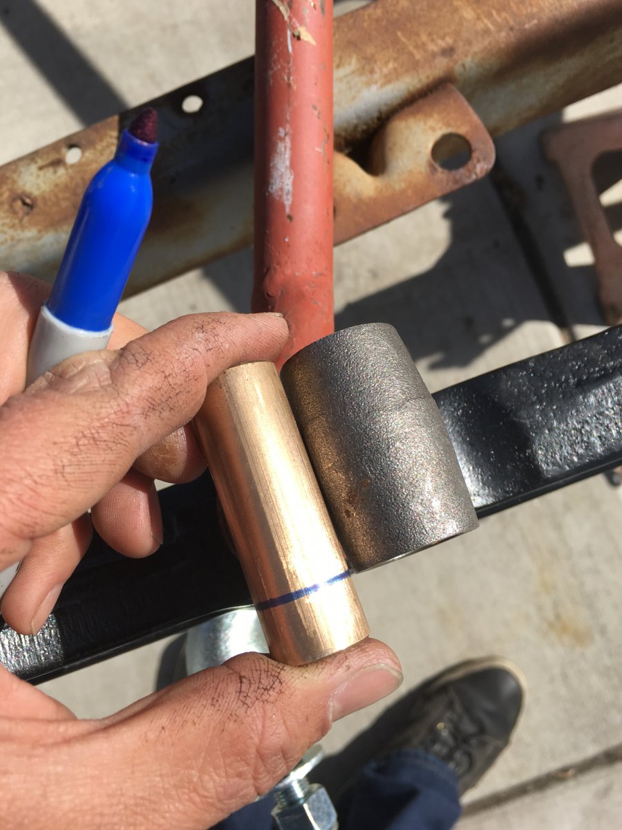

    Starting on the front end, I cleaned and ***embled a spring pack w a reversed eye main. Trimmed up some bushings. And cut down a second-leaf for clearance.
    07C2C8ED-6886-4182-86FD-74FB08ADA63C.jpeg D24780AE-554E-49D2-BA08-02258C65F487.jpeg CDC16B3F-1117-4CBE-85F2-A99A8AFFEF3C.jpeg F4B20E32-EBD9-4912-818C-C4C2BC6953EF.jpeg

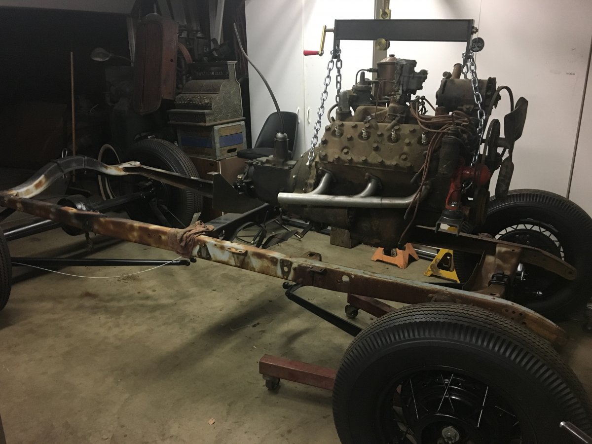

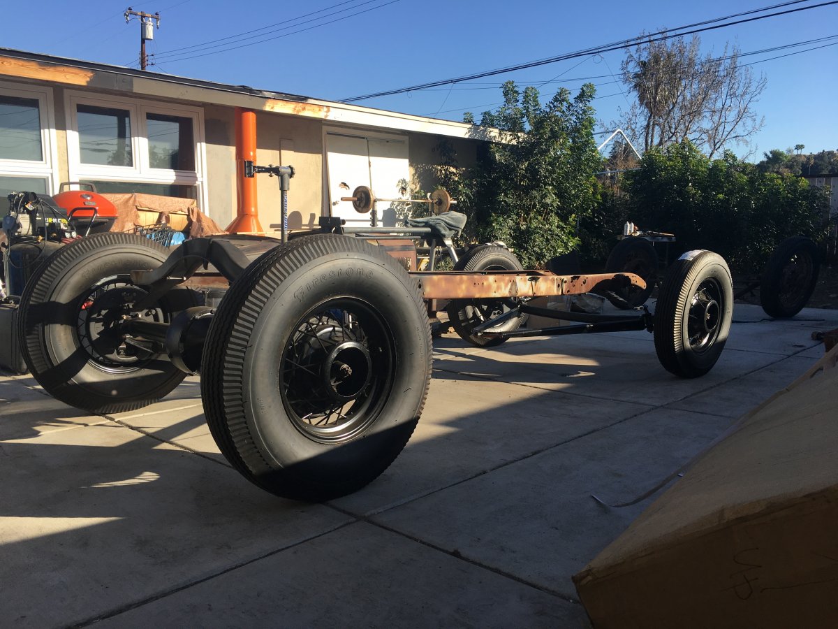

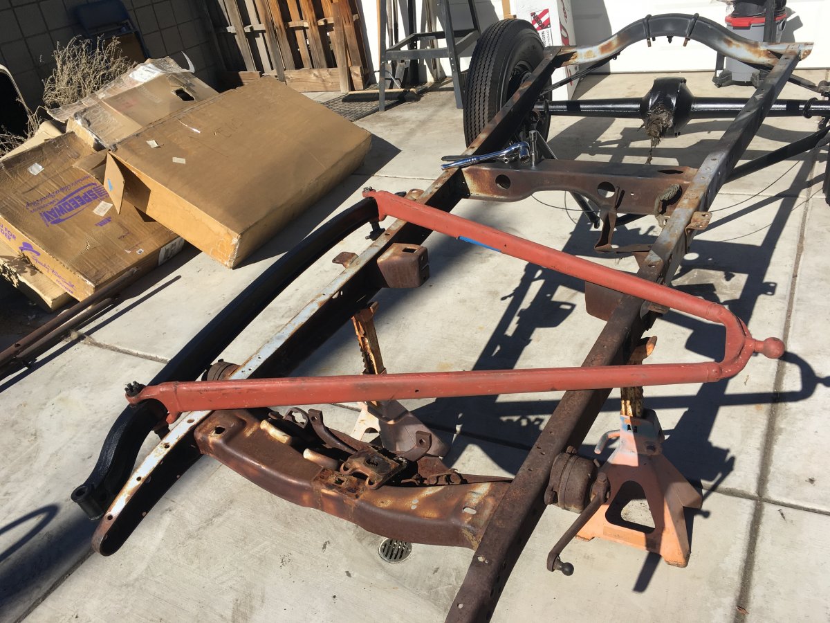

    I found a ‘34 wishbone that I’m hoping will clear the motor without having to split, and got the ch***is rolling on new front and rear axles.
    1702D4CE-0E07-4784-8663-0A2FFF357C1C.jpeg 708AD76F-CB3E-450B-8F45-CB495F0FBF99.jpeg 990C96FE-803A-4D98-9CD2-1261E9A67524.jpeg

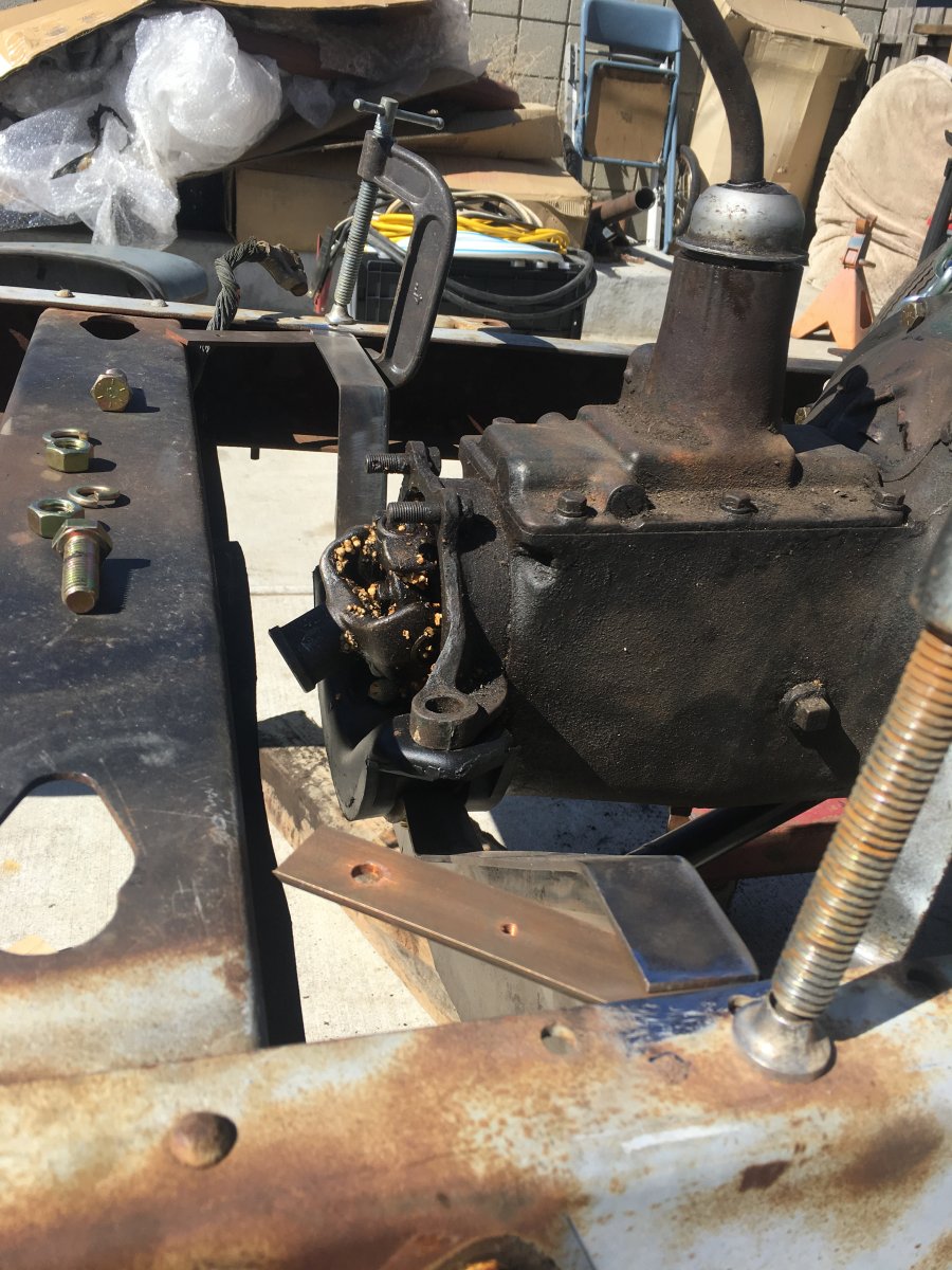

    A**** the parts I’d been hoarding away for many years was this 8ba flathead that I pulled from my old shoebox. I loved the way it ran so I kept it long after I had sold the car.
    I replaced the stock sideshift with a ‘39 3 speed. I sourced a F1 style crossmember from @house of fab and began locating mounts onto the frame.
    The headers were also purchased from Havlir.
    2F4CD279-152B-4D0A-8F26-B3C7E197ED52.jpeg 1A39B9B3-10D0-4654-B885-601CF16D5A24.jpeg

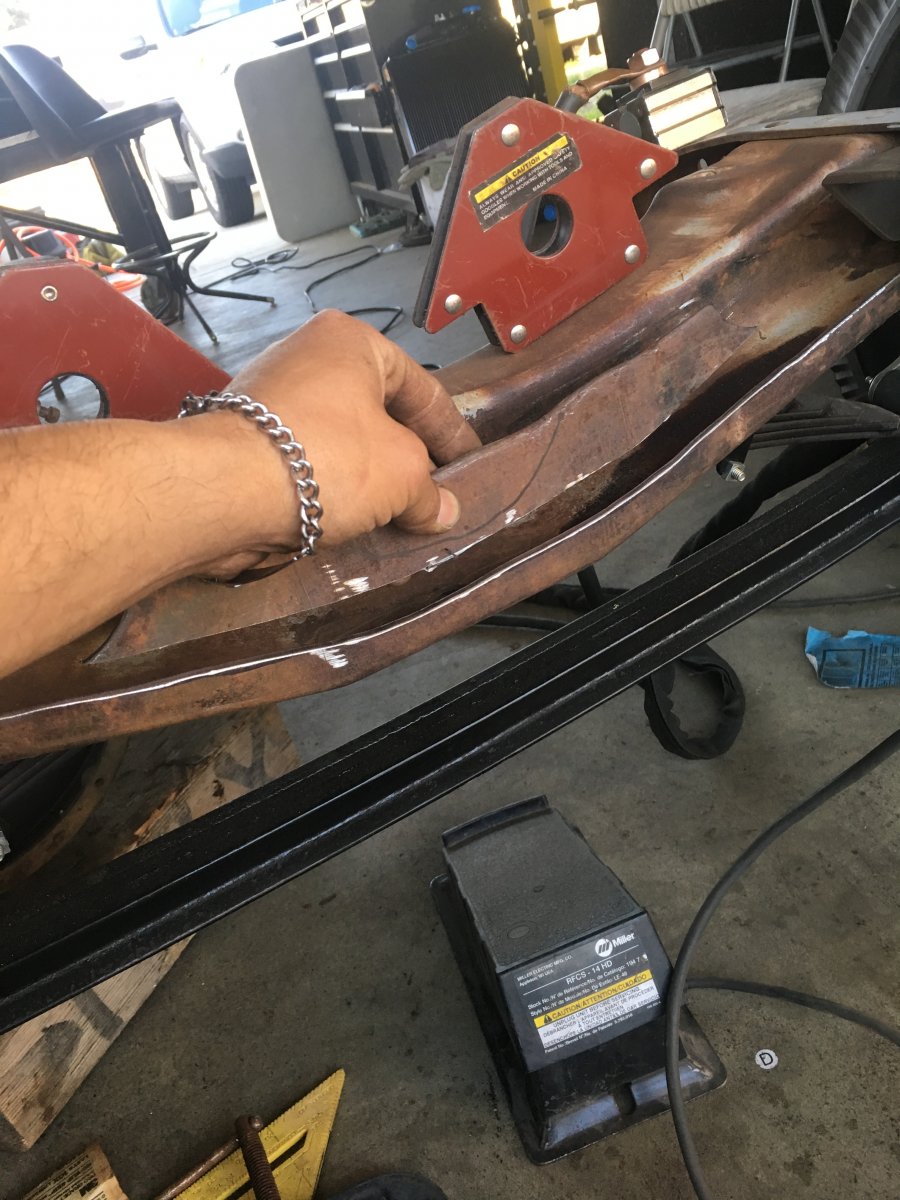

    After a lot of careful measuring, the mounts and crossmember are finally welded in. Some material was removed from the stock front crossmember for crankpulley clearance.
    (Please mind my ****py welds)
    9B295B66-7D52-4AA3-855F-466D5EE4B21F.jpeg 67857EFB-B5A5-4879-9F44-626A19D3B873.jpeg 769FB4F6-C741-4249-97F9-D9CC1AE32C7D.jpeg

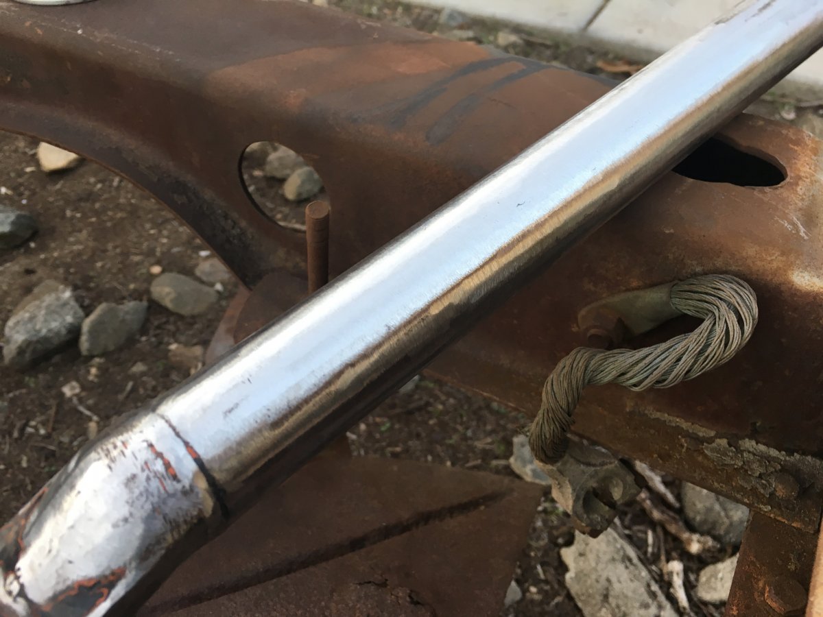

    Here is a better shot of that havlir cross member. I decided to eliminate the original model a cross member entirely. I’ll also have to make a bracket for that wishbone in the future. 4169F266-C8E4-4946-B780-839BB4151A12.jpeg B02E408C-0C04-4C0E-B728-6E5D32D8D81A.jpeg

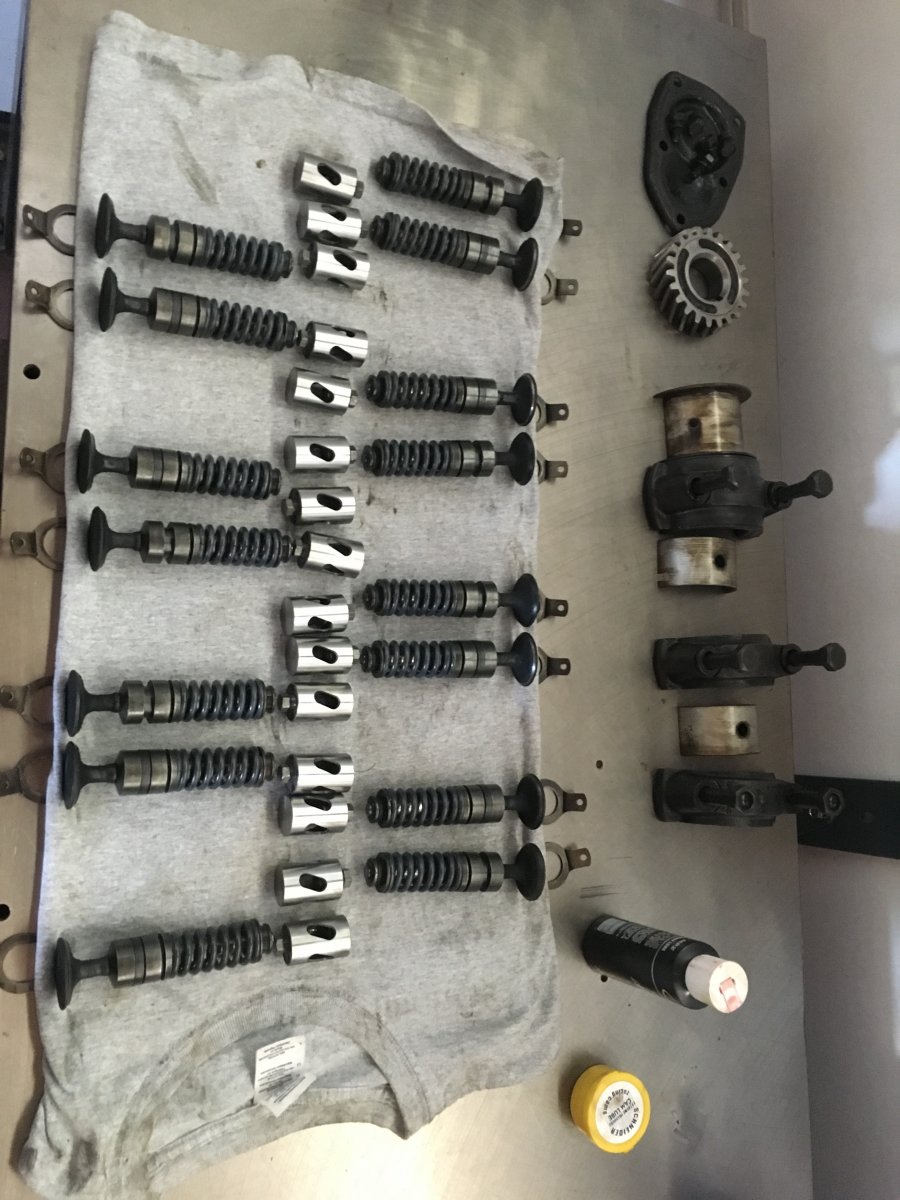

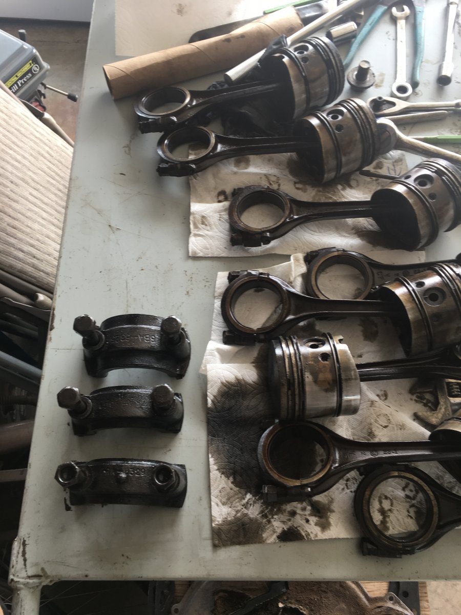

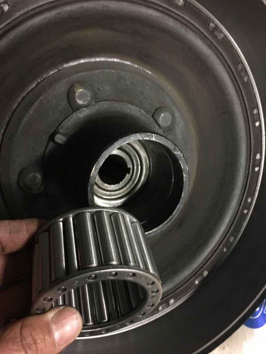

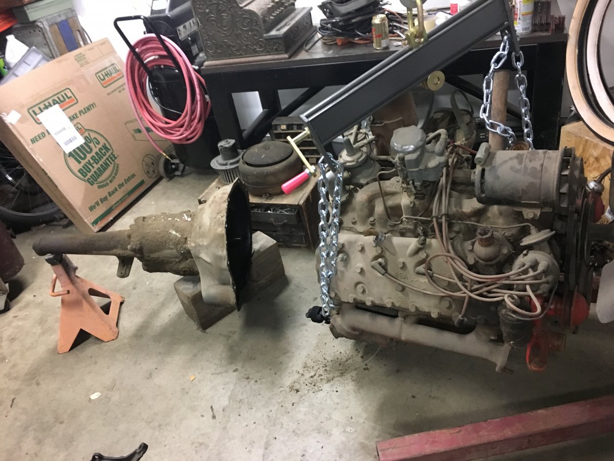

    I dis***embled the motor to swap out for an early style cam and distributor to help with engine compartment clearance. Also, it was a good excuse to freshen up the low mileage motor.
    F8384BBE-B38A-4AFD-AF91-74CBF39F7366.jpeg 0EB2D76B-8CFC-48B5-82FE-2649616BBDF4.jpeg DAB04E45-B7D6-4EAA-8E4E-5E8B94F9B316.jpeg
    I had to swap out the timing gears as well to run the 59a distributor setup.

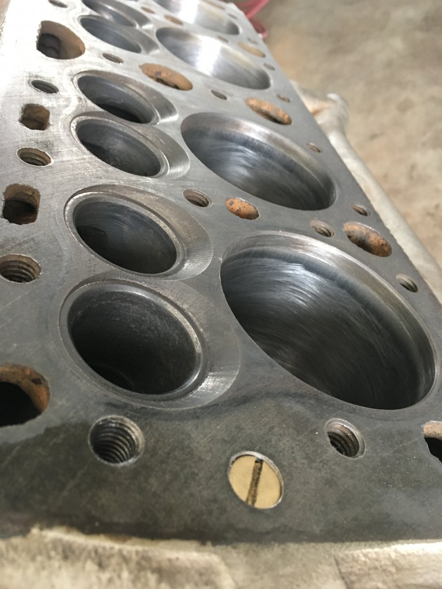

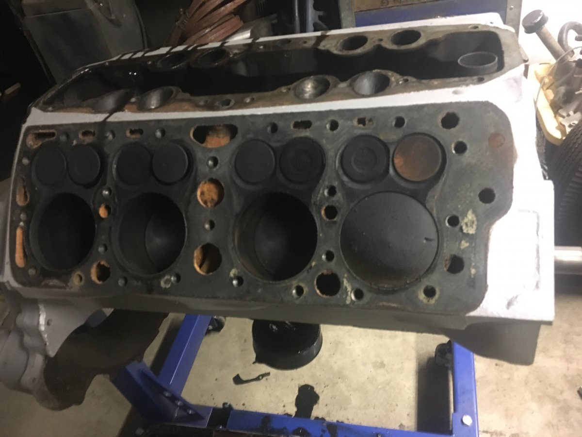

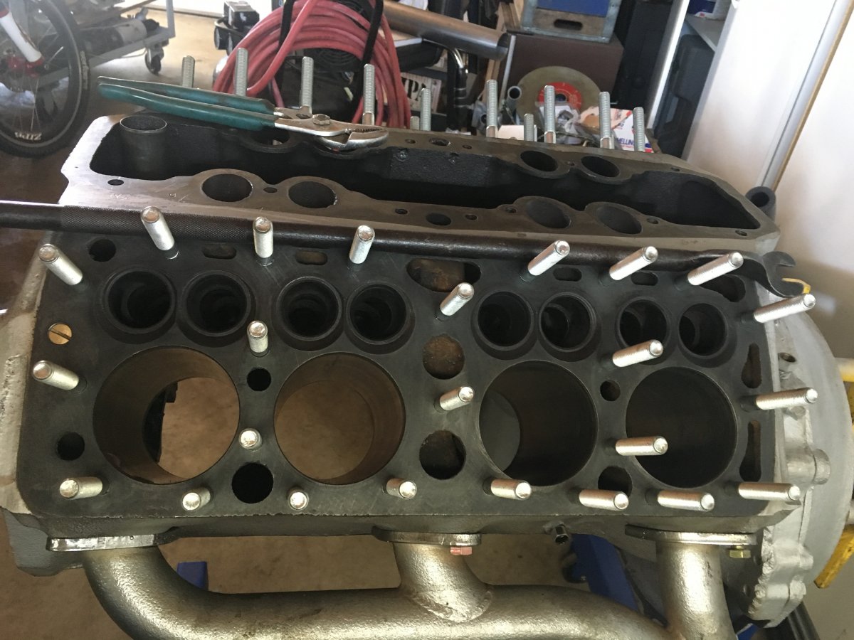

    Block was cleaned, cylinders measured within spec so I honed them for new rings. Schneider Racing in San Diego ground a cam for me. I installed it with new zephyr springs, guides and adjustable johnson style lifters .
    The forward water p***ages in the block were blocked off and sealed to accommodate earlier heads and water pumps.
    92619998-6A7F-4C21-B962-A7B29BBBB0C5.jpeg 7BB81572-2CA0-4CB3-9229-9206249E18A6.jpeg E7130D29-14E4-4C62-8382-73739540E8A9.jpeg 99C14F22-45A9-40EB-96B0-169C3C469982.jpeg

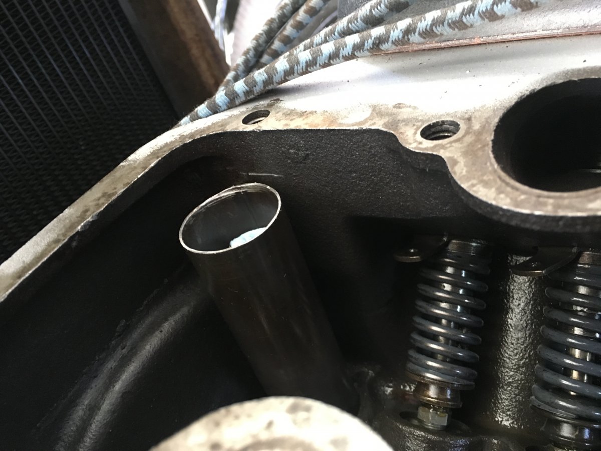

    I had some concern over the elimination of the 8ba road-draft tube. Some research led me to adopt a directional venting method that vents the block through a pcv valve.
    I cut down the tube that extends into the lifter valley and made an adapter for a venting line that will ultimately terminate at the intake.
    I liked how this design hides the pcv system.
