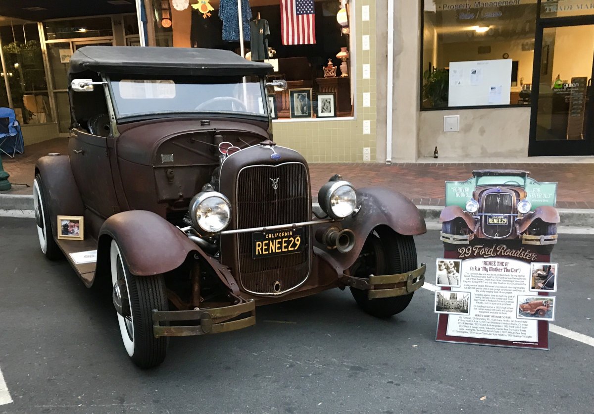

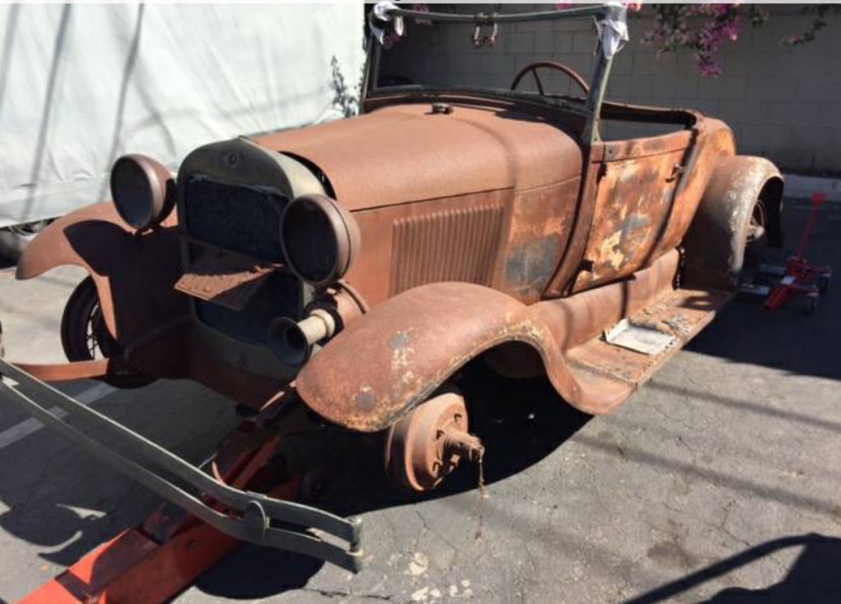

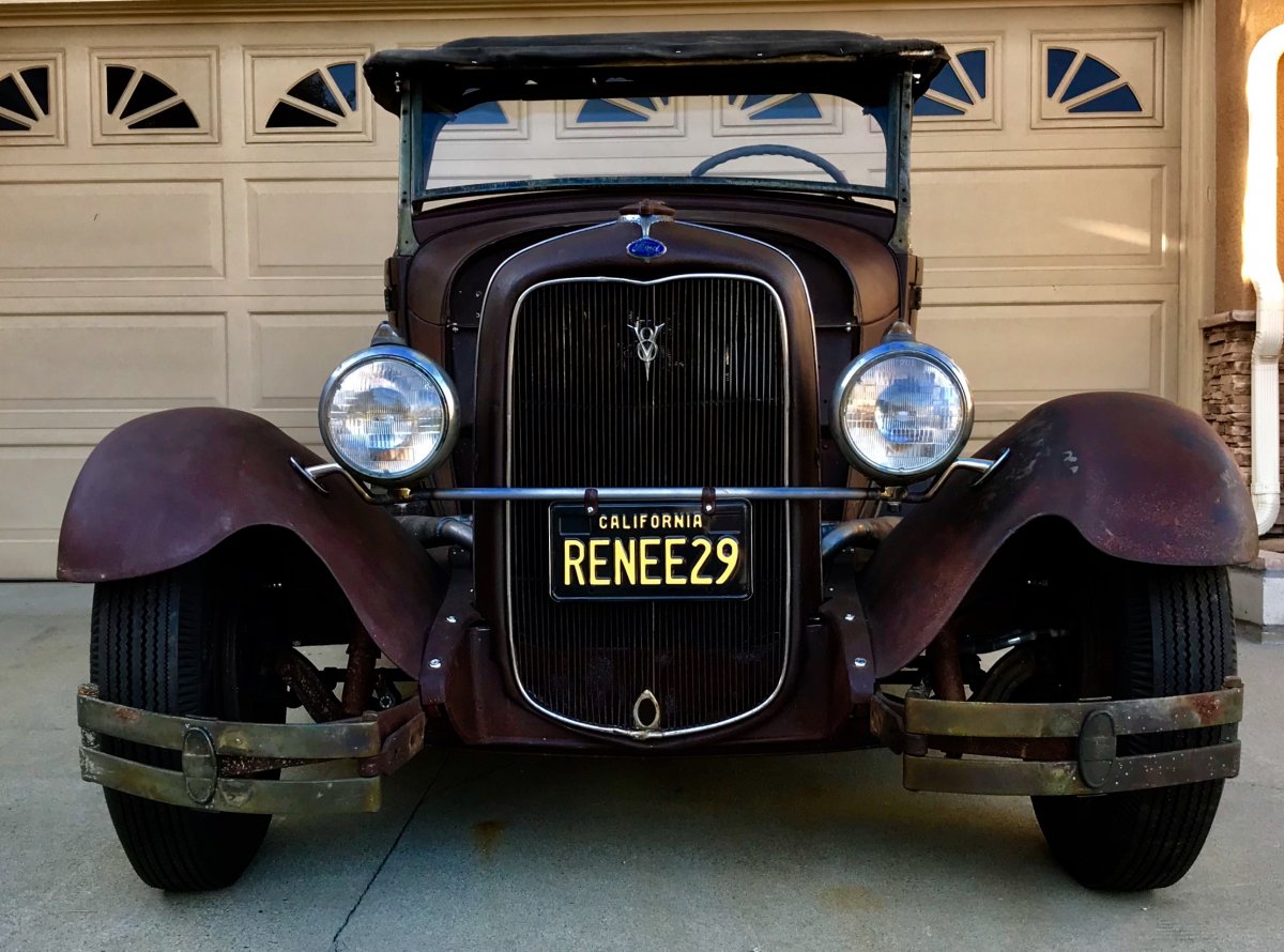

  20. CB8997E8-B90D-4681-88E6-F2AE9C2410EF.jpeg FDE6A05B-96E5-4EE0-B400-3BABBE02E466.jpeg EF43CE0F-104E-4C27-BB3F-6B99C4185796.jpeg 316E0383-5EDB-4401-90AD-DD439BD9EE23.jpeg CB8997E8-B90D-4681-88E6-F2AE9C2410EF.jpeg FDE6A05B-96E5-4EE0-B400-3BABBE02E466.jpeg EF43CE0F-104E-4C27-BB3F-6B99C4185796.jpeg 316E0383-5EDB-4401-90AD-DD439BD9EE23.jpeg Good Morning! Fellow AV8 builder here in Loma Linda Ca! I’ve been on mine for 2 years now, love the guys at Early Ford Store and Cooks! Mine is a tribute build to my mother Renee, also built in 1929
    Here’s couple pics.....
    1947knuck, bct, glorydime and 3 others like this.

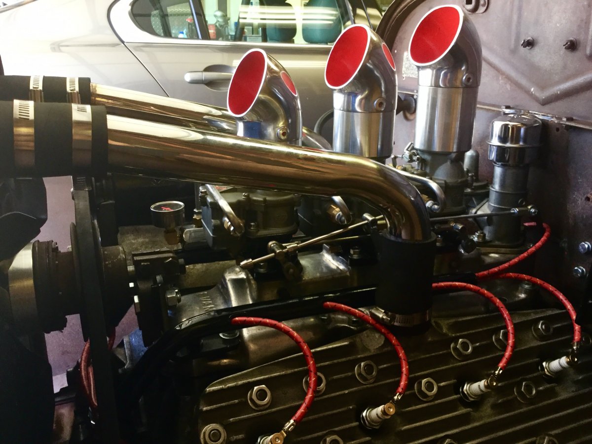

  23. 42A85798-3FBB-49F2-9AD4-E524A472D650.jpeg Final ***embly happening! How did you set up your radiator fan? My Evans manifold doesn’t have a location for one so I had to fabricate a bracket
    1947knuck, deluxester and akoutlaw like this.
  24. deluxester
    Joined: Mar 14, 2004
    Posts: 478
    deluxester
    That fan bracket looks great! How did you make it? What parts did you use? I used a stock fan with integrated spacer that Bill from the Early Ford Store pulled out of a pile of parts. I’m not sure what its from but I think the system could benefit from moving the fan closer toward the radiator.
