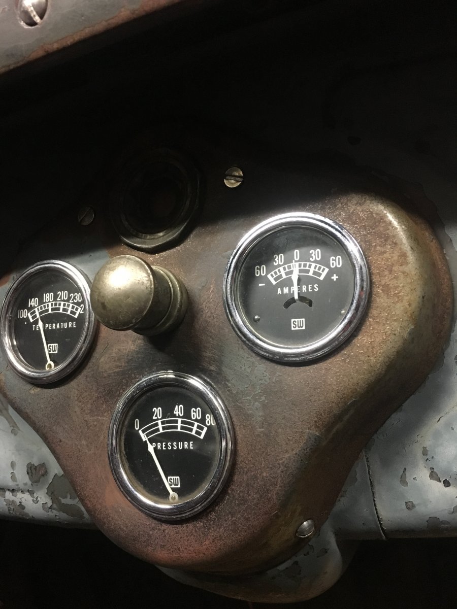

    I wanted to get rid of the stock oval speedometer and replace it with an oil pressure gauge.
    1947knuck likes this.
  20. deluxester
    Joined: Mar 14, 2004
    Posts: 478
    deluxester
    ...So I got to making the oval opening into a round one.
  21. deluxester
    Posts: 478
    deluxester
    ...and added a little patina paint job to blend into the original.
    1947knuck, Stogy, rpm56 and 10 others like this.

    I restore antique bicycles, and often opt to preserve 100 year old paint and patina while still performing necessary repairs such as welding and fabricating. I’ve developed a couple methods to help blend new paint to old, and sometimes taking completely restored projects and adding some age to the finish.
    Here is a link to one such project I posted on a vintage bicycle site:
    https://thecabe.com/forum/threads/1936-elgin-bluebird-progress.92645/page-7
    The dash piece was kind of a quickie job and was completed with 3 different colors of Rustoleum and steel wool, with no actual patina solution or rust.
    I’ll often blend actual oxidized iron in and on top of paint and dry-brush for hours until it looks convincing to me.
