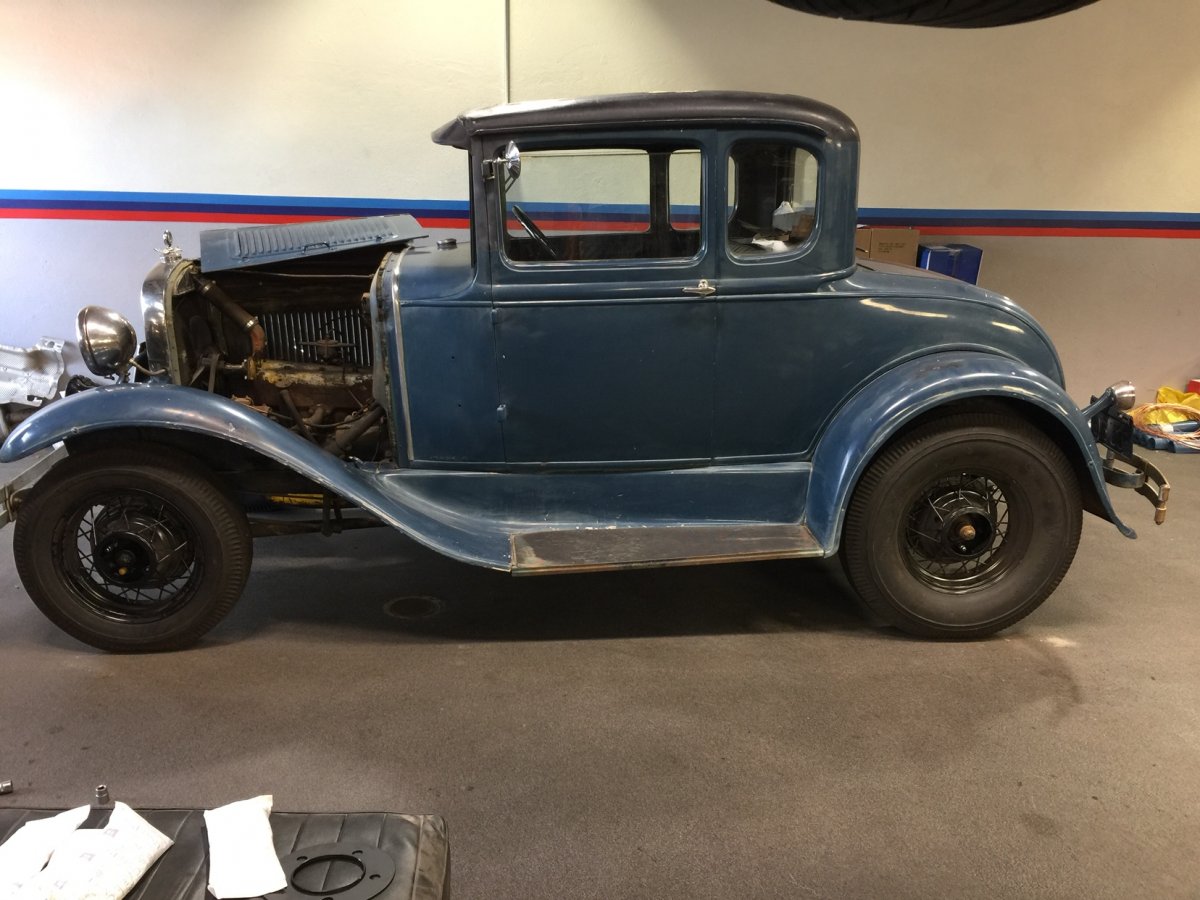

    So the model A has landed in my shop today. Had to tinker with it a little bit, so I test fitted my 16” wire wheels and pulled the starter to try to free up the engine. The previous owner tried by spraying the cylinders with some penetrating oil and fixing a bar with a 75 pound weight applying torque to the crank.
    I bought some Marvels Mystery Oil and will pour some down the cylinders tomorrow to see if it helps.
    Someone did a shady tube shock install many years ago by welding brackets to the front axle. The angles are weird to say the least so they’ll have to go when I swap the front axle for the dropped one. Will also install my reverse eye springs and make sure the ch***is is in good working order.
    This car won’t get a roof chop but instead kept original with bolt on modifications that can be reversed if I feel like it.

    Looks good with the 16's Tobbe. It looks like a really nice coupe to start with. Are you keeping the fenders on it? Keep us updated with pictures and all the stuff you do to it Tobbe. Looks Cool. Bob.................
  27. Tobbe J
    Joined: Dec 12, 2010
    Posts: 277
    Tobbe J
    Thanks Bob!
    The car is in really god condition as far as I can tell. Don’t know anything about the running gear but I hope it okay. The fenders will stay on, I thinks it helps to make the car look a little bit lower.
    Stogy likes this.

    I removed the hood today to get more access to the engine. Decided to pull the head to make it a little bit easier to free up the engine. Pulling the head proved to be harder than expected, it’s really stuck! Ordered two hooks to thread into the spark plug holes so I can use my cherry picker and lift while I try to persuade the head off the block. The locking screw for the distributor is also stuck, I hope I can lift the head with the distributor still attached.
    Stogy likes this.

    @Tobbe J...there are times when I think nuts and bolts are really there just in case...this is one of those times...I'm not a mechanic of unstucking 80 plus years of being together but maybe some strategic blows with a hammer to a hard piece of wood to certain areas around the studs and head while you have load or prying force on it may help to break it free. Others here are veterans of such activities and may have a few ideas knocking around...best of luck.
  30. Tobbe J
    Posts: 277
    Tobbe J
    Right! It seems like the nuts and bolt are there for decoration purposes only.
    I think it will loosen up with some careful beating of the head around the studs, or on the studs themselves. Now it would be nice with an induction heater, but the torch will have to do :)
    Report will follow!
