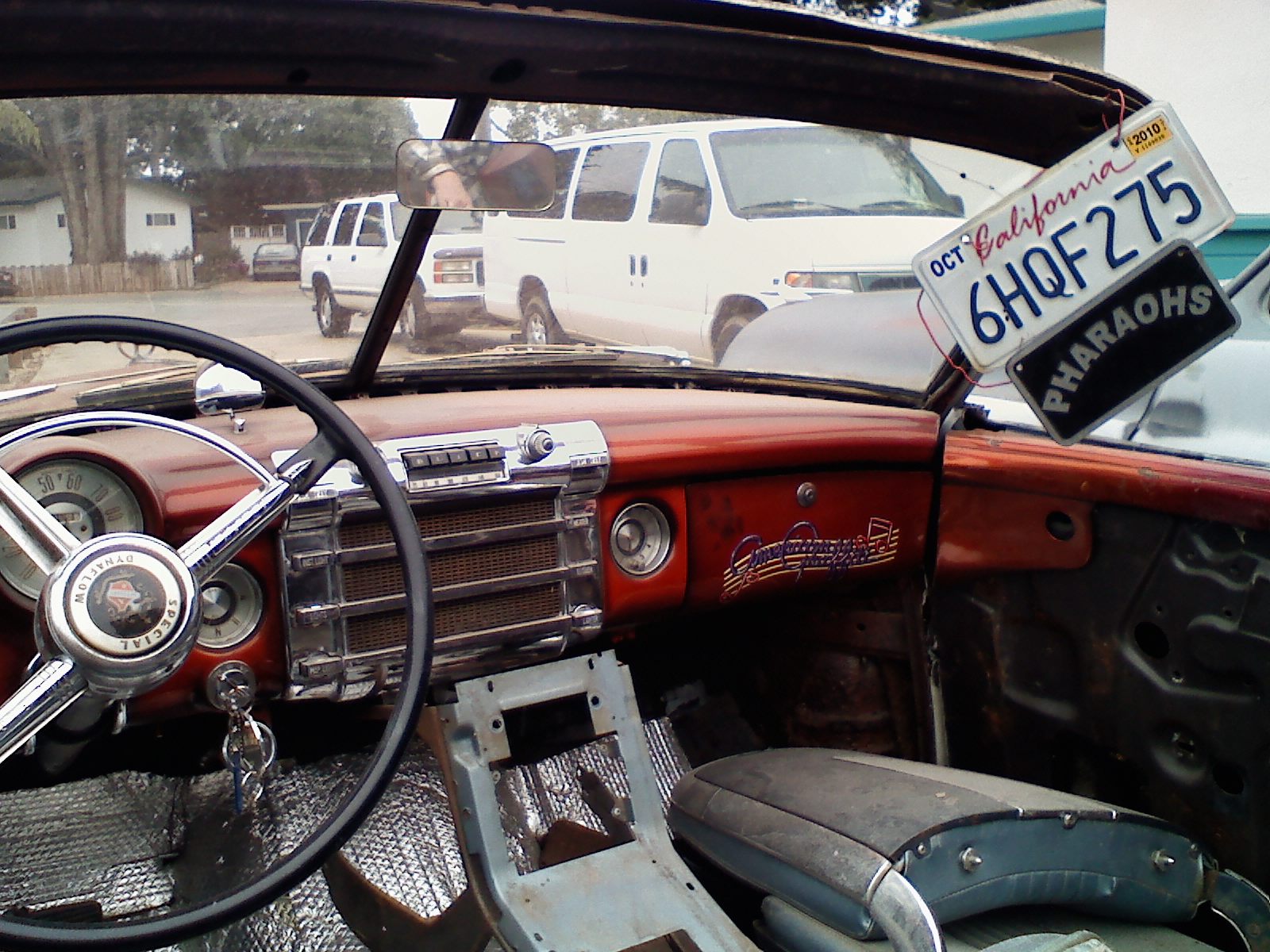

    Ok this is my attempt to make a Carson Top :eek:

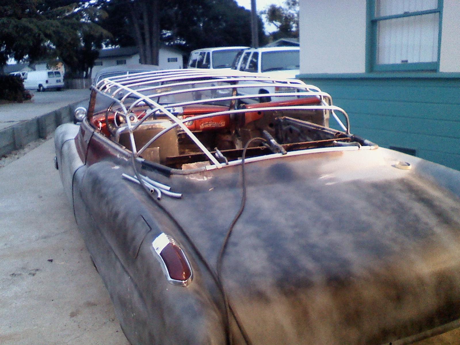

    Ok Got this far...:eek:

    Keep the pictures and progress notes coming. There's alot of us out here that like Carson tops and have never done one. It's great to see your progress.
    If you need some reference, look at Tyler Durben's 50 Shoebox. He did a quality job on that carson and it looks great. Good luck...

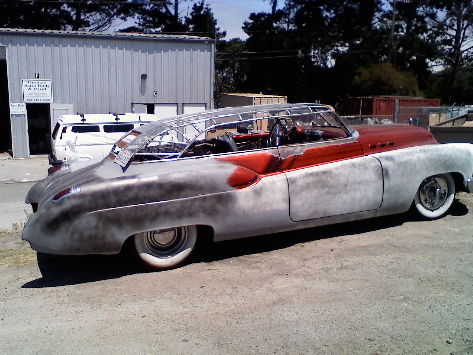

    Ok going on with Top

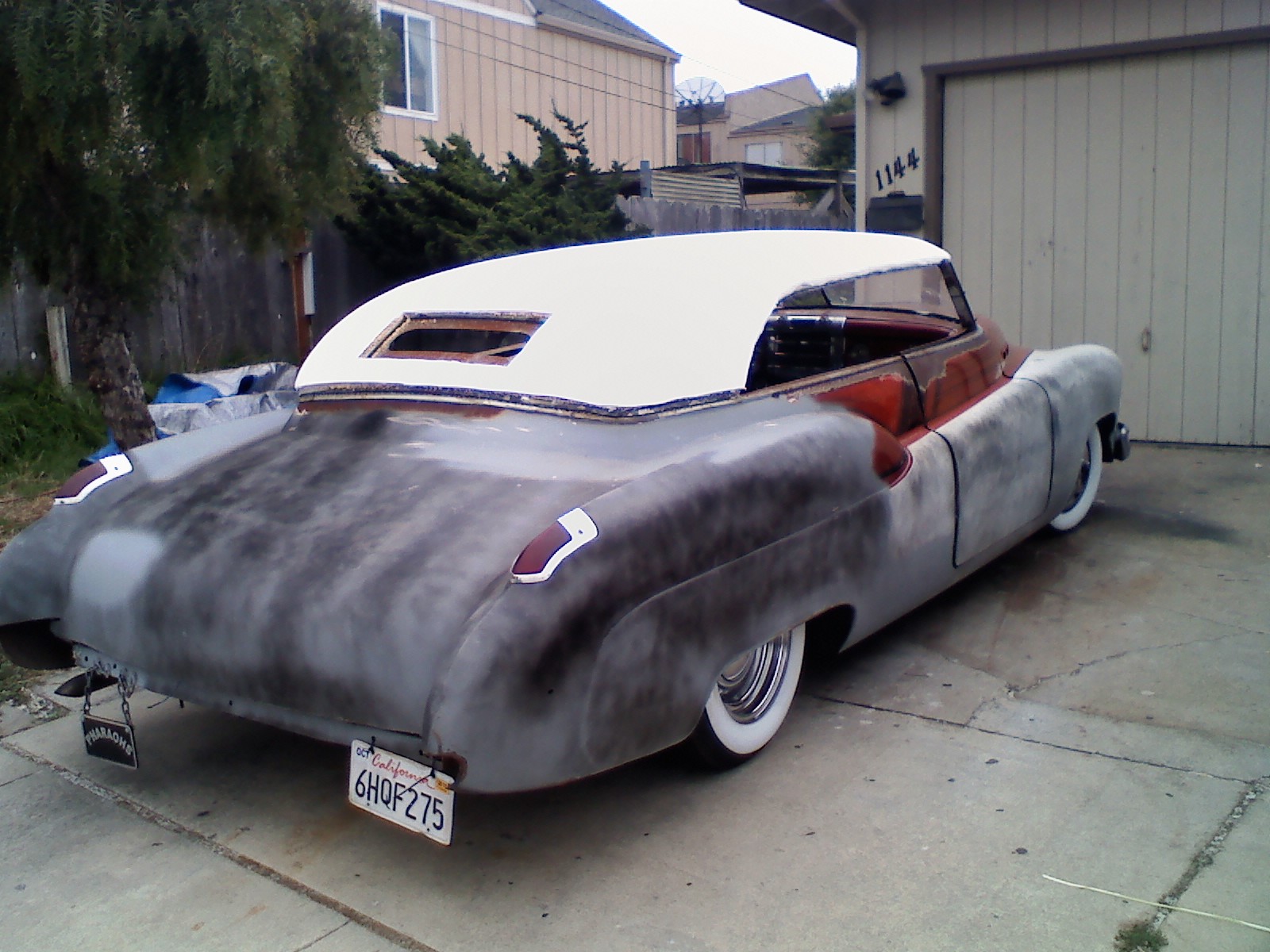

    More of this Carson Top ...

    Was this a 4 door car to begin with or a 2 door sedan ?

    rear window too small,doesn`t flow....good job though

    Wow!!!Great look. Seems the backlite is recessed. would like it better if smooth with roof panel.

    Took the rear window out of an old roadster after we got it done figured it was wrong, like I said this is my first try..Now I know what I did wrong and the next one will FLOW...Thanks for the input I need all the help I can get... We got guys out here that know this stuff but they won't share ideas,,

    x2 does not flow well, not that i could build one if i tried. just my two cents.

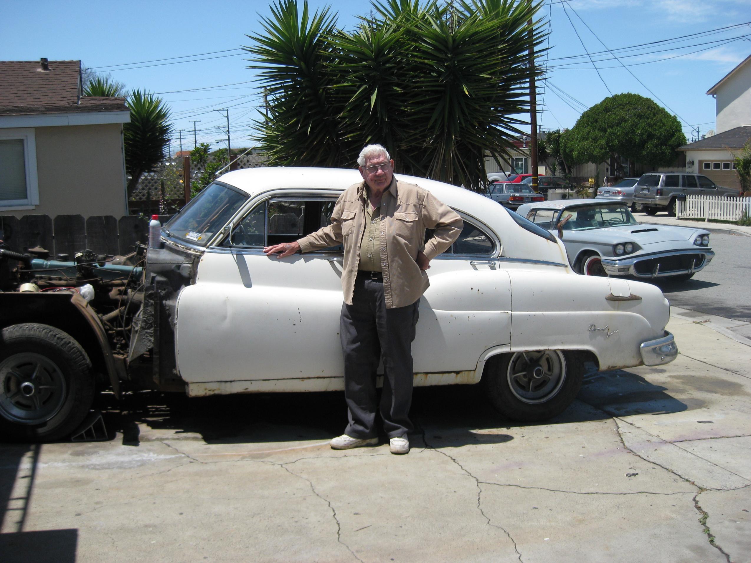

    Here's what I had to work with. It was on the way to the junkyard when I highjacked the tow truck and took it at wrenchpoint !!!:eek:

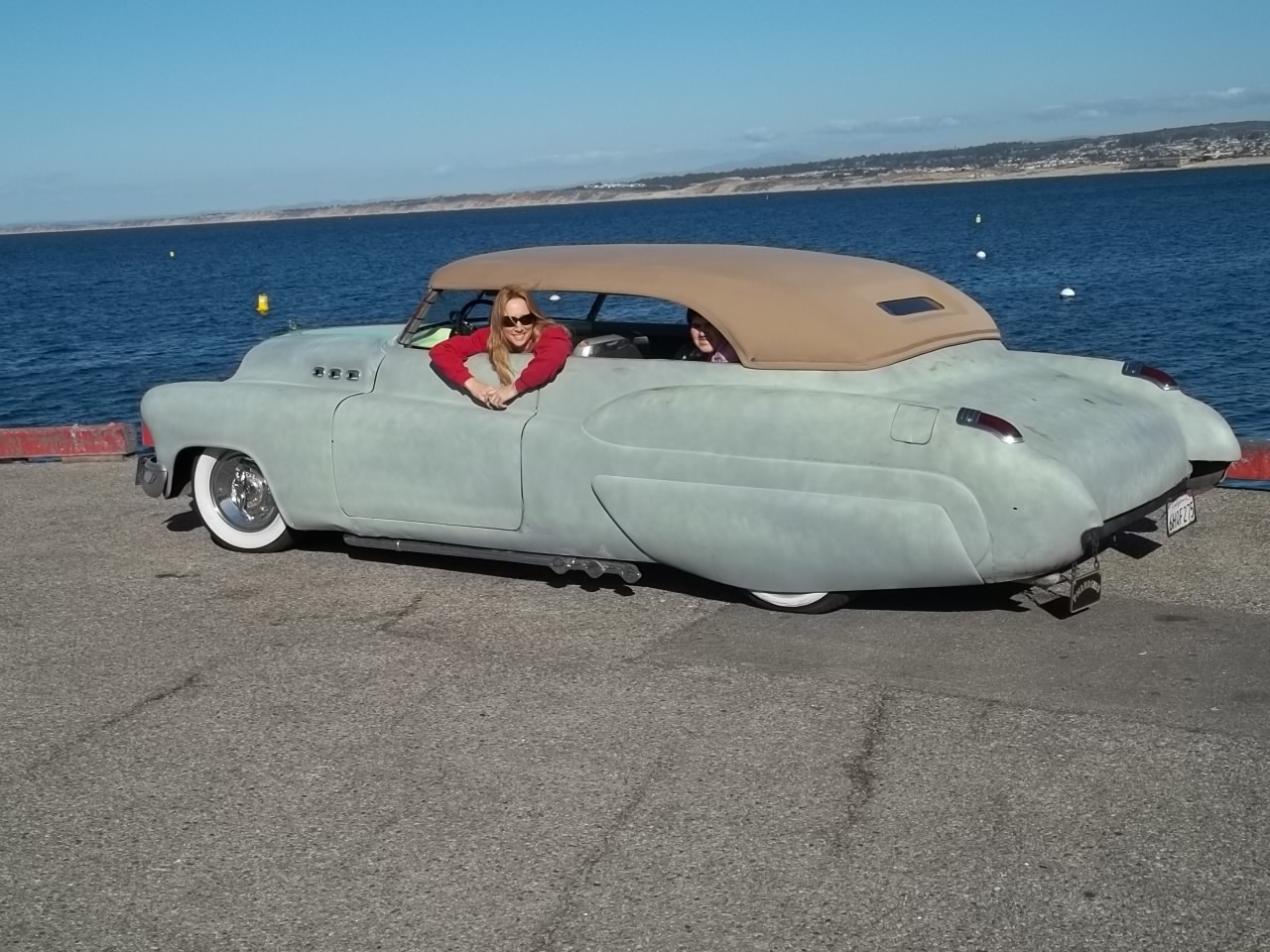

    So I feel as if I came along way's from what I had to work with, It wasn't like I had a Merc to start with !!! Like this one below...

    Bigcreep that is so true just tryin to have some fun,, I will attemp another next year for myself again.. Like you say not tryin to make a livin at it just fun for me... Thanks guys for the comments it really helps me and shows that there are people out there that will help a driveway shade tree kinda guy out THANK YOU GUYS...

    Looks like your technique is good. Just fine tuning the lines before committing to fabric would do a lot.
    You could have gotten away from the 4 door look a bit by bringing the leading edge of the C pillar forward a bit and sweeping the back of it down more like a fastback. It actually has a little bustle at the back that accentuates the sedan look.
    Having said that, some of the coolest early Carson topped cars were 4 doors.

    I disagree with the rear window being too small. I think the problem lies in the trunk panel. It's just a little flat in the trunk area. Needs a little more curve. Not knocking your ride and you're off to a good start. Best of luck to you.

    good finish but if you were to do it over again you shoulda laid the rear end of the top down lower to flow into the trunk and lean the rear glass down also woulda flowed better into the trunk area ....but the finish is super nice looking ...just my 2 cents..

    From a style/design point of view...I agree with the lack of flow. Still good job.
