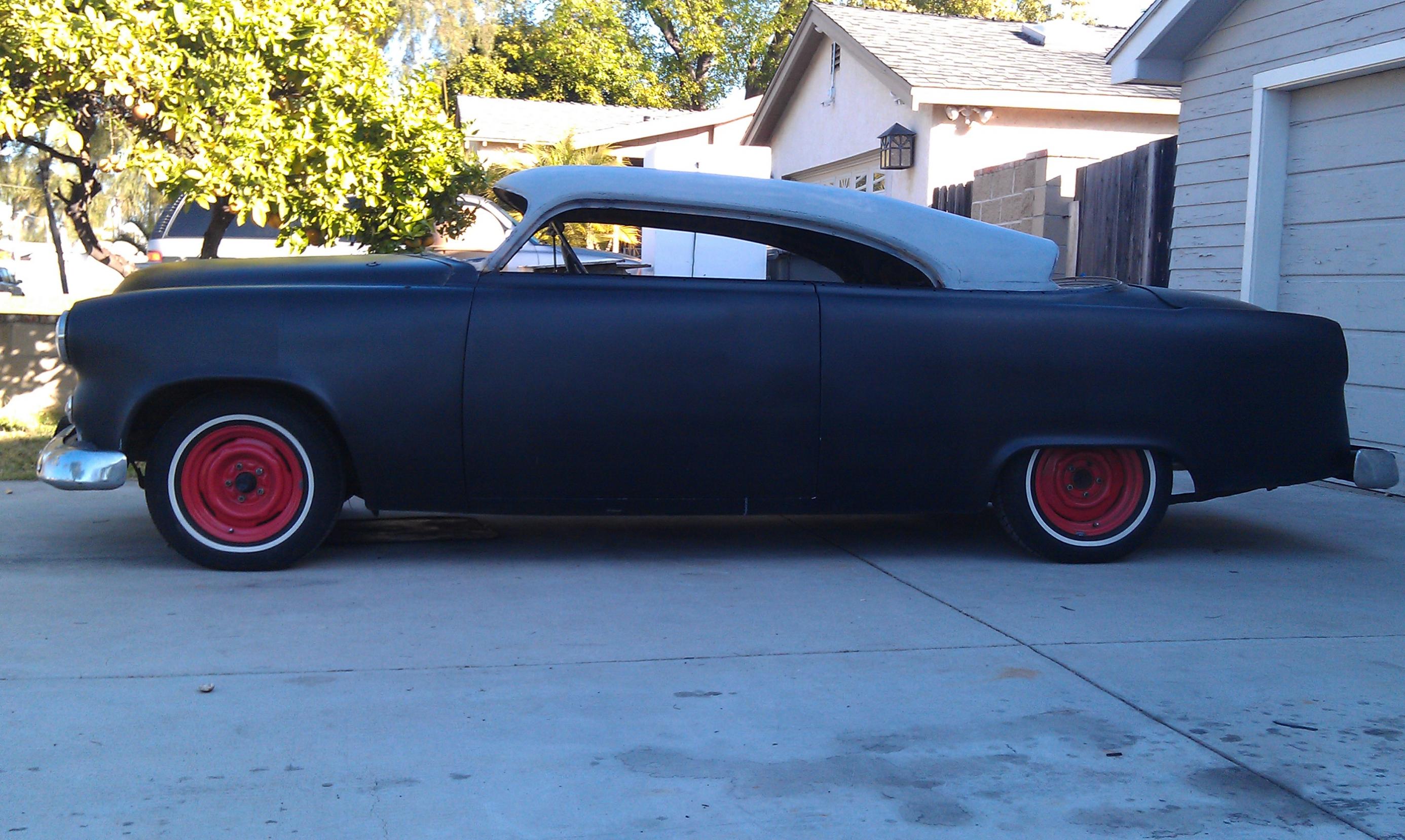

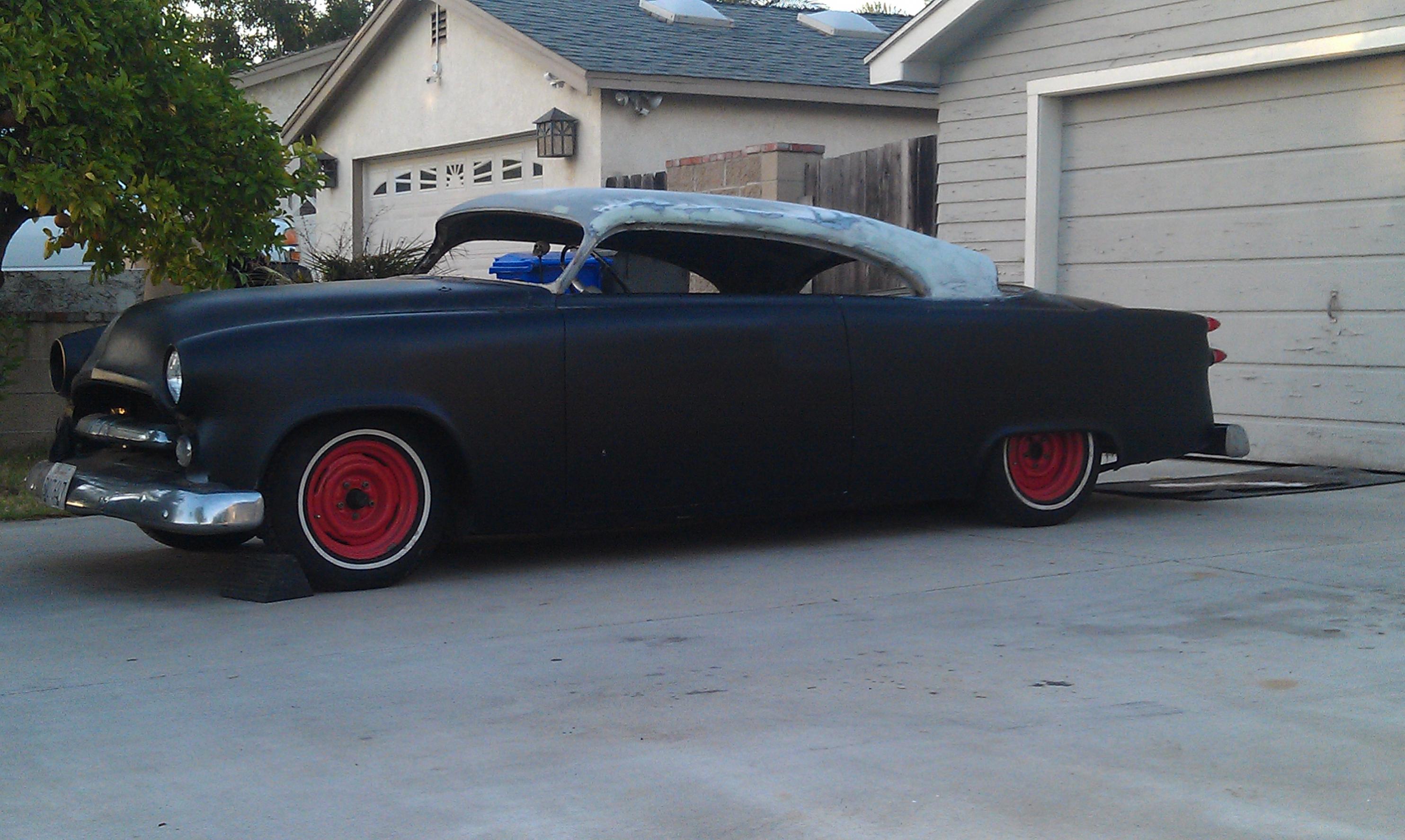

    50s Mopars have that ugly "lump" on the back. I chopped 3 inches, then 4. Then a guy we know that chopped his own car came over and asked with a straight face, "Did you chop any of it yet?" So, I did 5 in the front, 7 in the back on mine, only to make sure the rear flows. I also have a different rear window, since it's a Sport Coupe (hardtop). I think it would have been easier if I had the same window you have. The black car is mine, the brown car is what I was shooting for. I hope this helps.

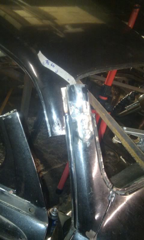

    On to some minor updates. I was able to spend a couple hours monkeying around. I sleeved one a pillar. I did exactly what was suggested and took the section that was cut out and chopped it up to fit. I then drilled 2 holes in the pillar for a spot weld to hold it in place.

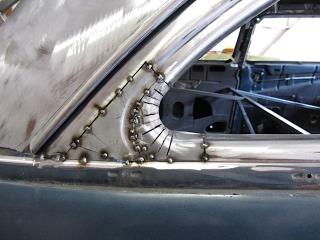

    You lost me a little on that. If you mean the gap at the back gl*** is wider than the front, thats normal. My roof was widened 3"s at the back and 1.5"s in the front (then I split that to be .75"s on each side of the widows peak).
    I could take a pic later if it would help.

    this pic should help: (yes there was a little misalignment correction on the drivers side)

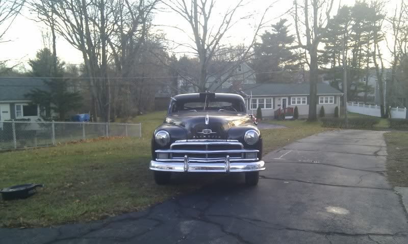

    I started by trying to lean the pillars in instead of widening the roof. So put one cut in the p***enger side. Then i decided i was better off splitting the roof. When i got to the driver side i saw that on this car the a pilars twist slightly as they go from the hood area to the top of the roof. So i then put a relief cut on the driver side in order to twist it ever so slightly to line up perfectly with the roof.
    I didn't get any work done yesterday. Trying to catch up on sleep from all the studying, then partying after the last cl*** of the semester, my motivation was a bit low. I did atleast get it out of the garage to take some pictures.

    Here is a quick edit i did with paint, to see how it would look onces its lowered with the skirts, pillars slanted and rear gl*** leaned down.
