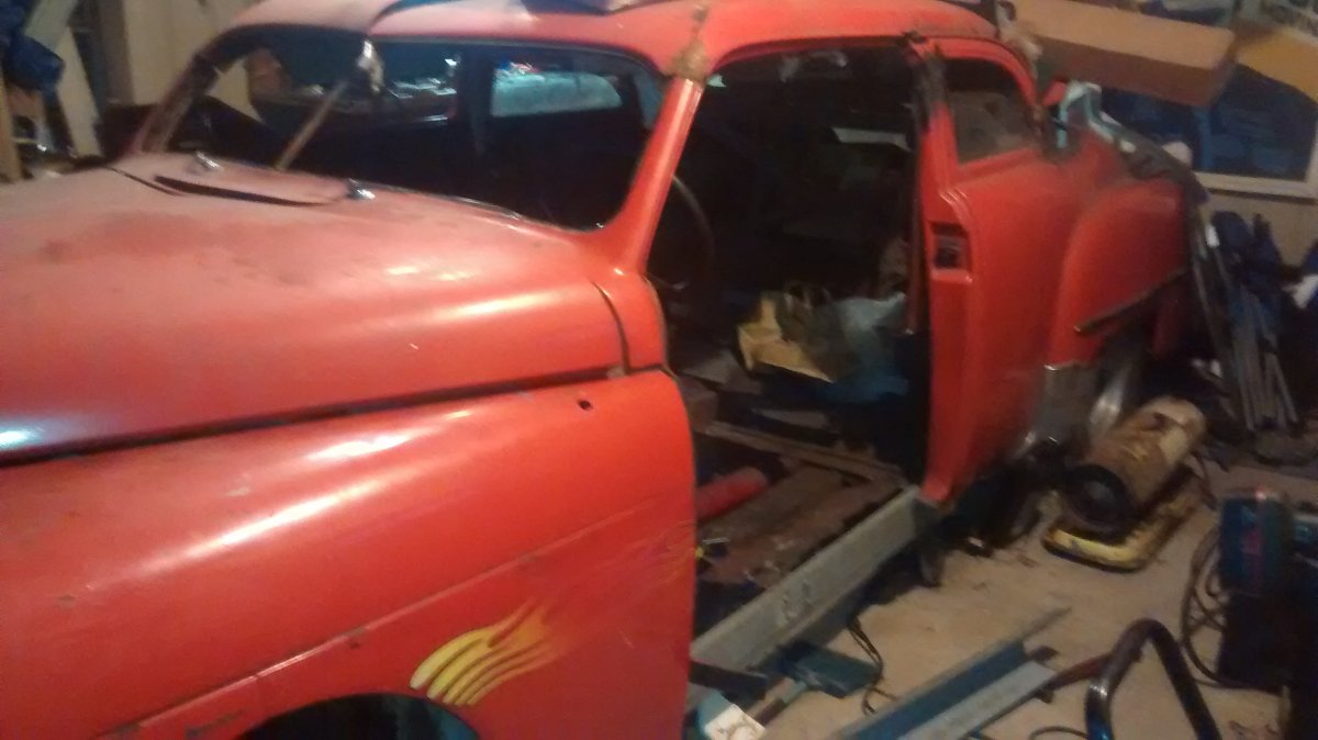

    So i flipped the rear window to take a look. Didn't really like it. I took a few pictures, but didn't bring it outside because it was already dark out.
    Then when i flipped it back to how it was i took out another inch off the back of the roof, and slid the class forward some more. It tightened up the curve where the window meets the roof much better. Now it will barely have filler.
    From there i made a ton of reliefe cuts and started going at it with a hammer, dolly, and torch to get the shape i wanted. Its almost there on the passanger side. a Little more and i'll be happy with the results.

    Looks like you're getting the hang of metal fabrication/modification. It's a matter of trying, perfecting and lots of patience. You'll get there!

    Looks good. The flipped window doesnt look right for this car, good call on leaving it. I hear you about the whole NEW suspension, the factory stuff gets fatigued after so much use.

    the upside down window definetly looks like butt!
    Just something here to check on, make sure the strip of metal that makes up the bottom of the window frame stays pushed up against the gasket. The weight of the glass will push that metal strip down and if you weld it in just like that, the gasket will be loose and therefore so will be the glass.

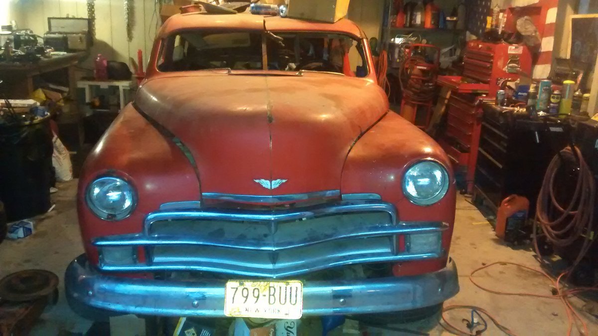

    I haven't gotten very far on my 1950 special deluxe at all. Time suddenly came at a premium once my wife started having babies, ha-ha. Well that and last summer I built my self a daily driver truck. But i started working on my project again too, I have been working on installing new floor pans and rockers while dreaming up a new fire wall to fit around my big block, I figured i would work on the hacked roof and door frames last after brushing up on my fab skills on the less noticeable areas of the floor and firewall. I might just go buy a roof cut from a salvage yard to work with, it would save me alot of time as mine is hacked up so bad..
  29. rusty snack
    Joined: May 19, 2014
    Posts: 11
    rusty snack
    from ARCADE,NY
    here are some pictures of my project finally 2015-04-16 20.01.06.jpg 2015-04-16 21.55.38.jpg 2015-04-16 23.03.54.jpg 2015-04-16 20.02.08.jpg 2015-04-16 20.01.21.jpg 2015-04-16 19.58.17.jpg
