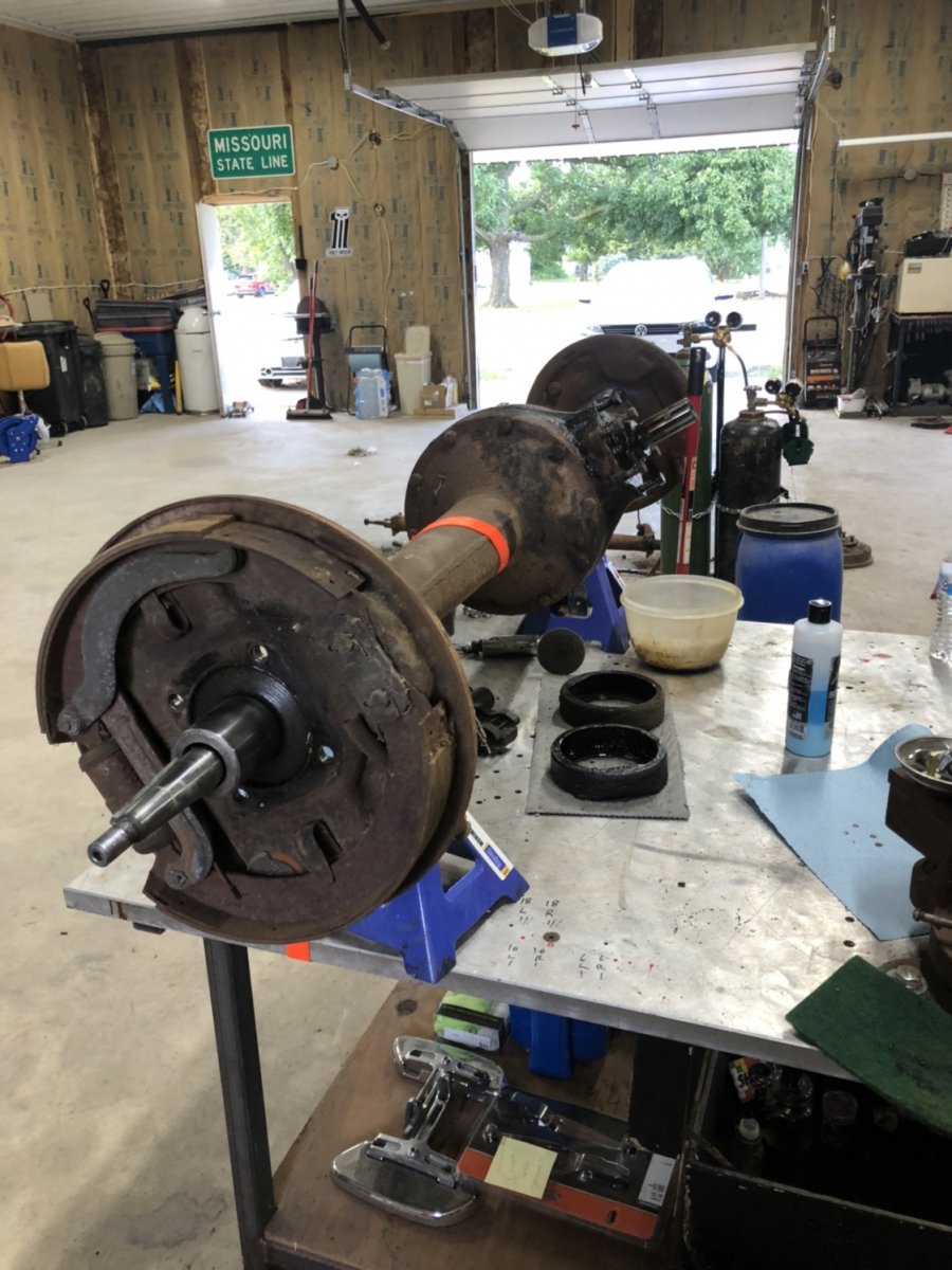

  6. Ok guys got the other backing plate and hub removed from the donor rear end. Going to clean up the mating surfaces and bolt them together! Did lose a piece of hard ware to the hot wrench lol! IMG_5019.JPG IMG_5016.JPG

  7. wheeldog57
    Joined: Dec 6, 2013
    Posts: 3,858
    wheeldog57
    If you don't have another square bolt you can use a hex bolt. I think it's 1/2" fine thread.
    Logan LeMaster and 48fordnut like this.
  8. ironfly28
    Joined: Dec 22, 2003
    Posts: 1,032
    ironfly28
    from Orange, CA
    Did you spin those backing plates around after you took that picture? Or were they on there sideways? It's not fair to mess with people's heads man.
