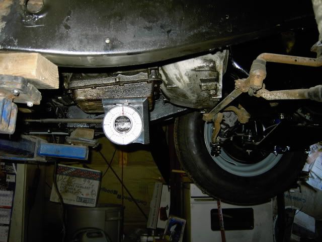

  2. cut the trans. tunnel out of the floor to get a better perspective of the situation......raised the ****** about 1" to get the 3 degree drop at the pan that I wanted..........the manifold is out of level 3 1/2 degrees and I can use a angled carb. spacer to get it level if needed........I'll have to check it again, but it looks like I don't have to raise the floor to accommodate the ******........

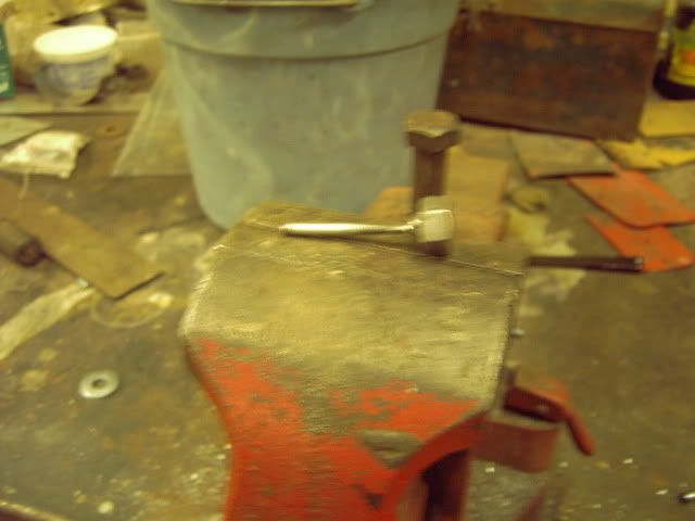

  11. changed the bear claw location.....put the claw in the body of the car and post in the door.......ran a rod from the opener mechanism down and out the rocker...added a threaded extension to the supplied rod, welded a nut on the end ..pull and the door opens from the outside.......drilled a hole on the rear window casing to access the claw mechanism from the inside of the car ....bent the stock rod to fit in the opening mechanism attached the door lock knob and push down and the door opens from the inside....... p***anger side hinges shot ,to much sag, former owner switched the hinges....... sending them out to be rebuilt...Shoebox Ford Enterprises........only broke off two screws......
