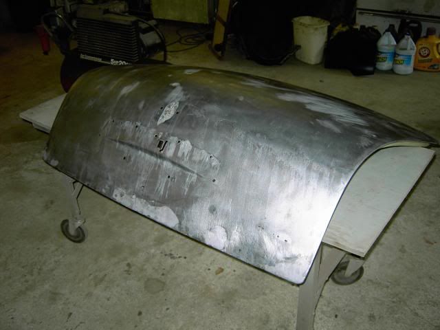

  11. well the trunk lids been bugging me, so I got out the lead and repaired it.....I'm not the best leader but I enjoy the hell out of it........

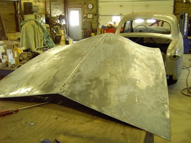

  14. trunk lid sanded, treated with zinc phosphate, need to lead a few more spots.....hood was stripped, ready for sanding
  15. prep work on the hood........
