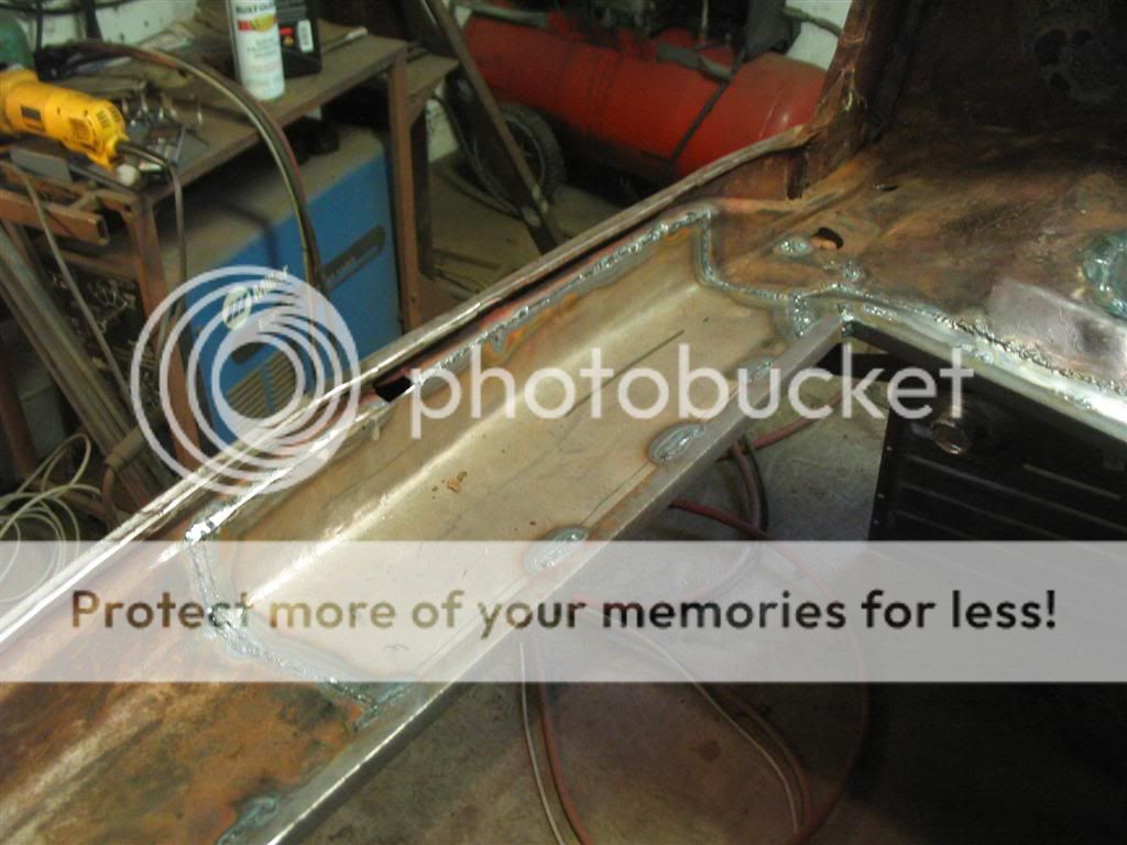

    The p***enger side rocker went in a lot easier than the driver's side.
    The fit just seemed much better.

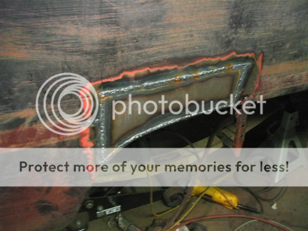

    Next, I tackled the p***enger quarter panel rust.

    Hammer, shrink, repeat.....

    Hay man nice work. What gauge steel you using for patches??

    I bought a 4 X 8 sheet of 18 gauge, I'm using it for everything, floors, patches, etc.

    is that a magnet from a hard drive? those things are ridiculously strong. this is awesome stuff and it makes me want to get cracking on mine again! You can see how i get side tracked...

    the-rodster
    Yep, I figured another computer geek might spot that.
