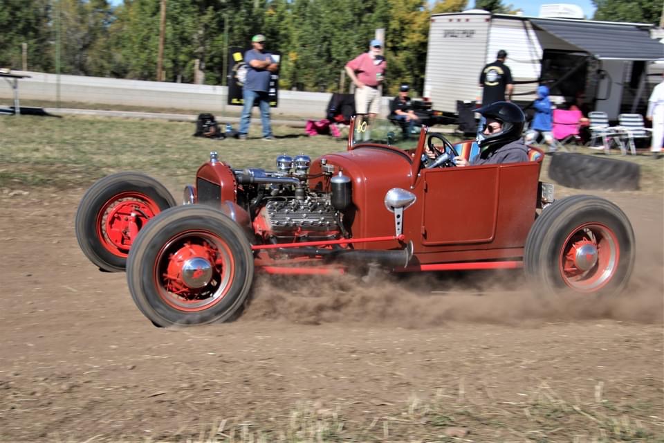

    This is my 26 that started as a touring. That’s what you have for sure. I would like to see the back end of it. E68DD347-3DAD-495E-822A-E49242A2DB3C.jpeg
