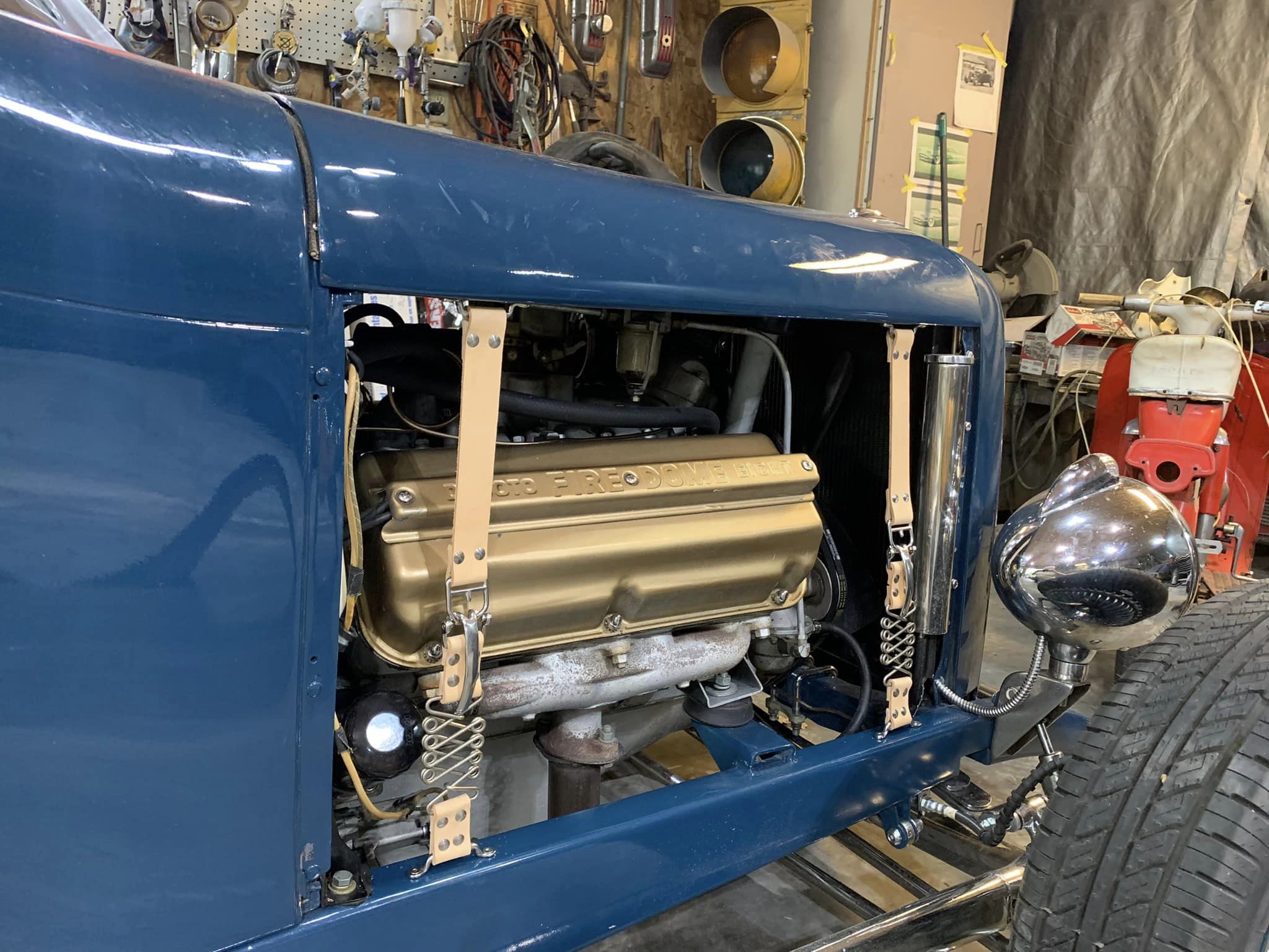

    A look at a couple of the bores. Will have more this weekend. Valve cover and oil pan gaskets are fel pro cork with the blue stripe, don't seem to be very old IMG_20241116_144727774.jpg IMG_20241116_144717916.jpg

    I am definitely going to take my time. I have all winter. I want her to run and run good
