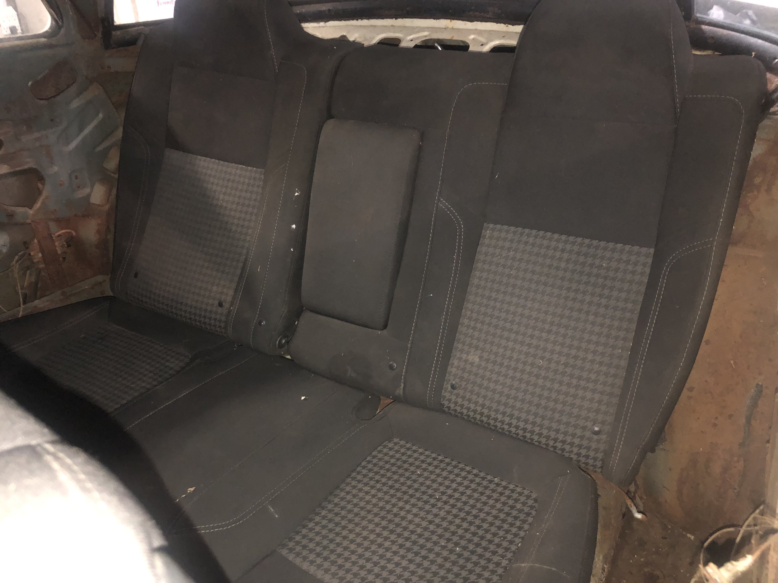

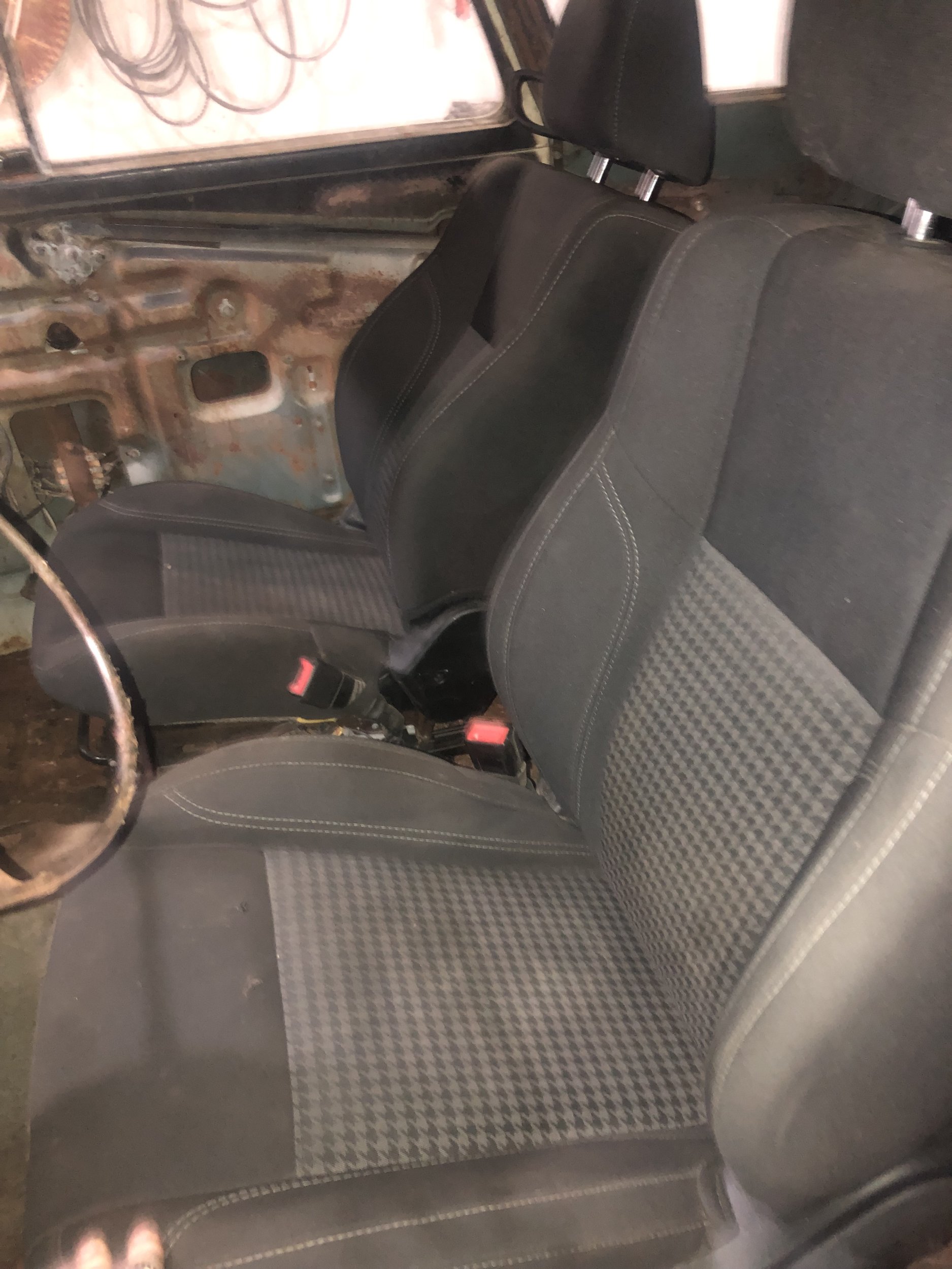

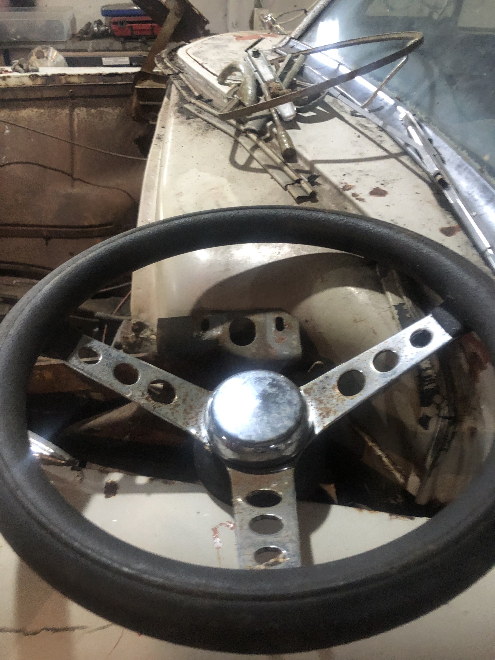

    Been working slowly on the engine cleaning her up. Got all the rods and mains, inspected, lubricated, and re torqued this past weekend. Scored some free seats and and a steering wheel I might use if I can. Had a very nice bench Im debating on using too. Don’t know which yet IMG_0086.jpeg IMG_0087.jpeg IMG_0089.jpeg IMG_0090.jpeg IMG_0091.jpeg

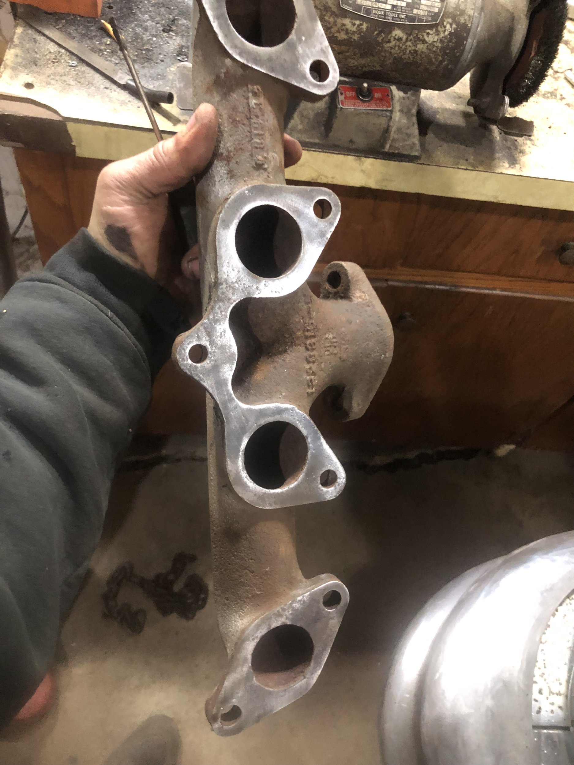

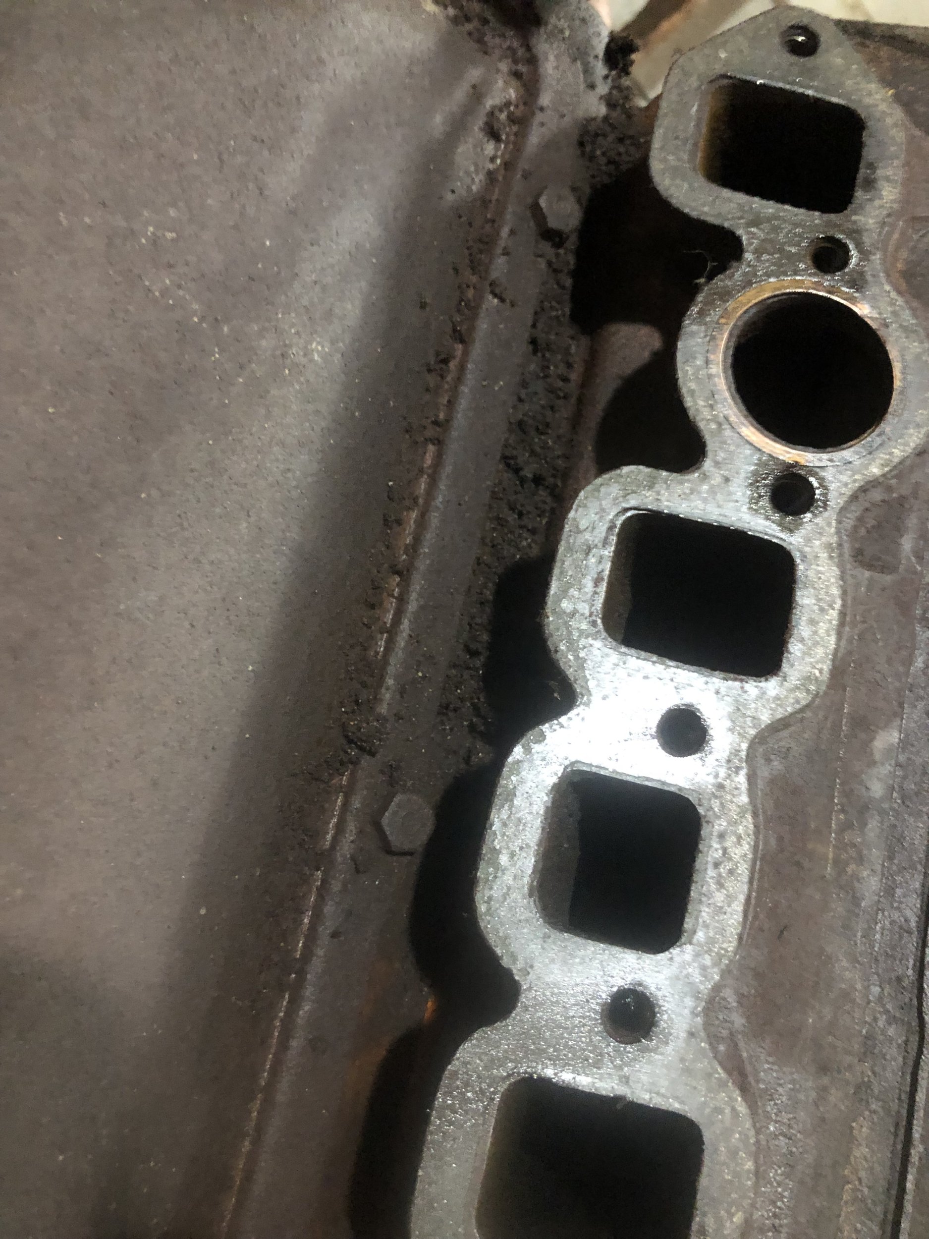

    IMG_0107.jpeg IMG_0106.jpeg Got the valley cleaned up, cam and lifters lubed, and my manifolds bolted on today. May buy some shorty headers later after I get it running. Pretty much dead set on bolting a 4 barrel intake on now instead of playing around with the 2 barrel. I have a line on a 4 barrel intake with the thermostat housing on it for 250 plus shipping. I’d rather spend the money on a hot heads one but maybe later after I get the car rolling under it’s own power and stopping. Got a long way to go still for that but can’t wait to hear this baby purr . Got the starter in the shop getting rebuilt
