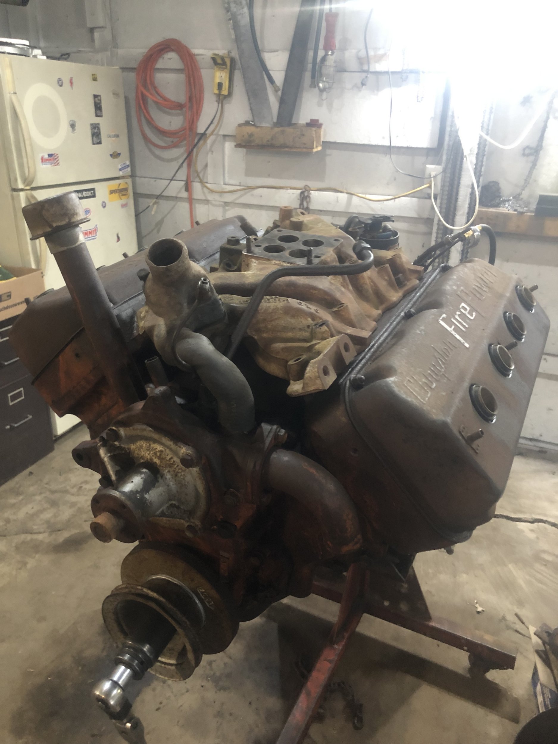

    Got my one year only “wet” 4 barrel intake that i probably paid too much for . Just need an adapter for a big base 4 barrel carb now and a way to clean loose scaly rust outve the intake ports. Any ideas? I tried with a wire brush on a drill a bit but I really need to get way into the ports just to make sure I get it all. I know I could’ve bought an aluminum 4 barrel intake for 600 from hot heads but I’d rather save for a blower intake because that’s my plan eventually IMG_0117.jpeg IMG_0117.jpeg IMG_0116.jpeg

    If you have a compressor, a cheap siphon sand blaster and a bucket of sand should get the worst of it.
    I have one of those manifolds (the original from the engine now in my race car) and plan on using on my '56 dump truck 331. Carburetor adapters are generally a bad thing, so I am rebuilding the Carter WCFB that came on it. It's easy to over-carburate these old engines.

    HH has a squeeze plate adaptor that you remove the carb studs, install longer ones & an Edelbrock bolts right up. You can straighten the airflow up by running the right size bit through both the adaptor & intake. On my '55 331 I found I had to add a phenolic spacer to keep things right in the Florida Summer (****py gas).

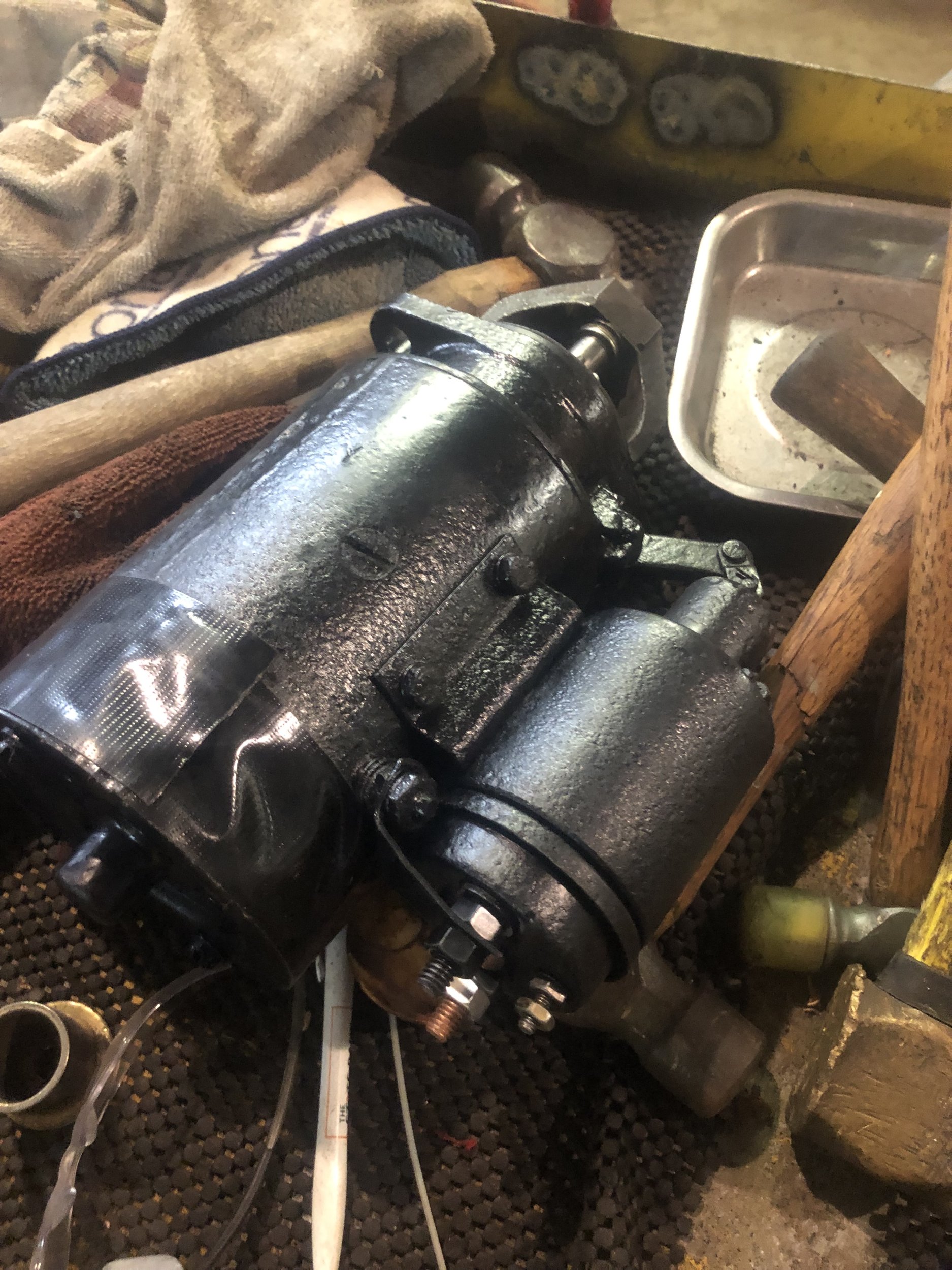

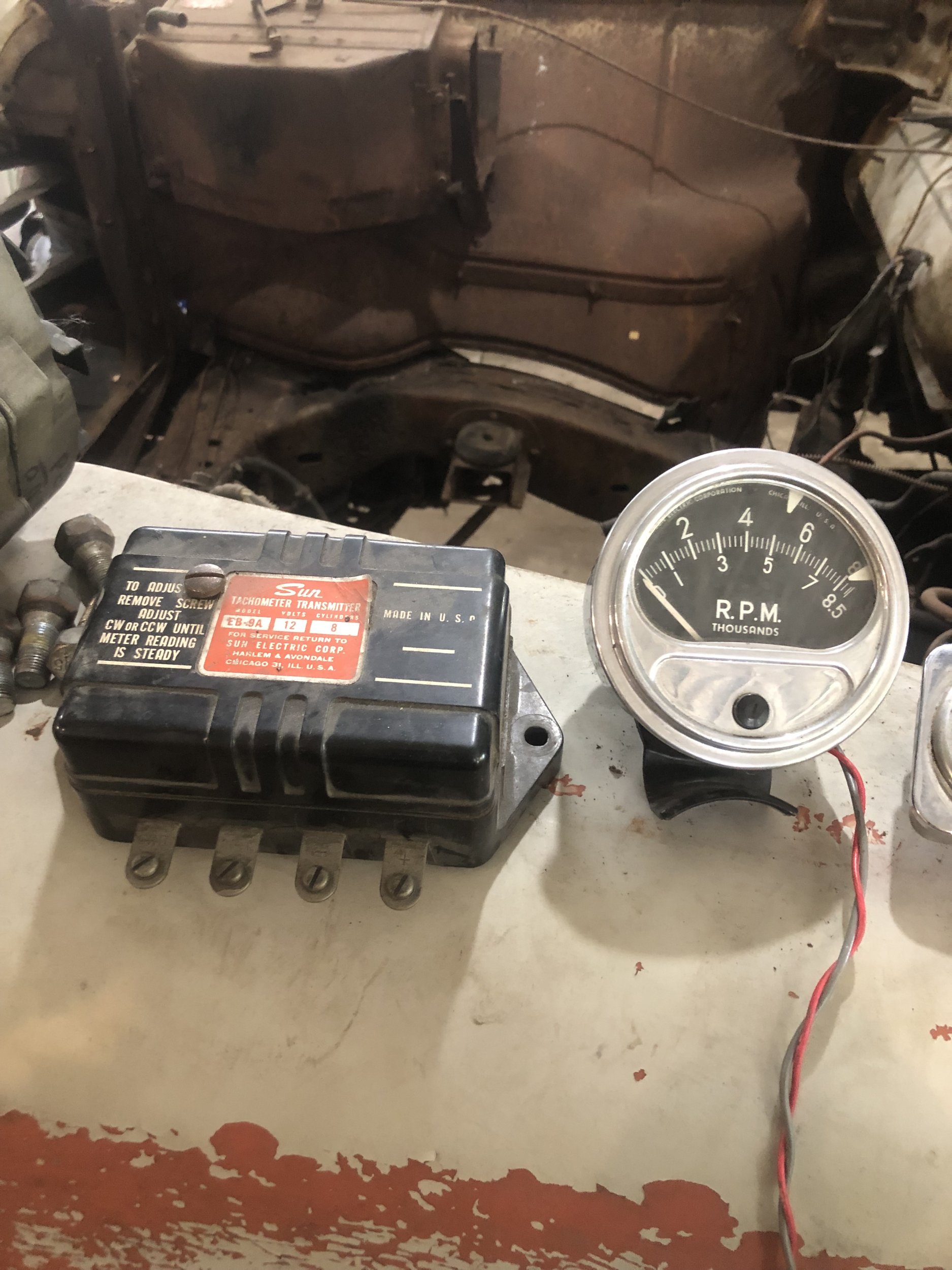

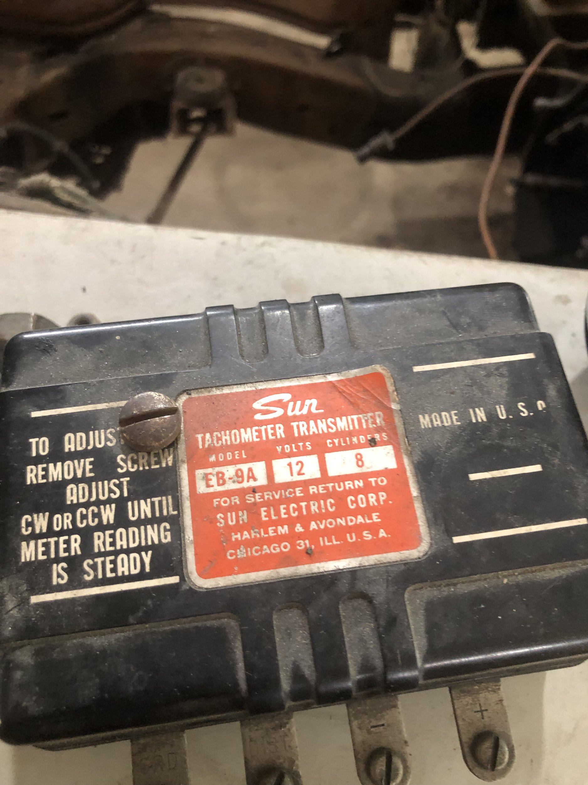

    Set my 54 intake on the engine. Still need to get an adapter for a standard base 4 barrel and some intake bolts and a carb . Had my starter gone through for 75 bux by a local starter shop and finally picked it up yesterday. Still have to get some nickel rod to weld a crack in the lower bell. Am I going to have to put a 12v set of points and condenser to run this engine on a standard 12 volt battery? I know the starter can take it. IMG_0184.jpeg IMG_0185.jpeg

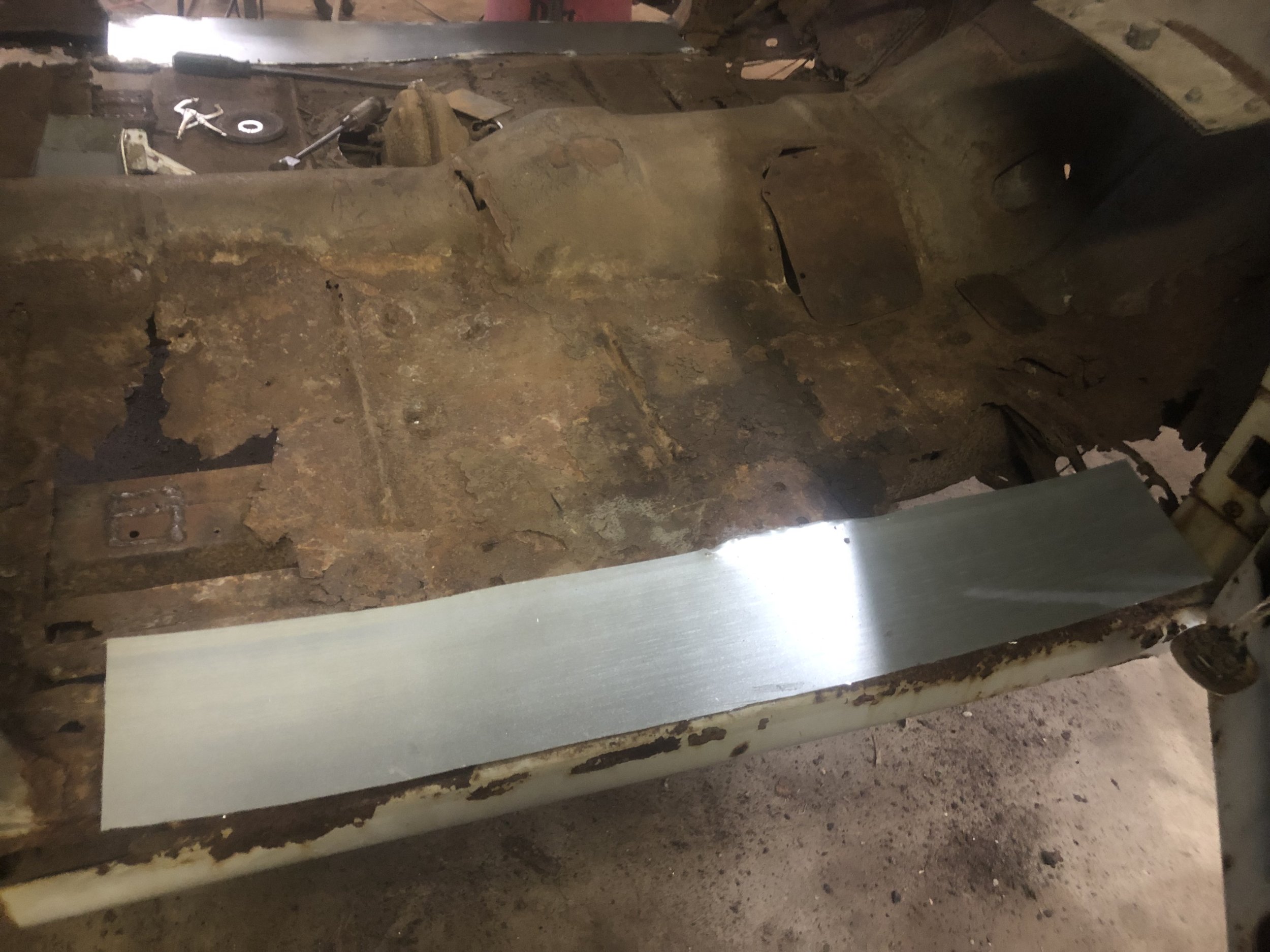

  21. Manostihl83
    Joined: Nov 17, 2024
    Posts: 106
    Manostihl83

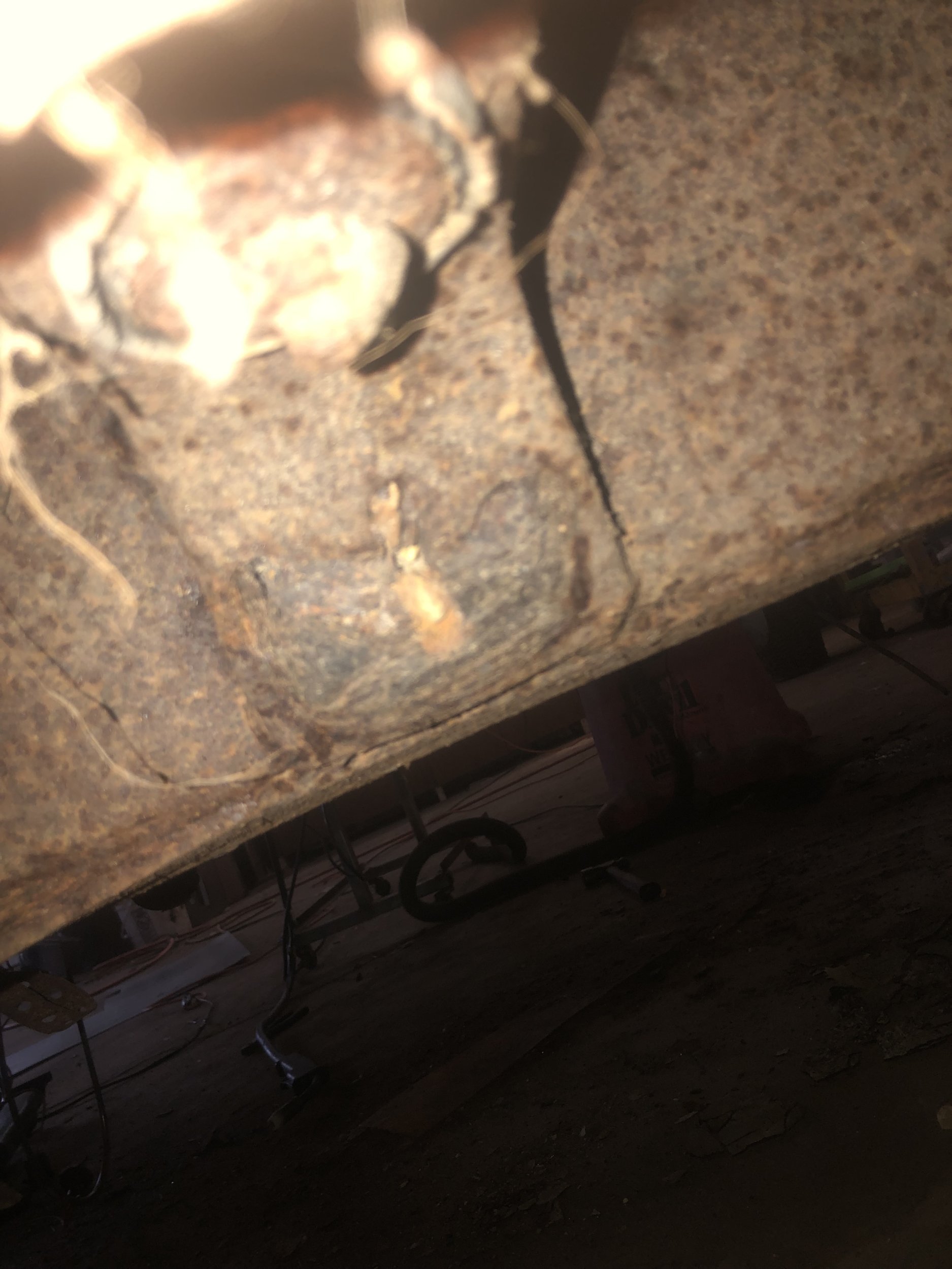

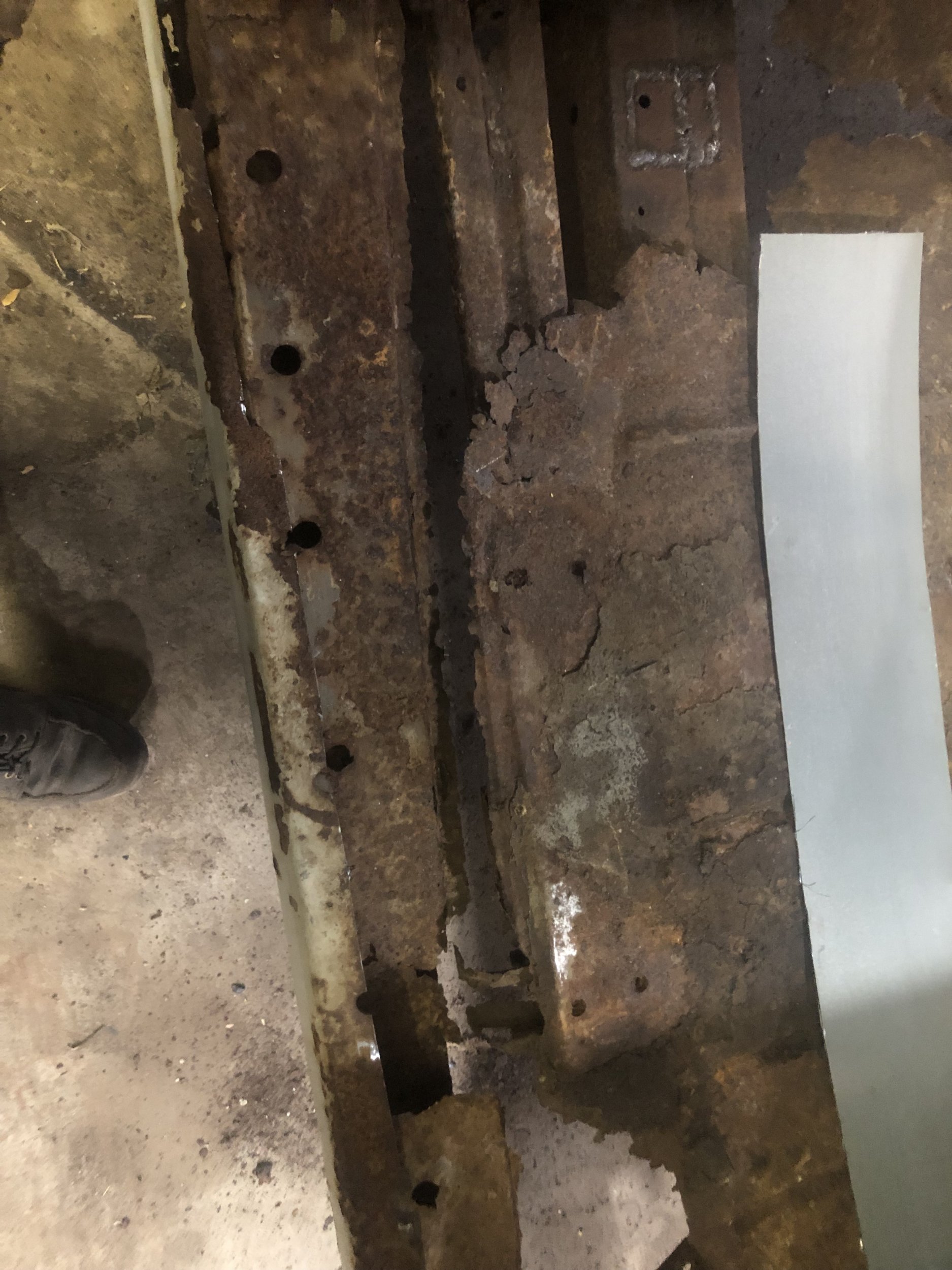

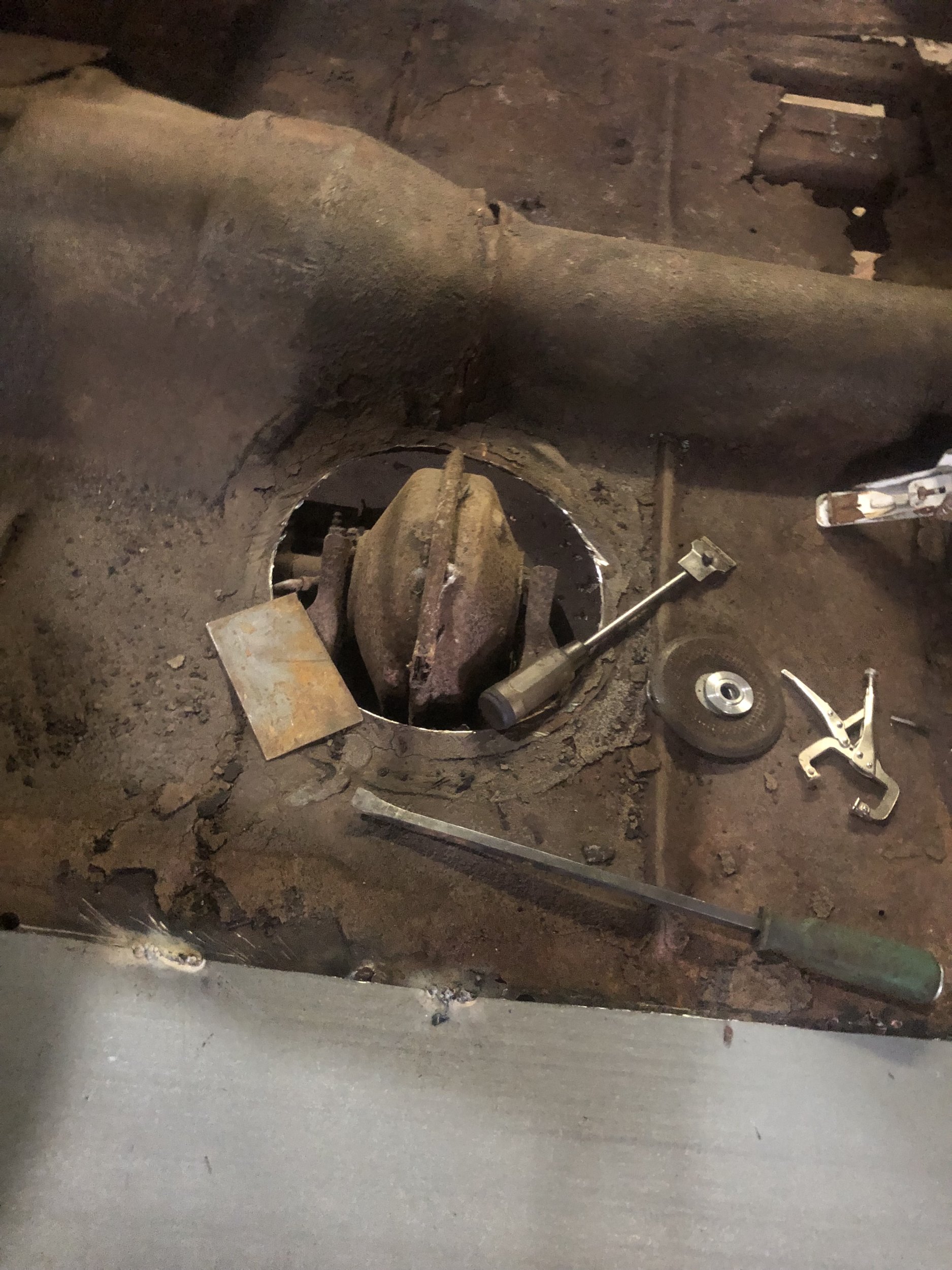

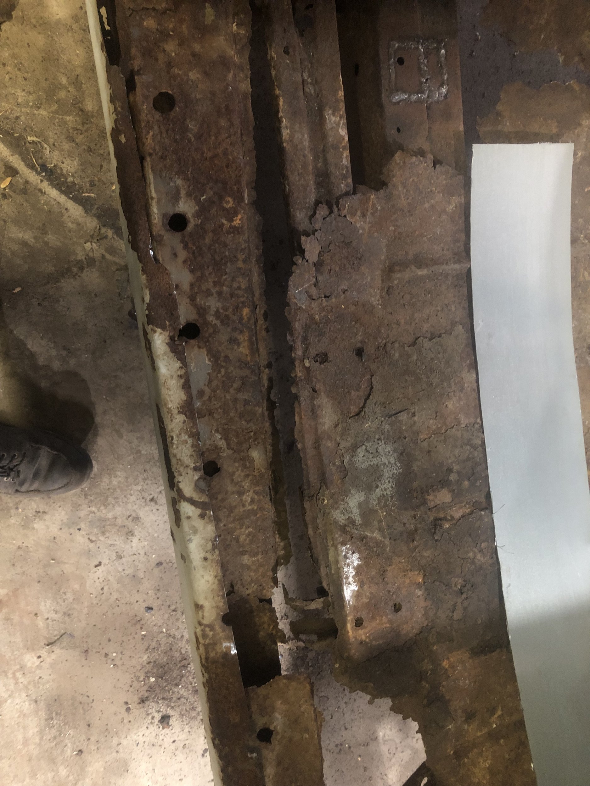

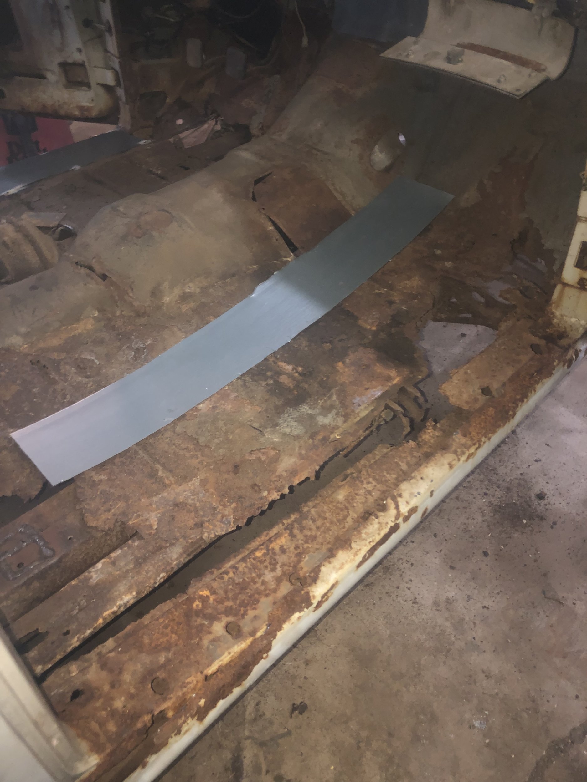

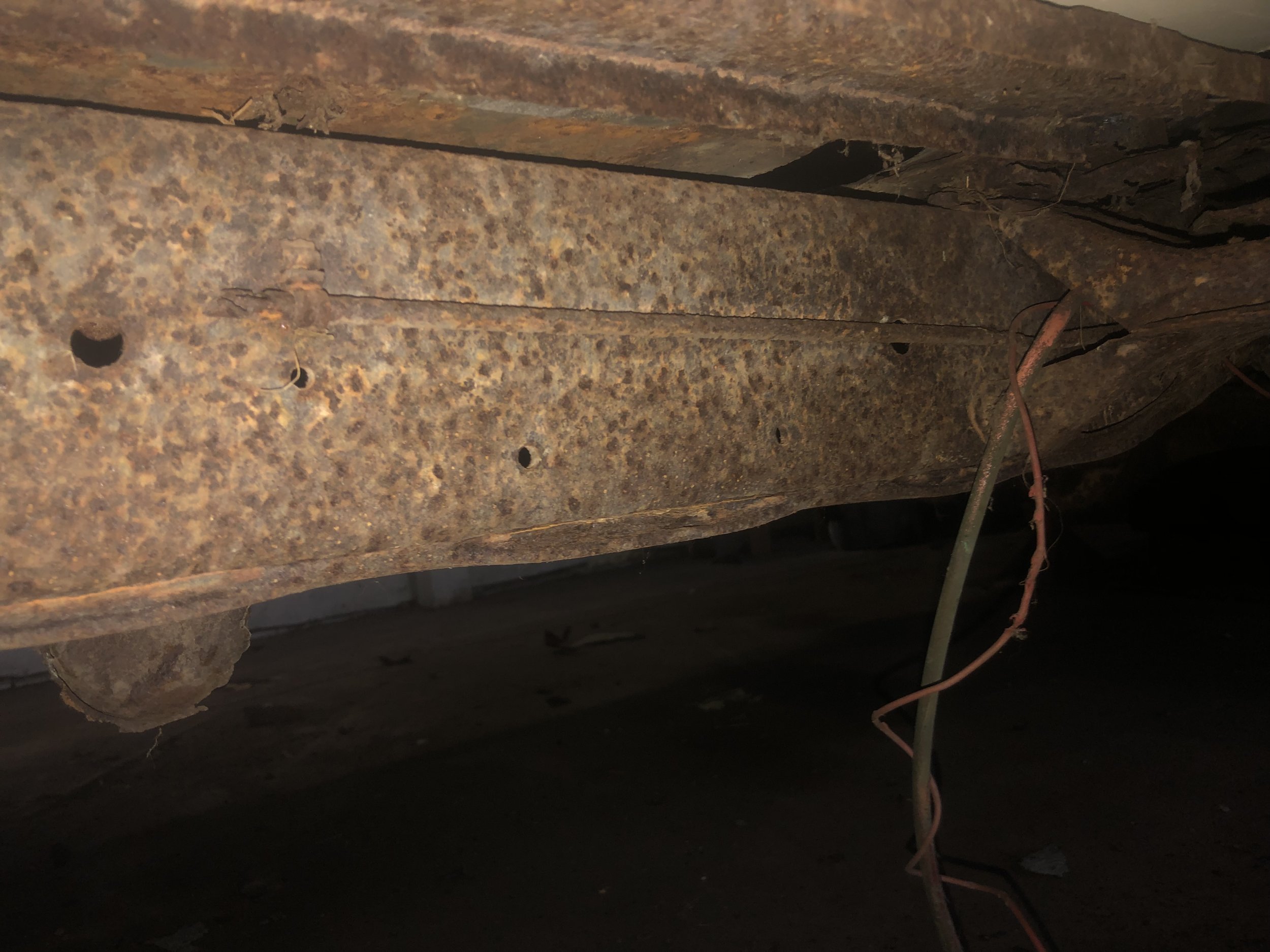

    Started re constructing the floors today. Have a couple floor support brackets to rebuild and some bad areas in the frame. I really need a 220 mig welder. I’m tired of my Clarke 110v flux core. Also had to cut a couple holes in the top of my frame to shop vac two giant mouse nests out of the rails but I was able to weld them up no problem with my 220 stick welder

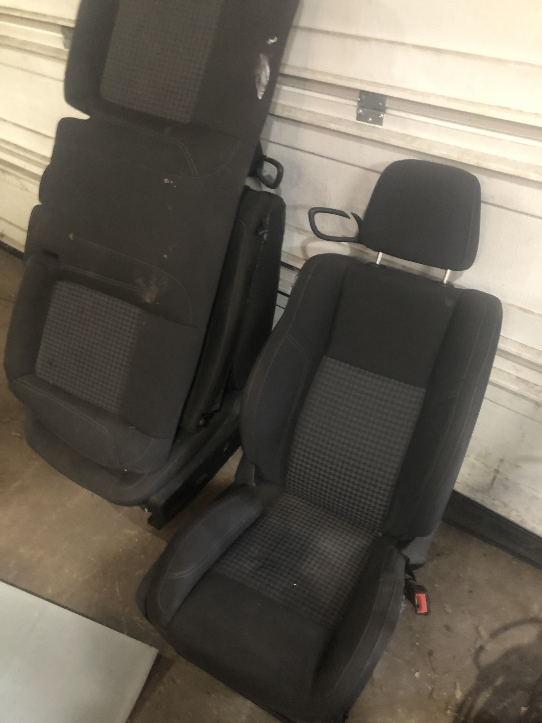

  22. Manostihl83
    Posts: 106
    Manostihl83

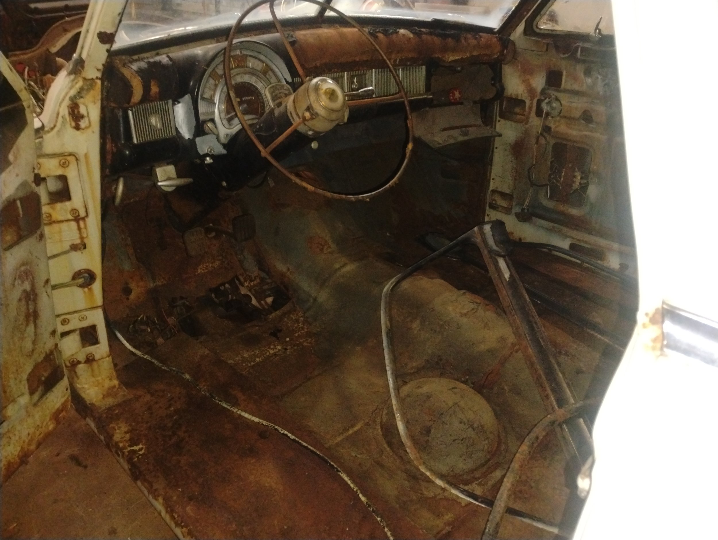

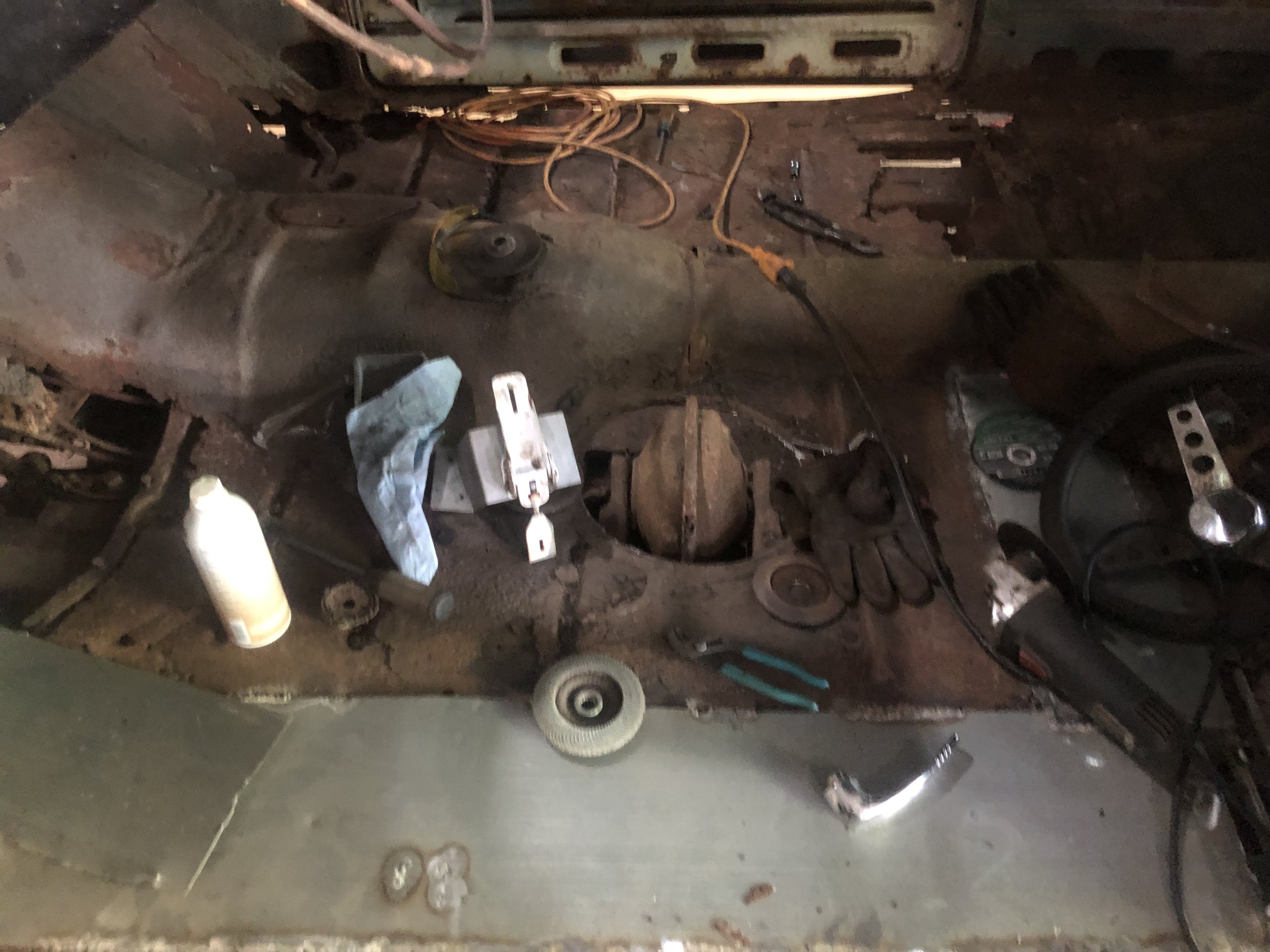

    I removed the hump in the drivers floor for the power brake booster to I can mount my free bucket seats in the car. Planning on removing the whole system and possibly going with a cheaper front manual disc brake conversion IMG_0187.jpeg IMG_0188.jpeg IMG_0188.jpeg

    You can open up the holes in the intake a bit by using the modern gasket as a template, or get the HH squeeze plate & use an Edelbrock carb and longer carb studs. The Edelbrock is drilled for the OEM bolt pattern. You can drill through the squeeze plate & into the intake or just use the squeeze plate & OEM bore holes. With today's ****py gas here in Fla. I had to add a phenolic plate to keep it from ****ping out at stoplights in the Summer.

    Main thing is the Edelbrock has the OEM bolt pattern, so if you used the carb gasket for the Ed. carb & opened the holes up enough for the ****erflys to clear it would bolt right on w/o the adaptor that would be needed for the Holley.

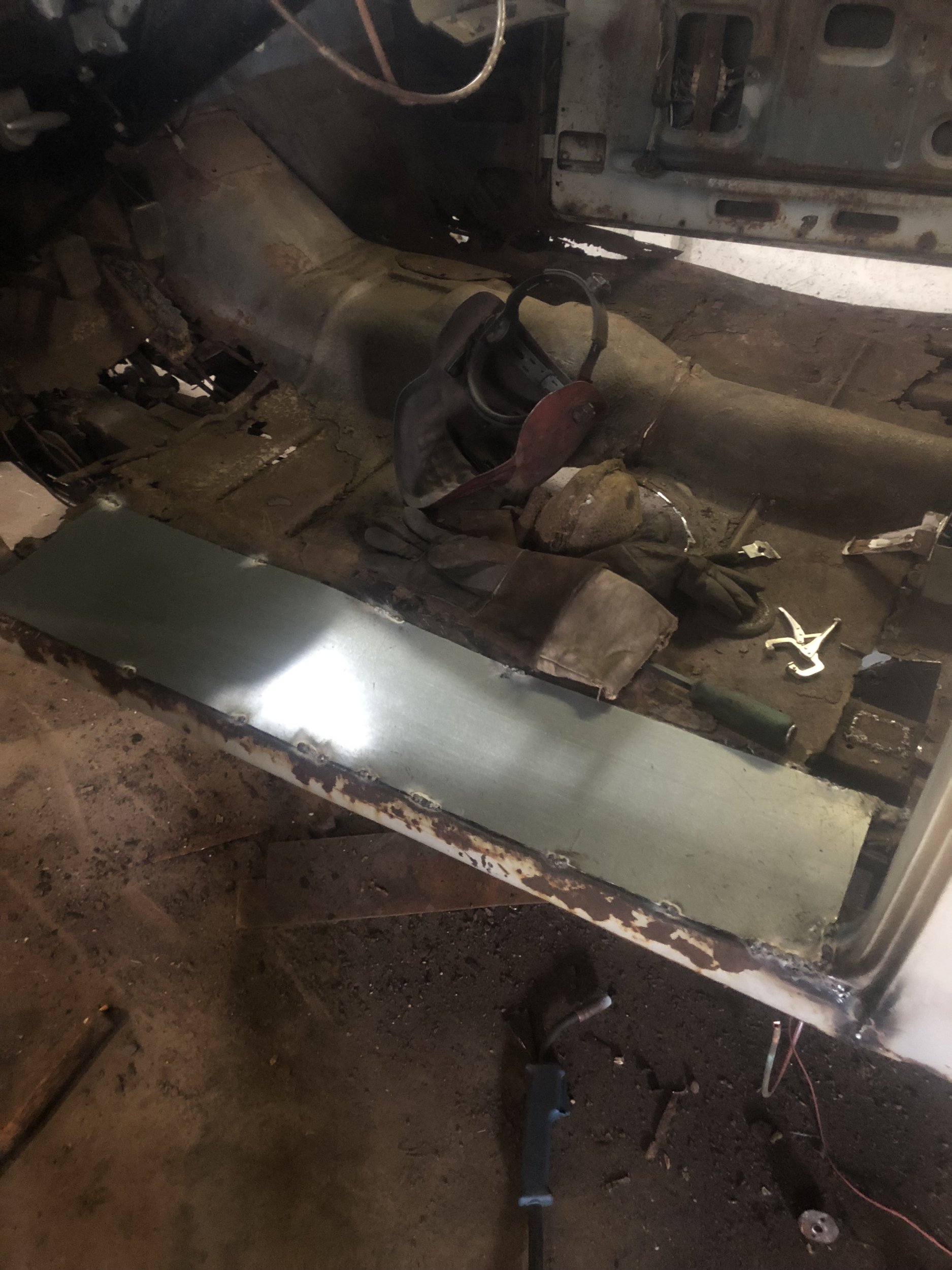

    Been a long time since I posted on my car. Have barely been able to work on it due to lack of funds thanks to winter. Maybe looking for a new job here soon. Welded in some fresh metal on the drivers side. Still haven’t fired the hemi up but I’m very close !

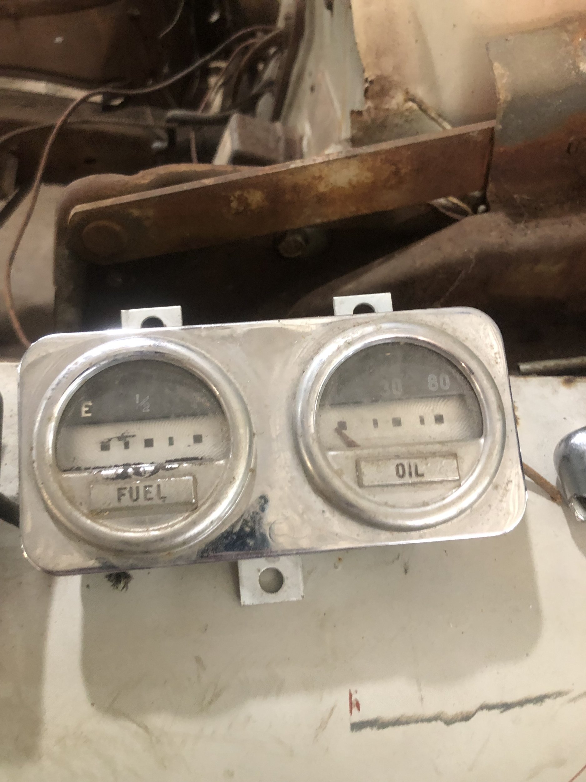

  28. Manostihl83
    Posts: 106
    Manostihl83

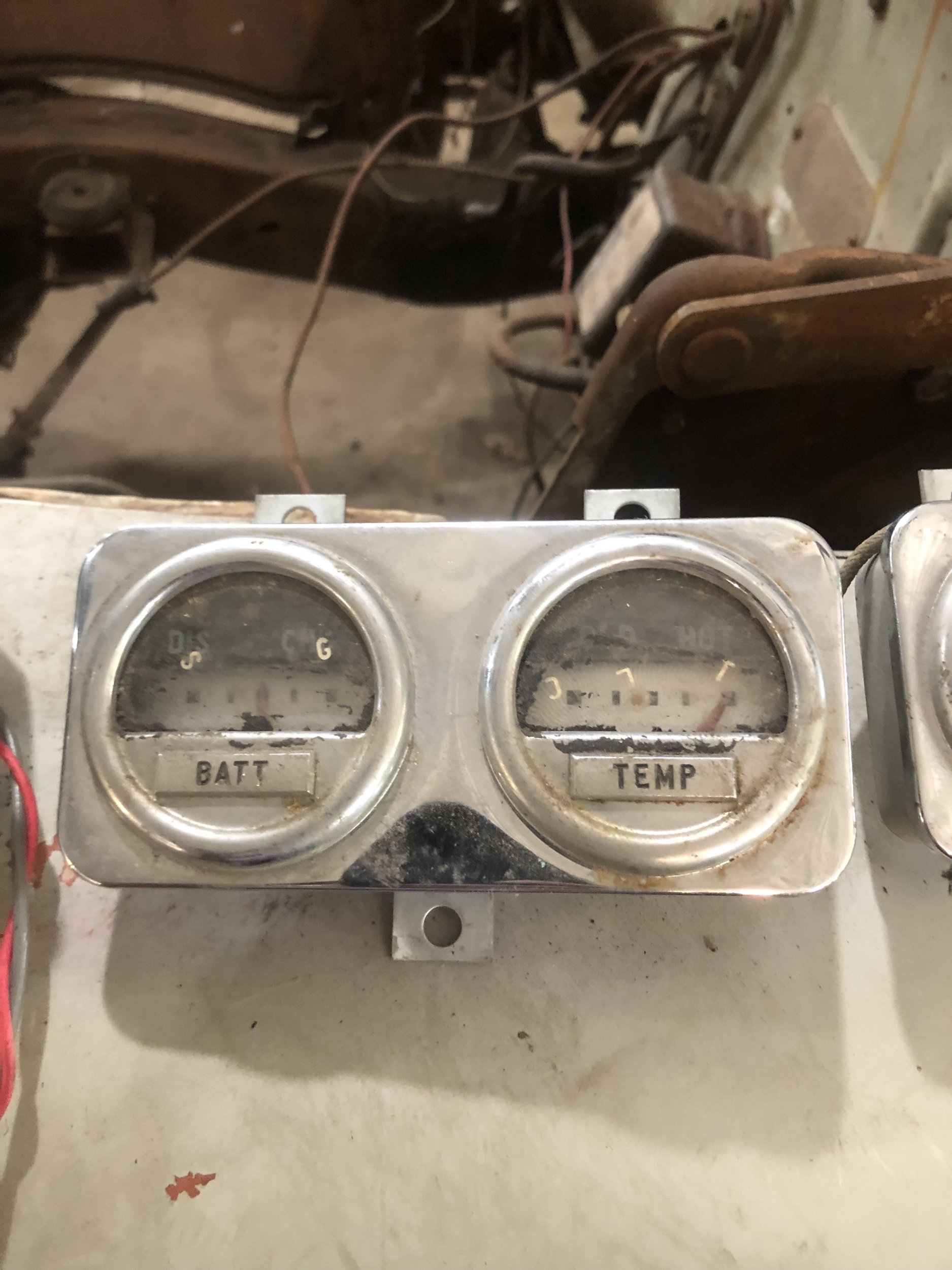

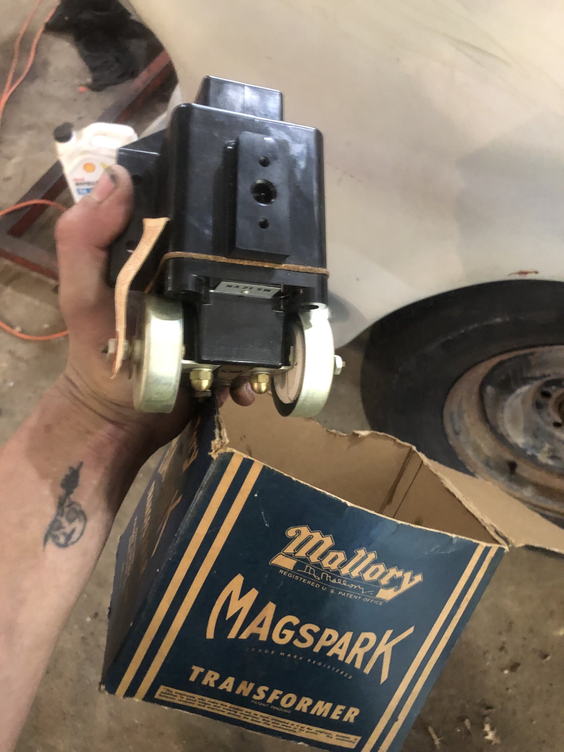

    Aquired some cool parts that I would like to use in my build from my ol lady’s dad

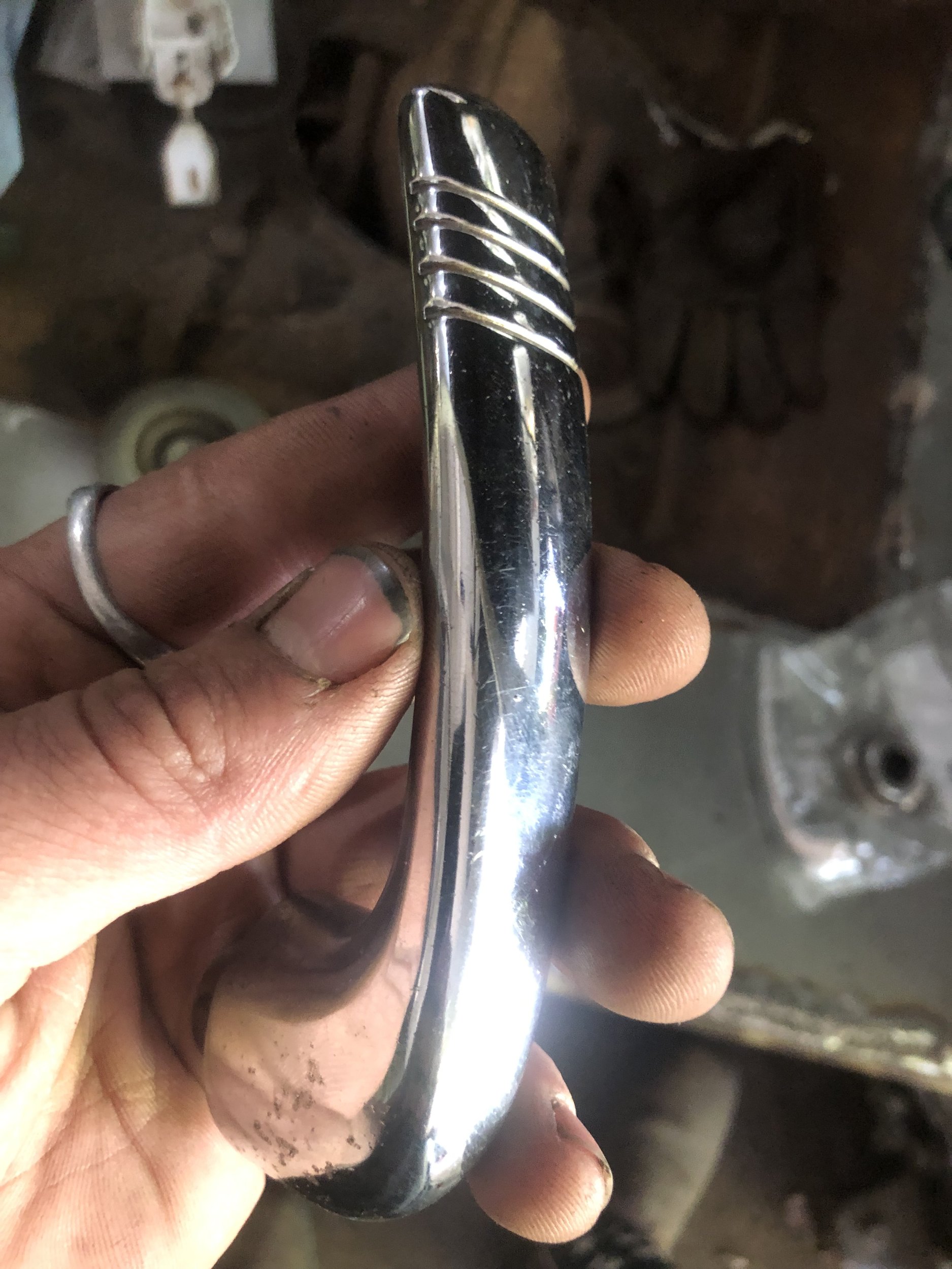

  29. Manostihl83
    Posts: 106
    Manostihl83

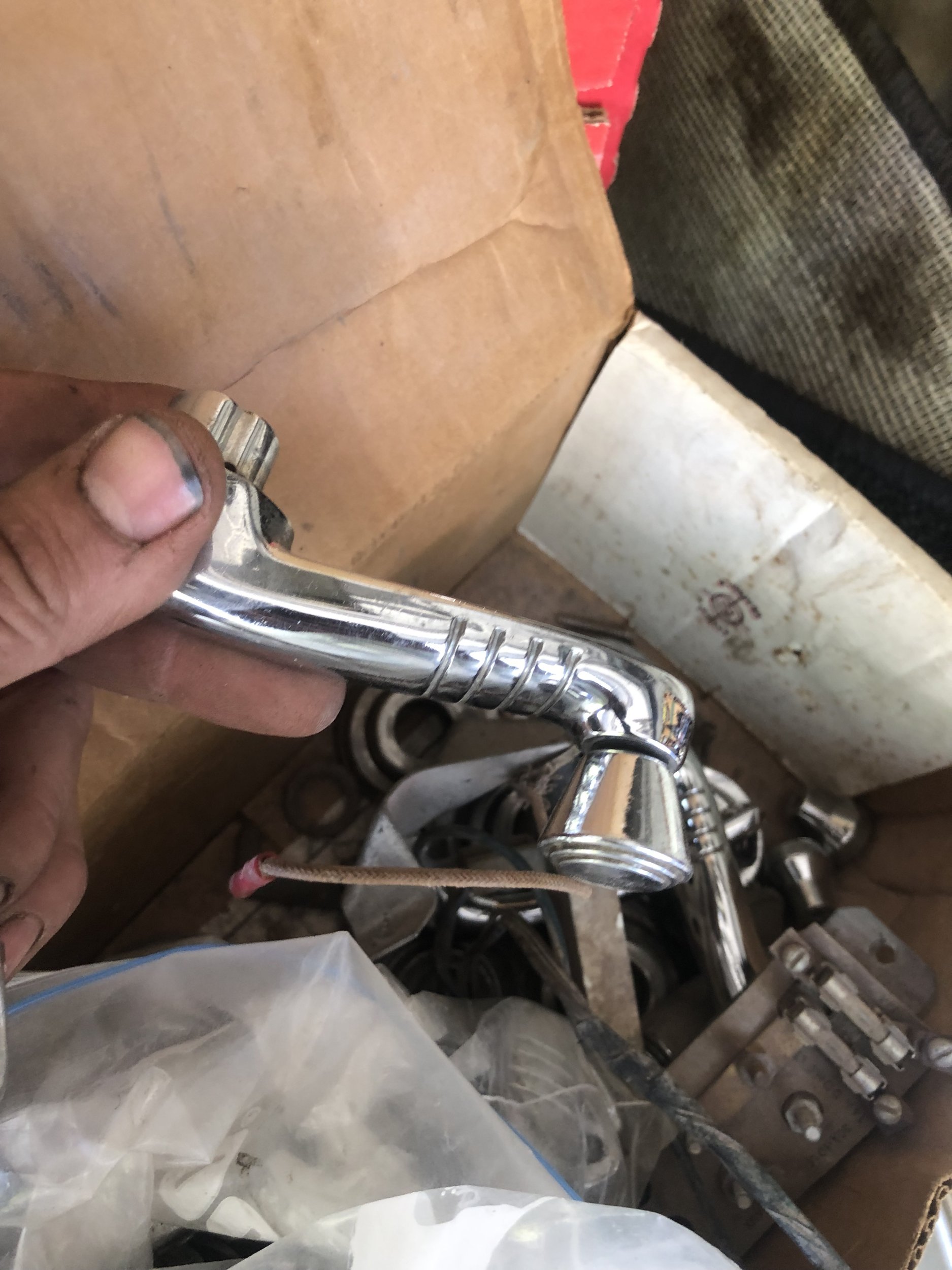

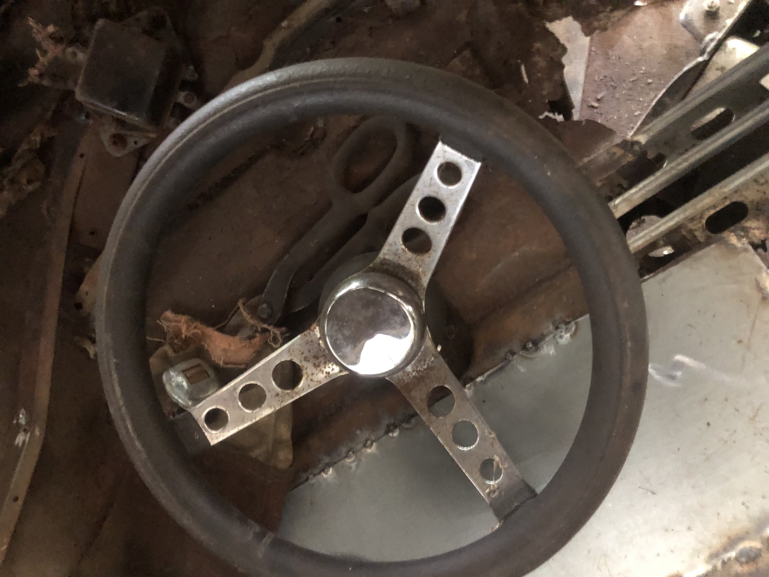

    Also got some handles from a 49 merc with the bezels (I guess you could call them)from him and a steering wheel that I’m going to use. Have quite a few extras if anyone is interested

    For cleaning the intake, I'd go with a bath rather than blasting. Do some searching for 'evaporust', 'mol***es' and 'citrus bath'. They all seem to work at getting rust cleaned out.
