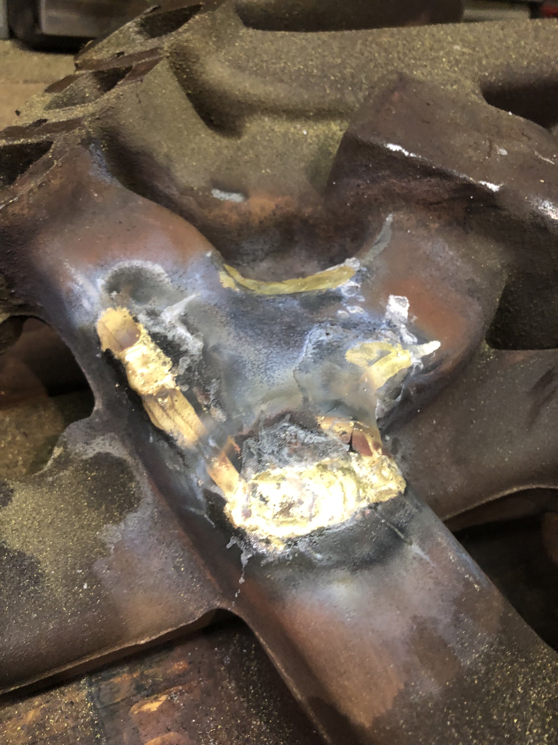

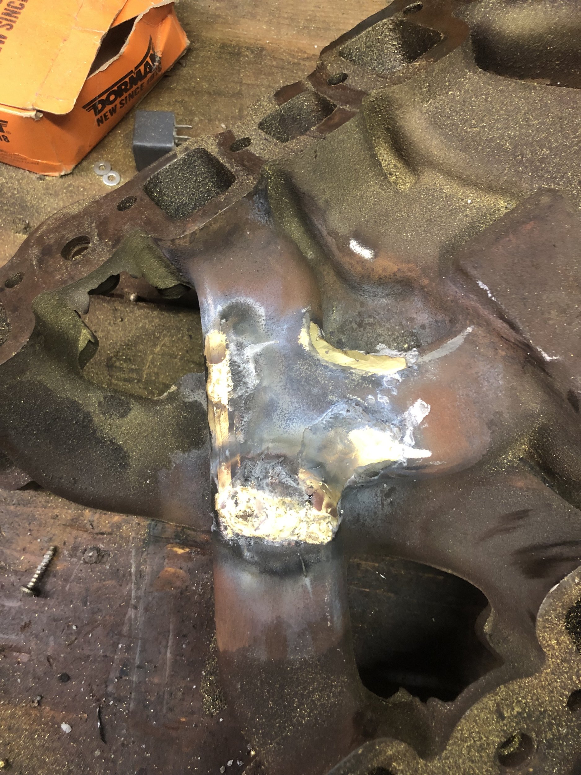

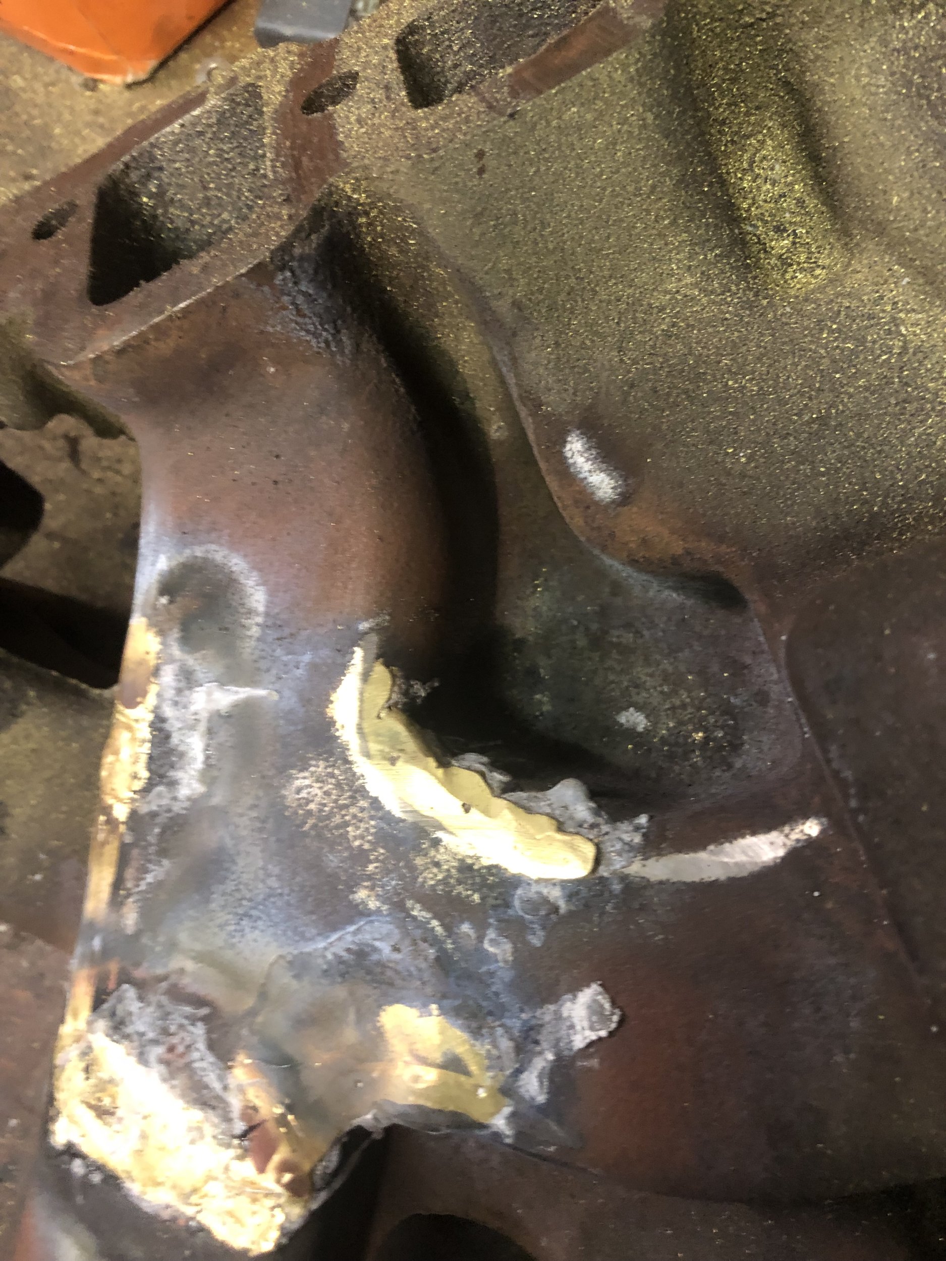

    I’ve never heard of the mol***es/ citrus bath, might try that next. I tried the evapo rust and it seems to have worked ok. I found three cracks in the bottom of the intake and tried for the first time brazing them. Don’t laugh at me, I already laughed at myself enough

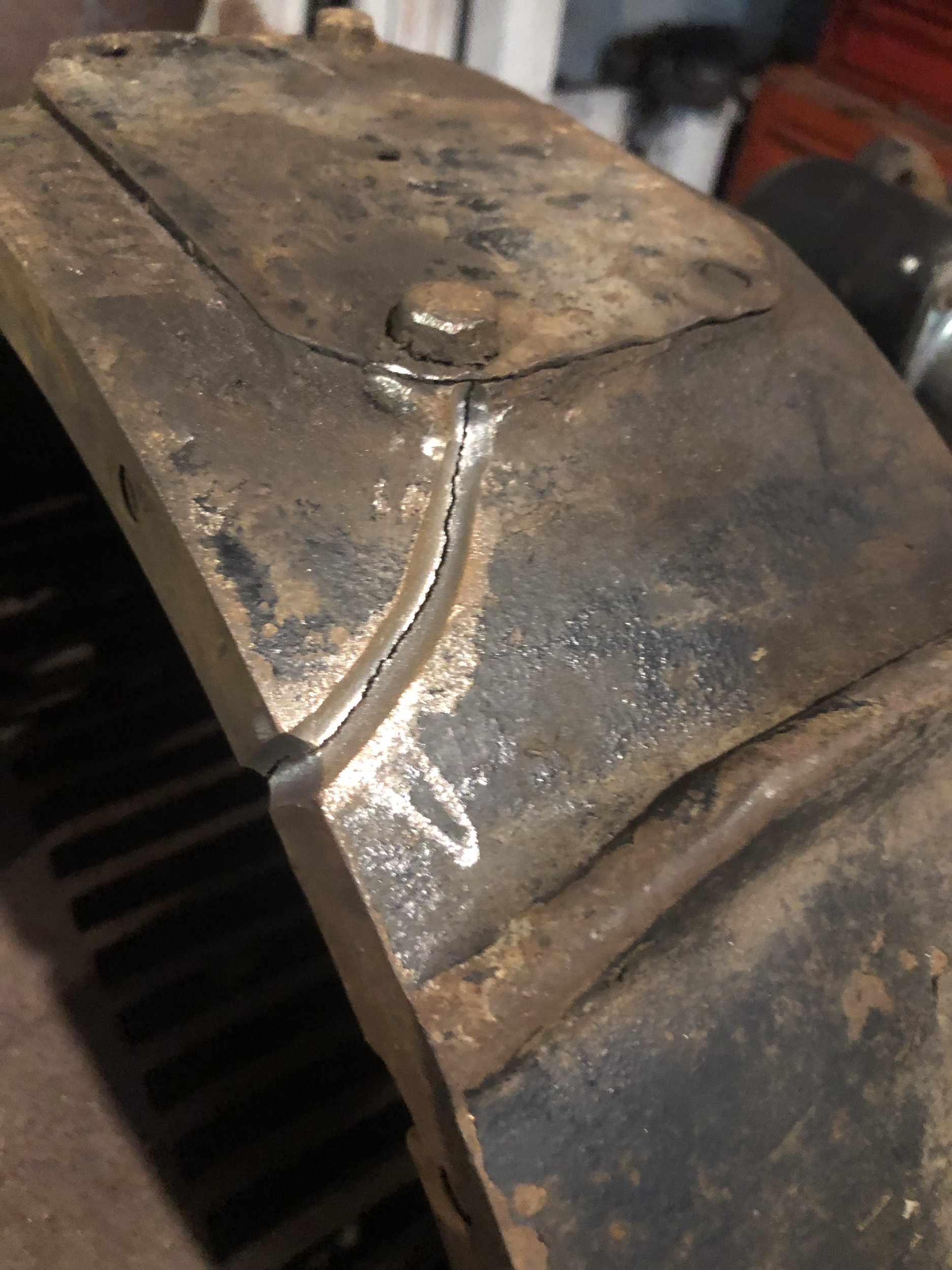

    Manostihl83
    Got my lower bellhousing to weld still. I ground it into a valley already but I’m going to try some nickel rod on this one when I get my hands on some

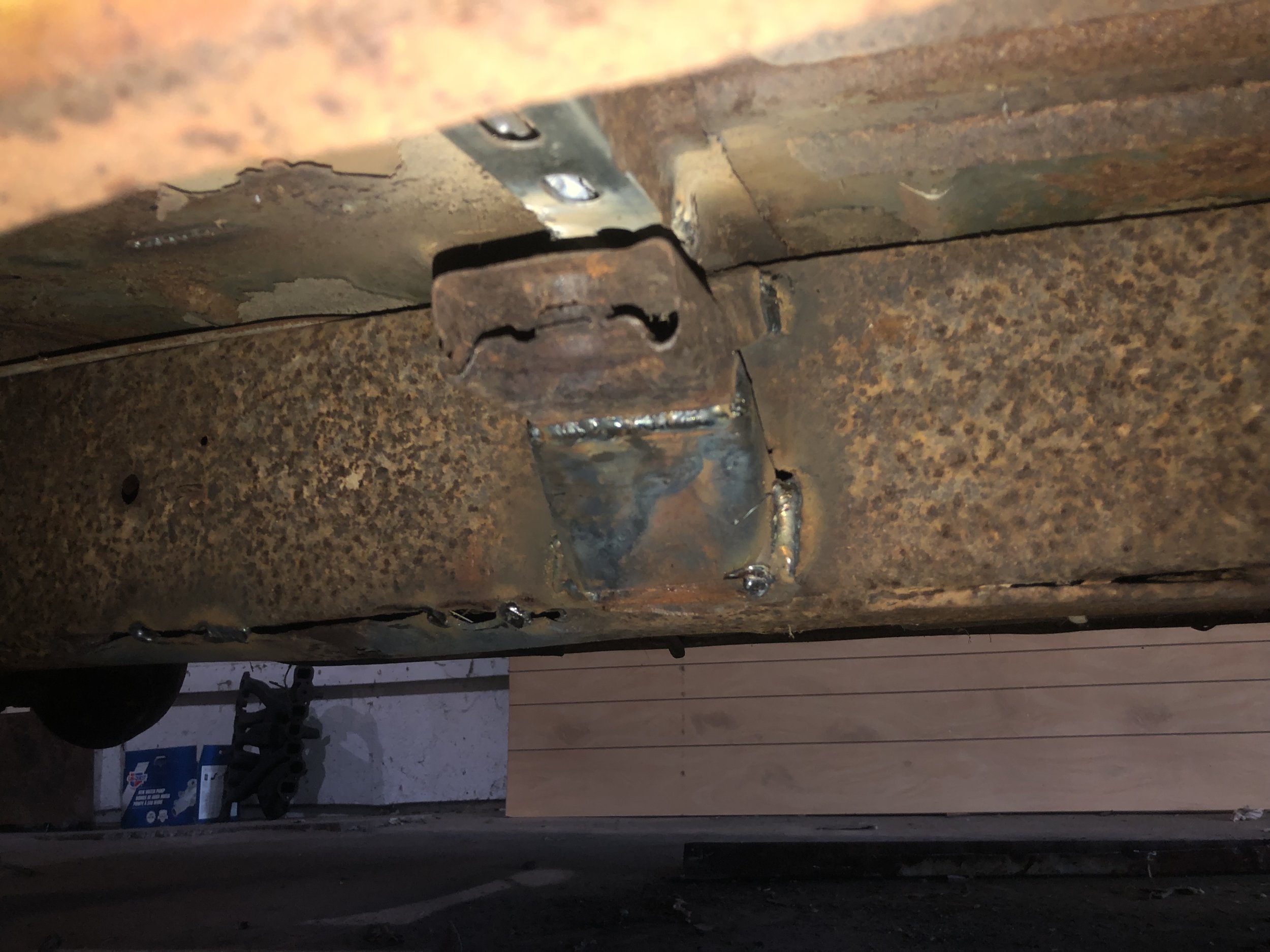

    Manostihl83

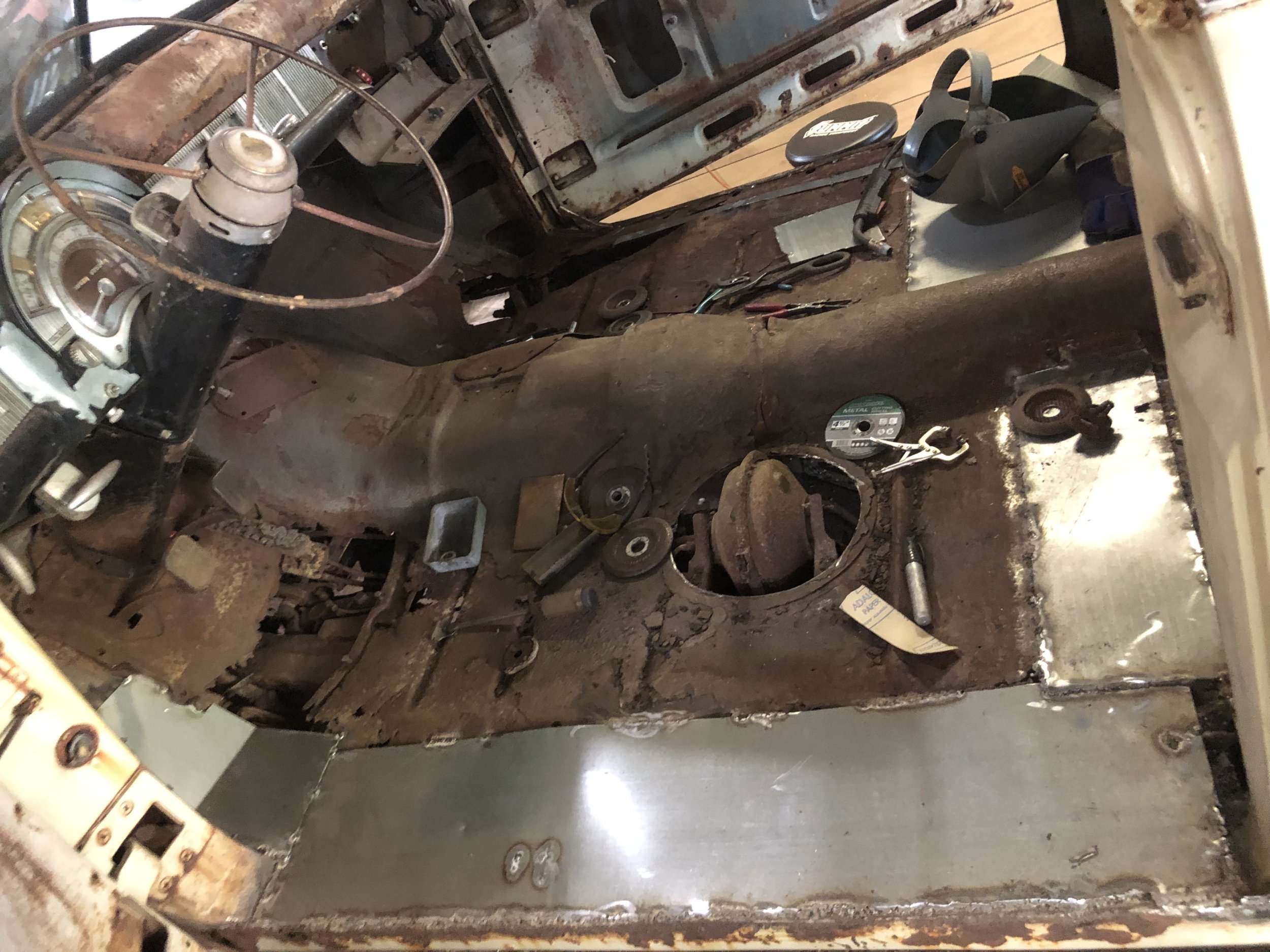

    I’ve acquired 220v Hobart handler 175 from my lady’s dad recently and started fixing up my frame and body mounts

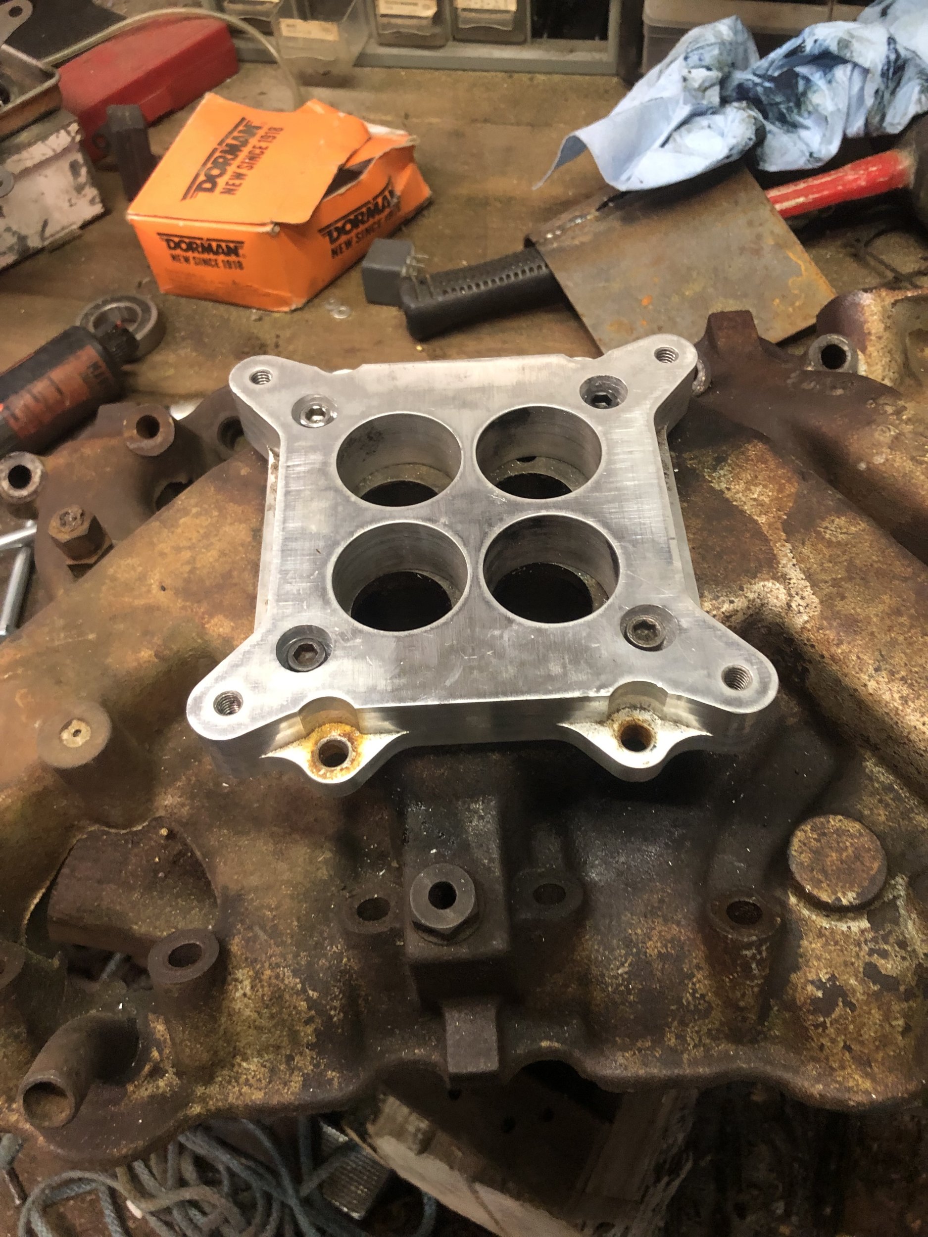

    Manostihl83

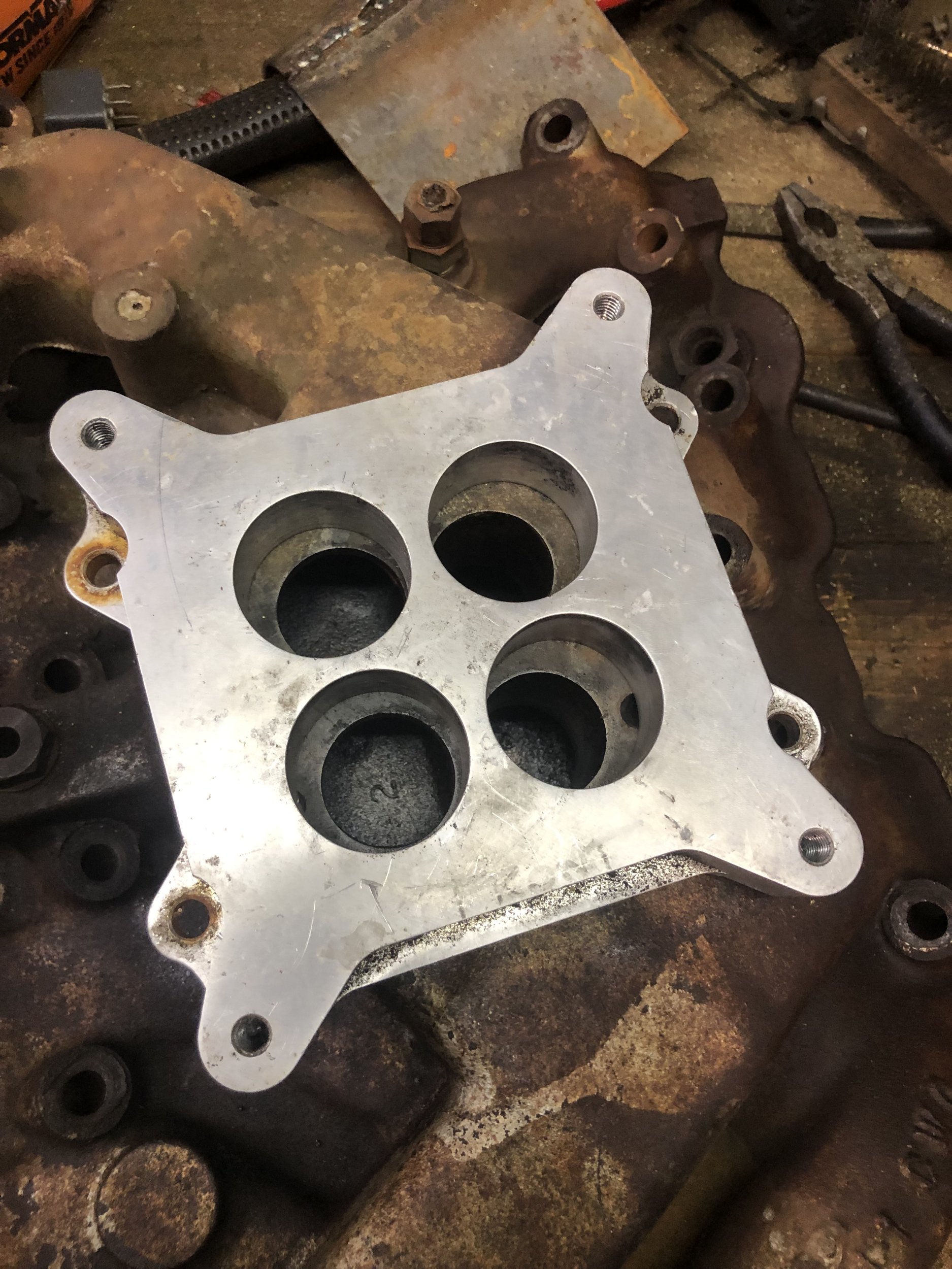

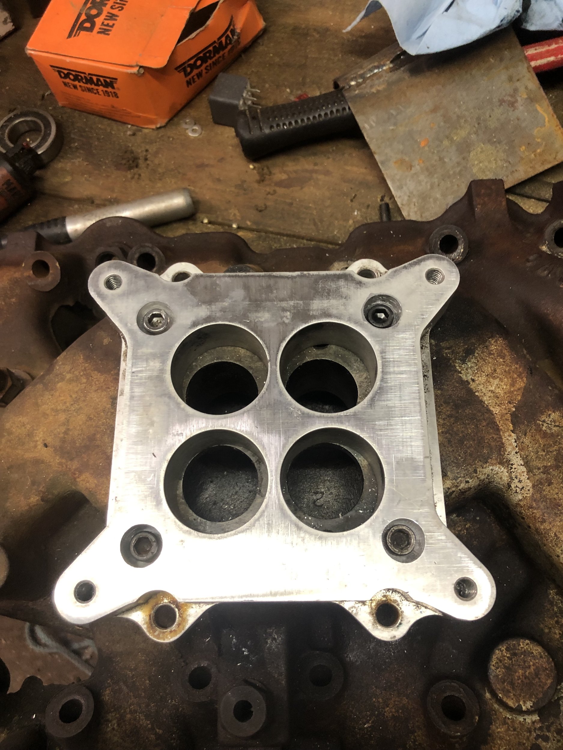

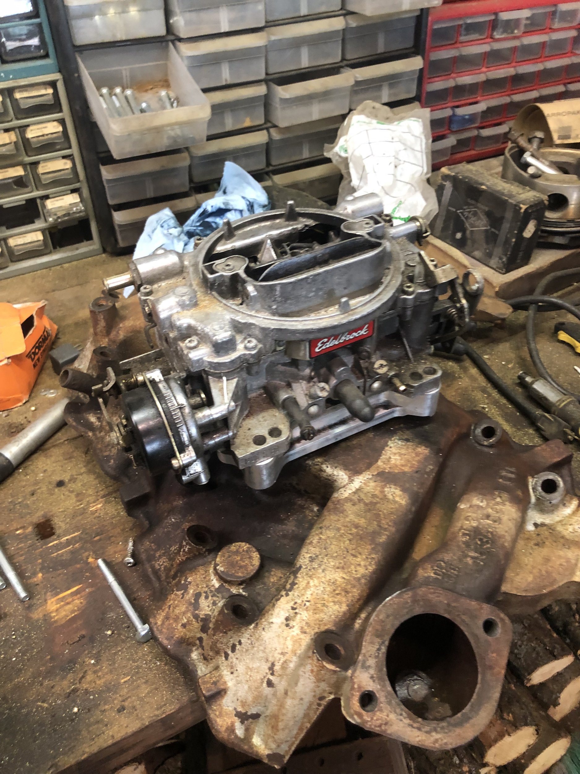

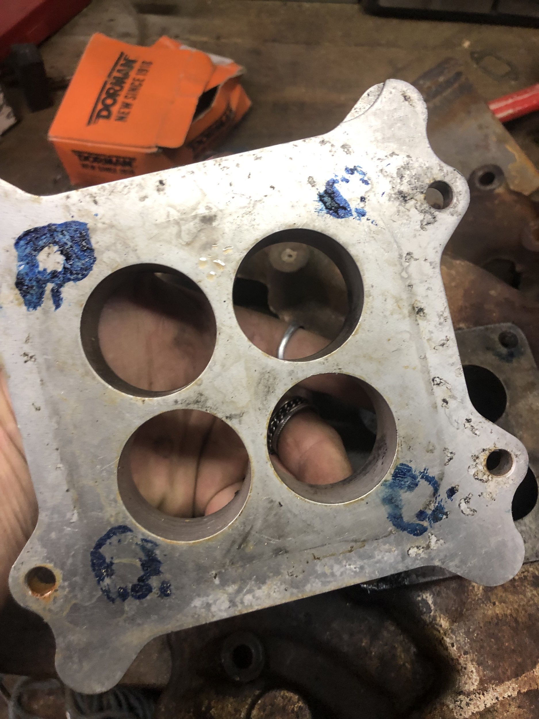

    I have a carb spacer I think on going to drill through for the small base wcfb holes and countersink then so I can mount the edelbrock on my intake

    When prepping for paint, they tell you to clean x3.
    For that brazing, it is similar. Dirty stuff around the heated areas flows into the molten metal, contaminating it.
    Get it cleand and as rust free as you can, making sure there aren't more issues. Then preheat if you can (stick the intake in an oven, pull out with welding gloves). It's not necessary, but will cook off lots of junk and help with the process.

    I had a valley ground into and cleaned it the best I could. I wish I had an oven in my garage but unfortunately I don’t

    George
    HH has a squeeze plate that necks down to the OEM holes. Install taller carb studs. I found on mine that I also had to install a phenolic spacer on top of the squeeze plate due to ****py gas we have today. If this was the common dry intake you could drill out the bore holes, but being the rare wet intake the squeeze plate is the way to go.

    I would like to buy one, but my funds are limited as of now so I’m trying to make use of what I have

    Manostihl83

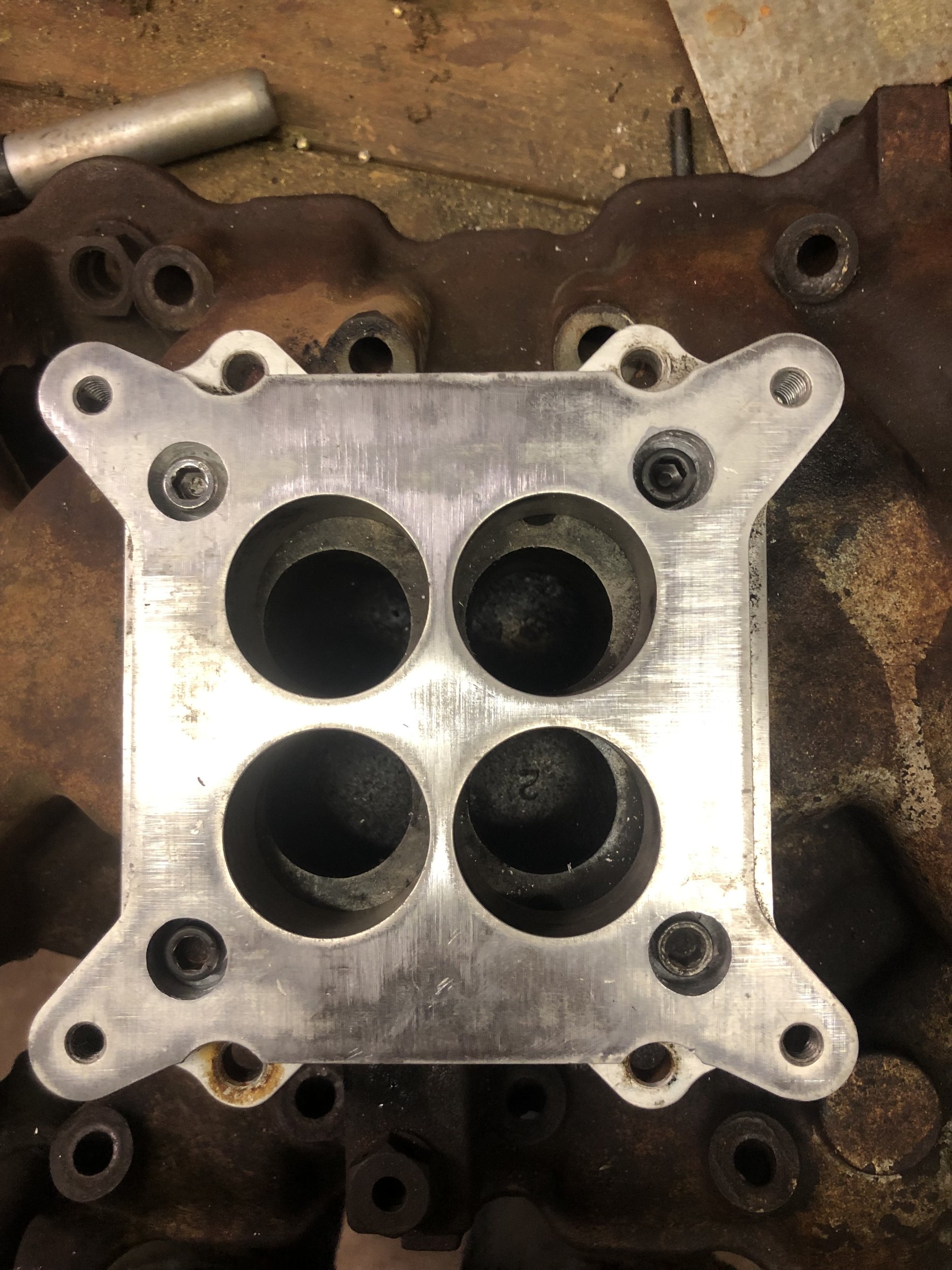

    Made my own squeeze plate today thinking I’m gonna do a little bit of grinding on the intake to try an smooth the sharp edges

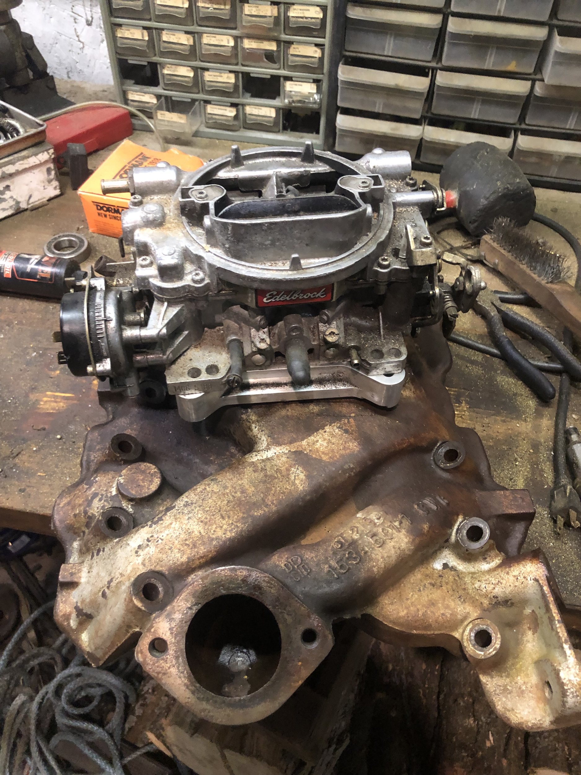

    I’m going to weld the exhaust crossover shut with my MiG welder as well.
  14. Manostihl83
    Joined: Nov 17, 2024
    Posts: 106

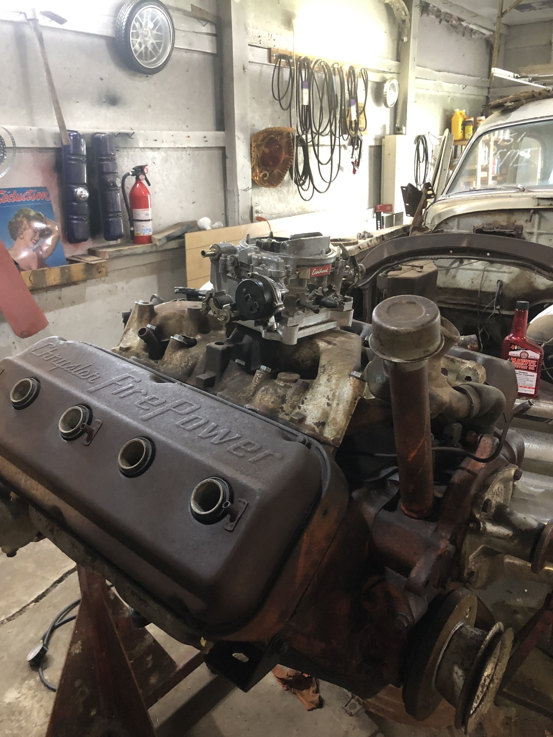

    Manostihl83

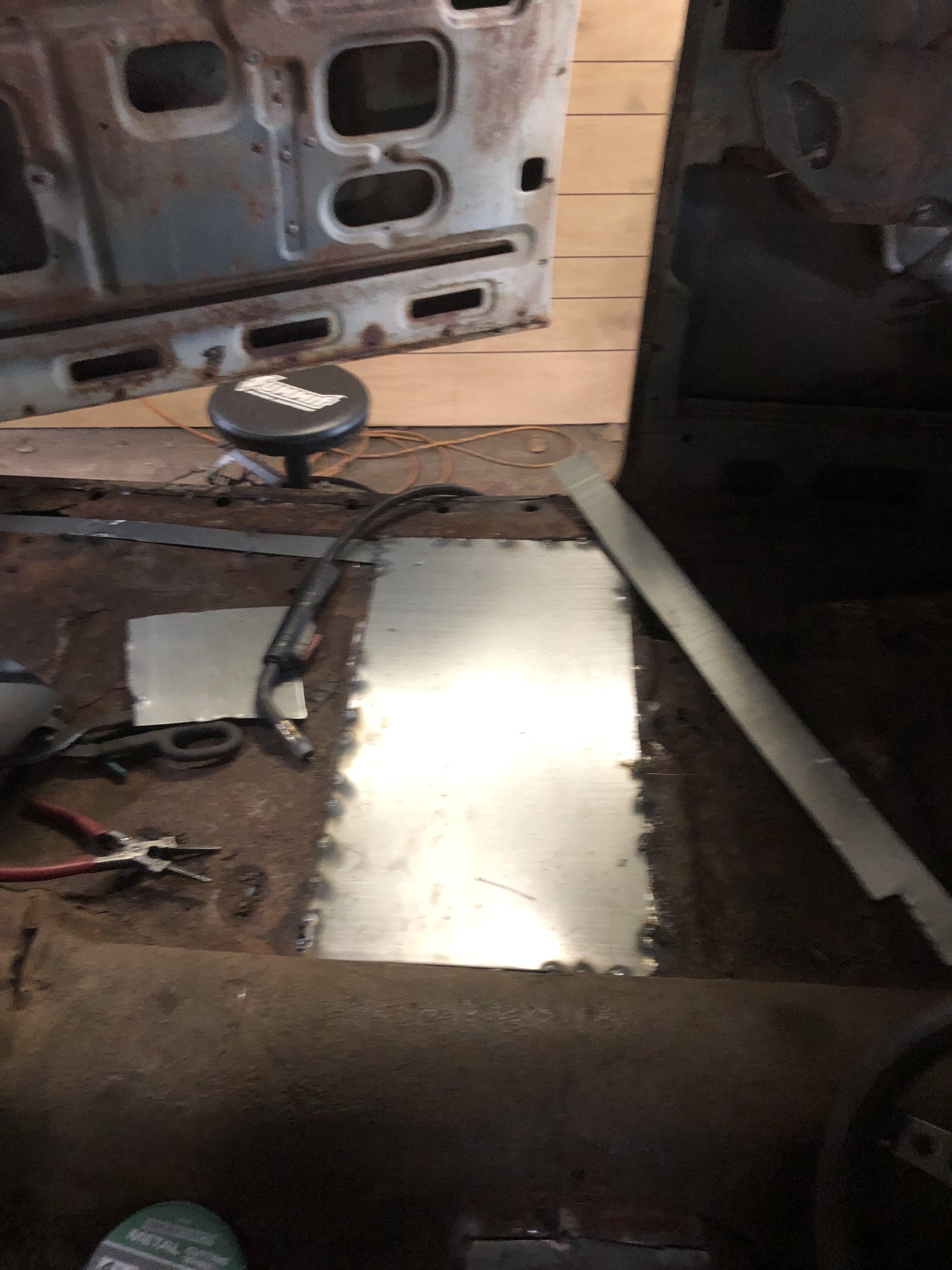

    Got the exhaust crossover welded shut, my intake and carb on today! As well as some more floor pan patches tacked in.

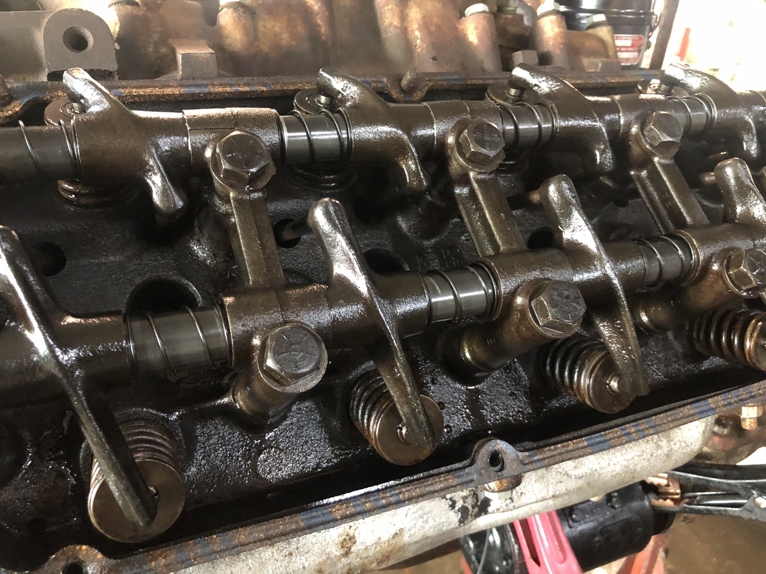

    Manostihl83

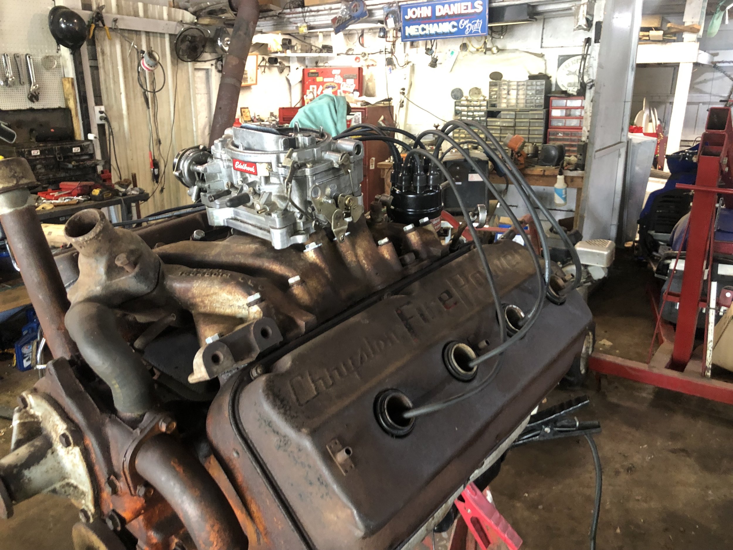

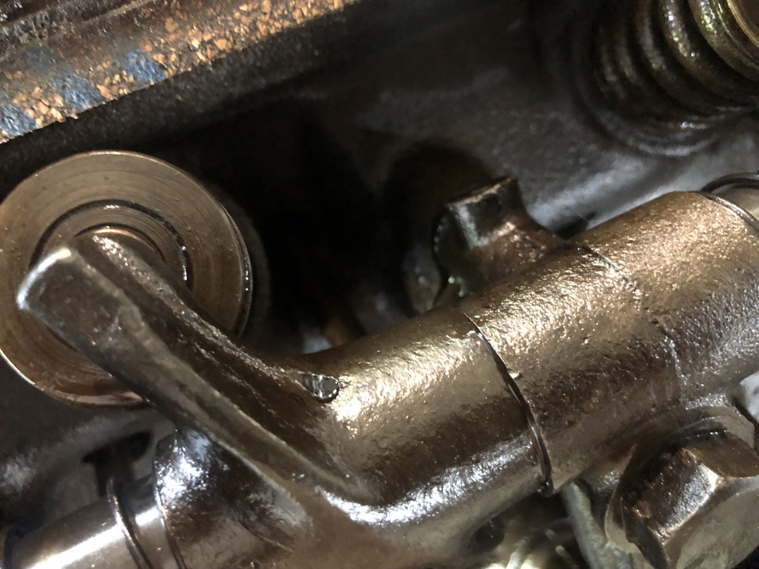

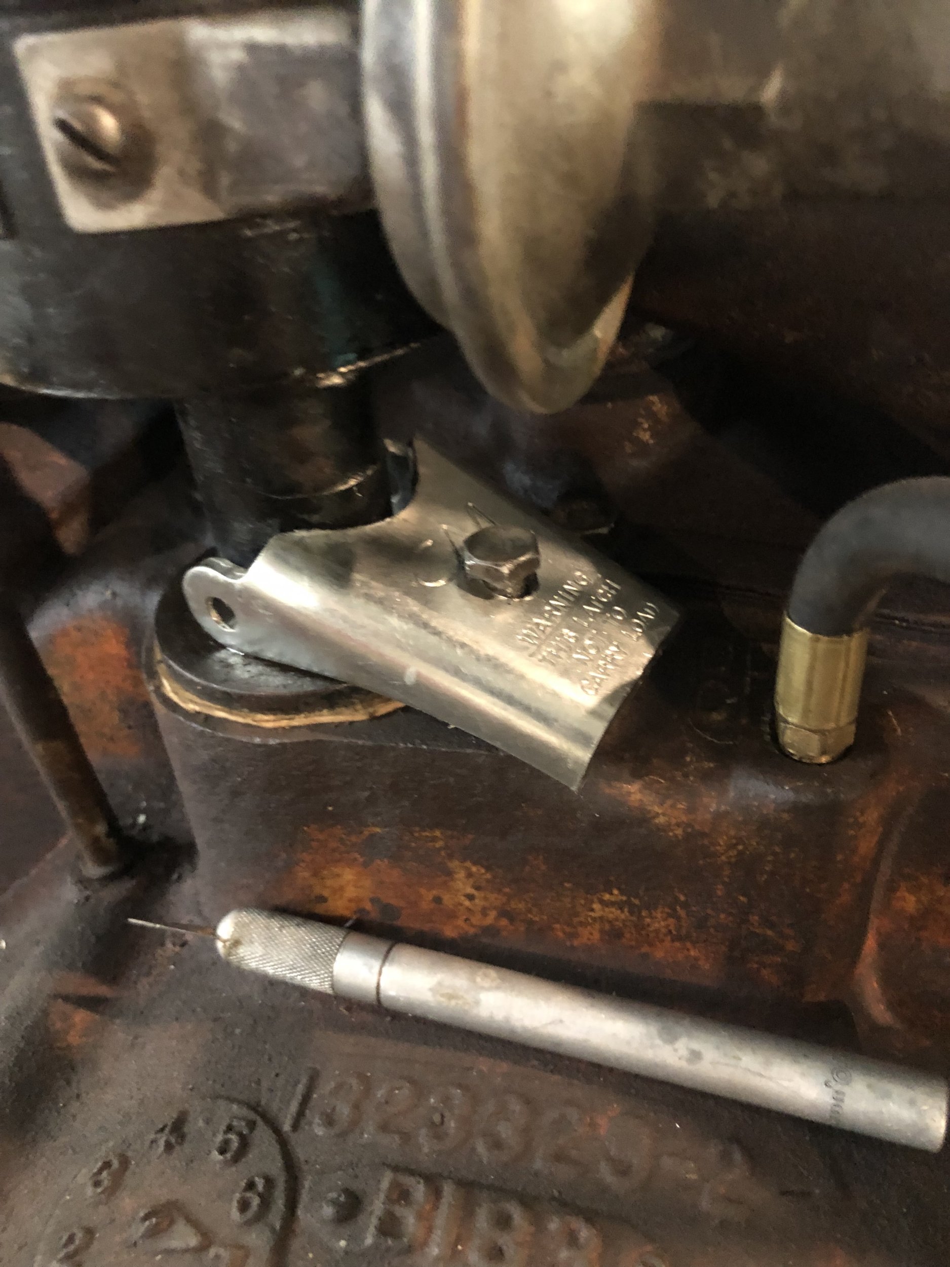

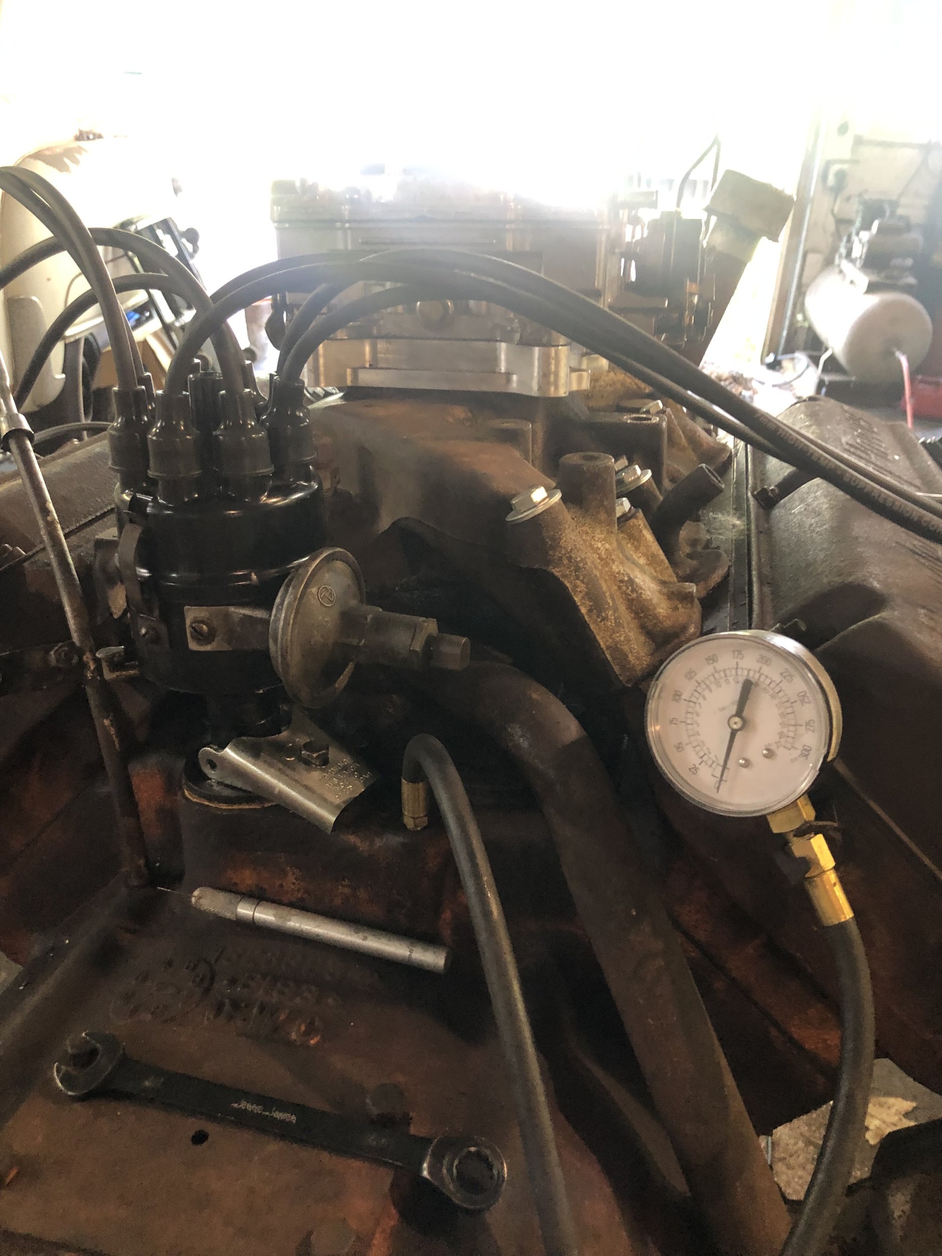

    Got my spark plug wires made today, distributor set in with a gasket I made along with a hold down I made outve some kind of latch , lower bell and starter bolted on, oil pressure gauge in place. Tried to remove the intermediate shaft with no success to prime the oil system with a drill so I just cranked it with no plugs in it many times. Had damn near 40lbs cranking it over and oil started dripping off the rocker shafts so I hope that’s good enough very close to a fire up! Just need to get fuel to the carb with a mr gasket fuel pump I have and just didn’t have enough line laying around and power to the points with a hood battery instead of the ****py one I have

    A stout piece of wire bent into an L will pop the int. shaft right up, usually.

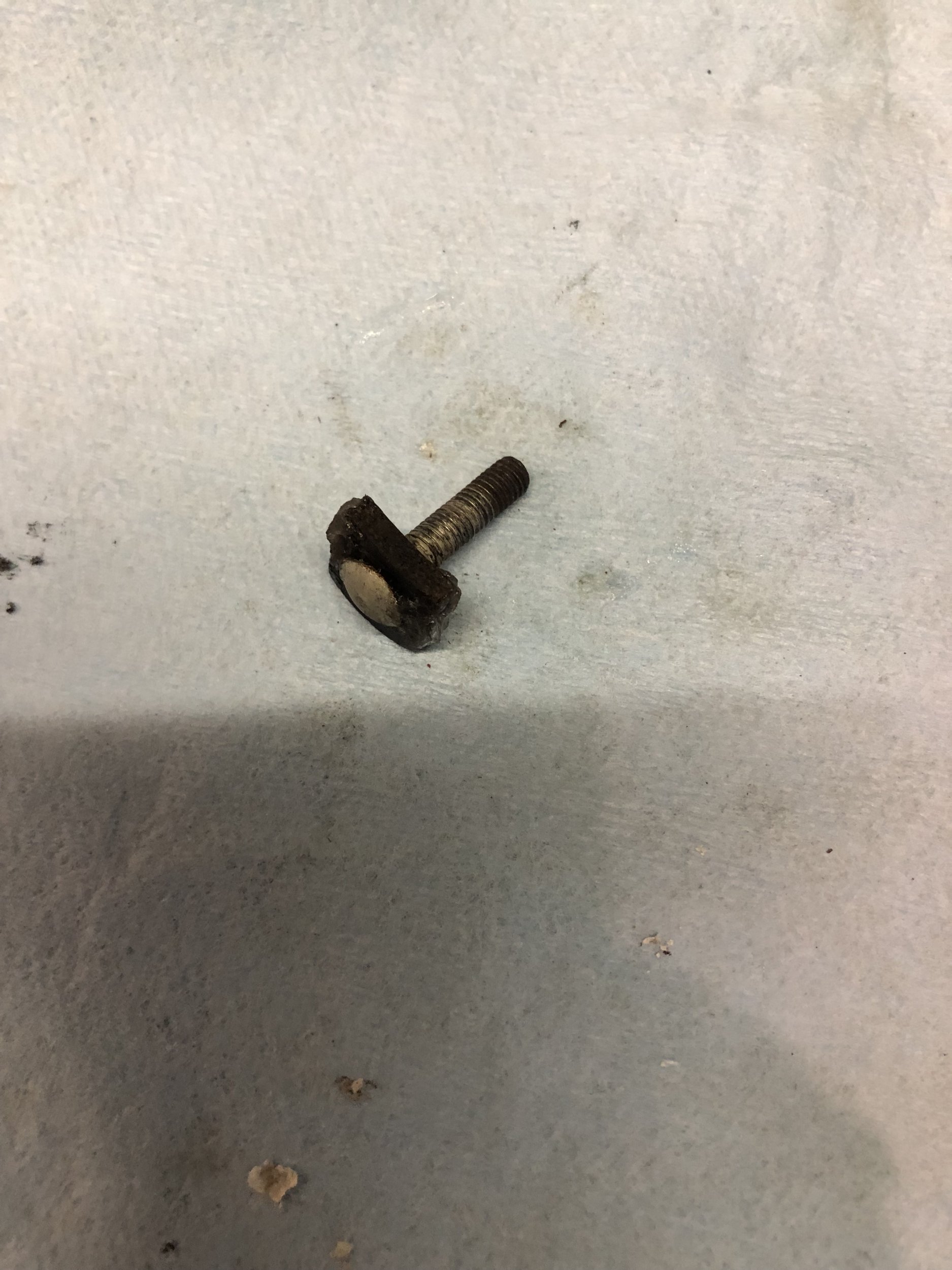

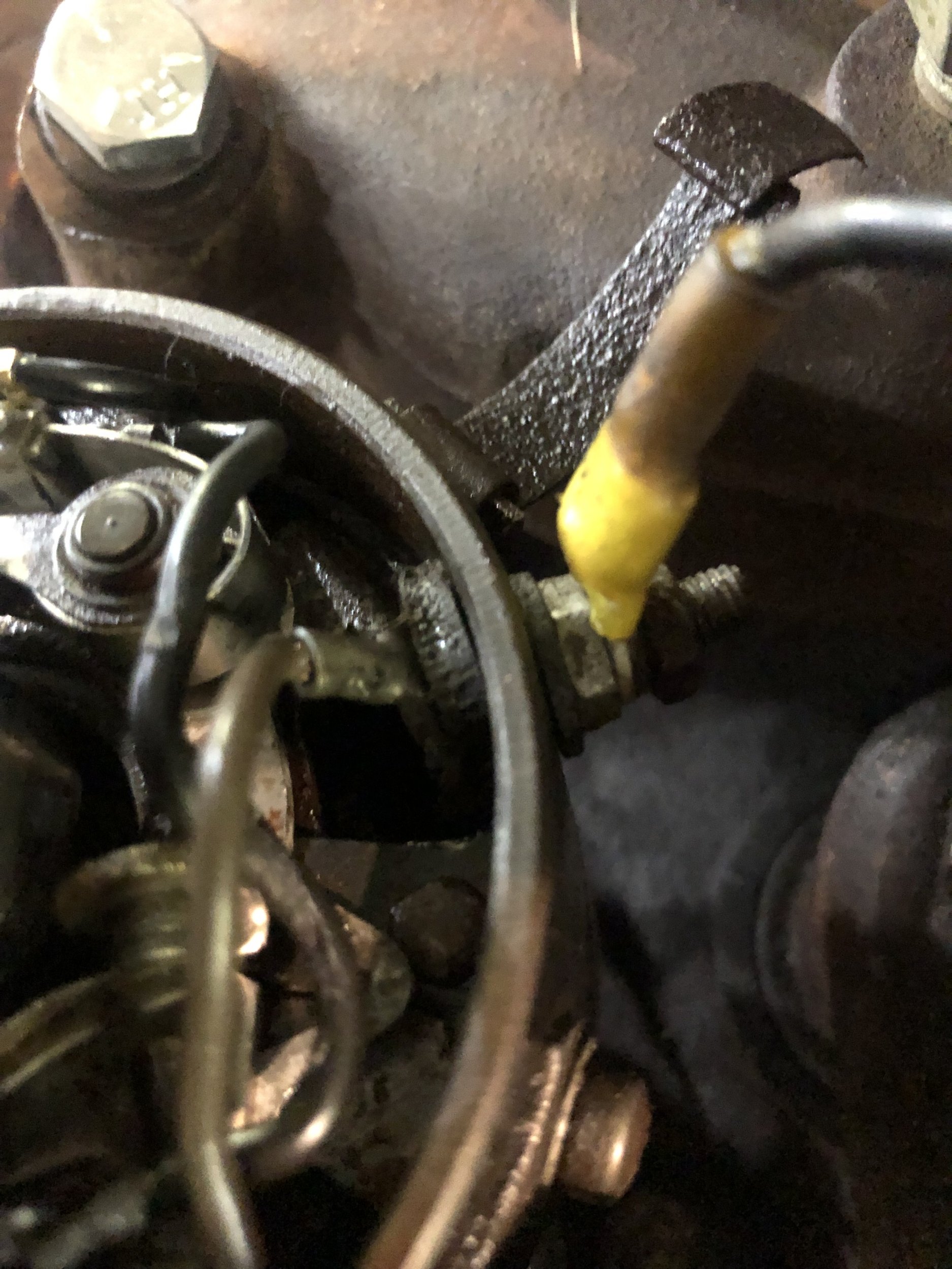

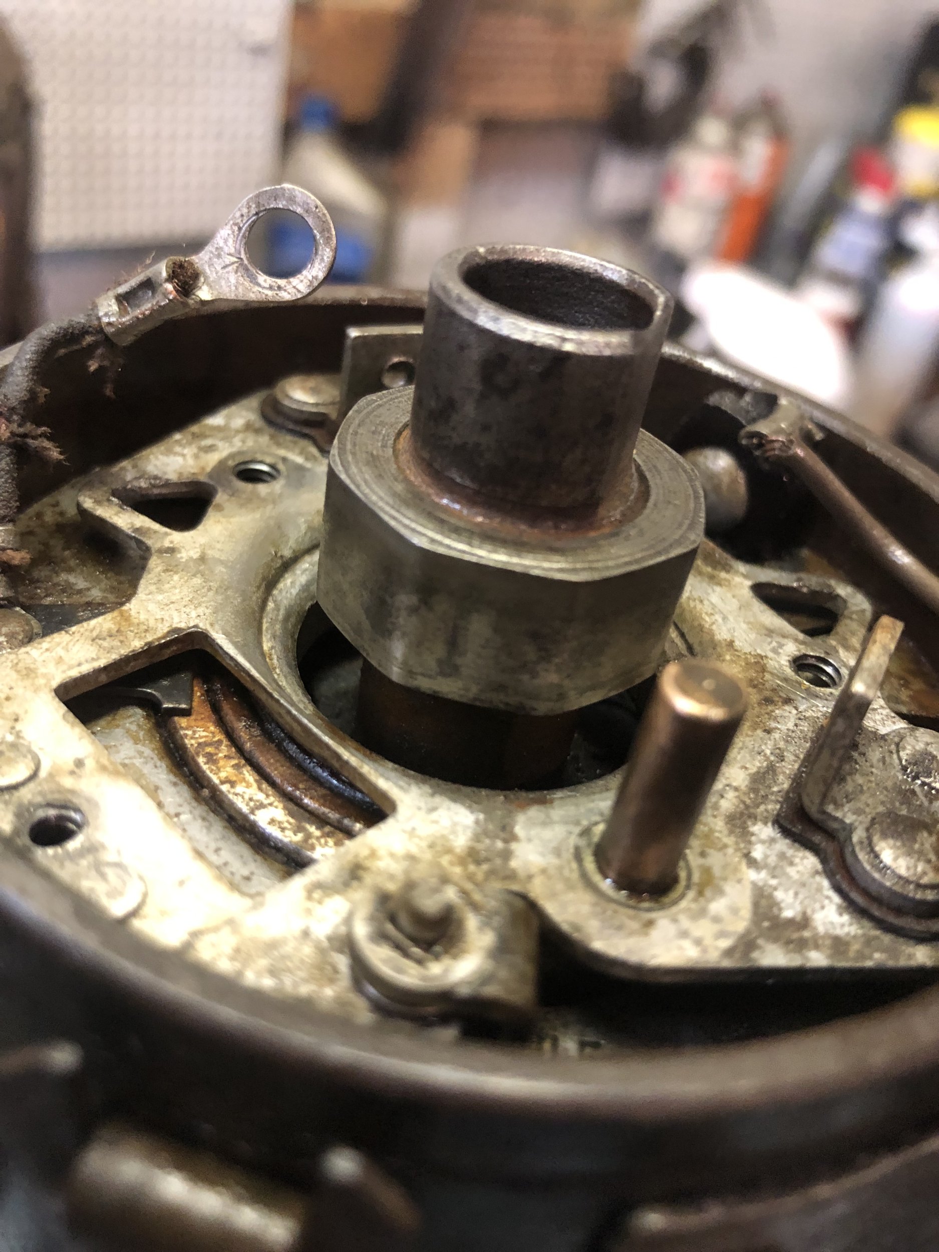

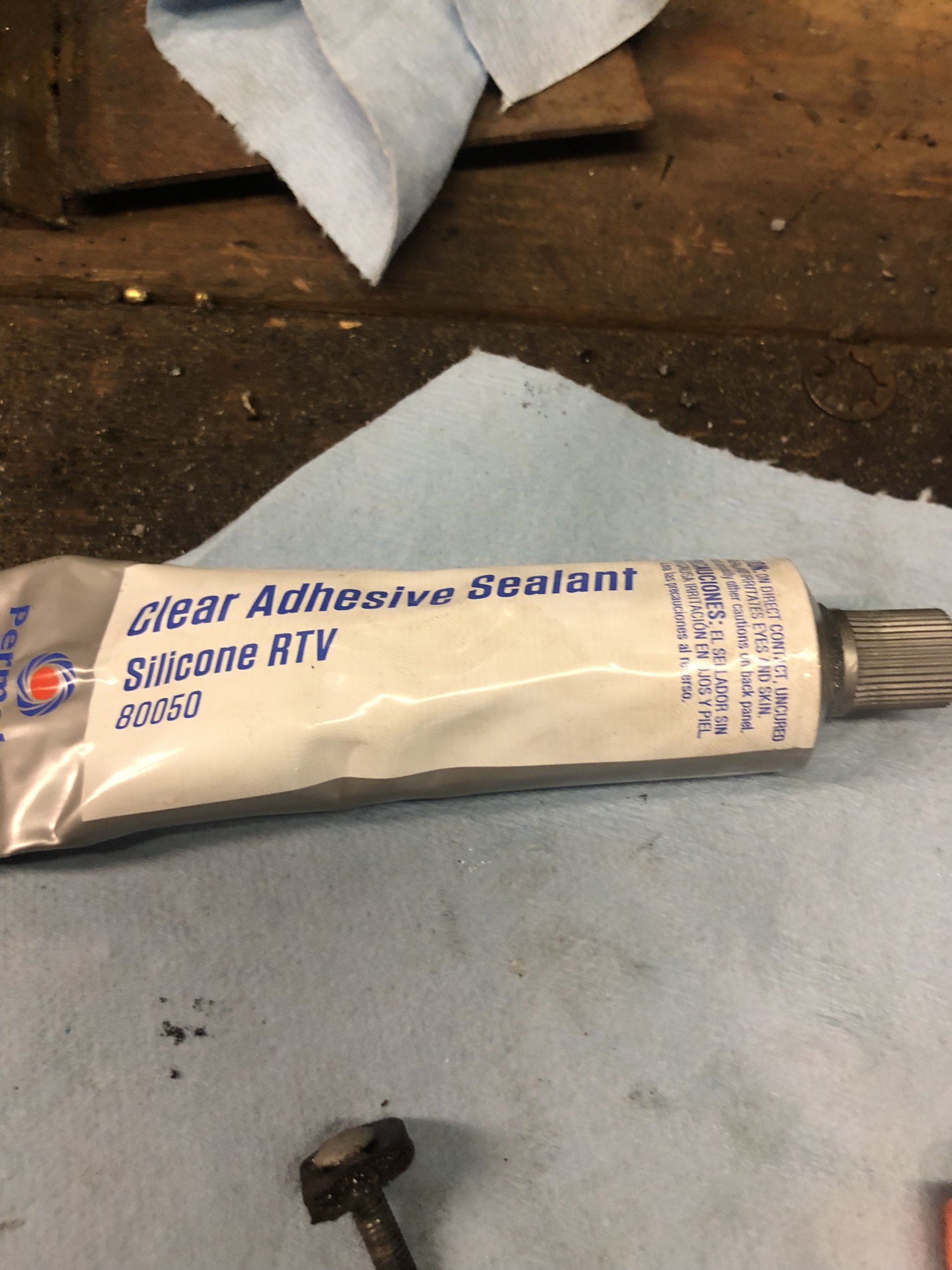

    Well I got the fuel system plumbed and primed today and the wires and coil setup for a fire up today and no go . No spark from the points for some reason. I accidentally broke the fiber insulator that the stud on the dizzy goes through. I glued it back together with some silicone adhesive and thought I was good but apparently not because I’m getting continuity from the stud to the dizzy body. Not sure what to do

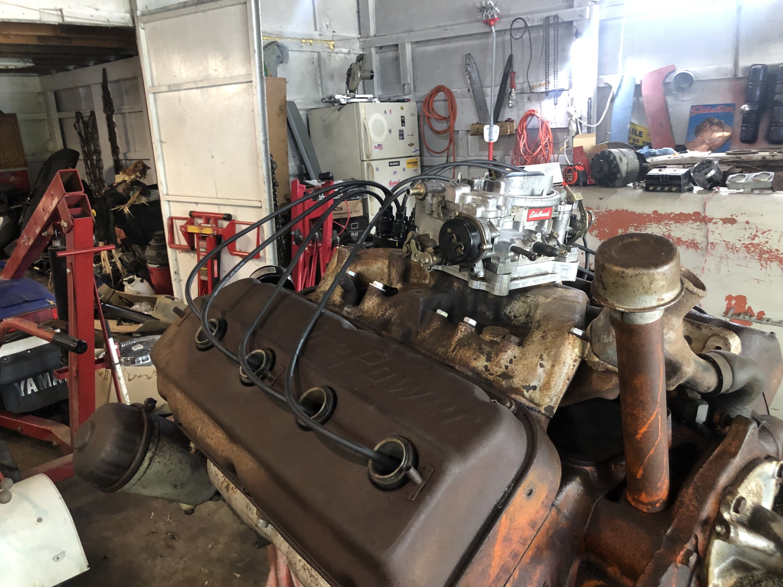

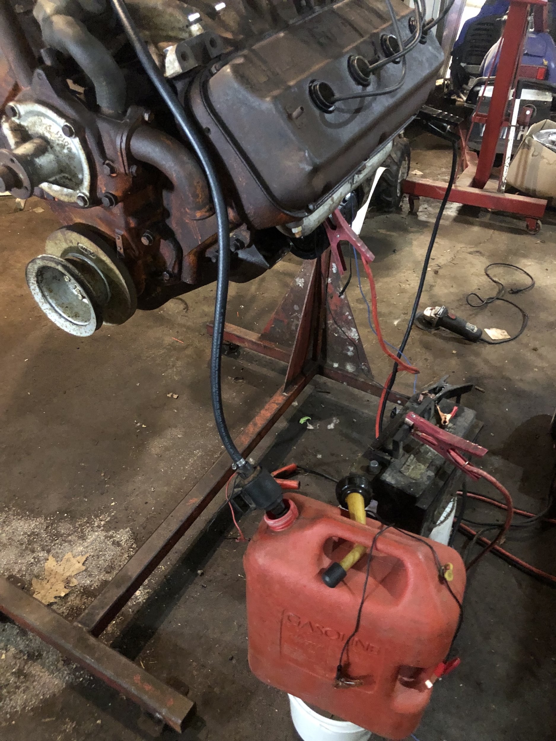

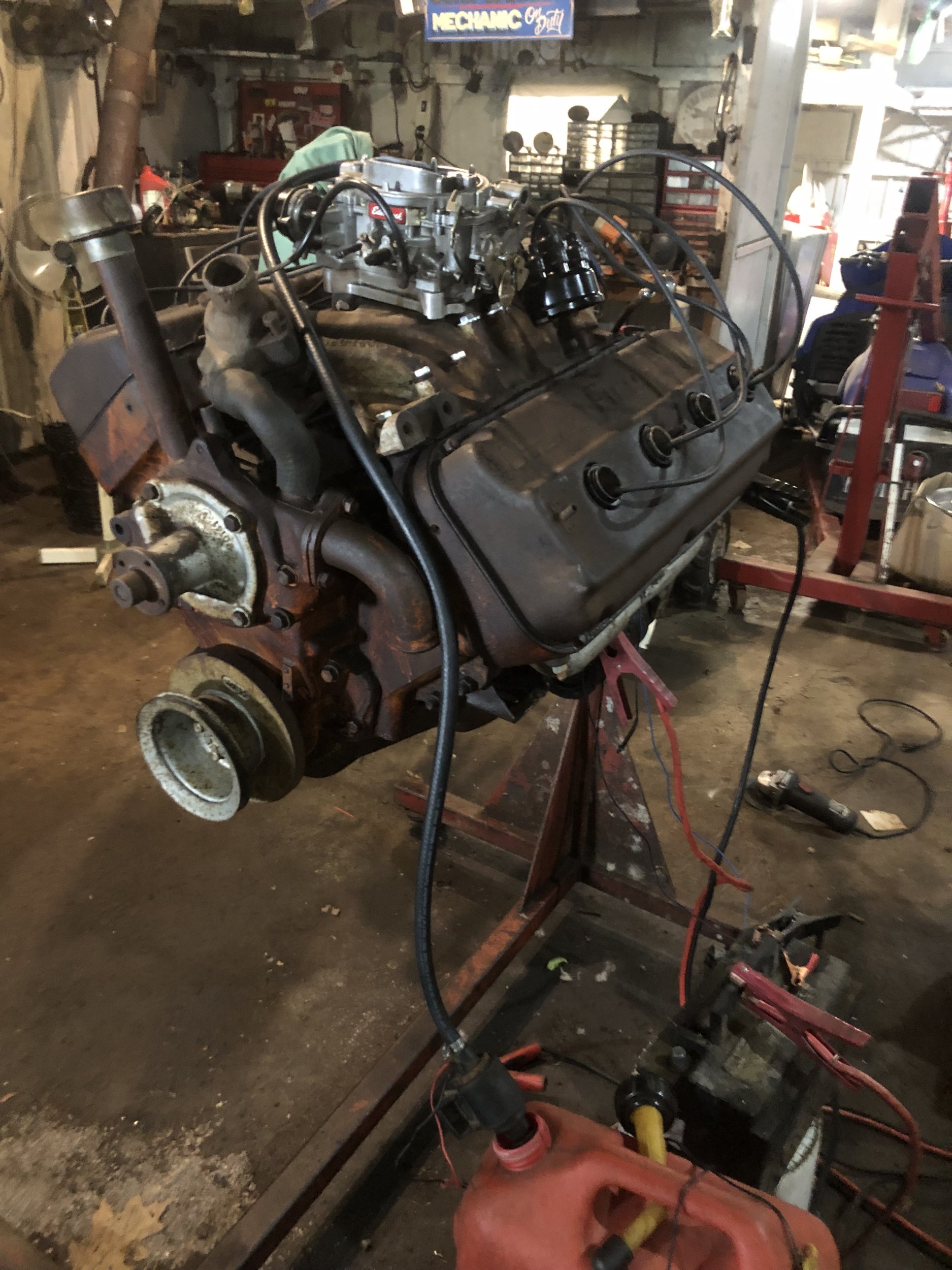

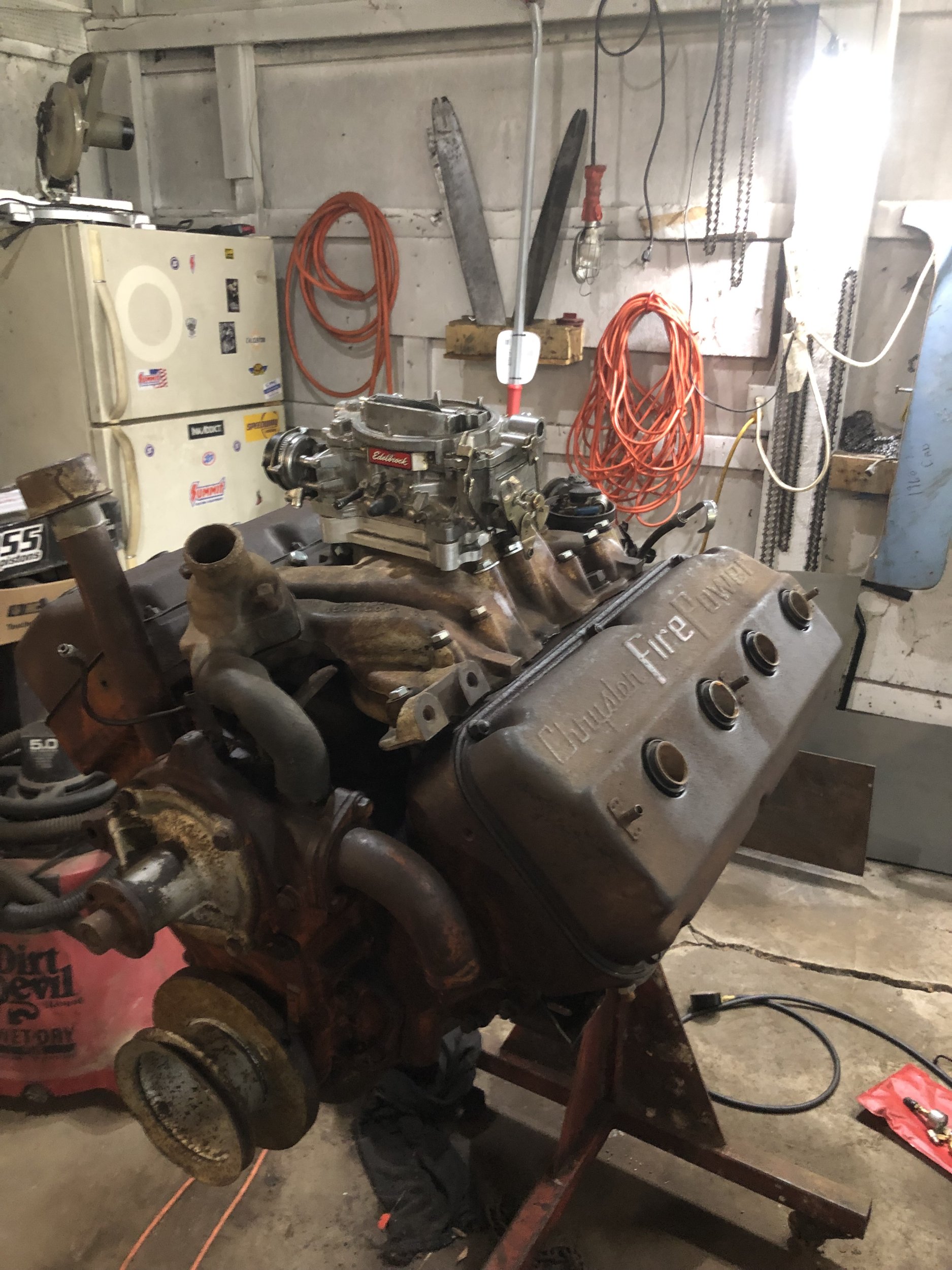

    She finally lives!
    4274SPEED, George and 1930 turbo like this.
  21. Congrats! BUT, you have a VERY HEAVY engine on what appears to be a very light-gauge engine stand. Be very careful with what you're doing . . . it sure looks like it could easily break your stand and then your feet! Just trying to look out for you! ;)
    ottersea and Manostihl83 like this.
  22. On your carb spacer plate . . . given the small sizes of the original manifold, you should try to blend in the lower holes to the upper spacer. Having that sharp edge really hurts flow. I don't know how much material you have to work with (in the cast iron), but if there is enough, blend the 4 ports all the way to the spacer plate size.
    Manostihl83 likes this.
  23. George
    Joined: Jan 1, 2005
    Posts: 7,974
    George
    Coolant looks low....
    Manostihl83 and Fitty Toomuch like this.
  24. Manostihl83
    Posts: 106
    Manostihl83
    Thank you but trust me friend this stand is better than anything you can get at hobo freight. For example it has a solid steel bar at the pivot point instead of a hollow tube like most engine stands. It’s held a 12 valve ***mins and. 1200lb Detroit diesel. She is stout.

    Manostihl83
    I did that with a carbide burr before I put everything together. I just forgot to take pictures

    tubman
    I have to agree with @Bored&Stroked ; that looks really shaky as a run stand. I don't care how it's made or where it came from, just watching the video gave me the heebie-jeebies. I had an early hemi on a storage stand that's a lot closer to the ground than that, and it went over on me when I hit a stray bolt when I was pushing it across the floor. Also, I wouldn't run it so long without any water. At least get a couple of flex hoses and a piece of proper size tubing and fill it with water if you want to run it over a minute.
    Congratulations on a successful startup. I have a couple of early hemis and would hate to see any damage come to that one
  27. Manostihl83
    Posts: 106
    Manostihl83
    She’s sturdy and fine idk what kind of stand you have but I couldn’t flip mine over if I tried. Thanks though.she will get water as soon as I get money for new freeze plugs
