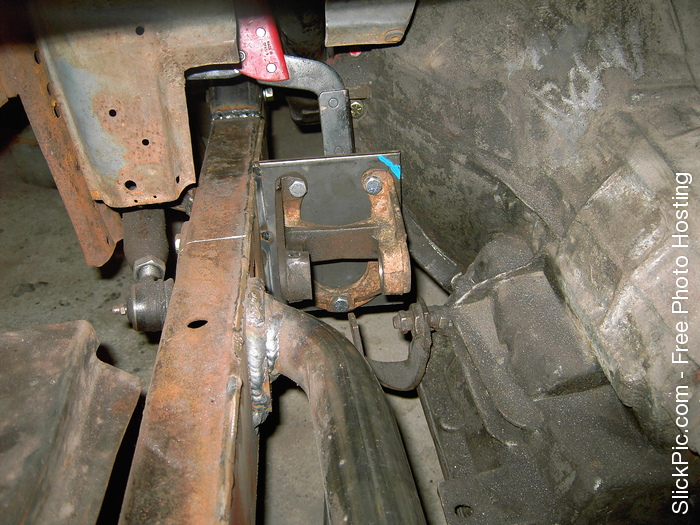

    Nicely none I had the same front end configuration on a 1930 coupe project except my front spring utilized a sleeve thru the spit '40 bones & a threaded shackle housing so I could keep the front spring from binding. I also like the 3 1/2" stretch on the front of the frame I did a stretch on the rear with a high arch A spring behind the axle (Bronco 9") You are doing a great job looking to see the finished project. I sold the '30 coupe Project to finish the '40 coupe

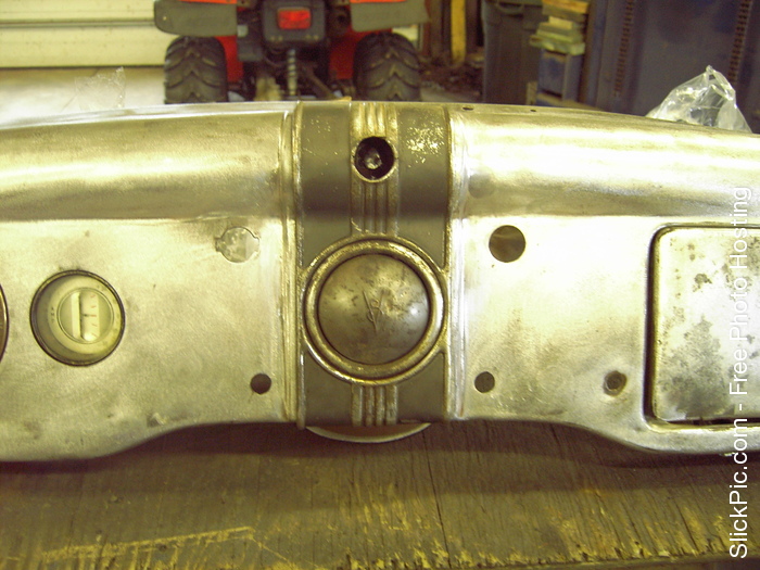

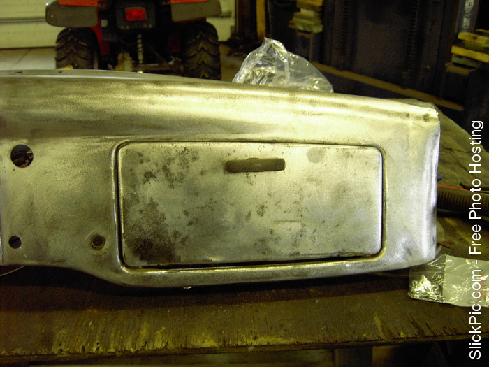

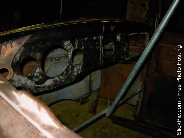

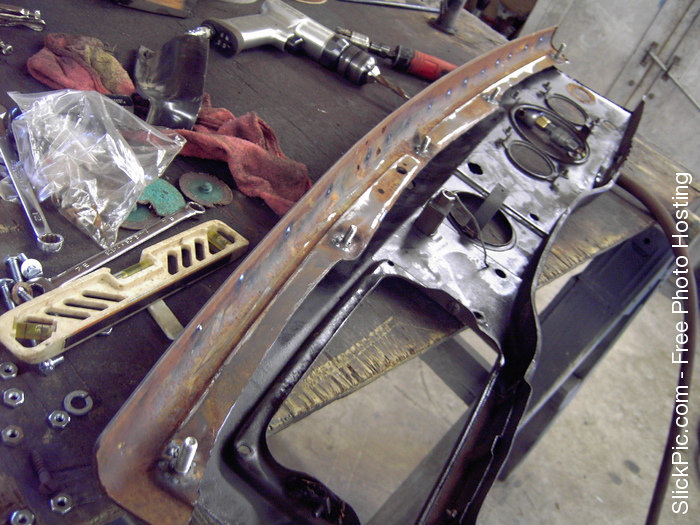

  5. welded some bolts into the model a dash rail so when I weld the dash to it I can remove the dash easily from the car..... still have more work to do on the dash, so far so good........

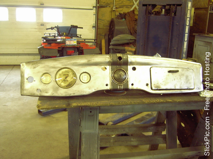

  6. finished up the dash and got her installed. Had trouble with one of my ''35-'36" dash speedo's. One fit the dash studs but the speedo dial was off......so I figure it's not a '35-'36.......the other fit and the dial face was in the correct position....luxury problems......

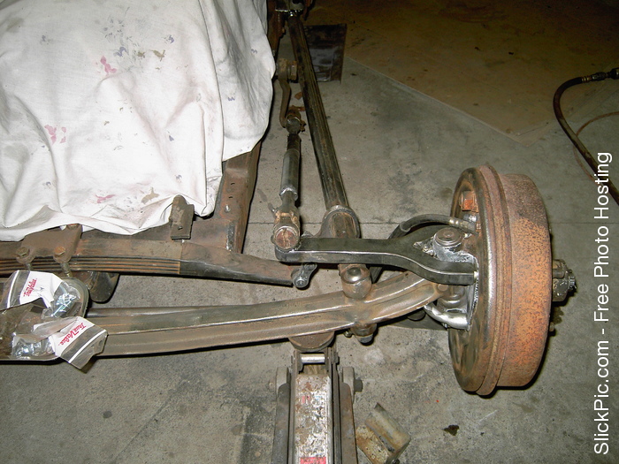

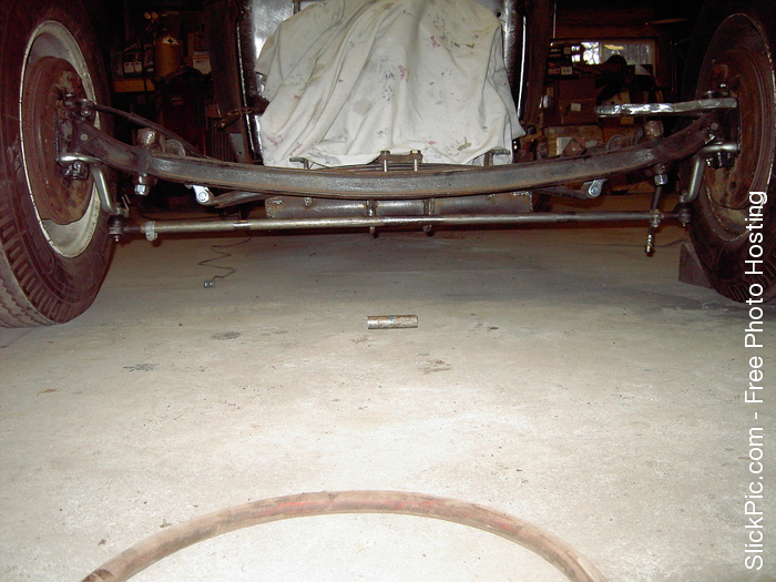

  9. Your doing nice work. I am liking what I see so far with the exception of the front axle. A 28 to 36 axle will give you a little more turning clearance. You will also need a narrower spring. I'd finish up the way you are going. If turning radius is a problem once you are on the road you can change it out.
  10. thanks man...........one of the reasons I like the HAMB so much is the great information and suggestions to improve your build other members give you free of charge. I do have a couple of 28-36 axles and if need be I'll switch them out if I have turning issues.

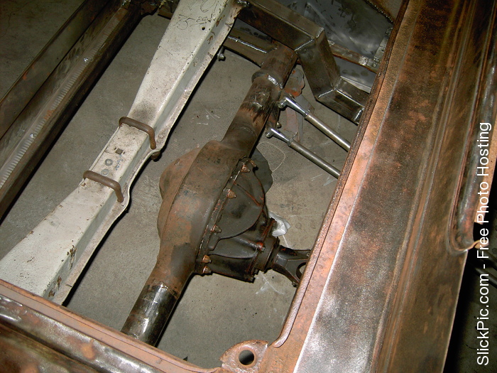

  14. well, I worked on the rear, got the 3 rd member, backing plates,shoes,axles,and drums in place.

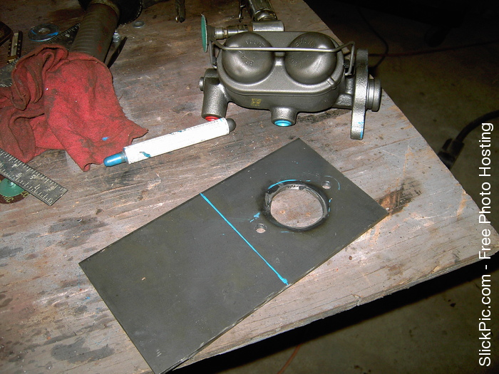

    Also fabricated some brackets for the brake pedal assembly and the master cylinder. Using parts from a 48-51 f-1 brake pedal assembly and a chevy truck 68-72 master cylinder for shoe/ shoe application. The master is going to be located approximately 20ish inches behind the brake pedal assembly,no room behind the pedal. Still figuring that out. Also figuring out the brake pedal arm , going to heat and bend or cut and weld...not sure yet.

  17. cut 3 : 1/2'' out of a f-1 tie rod to make it fit my application.......also mocking up a modified f-1 drag link....
  18. got the steering arm ball fitted and welded in, also the modified drag link is welded up and installed, rear window was trimmed and fitted ,then tack welded. Working on my deck lid to see if I can make it look half way decent so I can save $300-600 bucks and spend that money on other needed build parts. Lastly mocked in my pete & jakes pan hard bar. Their stuff fits so good. Also ordered my driveshaft style headers from gear_drive@yahoo.com. Matt is an alliance vendor, so I got free shipping on them....the benefits of being an alliance member.

  25. I decided to go with my '30-'31 ford grille with the stone guard. It seems like the majority of '30 coupes are running '32 grilles. I've also decided not to run my "little" mustang radiator. I can't see how that could cool my 350 motor in bumper to bumper traffic.
    I figured out where the roof wood header goes and the other pieces of the front of the roof.
    I also built a "cage", bolted to the sub-rails and to the bottom of the rear window. That really tightened the old girl up. She still has a little ass wiggle which I fix next. Don't get me wrong I like a little ass wiggle ,just not on my hot rod.
    My buddy started to wire the old girl up yesterday, rebel 8 circuit kit.
    After adding a spacer to my trans mount to get top of the motor level, I now need to notch out the frame rail to make room for the alternator lower bracket........

    Looks like you are really moving along there! Makes me feel lazy ... Or motivated. I have a question about you steering set up. Not sure from the photos but is there room for you to flip the steering arm on the front spindle to allow you to run a straight link to the steering box? Might give you a shallower angle closer to intersecting with the pivot for the wishbone. Maybe not.

    That draglink has some serious angle. Seems like I read somewhere that it should be parallel to the ground to avoid bumpsteer. Maybe someone can chime in and straighten me out.
  30. I'm retired so I can devote everyday into building hot rods....who's got it better than me. I'll check into the drag link situation and get back to you. Thanks for pointing it out.
    this is why I like the HAMB, fellow HAMBer's see potential problems and state their concerns....thanks man
