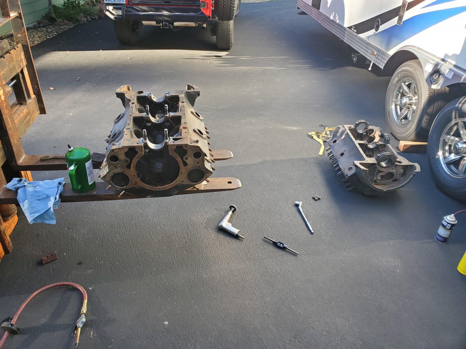

    Before I even got to work on the frame I had to go on the hunt for a good flathead block. I ended up going through 3 before the 4th one was good. I also forgot to mention up above that the cam I have is being custom ground to be close to the Isky 400jr profile. The ignition will be a Petronix 1.5 ohm coil with a Stromberg Efire electronic distributor and Efire plug wires.

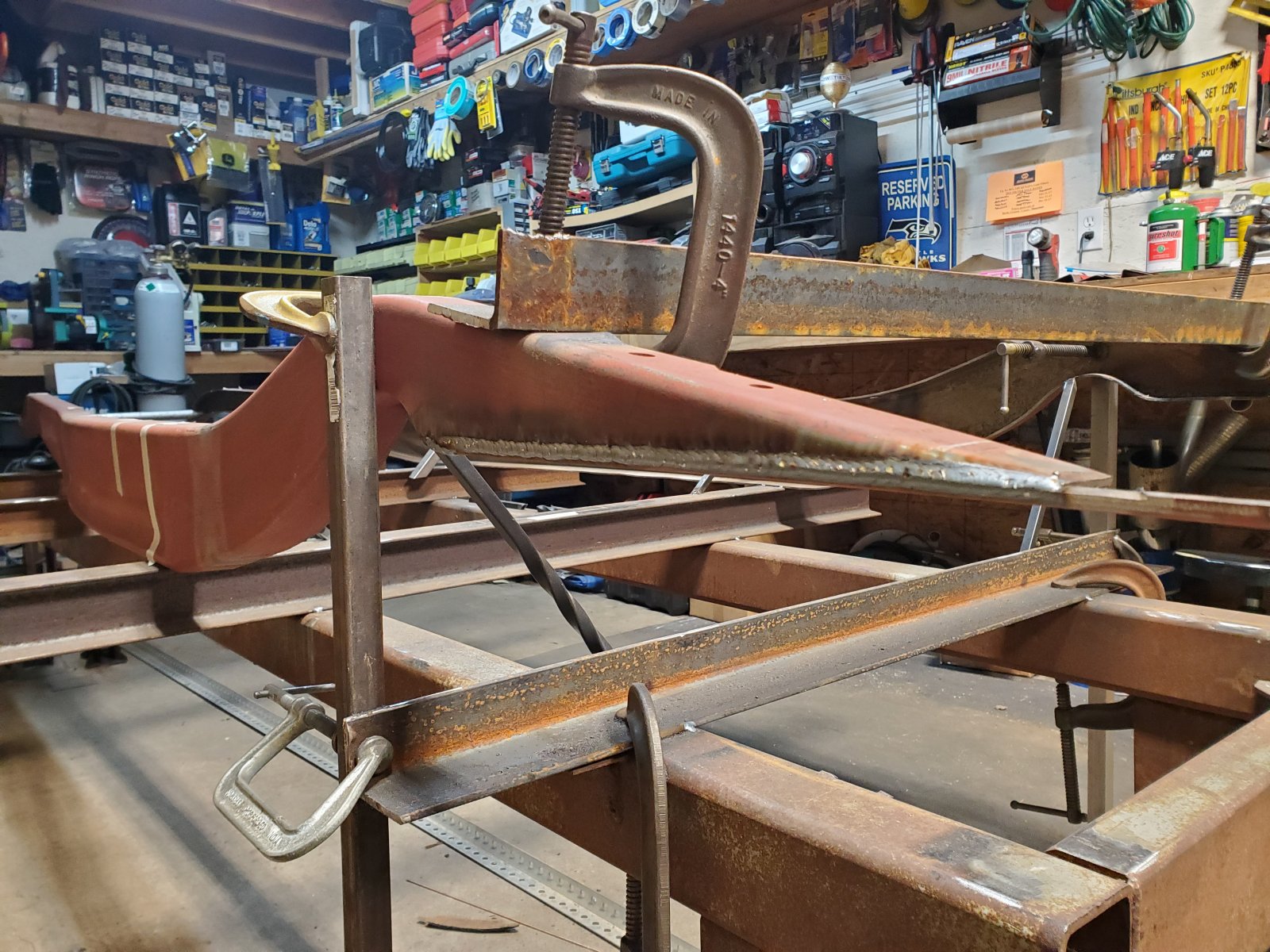

    Next item on the list was to get the frame table that I borrowed all set up. After getting it level and all the I-beam's in place I went ahead with locating the rails. That was a bit of a learning curve. I ended up ditching the Westcot drawings in favor of my own. The rails are dead on with a digital angle finder and the standard level. They fit the profile curve of the car dead on. Some work with the torch helped that out.

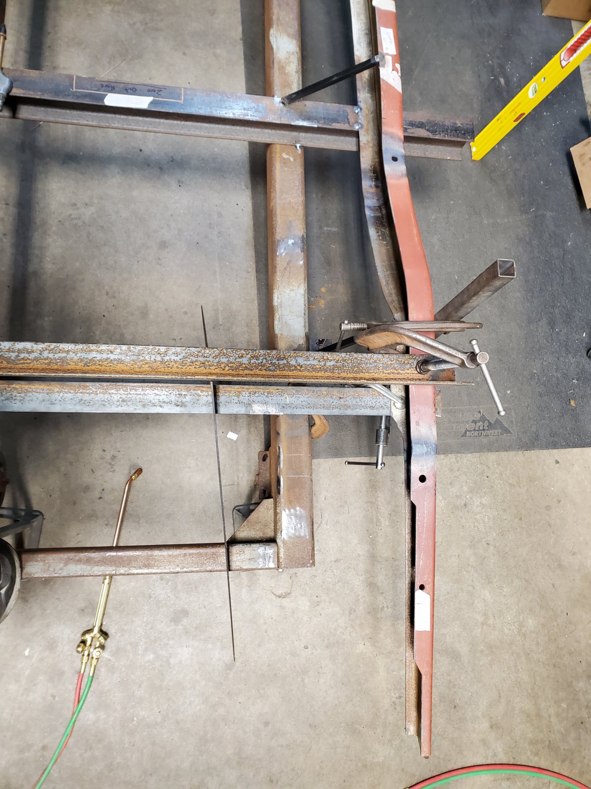

    Clamp and unclamp a thousand times. Then level, plumb and tack. After that I went with the heat to bend the back end of the rails.
    Here's shows the locations of the bends from the torch.

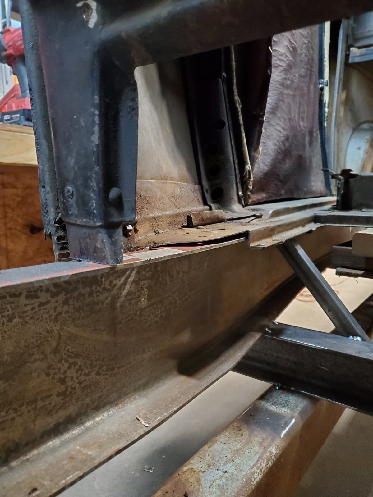

    So fortunate to have a forklift for this. Grabbed the extensions and put the body on the frame. Had to do this many many times to get the notching right and the frame bent correctly. Sits good and I like it. This pic doesn't show it sitting over the rails as it would though.

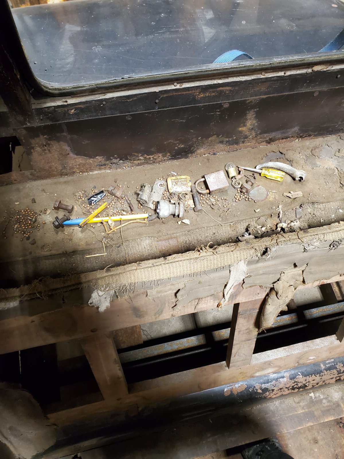

    Found mystery items left from years ago in the parcel tray fold. No gold bars though so I guess I get to keep harvesting off the money tree.

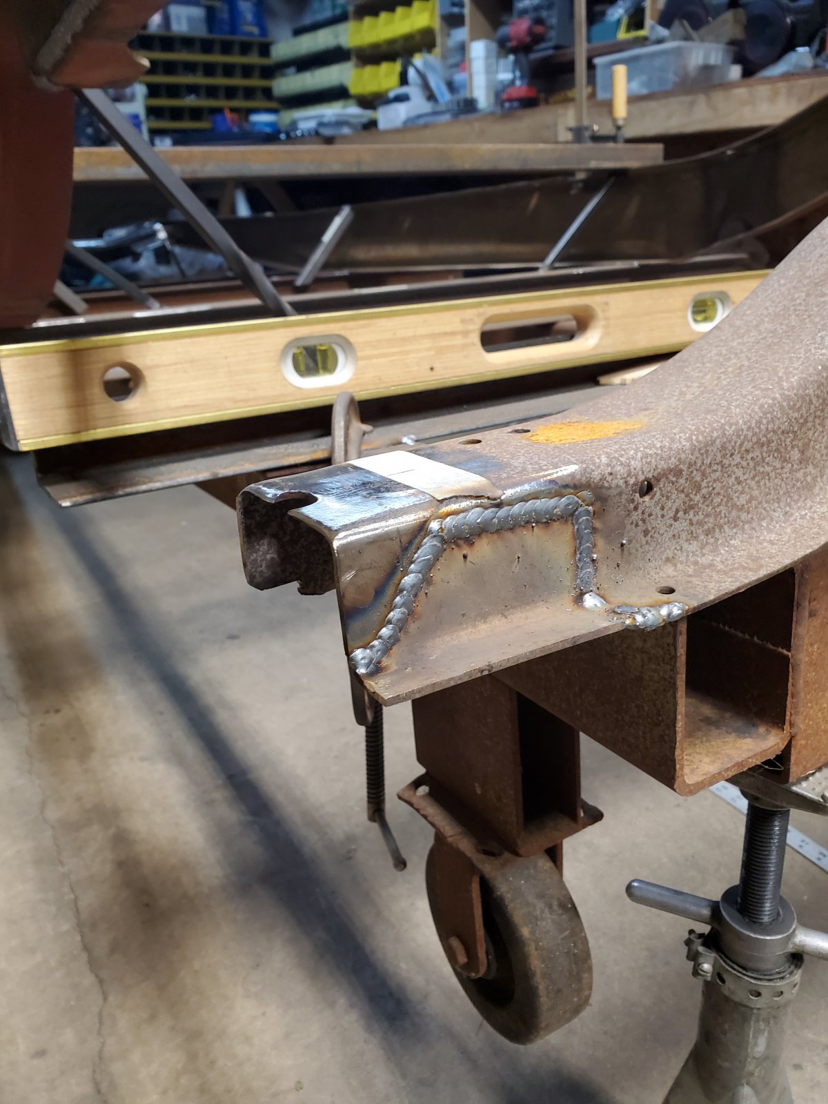

    Been busy on lots of things minus the car. I have managed to get a few things checked off the list now. After getting the frame where I liked it it was time to move on to setting it up at the degree for the rake I want. I put the body on and rolled the table outside. I've settled on a 4° rake for the overall frame. The front portion of the kick up where the engine sits is at 1.5°.
    Frame at the engine location.
    Center around the B pillar/door Jamb area.
    After that was to locate, cut, trim....trim....trim.....oh and more t******* to get a nice snug fit on the front crossmember. I set this up at 6°. I went with 6 for the simple reason that I can run 5 to 7. This puts me in the middle and gives me a tiny bit of room to be off a little if I change something. Side to side was 0.1 degree off of level so I left it there.

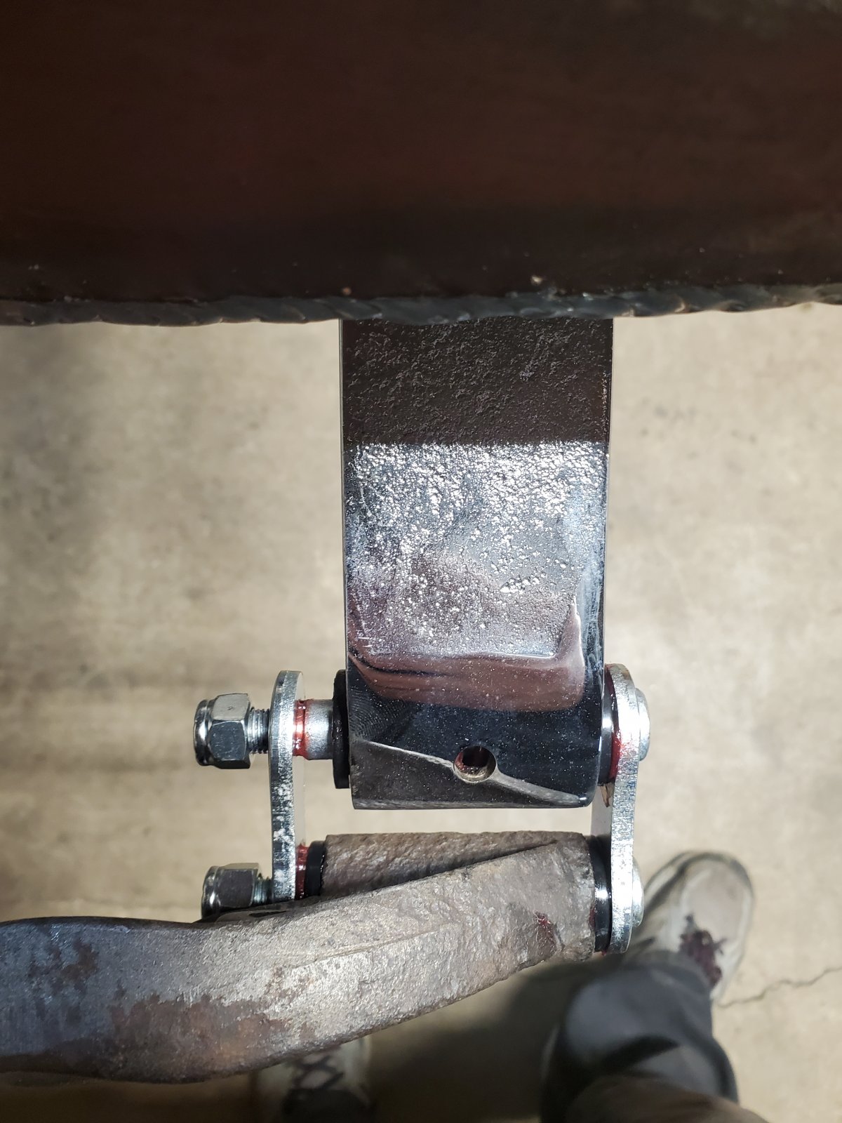

    Would anyone know why my rear leaf spring eye is narrower than the eye on the axle bell? Notice in the pic below that the shank for the bolt is exposed. I could make a spacer for that, but want to do it correctly. What would you guys recommend or do I need a different setup for this. Thanks!
    I'm getting more frustrated with this build, seems I make a step forward and do a few more back. I also have an issue with the spindles. Seems something is tweaked. If I rotate the spindle after the king pin is in it binds on full lock each direction. I've mixed and matched the parts till no end and I can't figure out what it is. I suppose I could toss the pins in the lathe and check to see if they are true.

  22. Stogy
    Joined: Feb 10, 2007
    Posts: 27,389
    Stogy
    Incompatible year for spring and mount? Is that a tapped hole for a zerk in the spring eye?
    303racer, brady1929 and loudbang like this.

  24. 36and63
    Joined: Mar 21, 2017
    Posts: 79
    36and63
    from Wisconsin
    T- rear spring is narrower and they have the zerk fitting
  25. Stogy
    Posts: 27,389
    Stogy
    Shimming is acceptable with spacer washers under this cir***stance?
    What year is the hanger off the rear...I thought T-springs fit A's as naturals...Is this perhaps a later hanger...
  26. 36and63
    Posts: 79
    36and63
    from Wisconsin
    I'm running a 40 banjo on my 30 roadster with T spring. I ground the hanger to match.

  28. Since you are in the mock up stage, put a washer/spacer on both sides of the spring to center it up with the shackle mount on the rear end. That way, if you decide to change to a full width spring in the future, you won't be fighting a misalignment issue.
