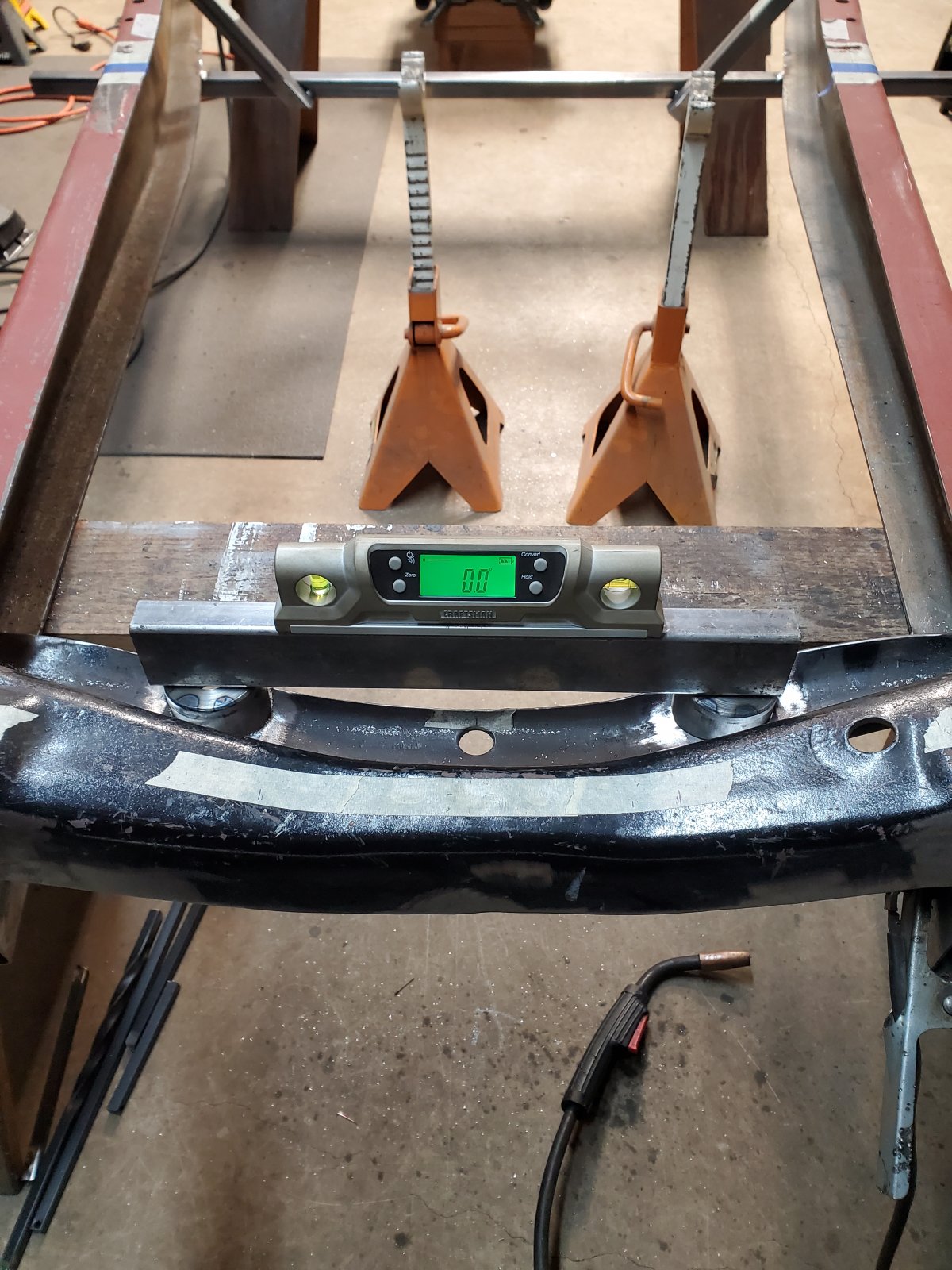

    Thats not a bad idea, I was only going to do the one side. Do you think an 1/8" will make that much of a difference over all though, are these ch***is that touchy on final setup. If they are I'm glad I'm being extra careful on the numbers.
    Side note, I ordered my the subrail kit from Steadfast Manufacturing a couple days ago. Looking forward to that showing up so I can start metal work on the body during any down time on the frame.

    Great planning on ch***is/angles/rear tails for body mounting! (Thought I was alone in that much 'ch***is ****-ity')
    If you are able to play with a milling machine, remanufacture some shackles (4) from 1/4" stock. Mill .125" off the spring hanger ends, nice solid solution.
    (Or, as in your earlier post? Tig some washers to the spring ends of the existing shackles: Both, 1/8" each, make them 'equidistant')
    Superb project.

    Thanks, I was told the more focus on getting the ch***is dialed in, the better it will handle and drive correctly at the end. So I want to take my time and do it right.
    I do have access to a milling machine, I actually bought one years ago. I don't have the room so it's sitting at my buddy's shop down the road for the time being. I need to get that thing some day lol.

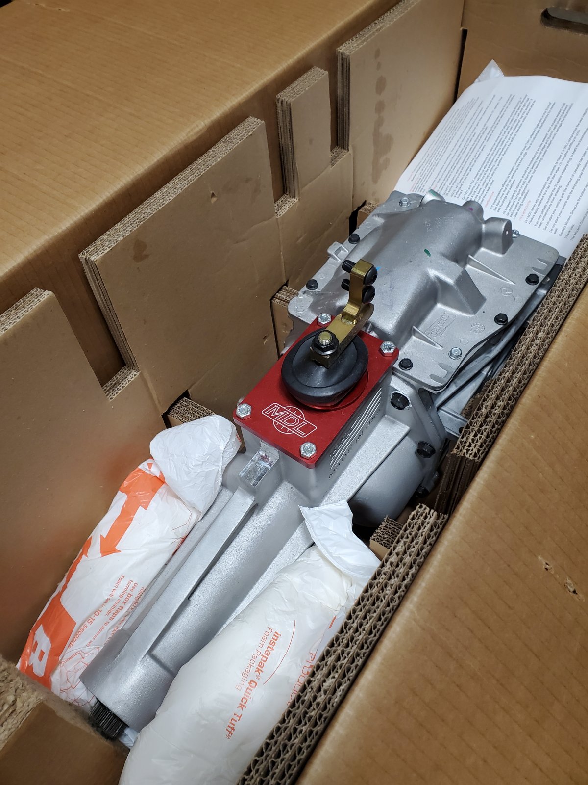

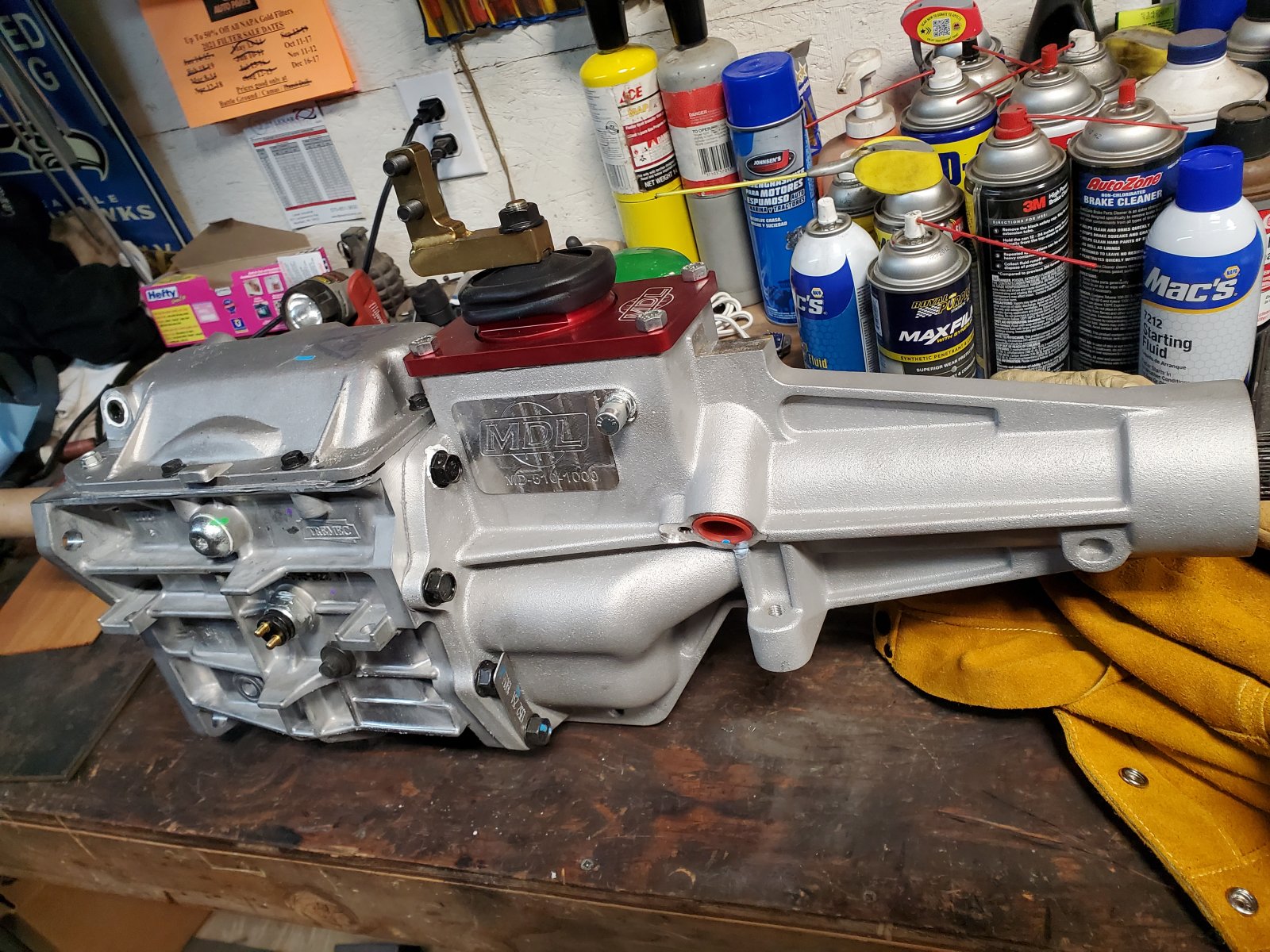

    Well I was a bit bummed out today after going out in the shop to open my boxes from Modern Driveline. I'm by no means unsatisfied at this point with them or the quality of components, but no bellhousing and no shift lever. They are on backorder. The lever is no big deal but the bell housing is a huge deal since I'm waiting on that for crossmember setup. So no great pics of the lot. The smaller boxes had clutch and items like hardware, fluid and misc. The transmission looks really nice though! Complete with a made in USA stamped tail housing. Once I get that stuff I will be able to continue with the project, but at this time I'm at a stand still.

    Nice Transmission!

    Thanks, it's a super nice setup. Hoping my bellhousing comes in soon. It's still not here, so I guess I get to make a phone call this next week. I have had a couple items show up. My tires from Diamond Back showed up. 7.50x16 rears and 5.50x16 fronts. Radials with a pie crust edge. They look awesome. I also got my wheels in, they to are really good looking. They are the Rocket Fire wheels in a cast finish. I can't wait to get this project on the go again, it's killing me to just sit and wait for parts.

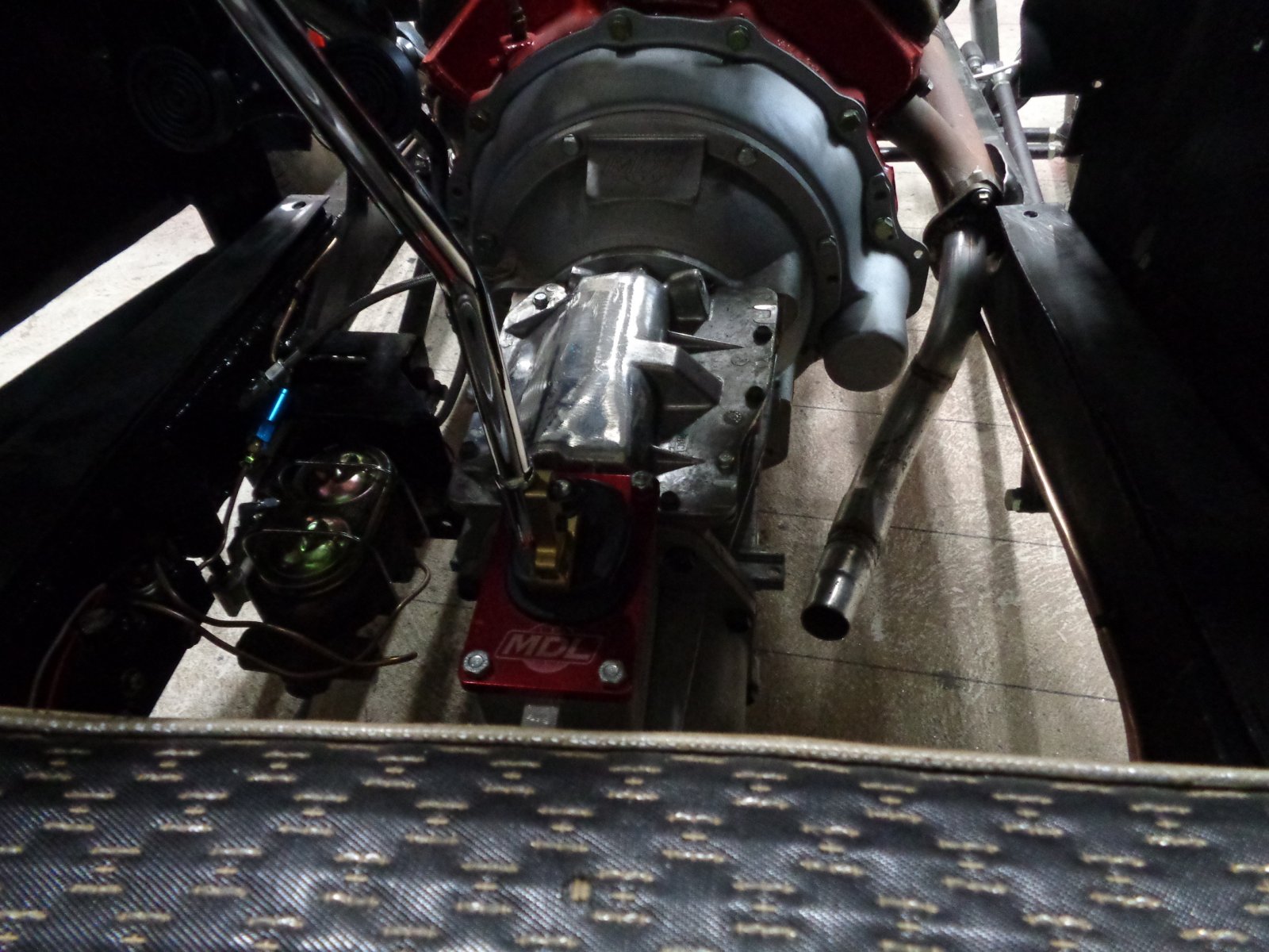

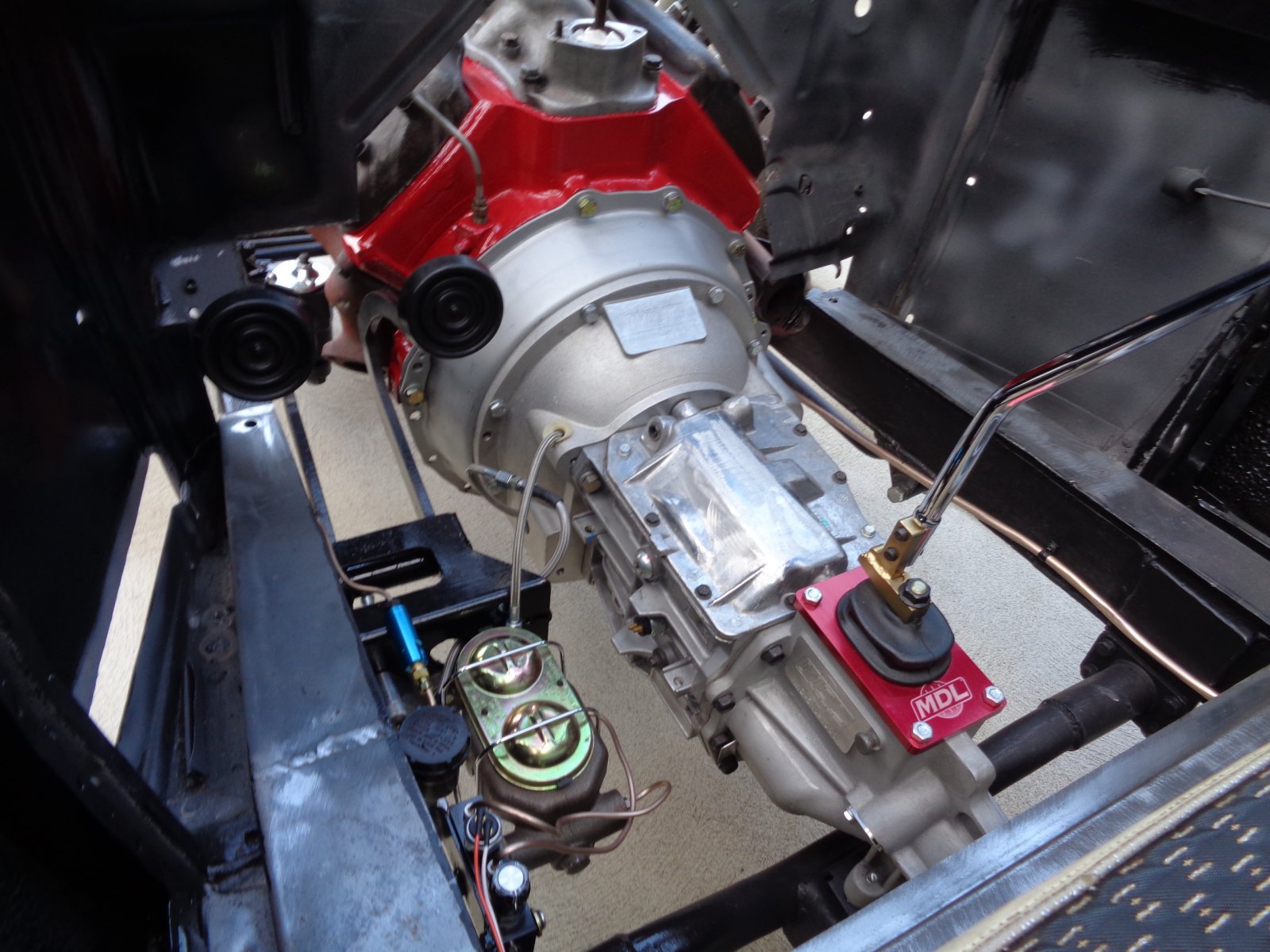

    Great project and progress! I wish I still had as much drive. I used the same MDL package. If you need any measurements to continue with the crossmember set-up since you don't have the bellhousing yet, let me know.
    You probably already know that the shift offset mount can be rotated 180 to move it back a few inches or can be replaced with a center mount. I found that helpful when setting up the steering, pedals, seat and shifter to fit me without any shifter bending. Things I like to sort early on during the build. DSC07013.JPG

    More than happy, they supply all the hardware needed and the instruction sheet is straight forward. Just make sure your crank pilot hole is large enough for clearance. The most critical detail for me was getting the Tilton hydraulic throwout bearing adjusted properly. It needs to be precise. After ***embly it is no longer accessible. Break-in and wear are calculated in the equation. Just use a dial indicator to get it right and clutch adjustments will never be needed.
    I just used a universal TransDapt crossmember with a rubber isolated mount which allows for minute adjustment. I welded substantial steel plate to the inner frame rails and bolted the crossmember. This allows easy trans removal without pulling the engine. Four bolts on each side and the trans and crossmember will easily lower.
    I just didn't see the need for any more frame structure than that.
    I always liked to learn from other's mistakes. Here is one I made. If I had moved the engine 1" rearward I could have easily mounted my 7 blade fan and shroud. But then the firewall would need to be modified a bit more to enable head removal. It gets tight with a channeled, full fendered, hooded car. Seems like you are always stealing from Peter to pay Paul.
    With my 3.80 rear gear and the 2.95 T5 1st gear ratio, making left turns from a stop at an intersection sometimes requires shifting into second before completing the turn. Other than that its awesome and really brings a flattie to life.

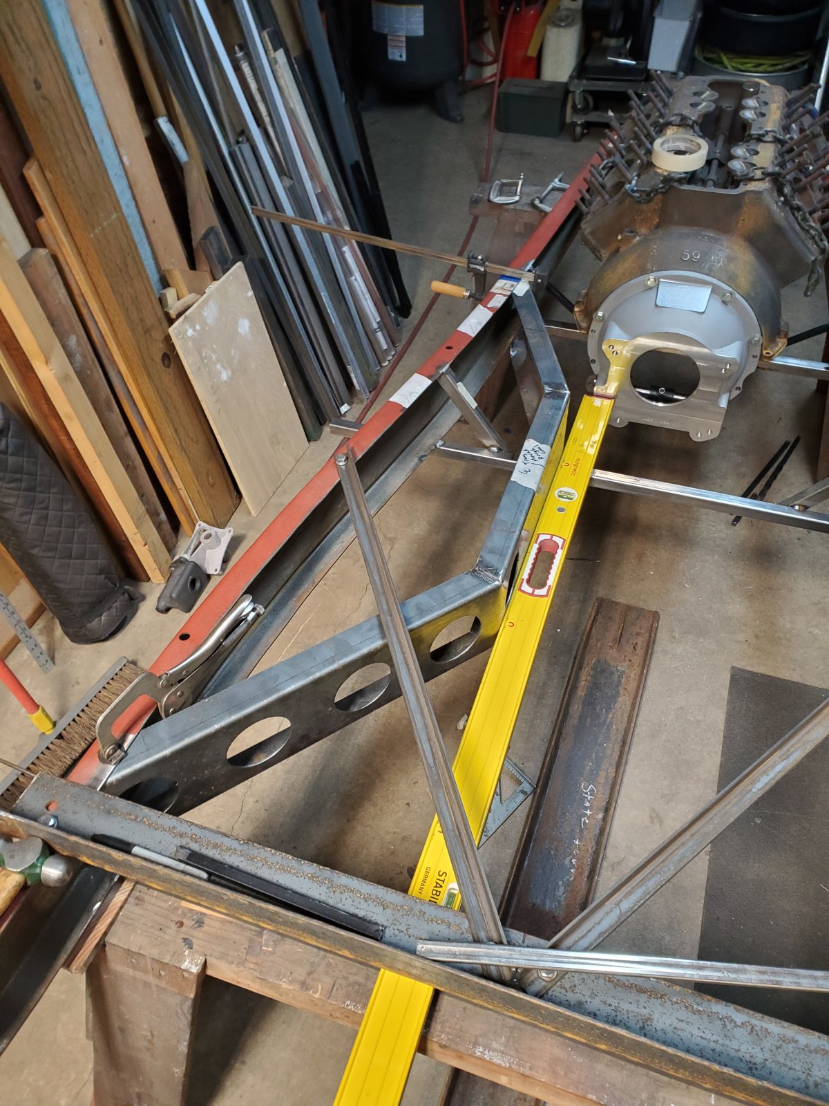

    I located the engine and prepped the front crossmember for that. Had to trim the small lip off it so It looked better. It just looked terrible so I trimmed it to look better. I also trimmed it to avoid the balancer, or I hope so. I set the engine up at the 1.5 degrees and centered it in the frame. Since I'm using a set of 32 front engine mounts I went ahead and bolted those up. I located the furthest point forward on the firewall and transfered that to the frame rails. Took that measurement and compared to the engine. From mounting hole to rear of block is 26 1/4". I used that measurement and located the furthest forward location of the mount. Transfered the hole locations down with a center punch and went to town with the hole saw. After a little die grinding to get the holes a tiny bit larger the tubing fits snug. You can see the portion of the cut off lip section on the saw horse.
    After that I started work on the mount. I'm no where near finished with this but it was time for dinner so I had to pause for the night. I'm using some 2 1/4" tube. The lower portion of the mount will sit inside the tube, then the steel flat plate will have a large hole to accommodate the rubber to keep it from shifting. Then the top portion of the mount will sit on top of the plate and under the mount. Fairly simple and not overdone which I like.

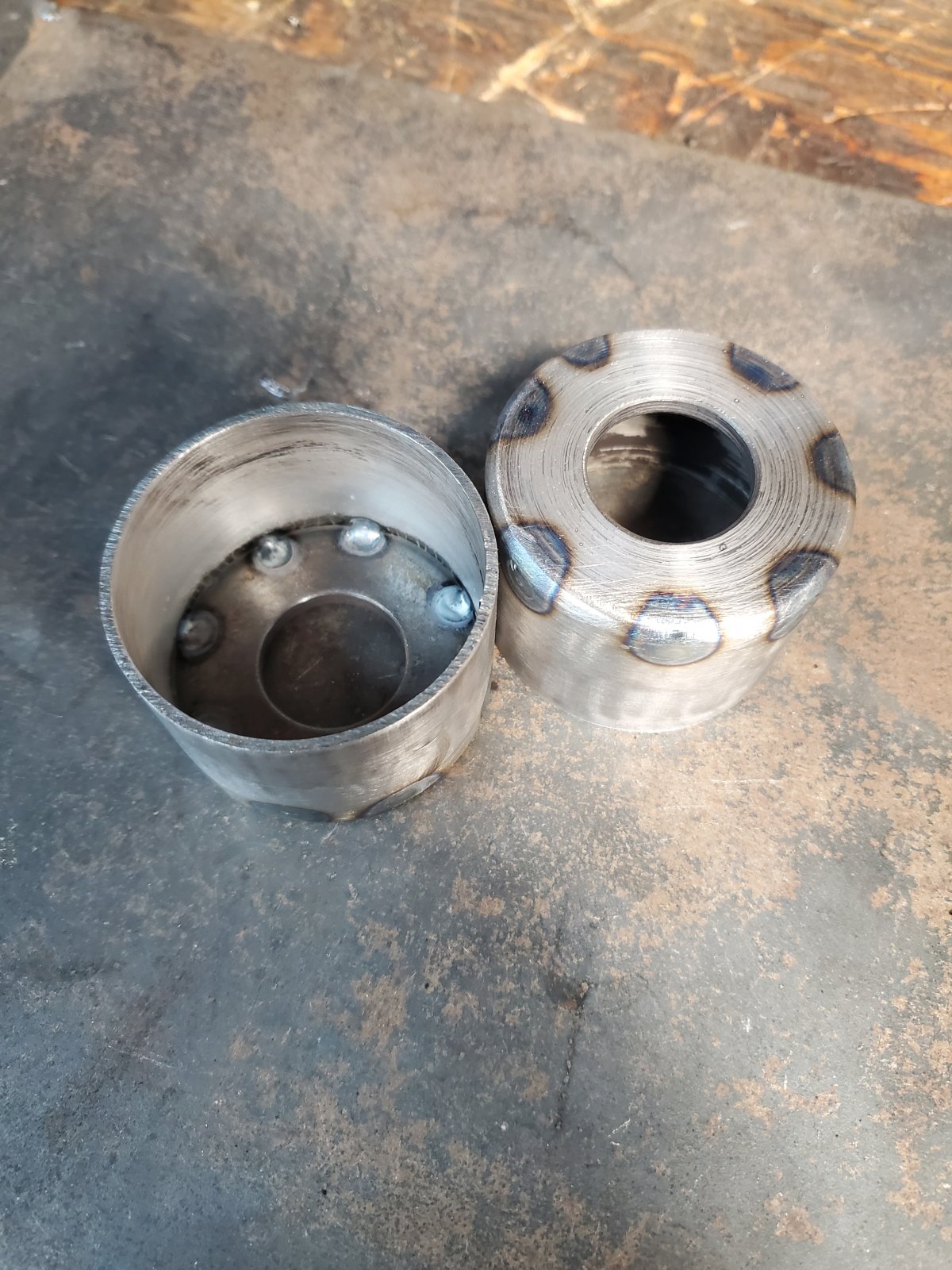

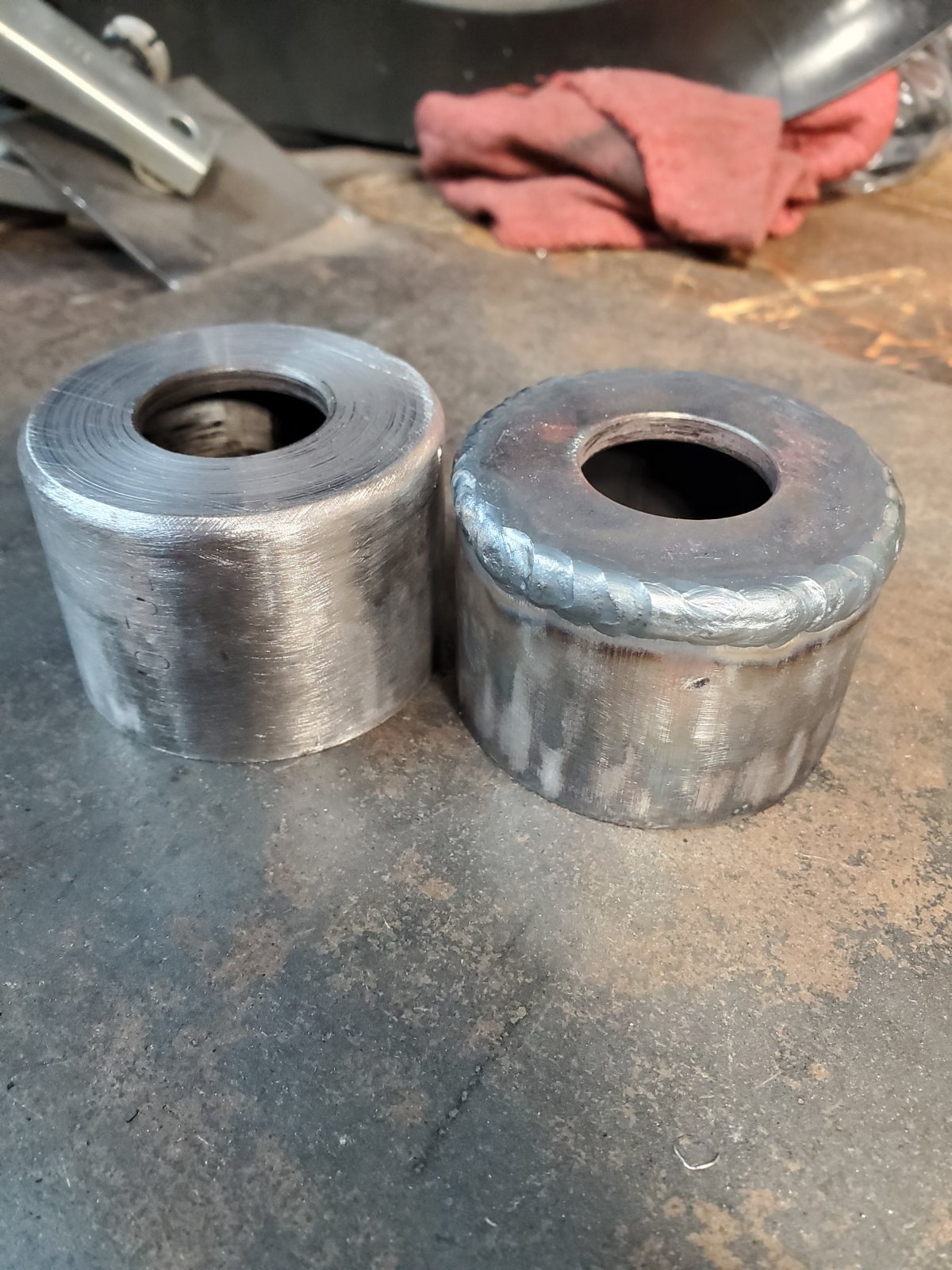

    Here are the round pieces I'm making, no fancy tools here, just a grinder with a cut off wheel. Then I grind them into round pieces.
    This shows the circle plate that will be welded to the bigger tube. Note the rubber portion sits just flush with the top, this will allow the top mount to be snug up against it. I still have to finish grinding and smoothing it out. Also plan to so a small round over on the top edge. I wish I had a vertical band saw now.

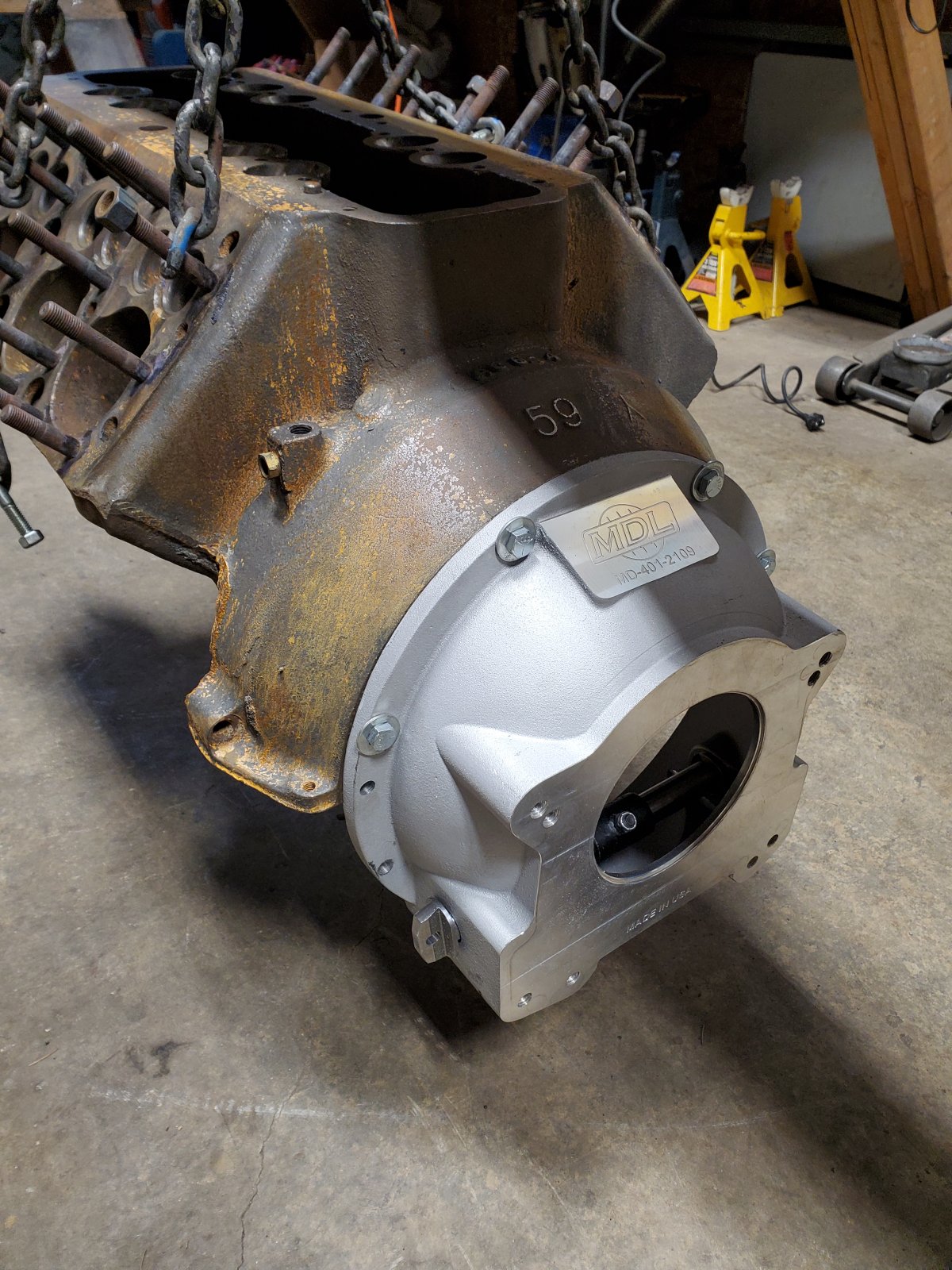

    For the last pic here it's just the bellhousing. Of course I'd get sick right as parts show up. Just glad I finally got back out in the shop. I should be able to get out and finish up the mounts tomorrow!

    Well I was back at it today. Got the engine mounts wrapped up. They will just need burned in after all the final fitment checks out.
    Started by finish grinding the round disks. I used the tig and just melted the 2 together using the thick material as a filler. Then I finished the end with the lathe and a final hand sand.
    Under the cap I did some quick tig tacks just to make me feel better about it holding.
    After that it was time to get them setup. Once I got the first one located I clamped a short piece of steel between the two and tacked the second in place. Took a bit to get the first one dialed in. I wanted it set at zero degrees/level across the ch***is. Then I went 1.5 degrees to match the engine degree. Dead on each direction, so I'm super happy with that.
    After that I set the engine back in to check things. It lined up perfectly. I found that one of the factory duece mounts is bent. I guess the originals are just steel and the new re-pops are cast. I'm thinking that one got bent during its life so I'll have to make a little spacer to get the engine to sit at 0 degrees.
    I also put another cross bar under the engine. This gave it more rigidity, plus it gave a place for the back of the engine to rest. The one that's in there now will have to be removed to fit the transmission. However I will leave it to keep the ch***is more solid till I finish up the K-member. As for that I will be making my own. I've looked around and am not thrilled with paying the minimum charges to get some stuff bent up.

    Your picture shows the truck waterpumps with the integrated motor mounts. I'm not sure of the plan and am just a little curious why you didn't use them for engine mounting. It would have allowed for easier fore/aft engine positioning.

    These water pumps are no good, just tossed on for location of water outlet/inlet. That way I could get a height location. I will be installing a new set of pumps and cutting the mounting tabs off. I didn't want to look at an engine mount off the side, that's really the only reason for going to the 32 set. They are slotted so I can move it front to back about 3/4" for total movement. I'm headed over to another steel fab shop this morning to give them my drawing and to see what it is going to cost to have some rails made for my K-member. Tomorrow I will be taking my tires down for mounting and balancing.

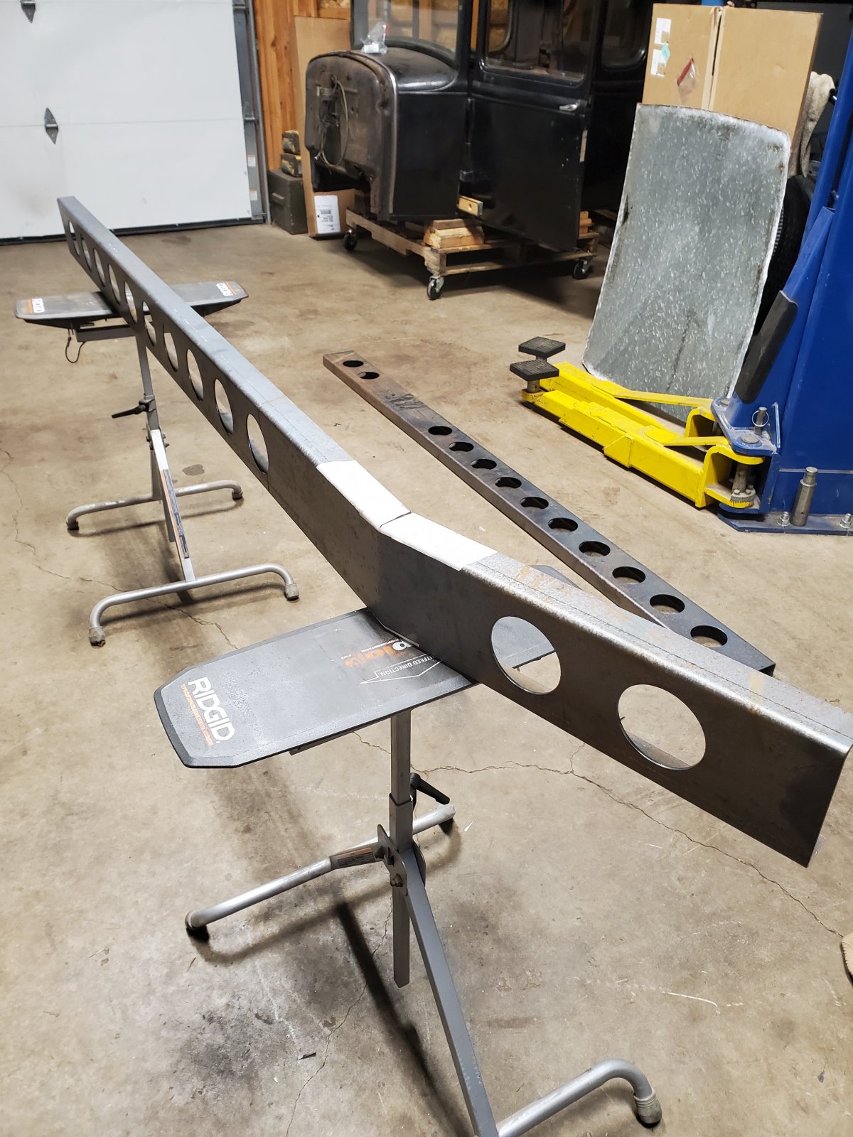

    Okay guys, sorry for the long time without an update. Been really sick as of late. I felt decent enough to get back out in the shop and actually get some work done. I got some k-member rails bent up and fabbed for me at a local shop. For a whopping $225 bucks I got 2 eight foot rails bent up and holes drilled. I thought that was a very decent buy. Today I got to working on them. Started withe the critical side of course, as the brake and clutch pedal layout is crucial for proper location. I did some figuring for steering column location and pedal location. After that I started bending and cutting. I'm happy with how it turned out so far. Onto the pics!

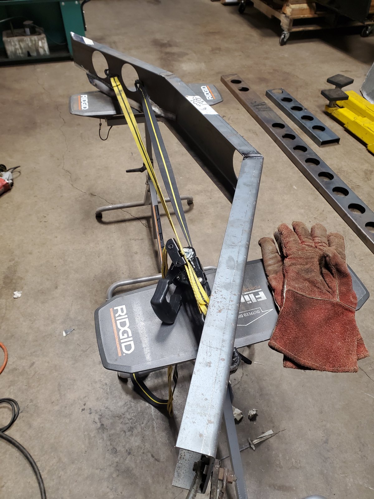

    First pie cut to get the angle I need for the front.
    I found that a ratchet strap worked great to hold it at the proper angle so I could tack weld it up.
    I went ahead and mocked up the pedal ***embly. I'm curious from you guys on one thing. How long is the clutch linkage arm from the pedal to the shaft on the trans. Mine is in total about 3.5". Of course this is a very rough measurement but close.
    Here is a quick shot. I believe MDL sent me the wrong setup for the clutch arm, so I gotta take care of that. Here is the length to see if you guys think that's about right?
    After the front was good I went ahead and did the rear bend. That was much easier minus the coping in for the beauty line on the frame. The front had a pich and a few more cuts to make it fit the narrow front rail.
    Last but not least a shot of it mocked up in the ch***is. I might be able to get back out tomorrow and mirror this one for the other side.

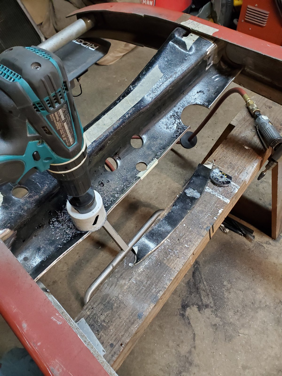

    Had a little free time after work today so I headed out into the shop to work. Did some fine tuning to the driver side rail to get it set right. Made a mirror image of it and swapped it to the p***enger side. I have 11-1/2" inside the rails for the trans to fit. Should have about 1" on each side of it.
    Took the time to cope in the K-member rails to fit the beauty line on the side of the ch***is rails.
