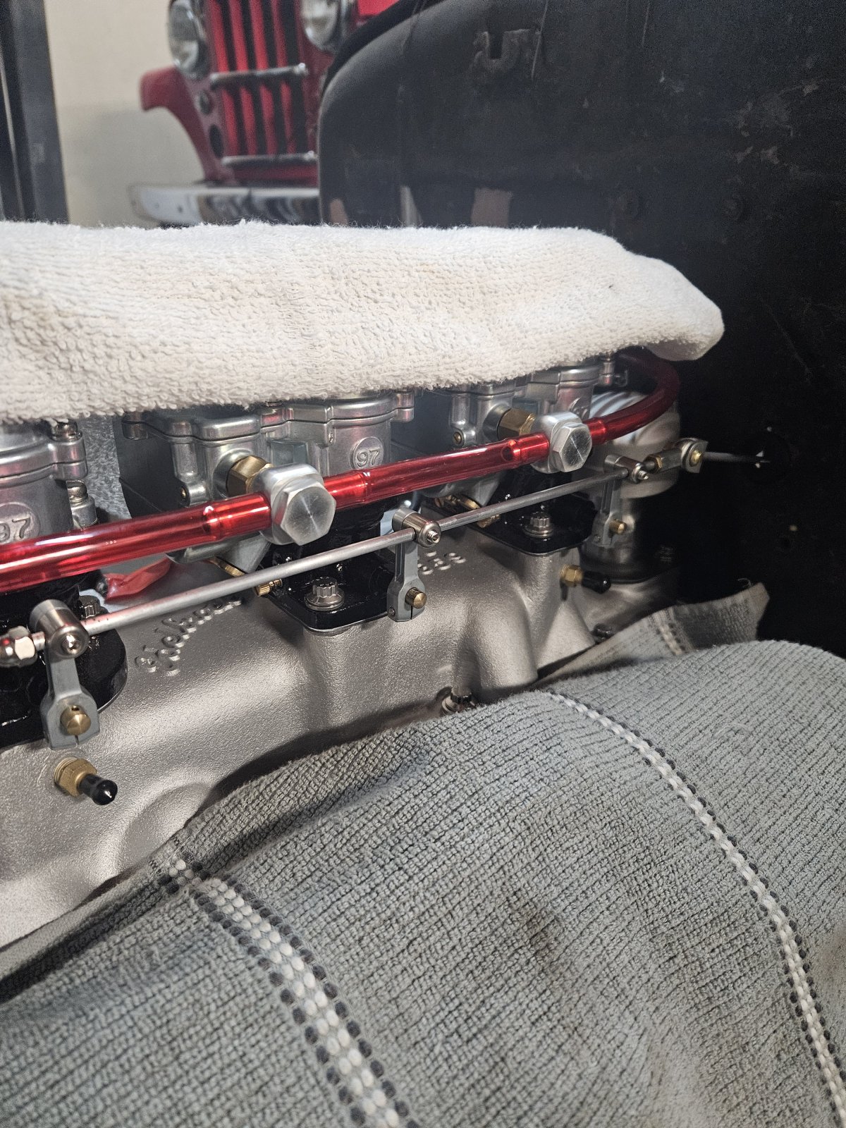

    Back to the small stuff that takes forever. First thing on the list was the throttle linkage.
    First step was to locate where the pedal would sit, so I tossed the seat back in and put my foot at the spot that felt good. After that I built a small stand off for the pedal. This allowed me full travel, and at full throttle the pedal arm is about 1/16" off the floor. Good for now, might have to adjust later for carpet. Cut one end, put a radius on it to match the pedal foot. The pedal spline setup was flipped from the factory design. This was to allow the linkage to sit straight through the firewall.
    I wanted a simple p*** through linkage, but I didn't want a steel braided line. After a bunch of figuring on pedal location, pedal/pedal arm angles, throttle at full and resting positions, and trying to get the smallest hole in the firewall possible. I came up with what I think is a fairly simple design. I just used some 3/16" rod, a heim joint and some hardware. I made the arm from the pedal to the heim joint location out of the same 3/16" rod. Tapped the end, then bent it over. Other end I made a small pocket for the joint to slip into. This part is fixed so I ended up putting the adjustment in the carburetor rod itself.
    From the top side, used some br*** parts to tie it into the carbs.
    Next item on the list was the breather. The other cast one was hitting the firewall, and being a cheap casting there is no way to weld it. So, I found an exhaust adapter that fit the breather portion perfectly. I traced the old on on a piece of steel and cut it out real quick.
    Inside I welded 2 baffles at opposite sides on angles. This should baffle the oil vapor, same as the cast part had. Put a 10 degree angle on it to clear the firewall, then welded it to the flange. After that I used some JB weld to make a smooth plate to tube look. I wanted this to look more like a stock part than a custom part once painted.
    That's it for those. Next is the ever so fun project of mechanical fan with 3 carbs.

    Next on the list was the throttle linkage and the crankcase breather.
    Throttle pedal itself was flipped. I installed a small nylon washer to space it off the base/foot I made. The base was to lift the pedal allowing me full travel at a more comfortable location for my foot.
    Next was a ton of figuring on the linkage, for something so simple. I had to factor in full throttle, no throttle, pedal angles, pedal arm angles, distance traveled, heights, all while trying to keep the hole in the firewall as small as pilossible.
    The throttle rod itself is 3/16" steel. I tapped both ends, one for a heim joint and the other for a acorn nut to finish it off. The heim is to keep some movement in the throttle while things twist under loads. It also allows for movement in the arm height as it travels through the arc from full throttle to no throttle.

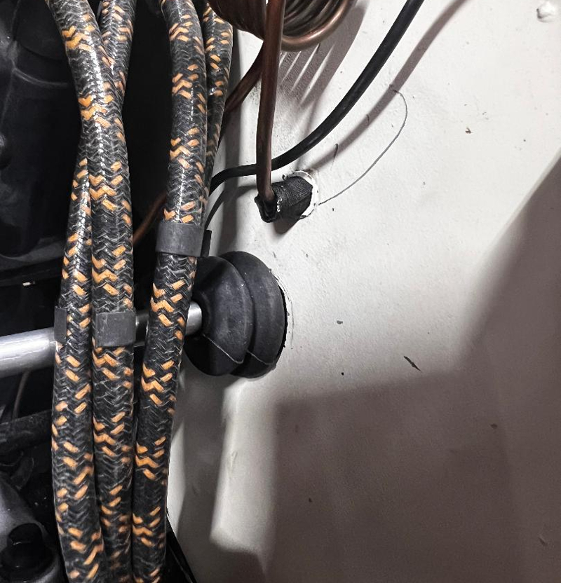

    I picked up a grommet that I was able to cut with a razor knife. This keeps as much out of the cab as I can ask for. Also used some br*** to tie it all into the carbs. I'll probably look for a br*** acorn to swap the other one on the front.
    Next was the breather. The old cast aluminum one was.straight up and it hit the firewall. So I traced out the base and cut it out. Next was the tube, found an exhaust adapter that fit perfectly for that.
    Inside the tube and at the bottom, I welded in 2 baffles to match the old cast one. I then started sanding at different angles to get the breather some clearance from the firewall. Ended up at a final 10° angle. Made sure it could be removed from the tube with the fuel line above, then welded it together. After that I used some JB weld to feather in the joint. I wanted this to look more like a factory stamped part than a custom welded one after paint.
    Next item on the list is the mechanical fan setup with the 3 carbs.

    Just an FYI, a Harley rear master cylinder boot OEM 41764-79 makes a good throttle rod boot. Opening is about an exact fit for the rod. It was 8 or 9 bucks at one time, not sure now. Drilled the hole in the firewall to fit the first necked down portion of the boot.....stays put.

    I like your work. I did find on my triplet of 97's that the throttle linkahges work best when tipped forward 45 degrees (or 10:00 rather than your noon set up).

    I'll have to look into the bellows style rubber boot, I like the clean look of the flat one for now though.
    Yeah, didn't know about clocking the linkage. I suppose that can be done, but I'll need to make another rod to lengthen it.

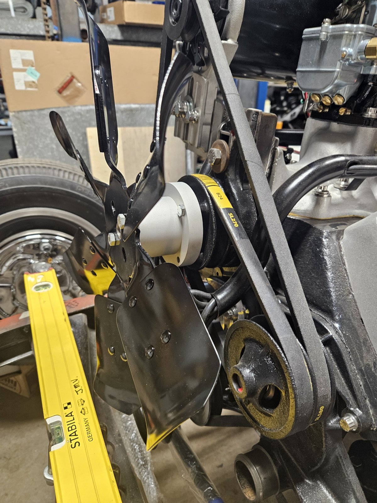

    Time to dive into the mechanical fan mount. So I ran into this problem promptly in my process. The front groove on the lower pulley sits almost right under the cap and wires. So the belt ran right through it. Not going to work.
    So, after staring at it for an unknown amount of time (longer than I want to mention) I came up with an idea. I decided to use the original generator mounted fan setup from my parts stash and convert it to a fan setup. Yes, it's been done before, but I haven't seen it upside down.
    I took everything off the back of the aluminum backing plate like the brushes and pins. Then ground down all the high spots. This picture shows the rough grind. I cleaned it up with an 80 grit 2" disk. I also indexted it some by grinding the lip on the outter edge. Also keeps it sitting inside the other side of the bracket. 20231209_154953.jpg
    Next I cut the main shaft off, stuck it in the lathe and turned the larger end down to fit snug in the bronze bushing.
    Next item on the list was to make sure I have oiling to the bronze bushing. Since I flipped this I needed to flip the oiling setup as well. Pulled the oil cup off and plugged it with a piece of br*** stock.
    Then turned a piece of br*** to accept the oil cup and press into the aluminum housing. I cleaned and pre-soaked the oil wick inside as well. Time will tell if the weep hole (tiny hole at the bottom of the wick area) will leak. If it does I will plug it.
    I had to drill out the lower (old upper) hole on the steel bracket side and tap the aluminum side to reverse the bolt head. It was hitting on the timing cover upper bolt head. I'll also counter sink it so the fan blades on the pulley clear it.
    To be continued....

    Fan setup continued....
    Next was to make a bracket. I knew things were going to be close as I was mocking things up, but close it sure is. Everything on this is close, which is why it took me days after work to figure out. I see why guys go the electric fan route lol.
    Grabbed some 3/8" and 1/2" plate and made a bracket. Put a small angled recessed spot for the oil wick area. So when it slides up and down for belt tension it won't rub. 20231210_122938.jpg
    Now here's where I messed up and made it more complicated than it needed. I should have made the 1/2" stand offs on this bracket deeper by 1/8". Then I could have milled a groove in it to slide like the factory mount, but that's okay. This works too. The top needed something to keep it from rotating, so I placed a small tab on the top of the bracket, seen here as my template. 20231210_132946.jpg
    After that I needed one inside. Turned down some aluminum for that as a spacer. It also keeps it from rotating on the lower side.
    Time to check clearances. Again, snug as I'd like it to be. This is mid point. It will go as low as sitting on the casting of the engine. Then up till it touches the oil cup. Plenty of travel for belt tension.
    A front shot of the system mocked up. Close to the distributor as well on full drop, but still plenty clear.
    Put the fan bracket at its lowest point and ran a string around the ouuter edge of the pulley to measure belt length. It came out to 26-7/8". I ordered a 27" belt first to try. It was spot on perfect!
    To be continued....again....

    The whole crux of this design was the double pulley. A special thanks to fellow Hamber Groovybaby6 for selling me the double pulley. I really appreciated his prompt response and delivery of the pulley. I decided that this would be a good idea. A single side pulley for the fan. As you can see it seems to be good to go, time will tell after use.
    This was a bit more involved as normal. Some trial and error, dis***embling and re-***embling the pumps many times. They are very specific in how they go together. Many checks with a micrometer and feeler guages.
    I pulled the pump off the driver side. Put the double pulley on and put it back on the car for testing. However, I noticed a diameter size difference from the other side. So I checked, and sure enough not the same.
    I had some other old pumps laying around, those had the same diameter of the double pulley. Swapped the p***enger side pulley. Promptly ran into the smaller pulley hitting the snout of the new pump body. Here's a shot of the snout difference from old to new Speedway pumps.
    Had to grind it down to be just under the inner diameter of the old pulley. Stock Speedway pumps. One sanded down to fit old stock pulley.
    After I got the pulley and pump situations figured out I then made sure the pulleys all lined up. Turns out my alternator needs spaced out some. Shouldn't be to bad to do with a spacer. I also pressed these 2 pulleys in a little further than before to match the lower crank pulley better. So this picture is more than it currently sits.
    All that sorted out and final test mounted. Seems to tension the belt well and clears everything well. I'm super happy with the look and the fan location. I will do some final detail work like clearance the fan bracket itself for the upper belt.

    Picked up a piece of 6061 T6511 round stock to make the fan spacer.
    Got started by getting a rough shape turned down. I didn't have my fan yet so I focused on the hub on the engine side.
    Got it fitting nice and snug, enough to hold itself in place.
    Transfered the holes and set it in the Mill to drill the mounting holes.
    My fan came in so now I had a template for the depth of the spacer. I also had the pilot holes size and mounting bolt locations to work with. I ordered a Speedway six blade 16" steel fan. After all said and done a 17" would fit just fine and come close to reaching the furthest fins on the radiator, but for now the 16" should be fine. I drilled and tapped the fan holes for 5/16-24x0.75" UHL 12pt bolts. Made a steel centering ring and pressed it into the spacer. Tossed some loc***e 638 retainer on both sides and pressed it in.
    Finished hub, I then put it in the bead blaster to dull it up some. I'm not into shiny aluminum on this car if I can help it.
    Mocked up on the engine. Spacing behind the fan is about 3/8" to the closest point. Spacer length is just under 3"
